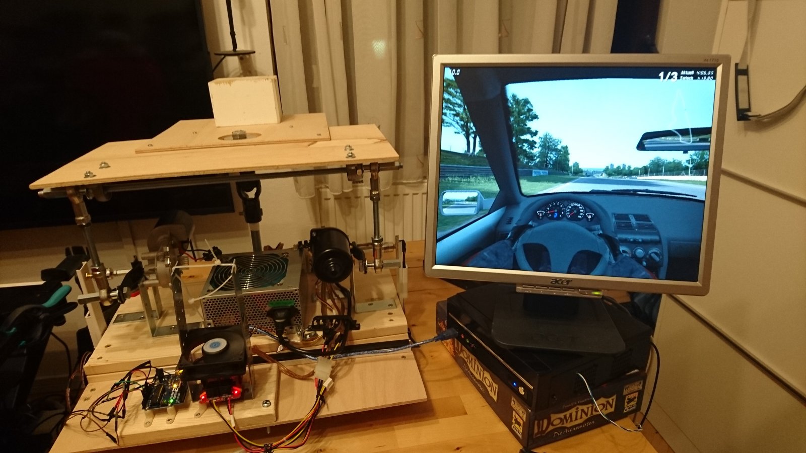

    Hello !

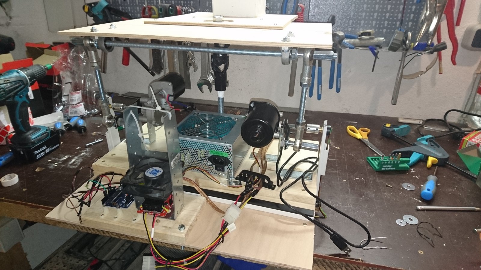

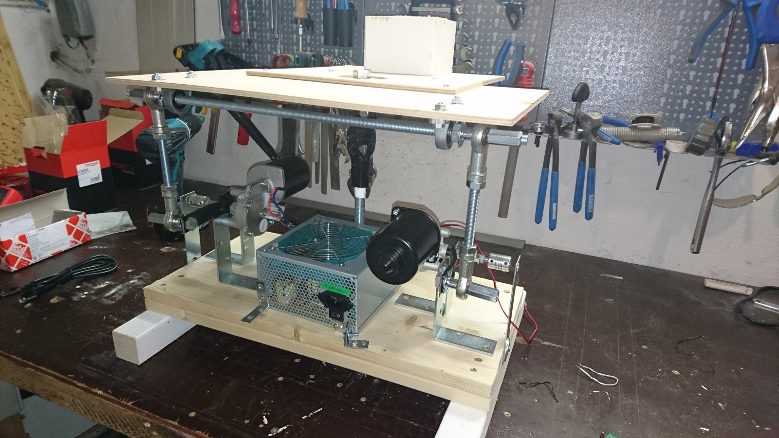

    Test Prototype

    used parts for Prototype

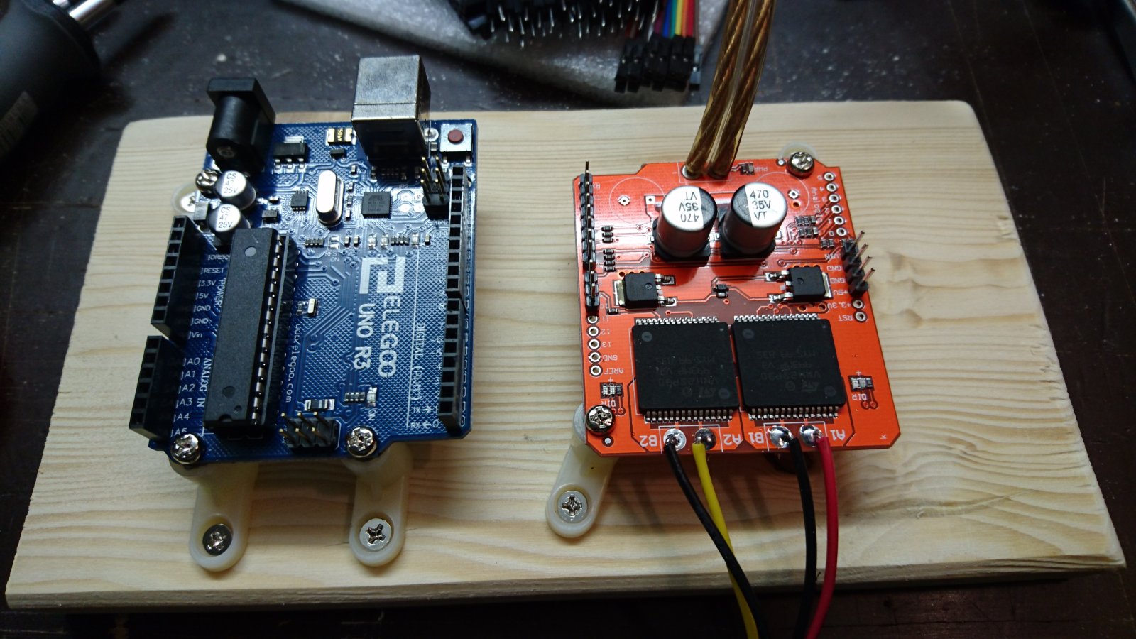

    1 x Ardurino Uno with SMC 3 Software ( 20 Euro )
    1 x 400W Power Adapter from a old PC
    1 x Monster Moto Shild from China ( ca. 5 Euro )
    2 x 6127V1A180L.5FS - Hall Effect Sensor ( ca. 40 Euro for both)
    2 x Flexclutch for Hall Sensor ( 15 Euro )
    2 x Wipermotor Metzger 219507 (VW Golf, Polo) ( ca. 60 Euro for both ) will be replaced for real Sim
    1 x Febi 18539
    2 X Block Bearings ( 30.- Euro )
    4 X Rod end M10 from Ebay ( Ca.20.- for all)
    Some wood, threaded rods (M10, M14, M16) Patience, help from the forum,
    and above all time!

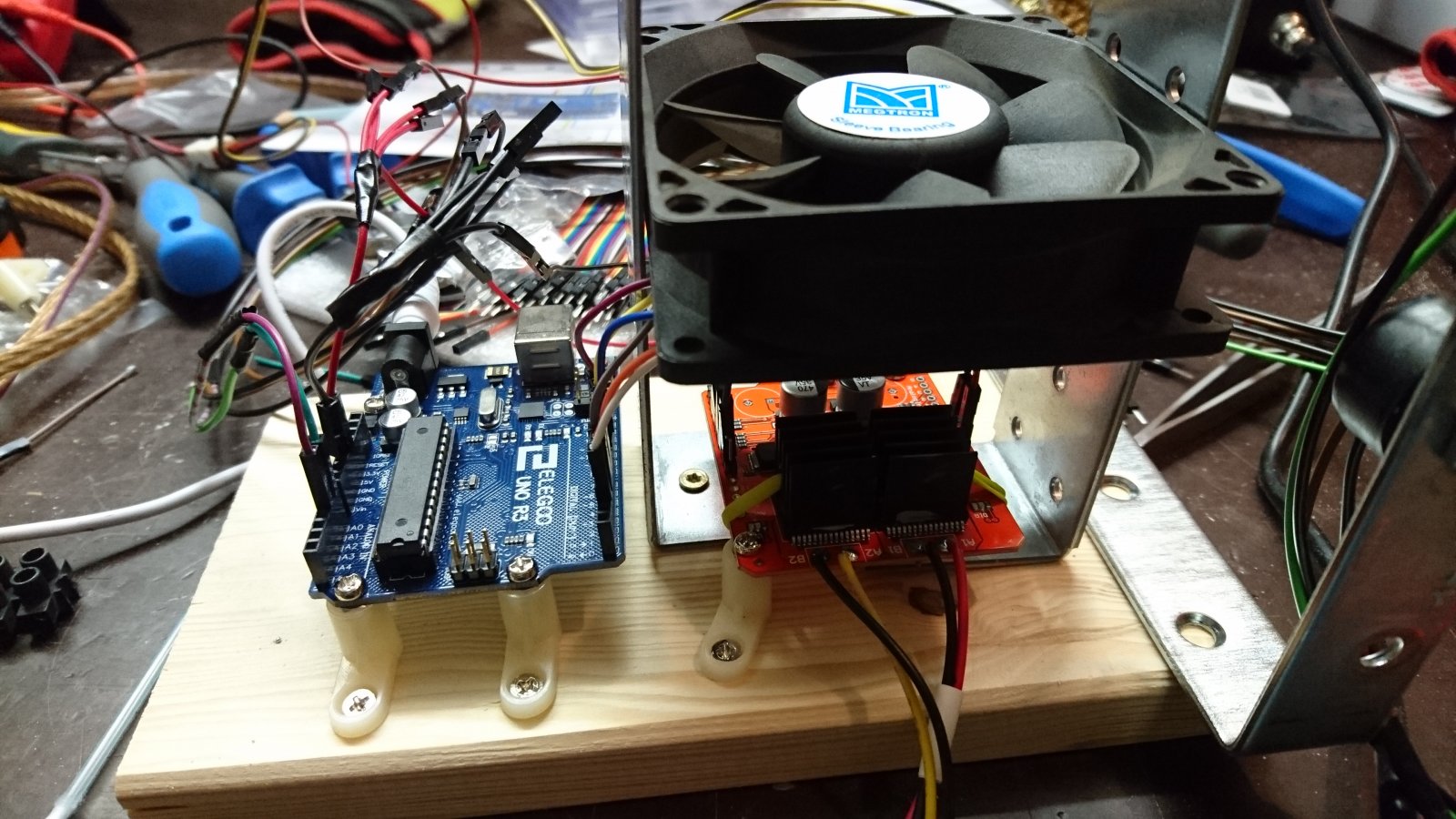

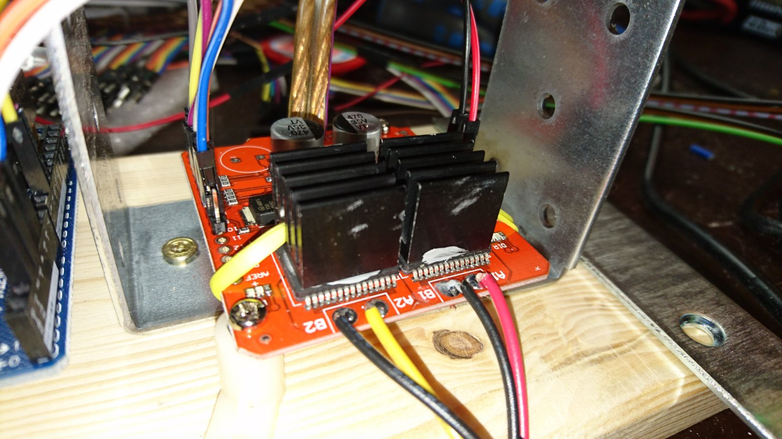

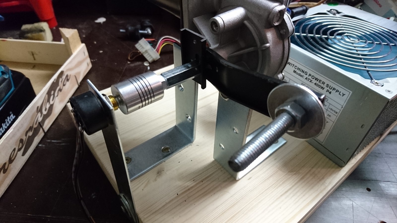

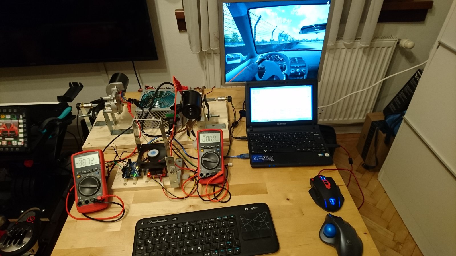

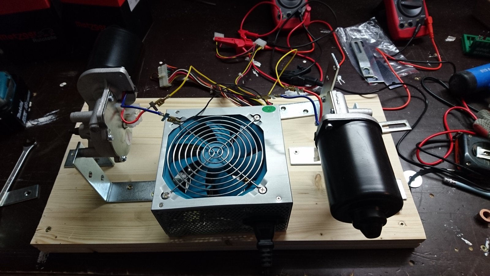

    8.JPG 9.JPG Block bearing for threaded rods M10 8.JPG 8.JPG 49798

    DSC_3730.JPG and so it looks like now. And works better than I thought, ...

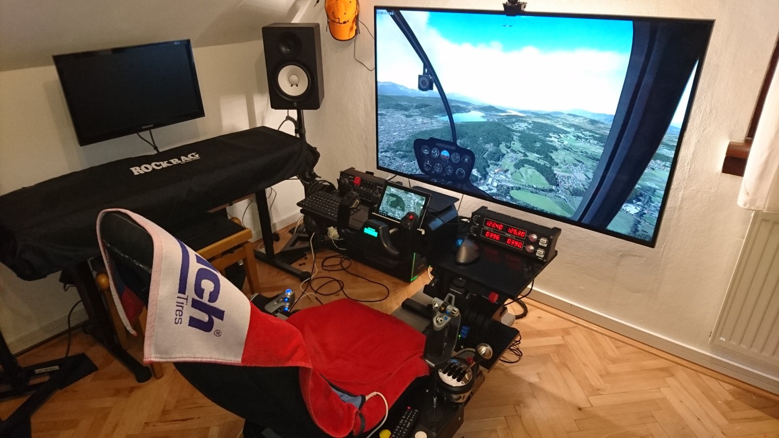

    It should be a full-frame simulator because the seat already exists and I like to play flight and racing simulations, ...... DSC_2961.JPG DSC_2961.JPG DSC_3737.JPG DSC_2961.JPG DSC_3737.JPG

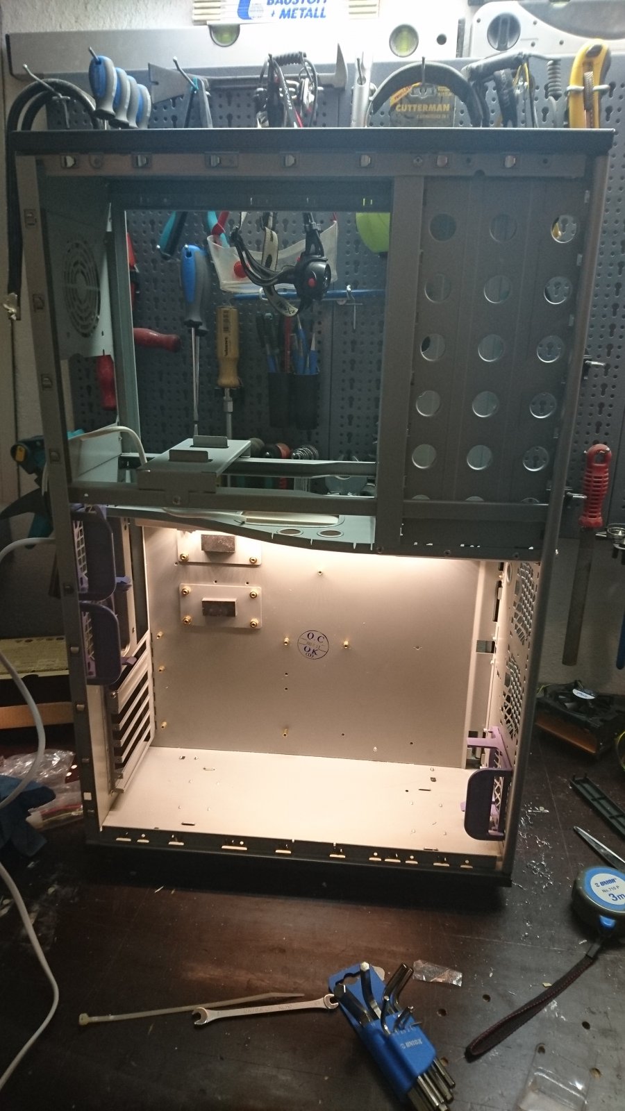

    I got an old server case.
    There I will install the entire technology, ....
