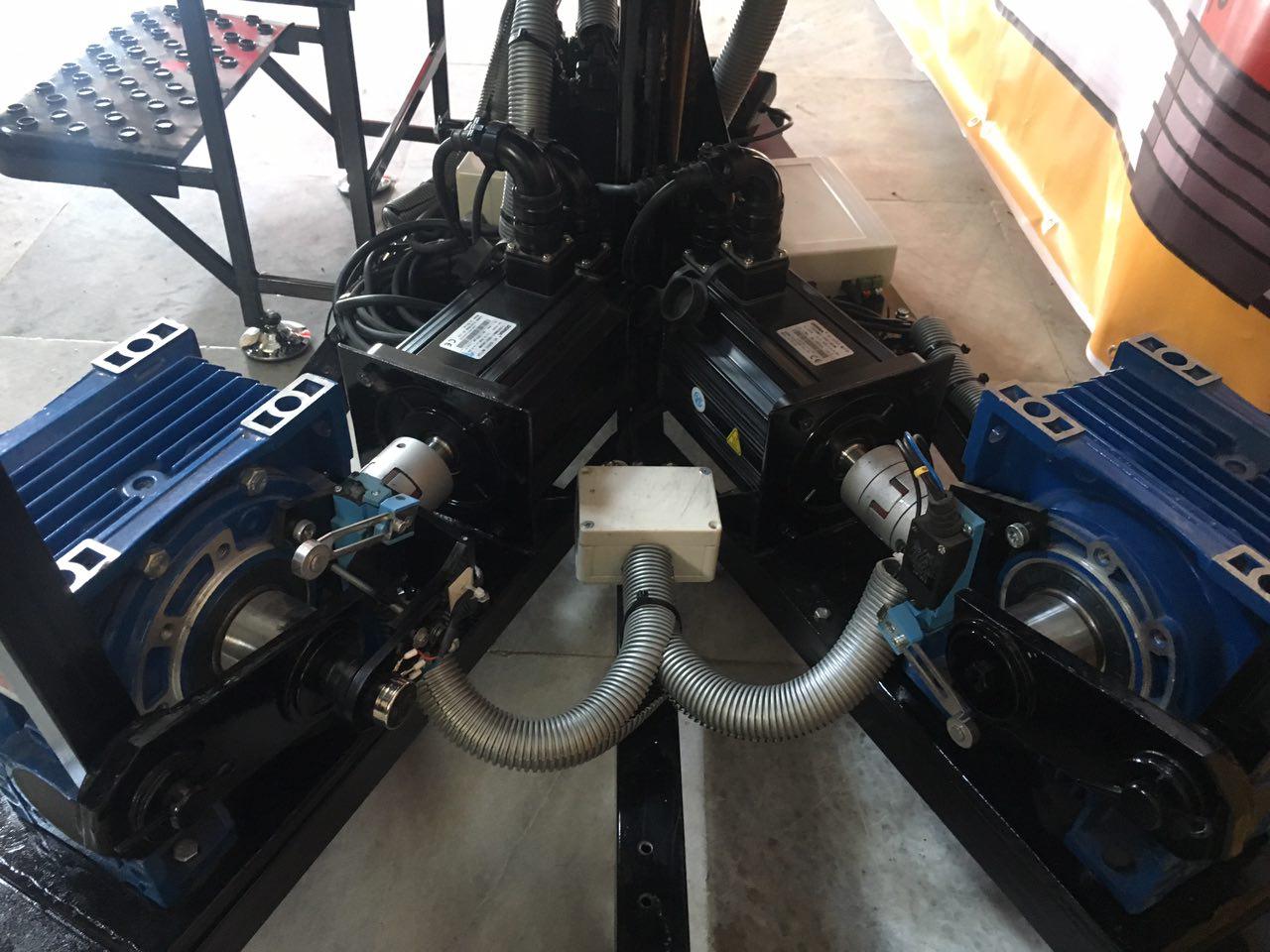

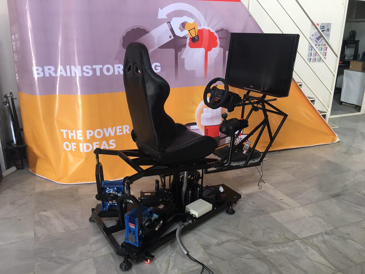

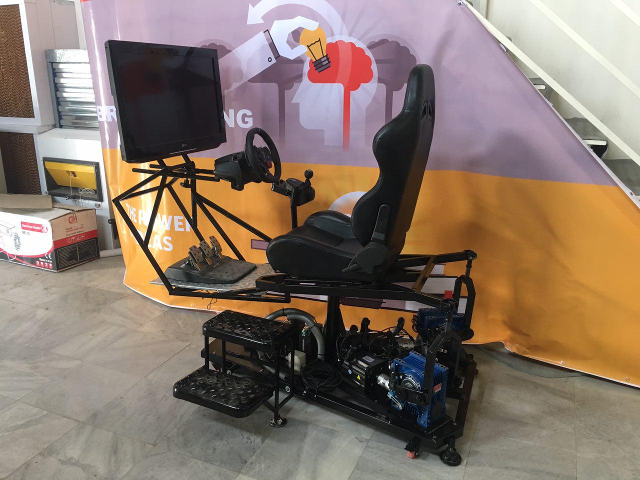

    Here is my 2DOF and i want to adjust setting and structure for the best performance in no limits rollercoaster. Some elements with steep slope may wont be simulated well in this design.

    So is your plan to use the motors and electronics but build a new frame, or something else?

    Looks like a nice build. :thumbs Did you do a build log? what motor and gear box's do you have fitted? Have you considered adding a third motor to the front for 3 dof?

    exactly, I am looking for the most proper structure for a real experience of rollercoaster and the best performance for mechanical parts.

    no building log yet, as i am just modifying the structure every week ;) , the next plan is the 3DOF model as you mentioned.

    I just realize that you still did not get an answer to your question in the initial post.
    What I would recommend (and what I already did by myself) is:
    • Add fans for simulating wind
    • Integrate a g-seat, at least for surge. In this way you have the pitch angle and the surge force separated, which in my opinion is essential for roller coasters and planes.
    • Use VR (if this lies within your budget). I am using an Oculus Rift, and for me it is great
    At the moment I have a 2DOF full frame rig with all these add-ons. I am close to starting a new rig, but it will again become the same type of simulator. I will just improve many details (use stronger motors, use stronger fans, make it much more compact, re-design the g-seat). Looking at your current structure, my first try would be to keep it and make the listed additions.
    Of course these are only my personal experiences, and you will probably get many others and different ones.

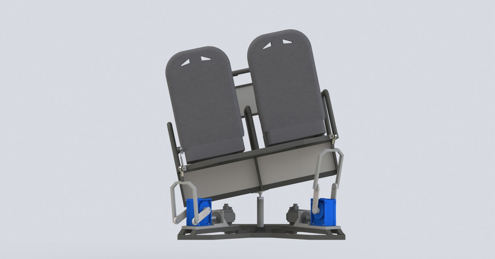

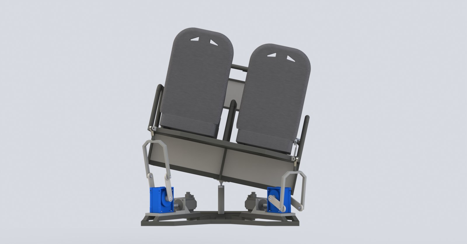

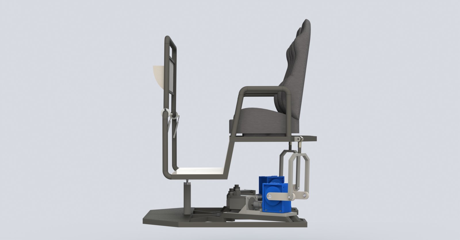

    This is my initial design for a dual seat roller-coaster that provides more movement!
