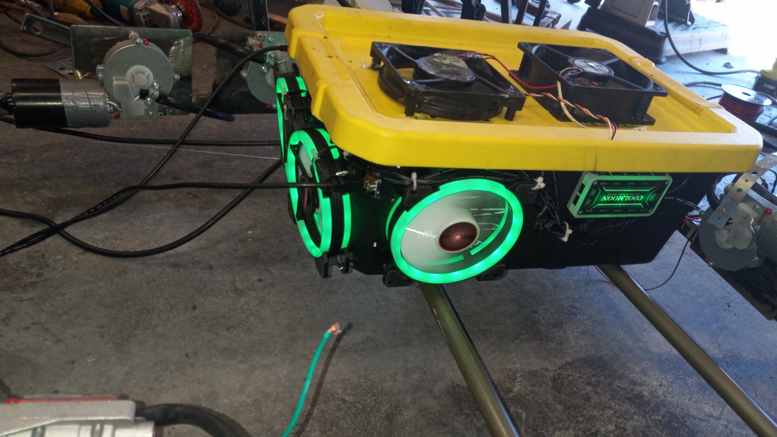

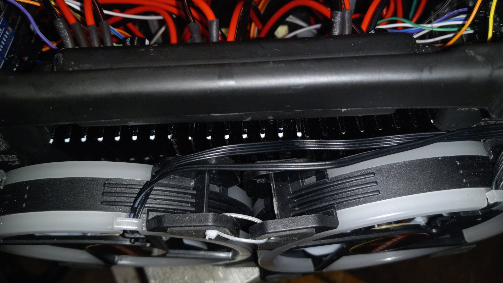

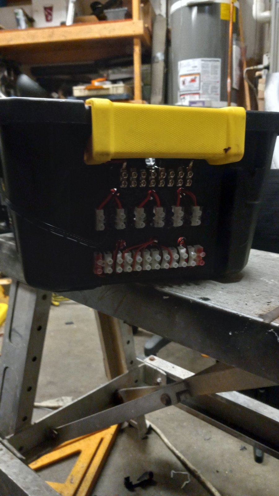

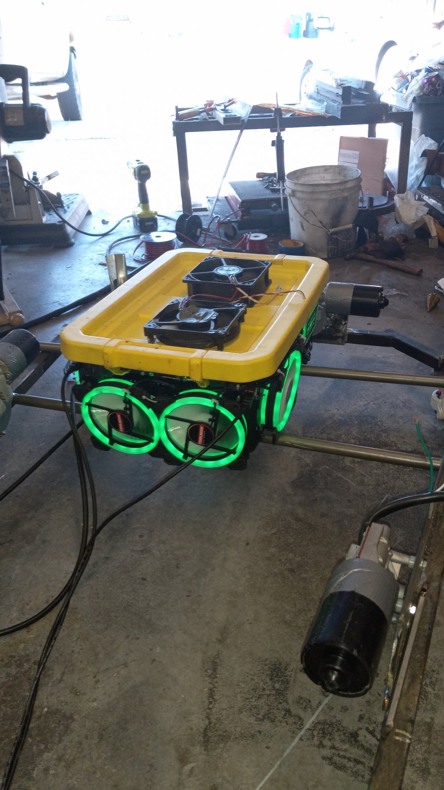

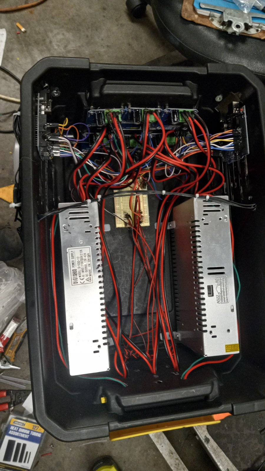

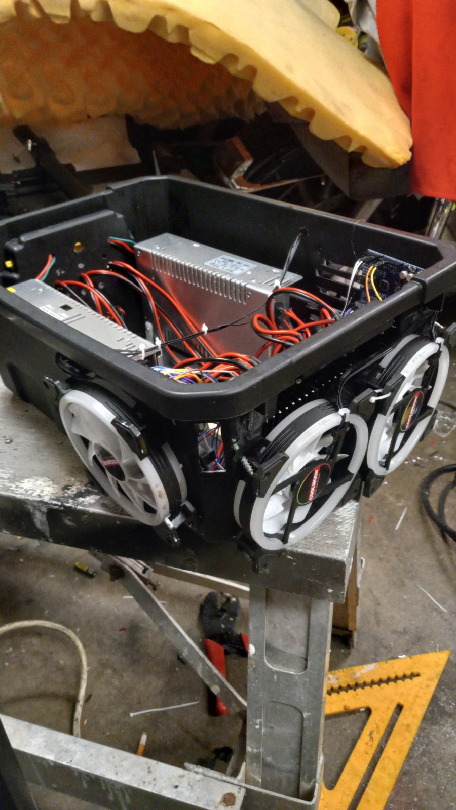

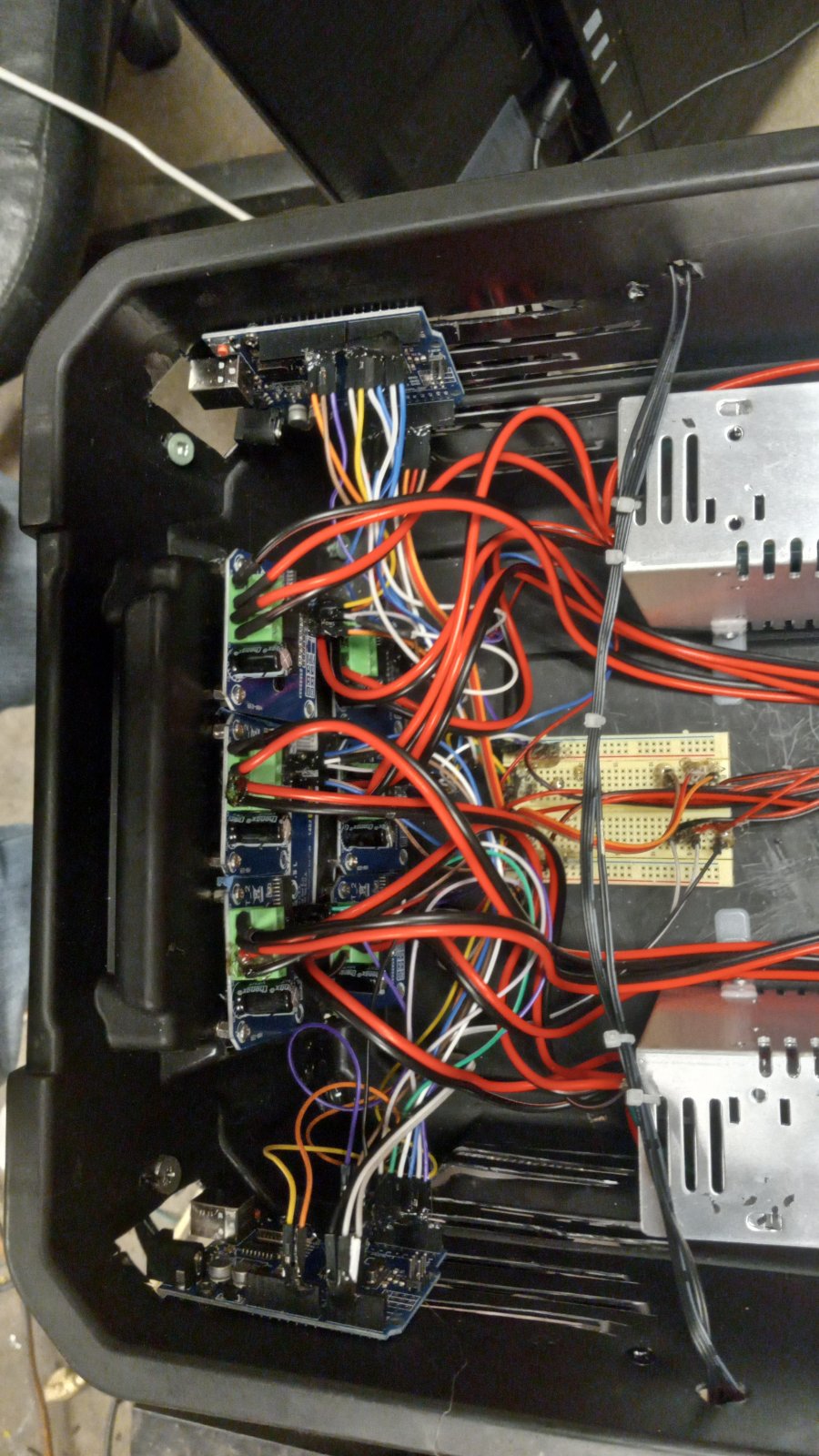

    Pics are of my rig and my motion box that took me a week to complete..lol
    But im happy with it so far.. 2 fans on the sides blow in and the two in front suck hot air off of the heatsinks that go thru the tub and the 2 on top suck out
    IF I COULD JUST FIND 6 MOTORS I CAN AFFORD GŔRRŔRRRŔ

    I cannot for the life of me get SMC3 to get control of all three motors at the same time like I can get one to spin but the other two either they won't turn on the only way I can get all three to turn on at the same time as I had to reverse the polarity of one of my motors motor number 2 and then they still don't work. turn on and nothing happens and then open the program again another time and then a different motor will move and then if I press the reset on my Arduino with smc3 open motor 3 start spinning out of control even if I put the pwmMax all the way back down it just keeps spinning even when it's at 0 it keeps spinning after hitting reset on the Arduino I can't I I Im really really losing my patience with this I don't know why it's not controlling the motors like it does for everyone else.
    20,520
    144,950Coins
    +10,770 / 52 / -2
    Is SMC3 set to Mode 2?
    Are the motors being used ground isolated?

    Yes. Im going to go out and hook everything up and run the program again then I'll take some screenshots I do have continuity between the positive and negative but that's just because of where the brushes touch the motor shaft so but I don't have continuity between the ground in the in the case or any wire between the the wire in the case

    I figured it out!! the position of my hall effect pots was wrong. I give them a Twist and then the motor start turning on and moving I get movement and control over so yeah yeah I had the position of my pots wrong. I haven't hooked up all three together yet but I am getting movement one motor hooked up at a time so I'm almost positive that once I do I hook all three of them up that they will work once I move all three pots.
    Thank you so very much @noorbeast for answering all my questions and trying to get me thru it. Im not done yetIll probly need you some more for SIMTOOLS lol. I told you that I'm a hardware guy I knew the software part would be a little bit of a battle but I'm getting there thank you very much
