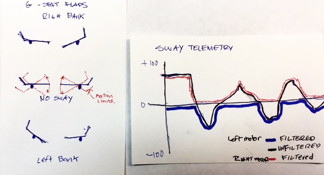

    Is there any way to filter simtools to do the following:
    Filter only DOF3(sway) keeping DOF1(surge) And DOF2 (heave) unfiltered.
    Making Axis 1 to output only negative and Axis 2 to output only Positive??
    Lets say a take a left curve:
    I want the right flaps (Axis 2 Dof3) to rise
    and
    the left flaps (Axis 1 Dof 3) to remain flat and not to depress.

  5. SimPotato
    SimPotato Member
    May 17, 2017
    47
    Designer
    Gardiner, NY USA
    479Coins
    +53 / 0 / -0
    These two pictures will help visualize the challenge.... Untitled-1.jpg 1.jpg

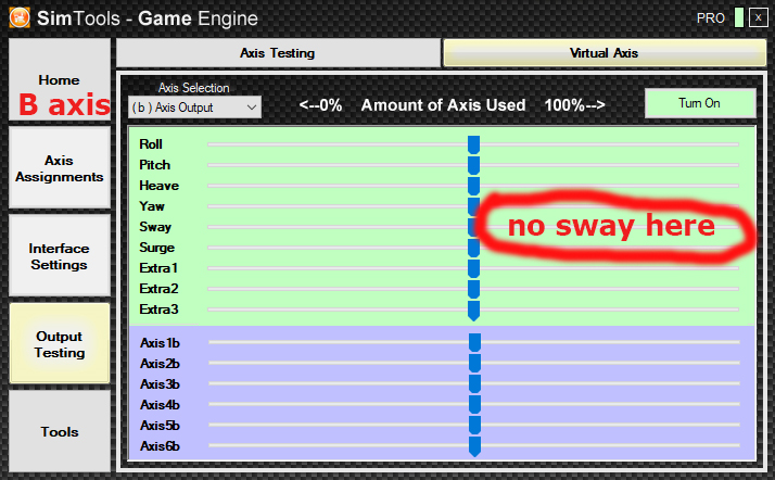

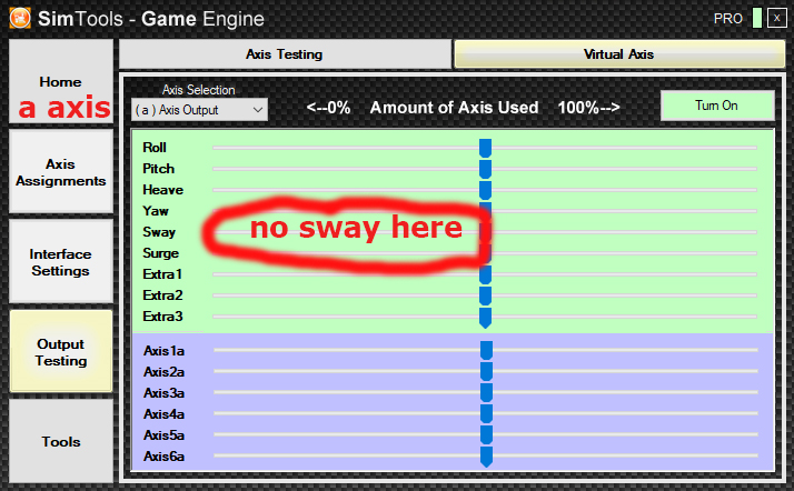

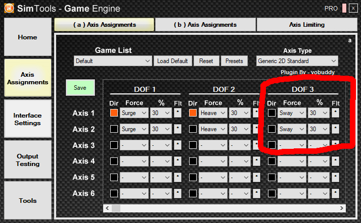

  8. yobuddy
    5,399
    50,580Coins
    +5,159 / 19 / -0
    Hi Guys,
    We should be able to do this without modified plugins like this. :cheers
    First Game Engine needs to be in "Expert" mode, this gives us separate Min/Max files for both (a) and (b) Axis Assignments.
    Then setup you axis assignments like this.
    Notice this is the - (a) Axis Assignments.
    Notice this is the - (b) Axis Assignments.
    Then in Tuning Center, make sure both sets of Min/Max settings for (a) & (b) Axis assignments are the same, except for sway.
    For (a) Axis Assignment use a sway like this.
    And for (b) Axis Assignments use a sway like this.
    What you have essentially done here is turn off sway in one direction for each axis (the 0 turns them off in that direction.)
    Now all you have to do is change your interface output.
    Wherever you are using <Axis2a> Change it to <Axis2b>.
    With this example above, all game plugins should be usable without modification.
    If anything in the example needs more explaining, let me know!
    Take care, :thumbs
