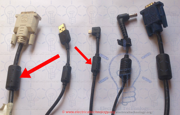

    For my new project I'm thinking about switching all the wiring inside the metal frame:
    In short.
    - cables from 220V to 12V 50A power supplies
    - cables from power supply cards JRK 12V12
    - cables from JRK 12V12 cards to engines
    - signal cables from JRK 12V12 cards potentiometers
    - USB cable (mini-b - usb) from JRK 12V12 cards to pc
    In which of these cables suggested me to place the ferrite in order to avoid the risk of interference? At what point in the cable should position it?

    All cables ... and should be placed nearest to the device being protected or mostly affected with interference .

    But for example the cable from cards jrk to pot where is better put the ferrite? near pots or near cards jrk? In the cable minib - usb from card jrk to pc is better put ferrite near jrk or near pc (near minib or near usb)?

    You should use ferrite near to the jrk card as it is the active element, the pot is not active ... it is passive .
    and for the PC and the jrk ... more ferrite on both sides is better ...
