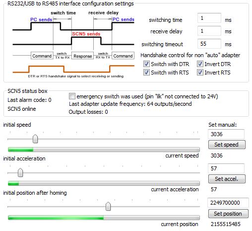

    I would like some input on where you guys think I need and can improve my simulator. I don't really know where to start.
    If you take my SCN5 plugin settings:
    USB to rs485: ( I guessing this default )
    switching time: 3 ms
    receive delay: 3 ms
    switching timeout: 70 ms
    ( Where do I see my outputs you guys keep compairing. Is it on the main profiler page?
    USO engine outputs and synaptrix outputs)
    current speed: 50%
    current acceleration: 50%
    current position: 50%
    The rest of the setting are from bvillersjr profile for Race07
    Ferrari_man
  7. Ringorumble
    Ringorumble Active Member
    Jan 20, 2008
    178
    190Coins
    +48 / 1 / -0
    For me it is much to fast, like the most of all the profiles and videos. Too much bumping around and shaking and all.
    I use
    Actuator Speed 3000 (~16%)
    Actuator Accel 53 (~5%)
    switching time: 1 ms
    receive delay: 1 ms
    switching timeout: 50 ms
    Polling 1 ms
    You can see the output if you leave the SCN5 Plugin open.

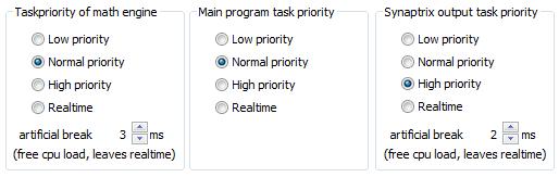

    Thats is correct. Lower your settings as shown above. Also reduce the artificial breaks in the Profiler application settings to matcvh the number that you set in the sender settings. I personally think that 1ms is unnecessary because I dont think that the game updates that often, so you would just be wasting processor resources and increasing the likelihood of poor game performance.
    I would suggest what Ringo stated above, except use 2-3ms in the sender setting and sett your artificial breaks the same. Also, if you find that you loose connection to your actuators using the above settings, try 1ms, 1ms, 60ms instead.
  9. Ferrari_Man
    Ferrari_Man Member Gold Contributor
    Jul 17, 2007
    107
    Copenhagen
    - 5Coins
    SCN5, SimforceGT

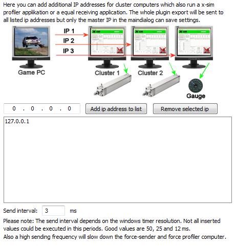

    Hey and thanks for your inputs.. they are really helping me understand how it works.
    I have tried the settings Ringorumble posted.
    Here are some picture of the setting just to be sure.
    And here is at video of it: I think it is a little to slow. But look at the video
    http://www.youtube.com/watch?v=ewaJyjCwIUY
    I am only getting around 60 outputs is that enough.

  14. bvillersjr
    bvillersjr Active Member
    Oct 11, 2008
    1,174
    Ohio, USA
    438Coins
    +23 / 1 / -0
    This movement could not possibly have been produced by my profile under any circumstance. The movements are significantly delayed and poorly represent almost every category that I evaluate a profile on. You can find my evaluation criteria here: http://www.x-simulator.de/forum/criteria-for-evaluating-a-profile-s-realism-t1279.html.
    All of these things are of course a matter of personal preference when it comes to fine tuning, but there are some basic elements that should exist regardless. For example, your video shows some cases where you have been out of the corner for some time, yet your actuators were still in the process of moving you back toward center. Also, there are scenarios where you were finished braking, yet the actuators were still going forward. The amount of time it took once you accelerated for the actuators to retract was unrealistically slow. I won't continue on with the list, I think from your above post that you can feel what I am talking about.
    To give you some idea of what it is like in a real F1 car, the g-forces under braking are so severe, that you have to time your braking with your breathing because the force of the seat belts on your chest forces the air out of your lungs! I realize that in a simulator, that we are not trying to create that level of realism, but an F1 car shouldnt feel like a Sunday drive with grandma either ;D
    Now you know why they have driver swaps at endurance races. It is a true test of both man and machine (Physically and mentally). I wish that I had a set of 100mm actuators so that I could be more helpful.
    The only helpful advice that I can offer since I do not have 100mm actuators is:
    -Get your updates per second to at least 150 before making any further profile evaluations. It will make a difference. RingoRumble was right. Try switching with all 4 checkboxes unchecked and see what you get then.
    -Then Go back to my original Race 07 profile and up the percent limiters on the left and right math to 99%
    -If the movement is too harsh, go into the output section and reduce the left & right actuator acceleration values in small increments until you achieve your desired effect.
    Best of luck, and sorry I dont have more helpful input for 100mm users.

  19. egoexpress
    egoexpress Active Member
    Dec 13, 2006
    3,839
    Germany - Frankfurt/M
    421Coins
    +10 / 1 / -0
    The actuator speed is definately an individual matter of taste. But the accelleration NOT! The accelleration of the actuator is dependant on Profiler outputs and driver weight, nothing more. If the perfect value is found once, the accelleration in the SCN5 plugin is never changed again.
    If you have found the perfect accelleration value and you may find the movements too hefty, then you have to adjust it in the effect math by increasing or decreasing the max value in the math effect editor.
    The perfect accelleration value is found, when your actuators move with dynamic speeds without judder and lag.
    To set the accelleration in the SCN5 plugin right, use following procedure:
    If the actuators judder when moving slowly, then the accelleration has to be decreased.
    If the actuators produce lag, the accelleration has to be increased.
    Ferrari_man
    I think an accelleration of ~50 may be too slow. Leave the speed as it is, and just try to incresase the accellertion to a point, where the lag disappears.
    Regards
    Christian
