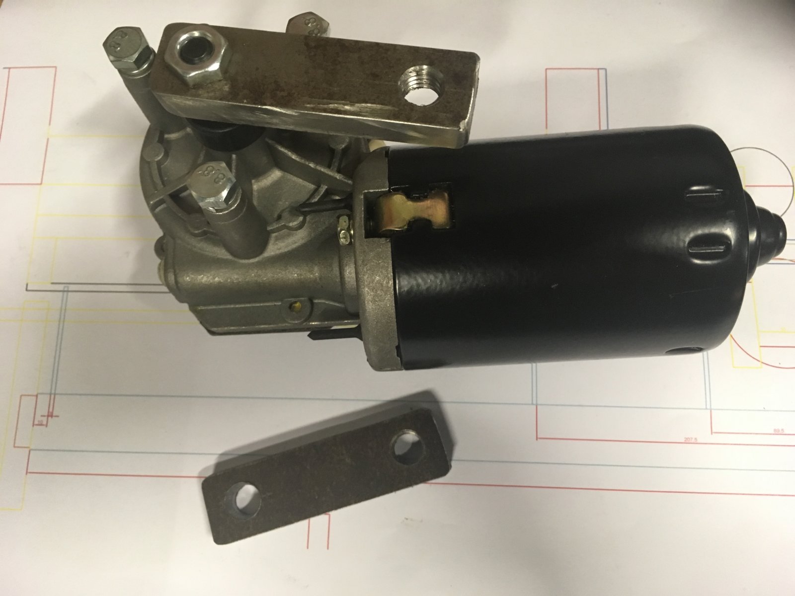

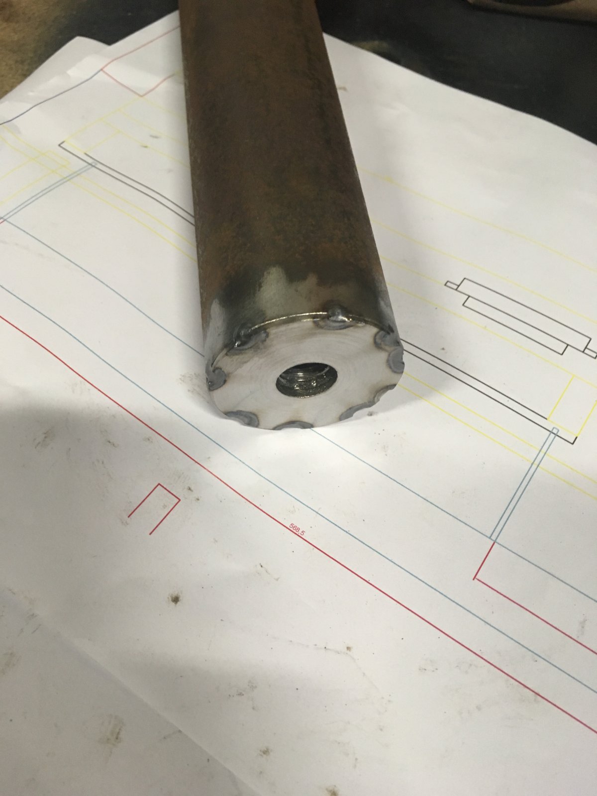

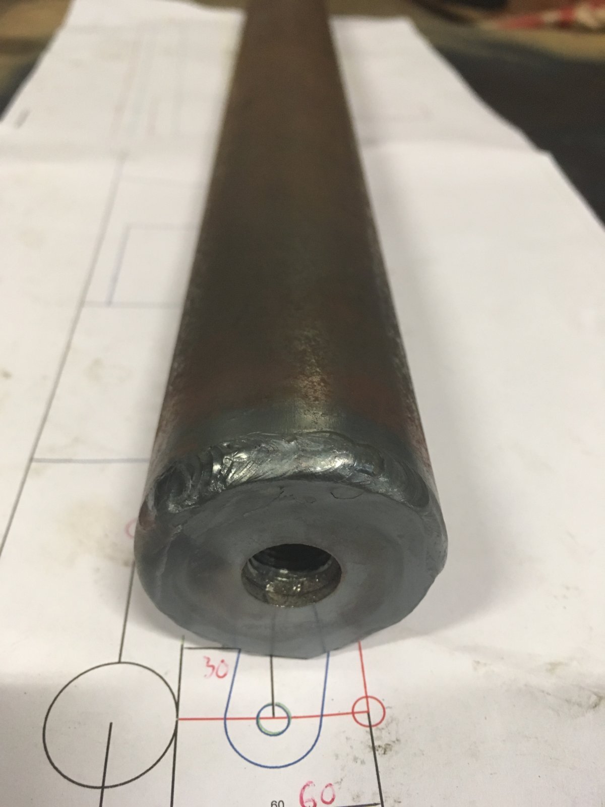

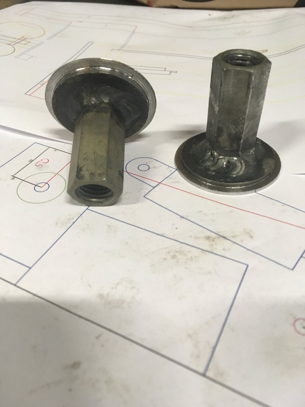

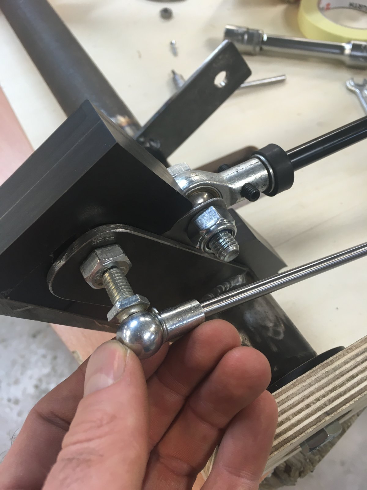

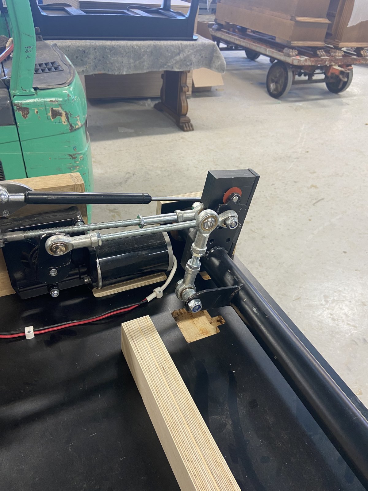

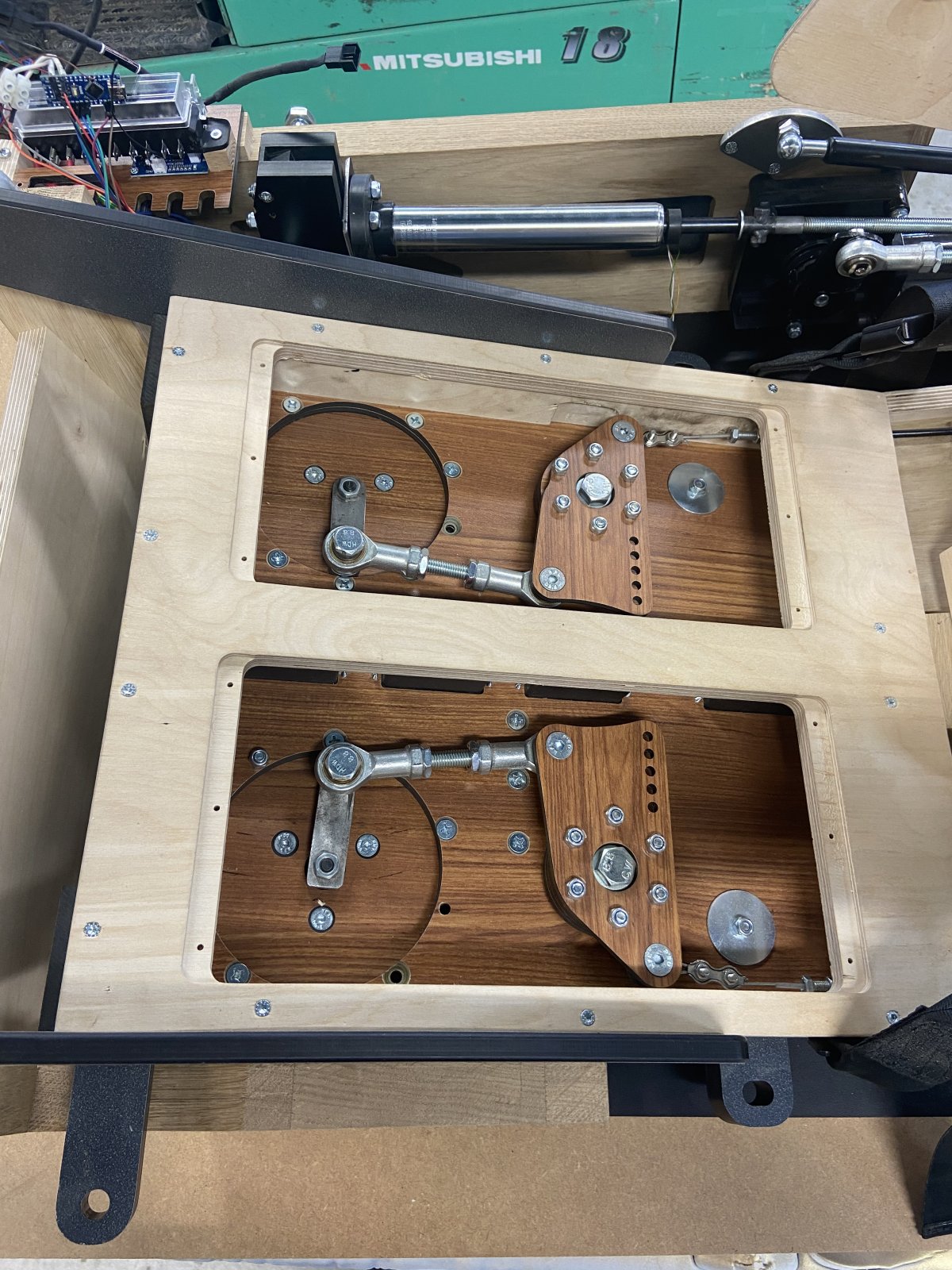

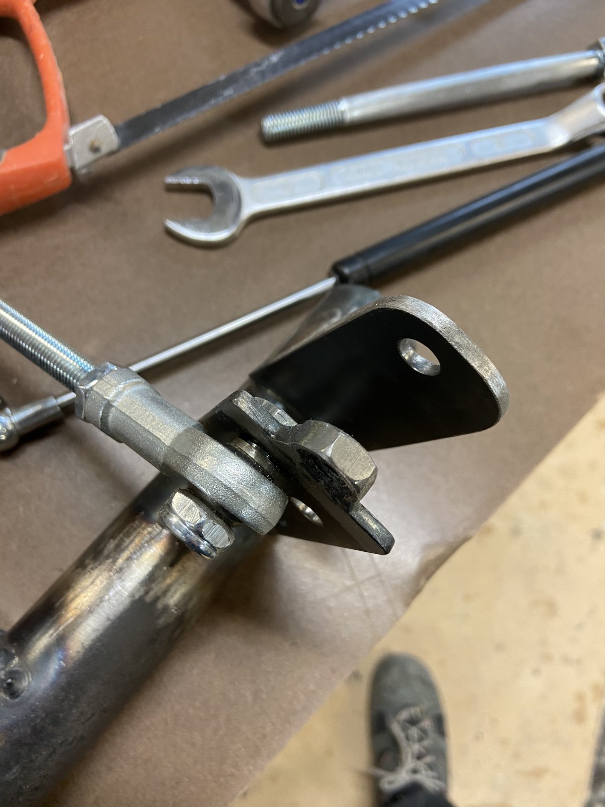

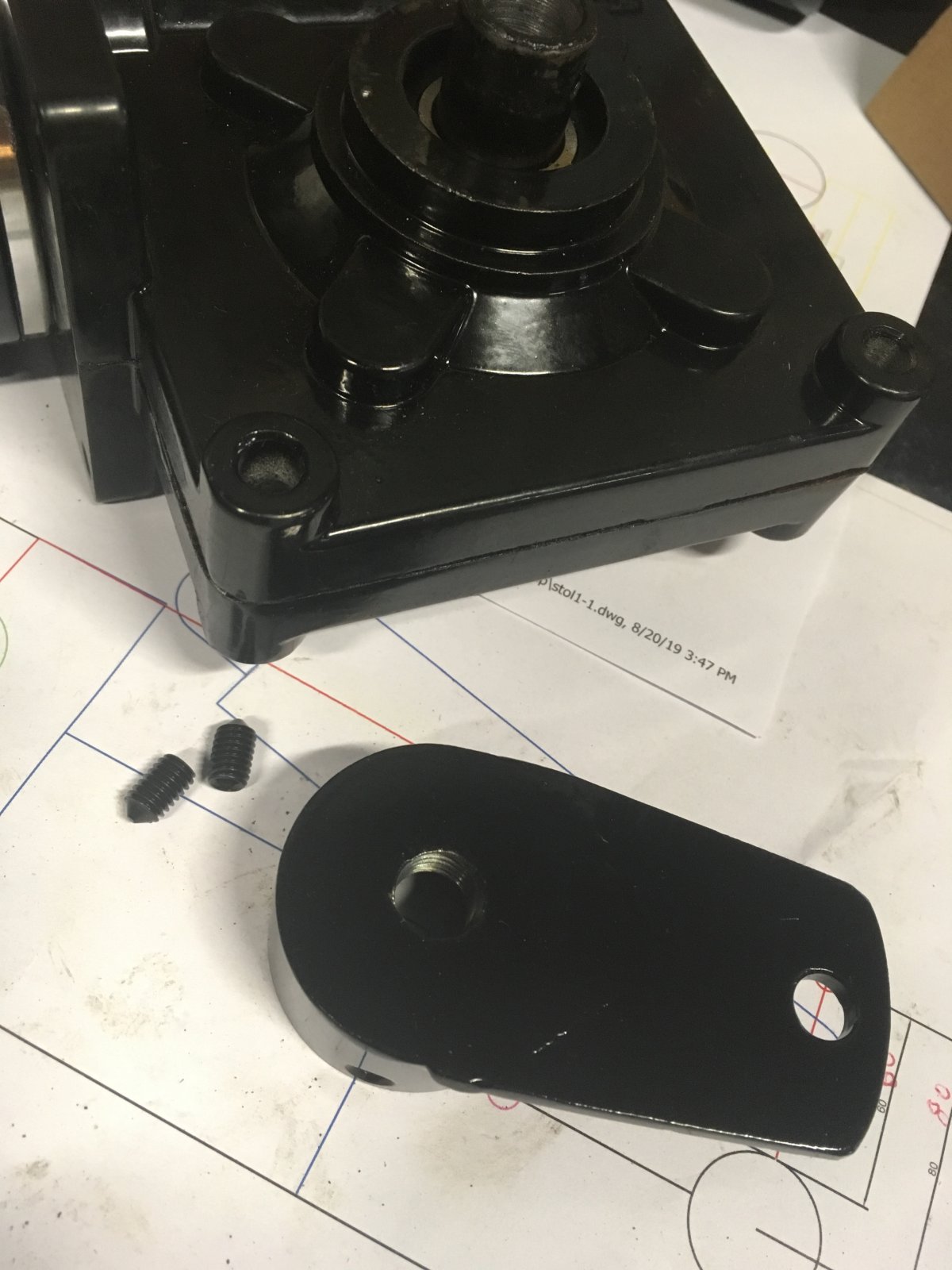

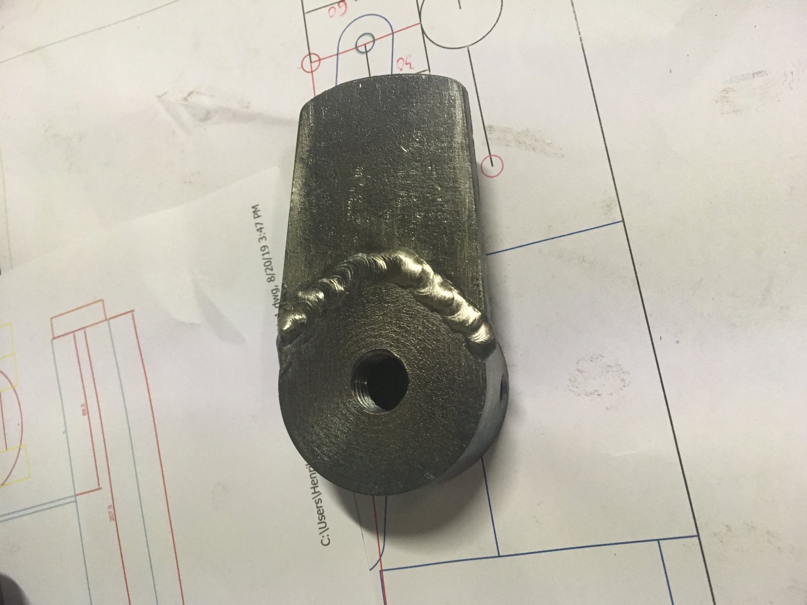

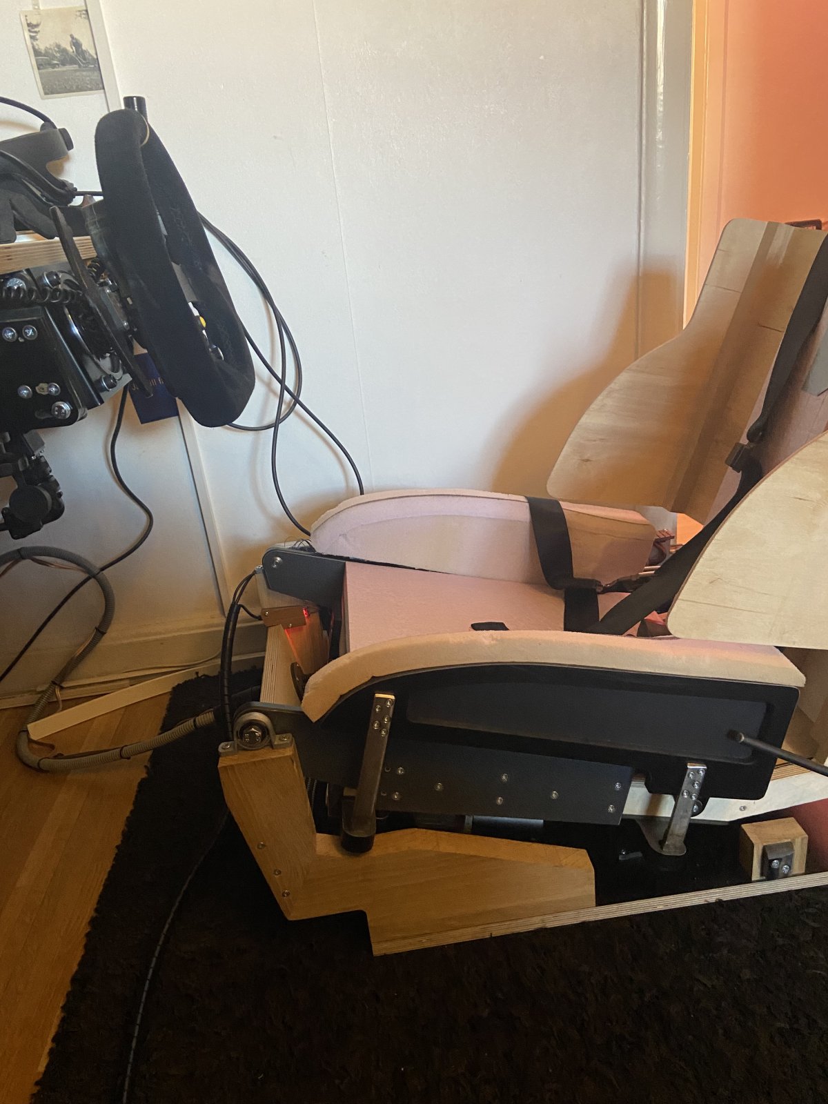

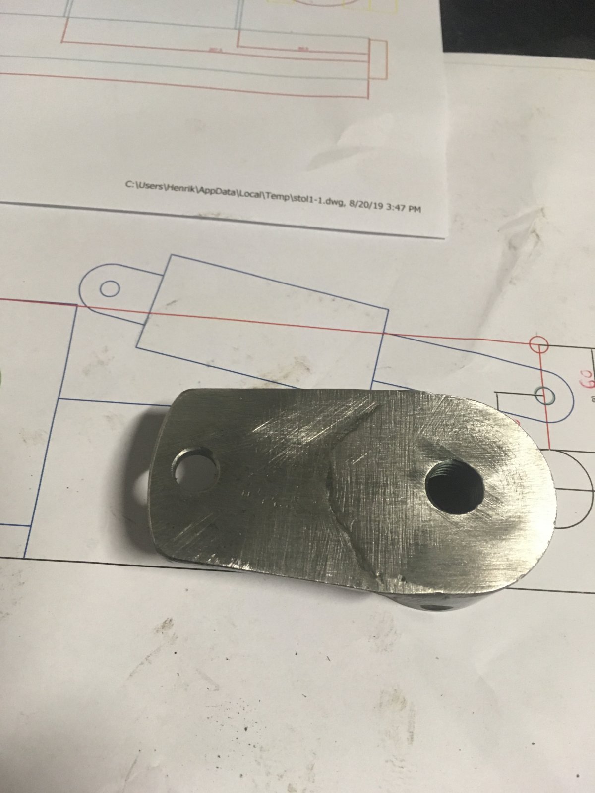

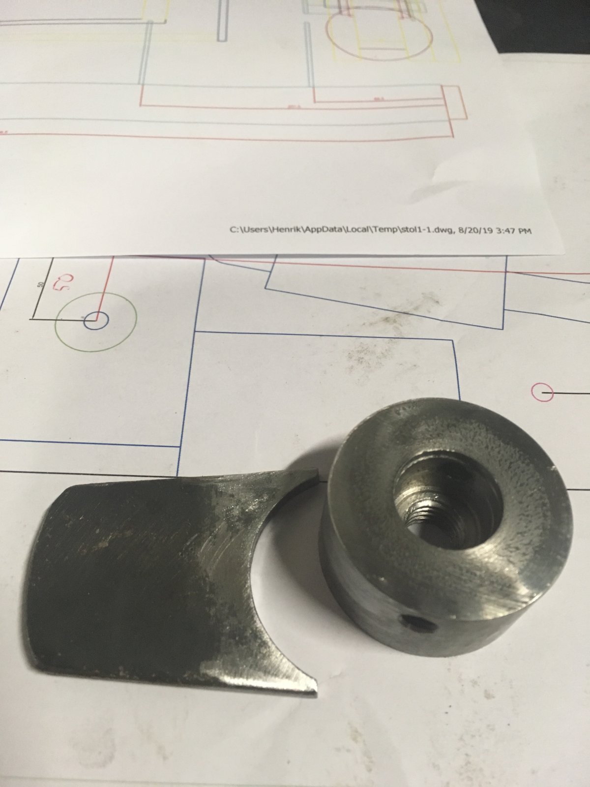

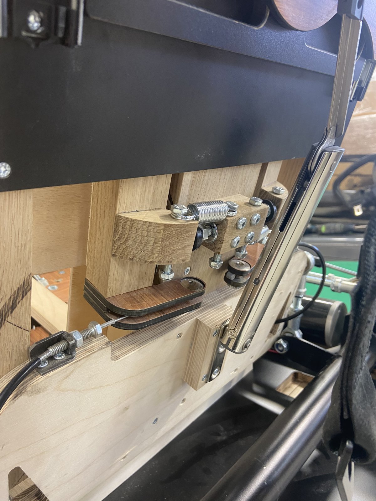

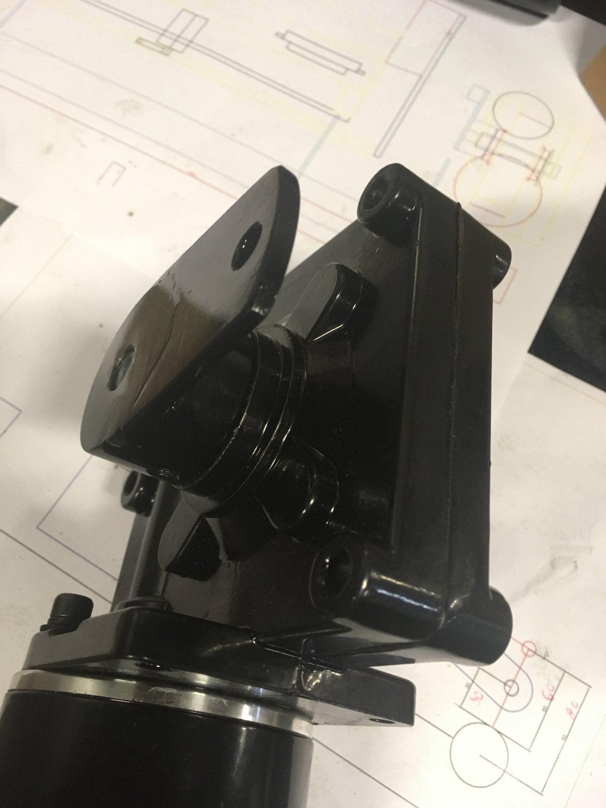

    I have finally begun the manufacturing of som parts for the chair :)
    Yeah, the arm on the large motor could be a bit longer.. :rolleyes:
    The last pic is the very expensive and over complicated weldingtable iv used for the arm :D
    I am still working on the design in cad, but som parts are starting to come together.
    The concept is somewhat unusual..
    IMG_4037.JPG IMG_4036.JPG IMG_4038.JPG IMG_4039.JPG IMG_4040.JPG IMG_4042.JPG IMG_4043.JPG IMG_4044.JPG IMG_4045.JPG IMG_E2809.JPG

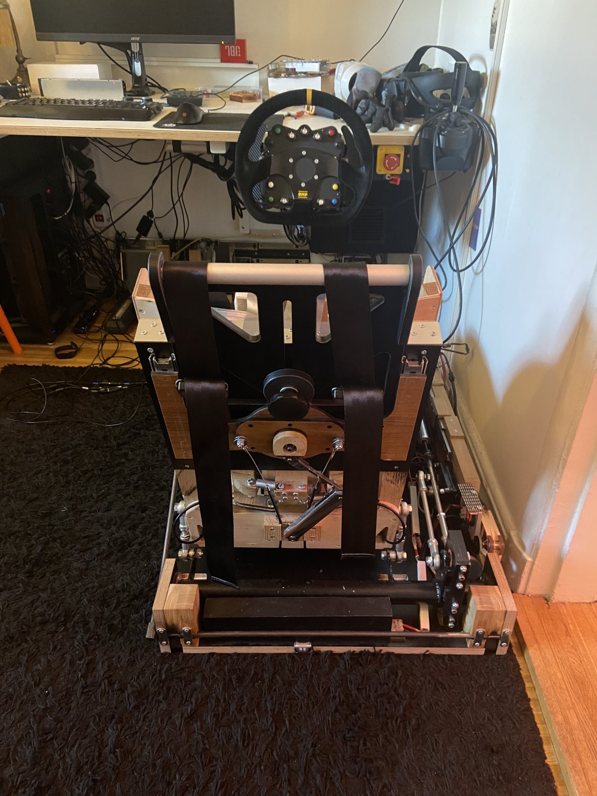

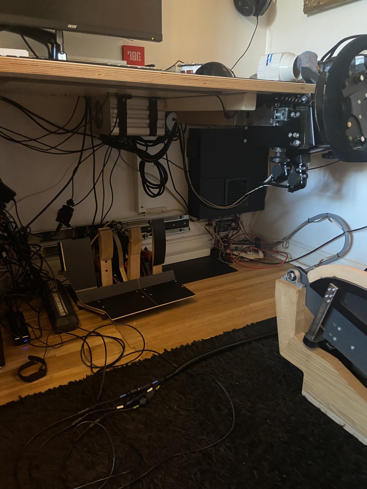

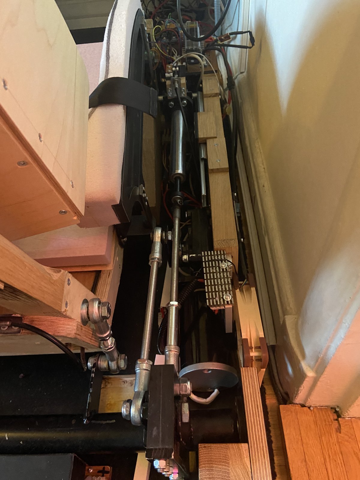

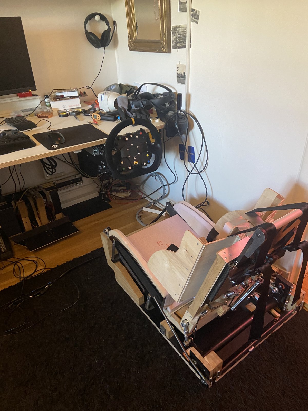

    Thank you for your interest in my endeavor with this projekt.
    I will try to explain my thoughts.

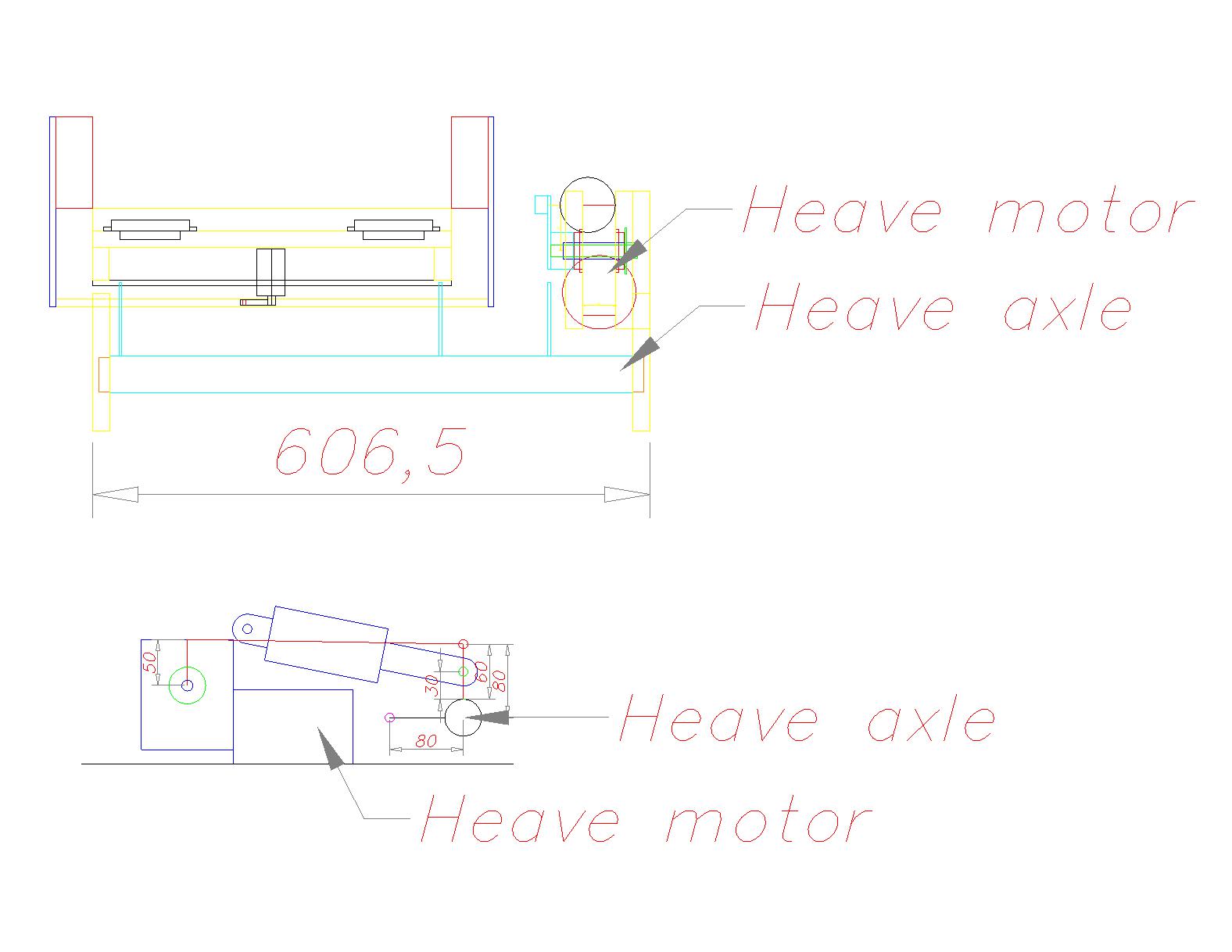

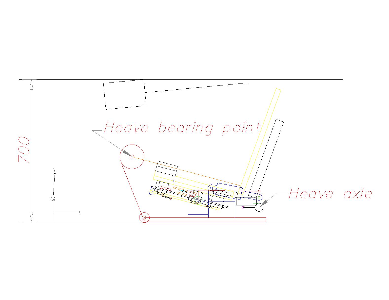

    I have actually ditched the foldable part of the chair ( i will change the sign) . But it will fit under the desk.
    Here are some pics from early CAD sketching.
    First pick, chair from side under desk.
    Second first, is seat from behind, and last second is the motor with axel, arms, and a spring.
    The heave motor is on the right side of the chair connected to a heave axel.
    The chair has a bearing on each side of the knees, and the heave axels arms are attached under and behind the butt.
    The travel under the but is 50mm upp and down.
    The idea is to have the chair under the desk, and pull it out when needed, and the wheel mounted on a "drawer" to pull out as well.
    I hope i am making my ides a bit clearer, for those who are interested :)

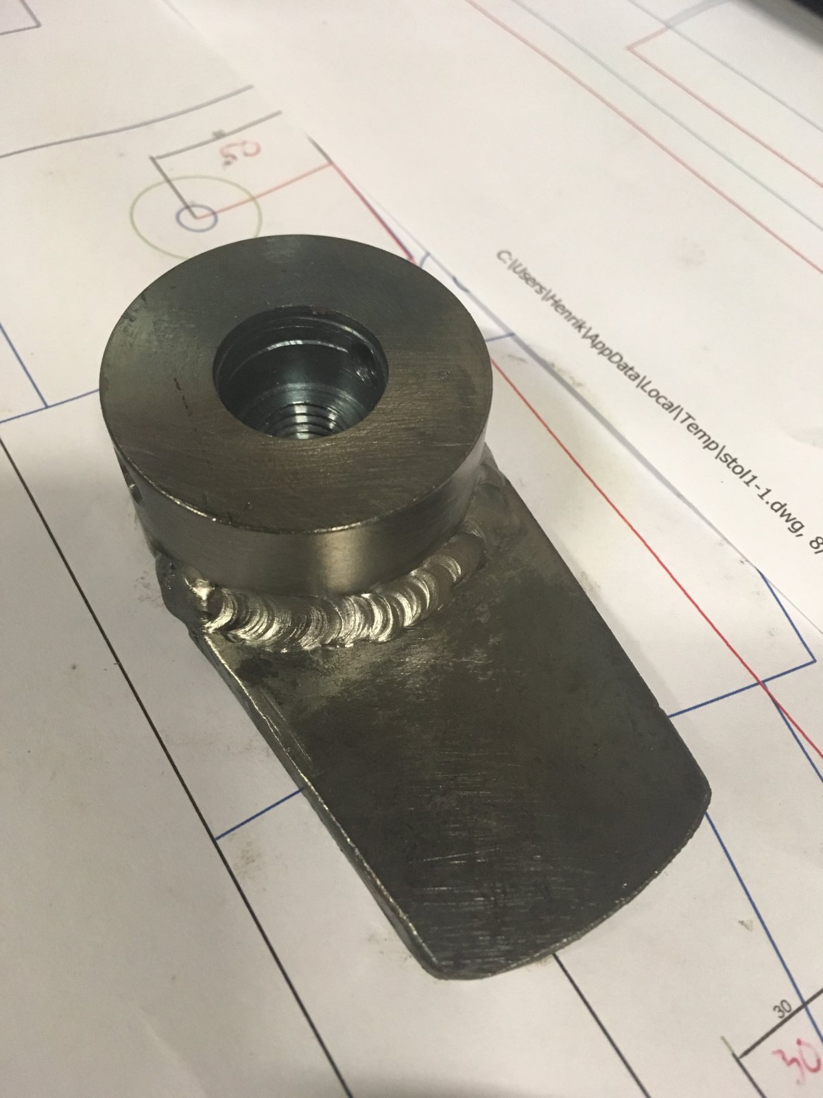

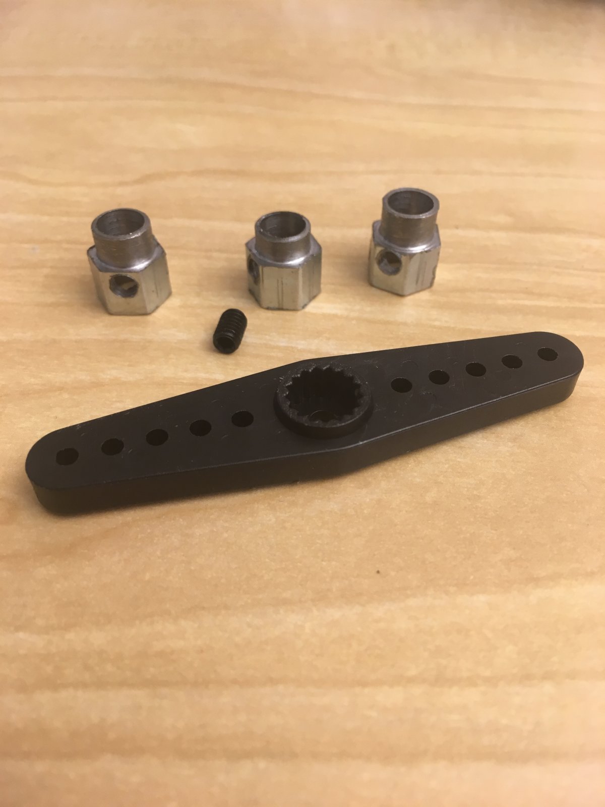

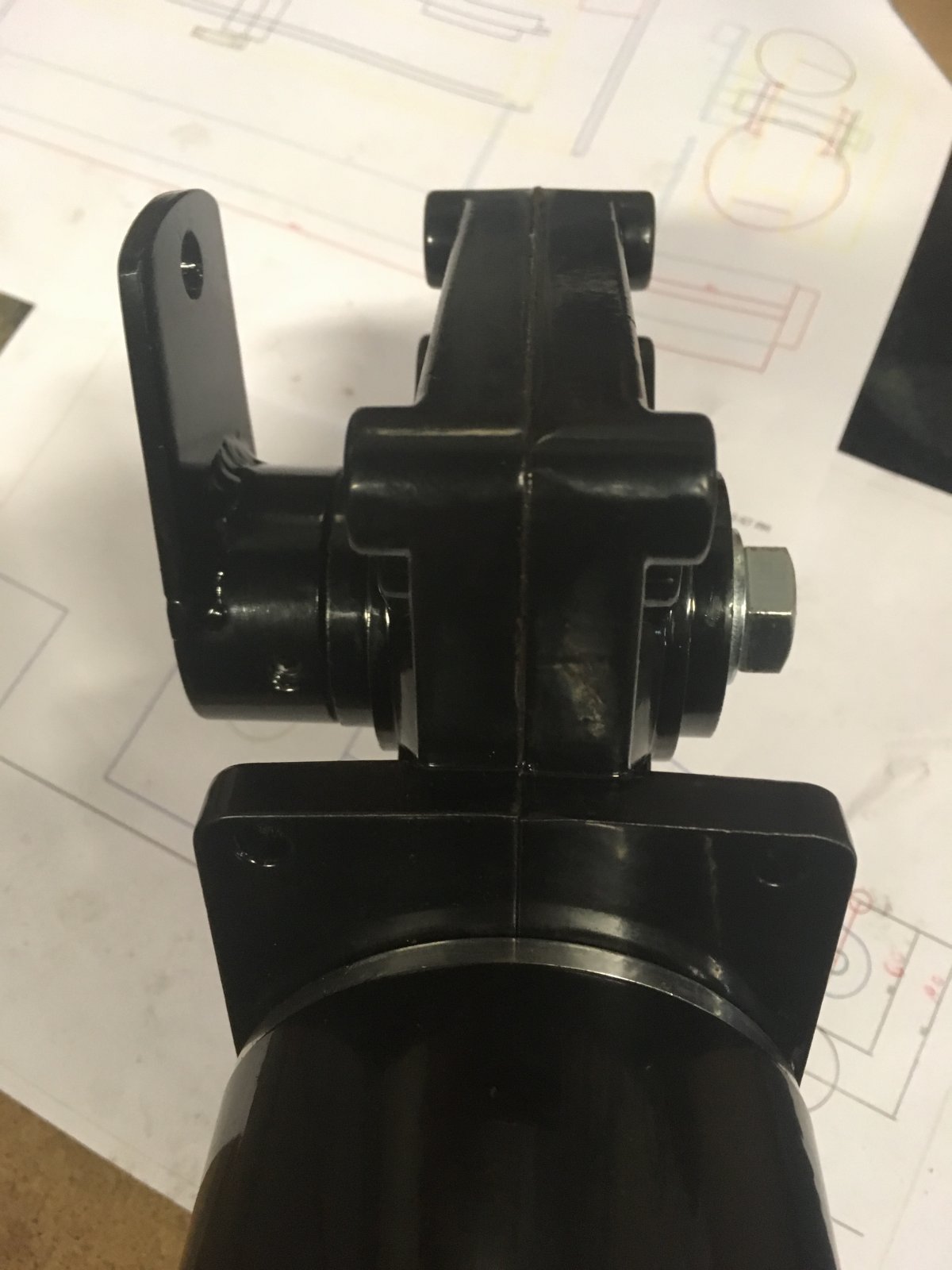

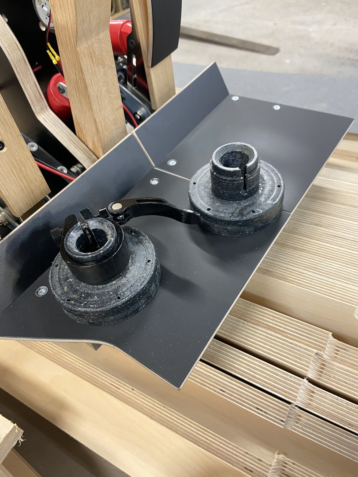

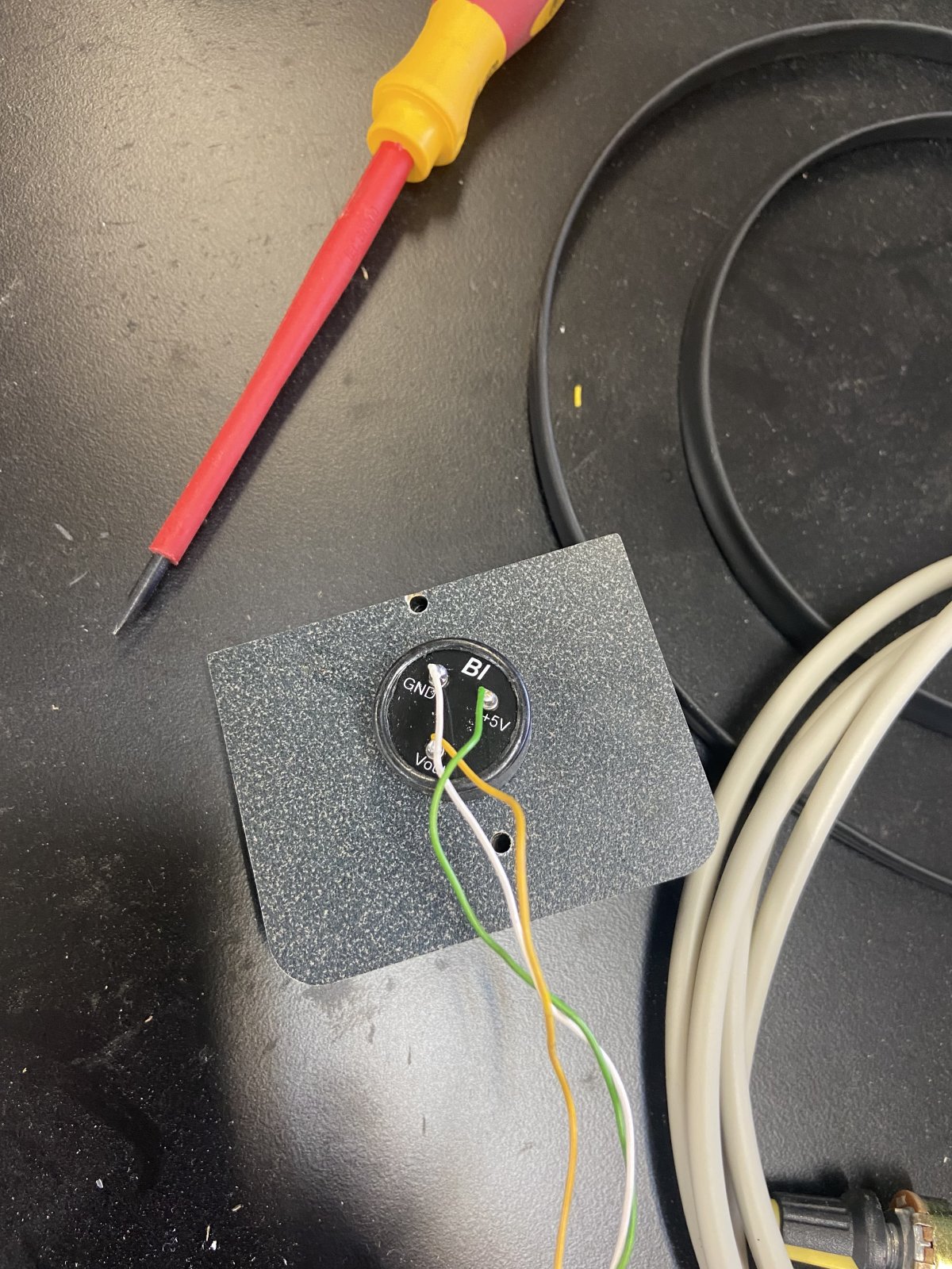

    Here are som pics of the ongoing produktion of the heave axle

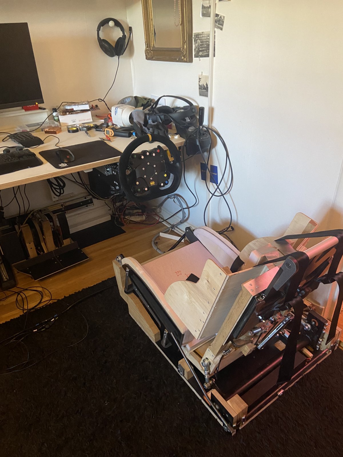

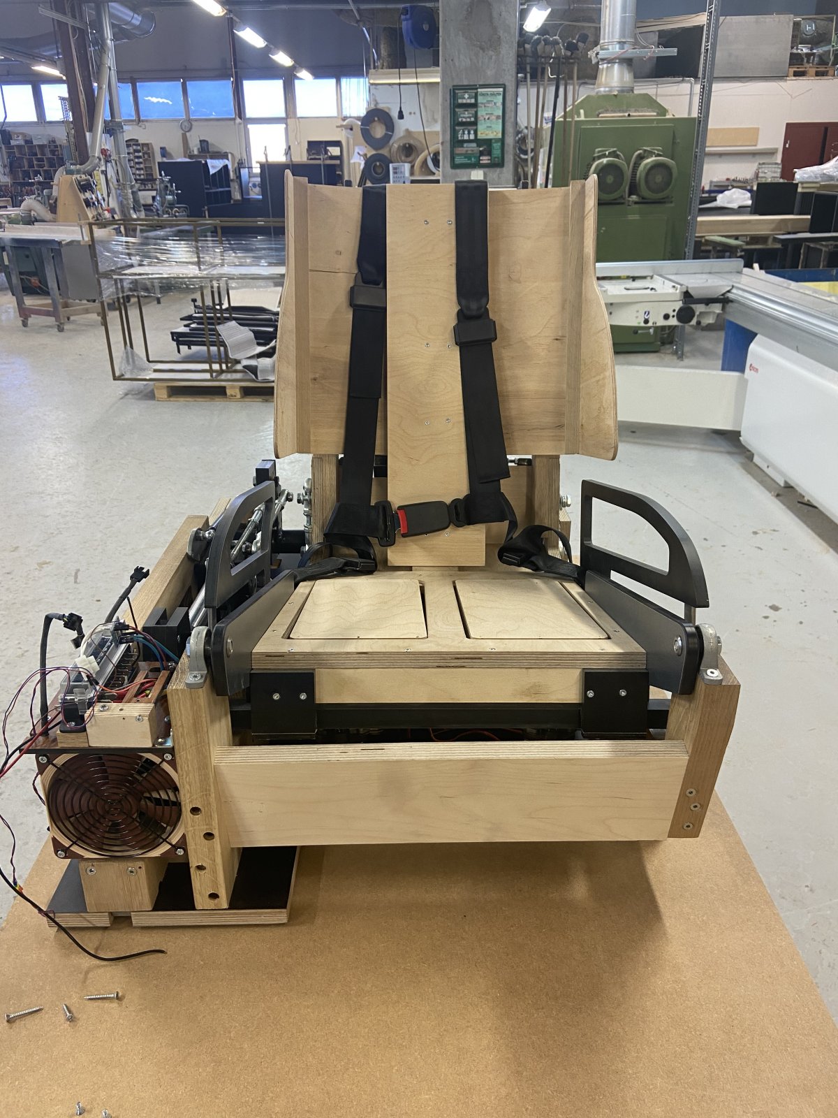

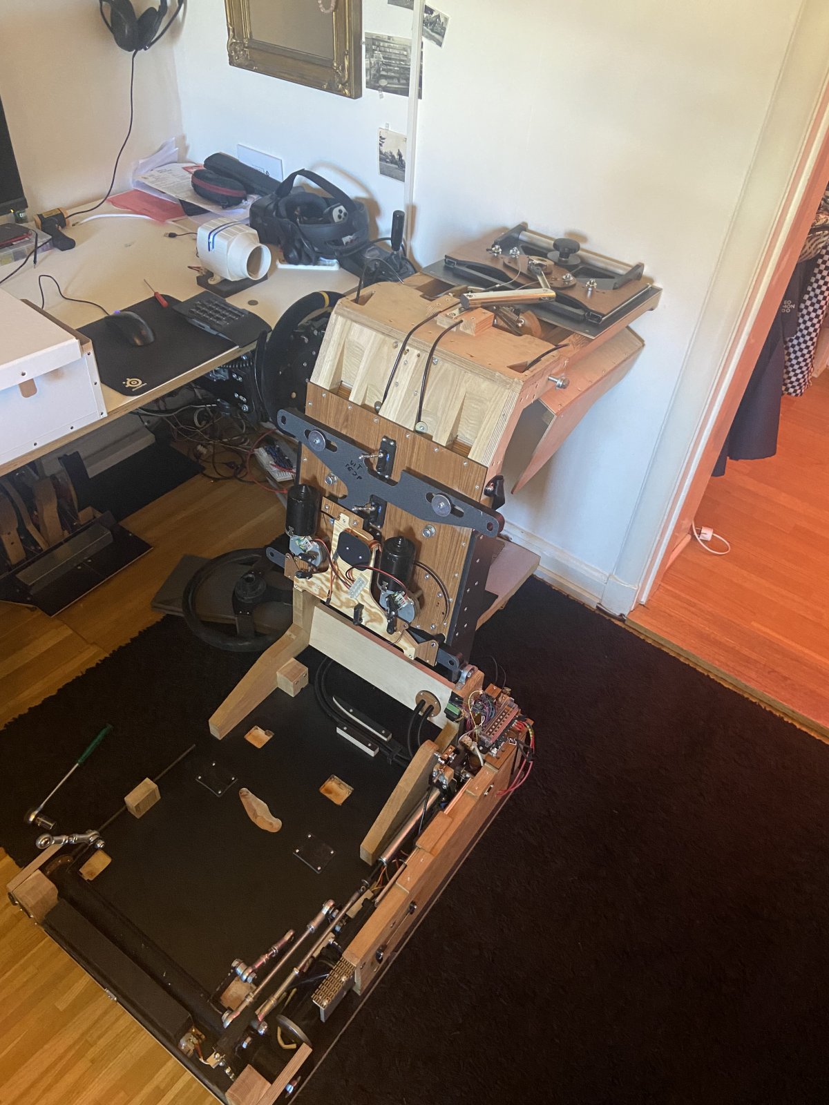

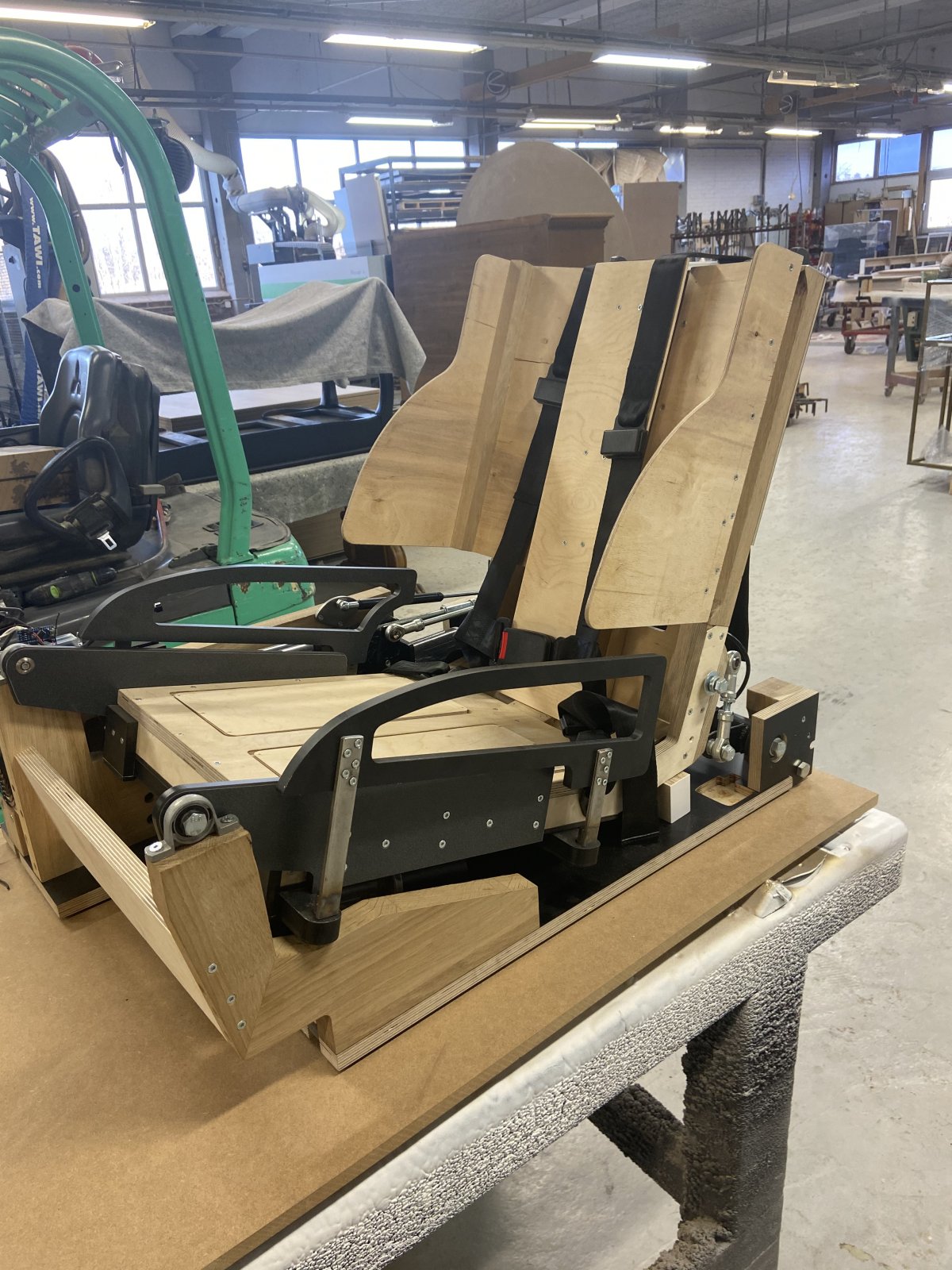

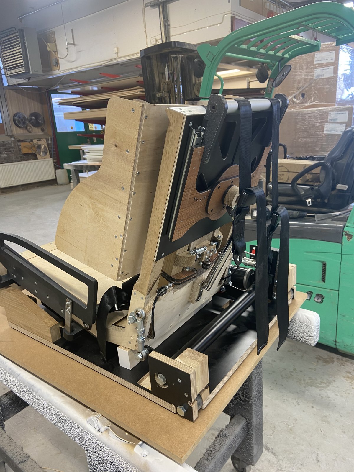

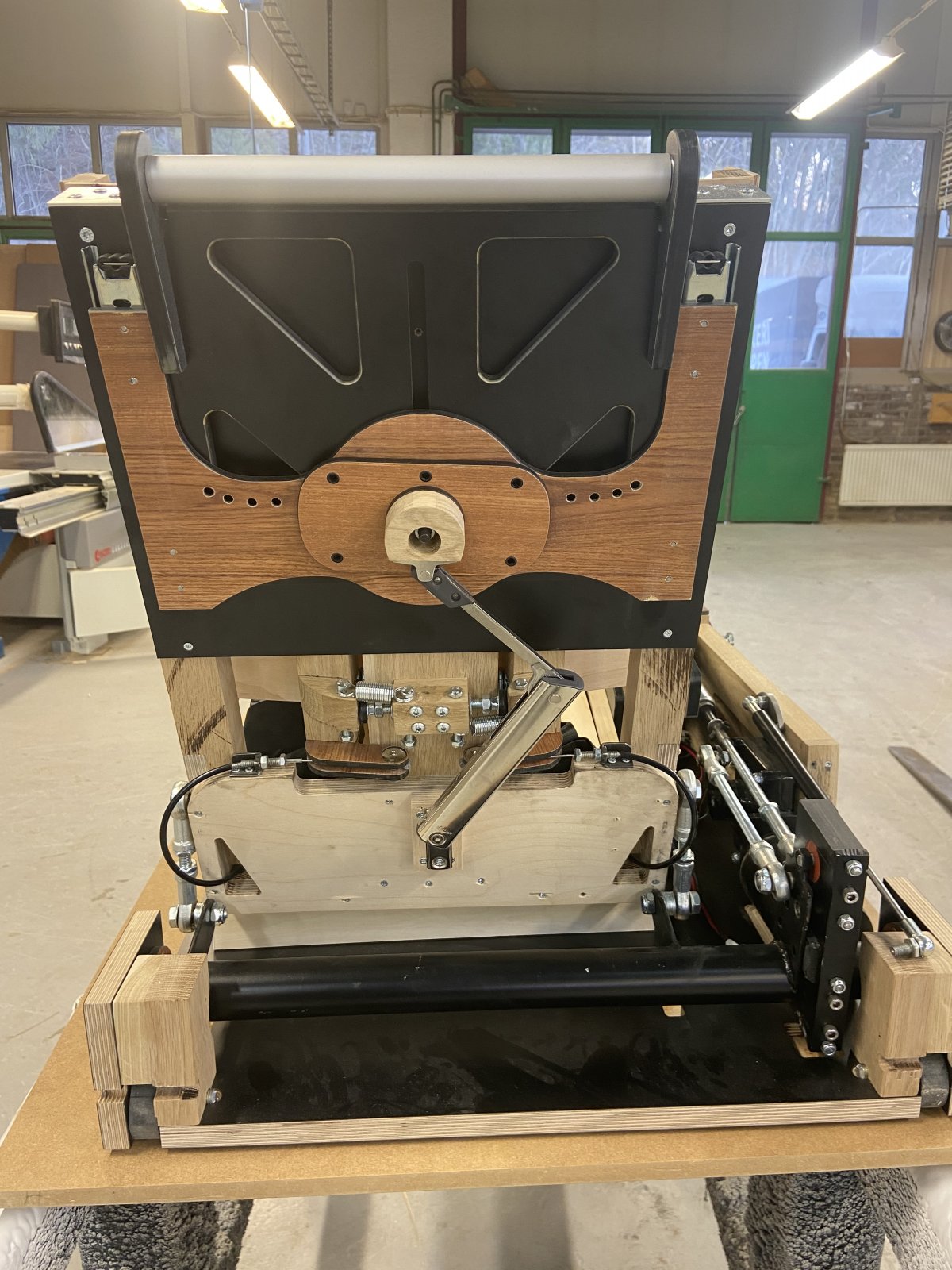

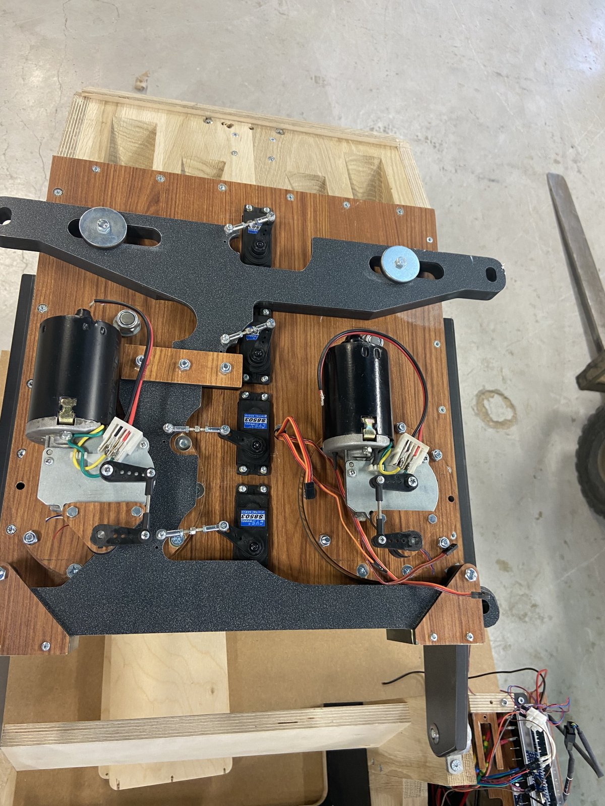

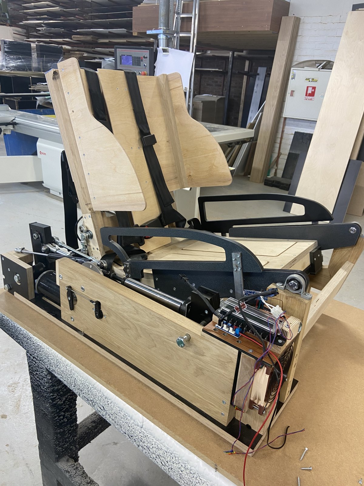

    Progress!
    IMG_4037.JPG IMG_4162.JPG IMG_4203.JPG IMG_4660.JPG IMG_4749.JPG IMG_4890.JPG IMG_4891.JPG IMG_4929.JPG IMG_4930.JPG IMG_4931.JPG IMG_4932.JPG IMG_4933.JPG IMG_4934.JPG IMG_4935.JPG IMG_4936.JPG IMG_4937.JPG IMG_4938.JPG IMG_4967.JPG IMG_5092.JPG IMG_5237.JPG IMG_5249.JPG IMG_5265.JPG IMG_5266.JPG IMG_5267.JPG IMG_5268.JPG IMG_5269.JPG IMG_5270.JPG IMG_5271.JPG

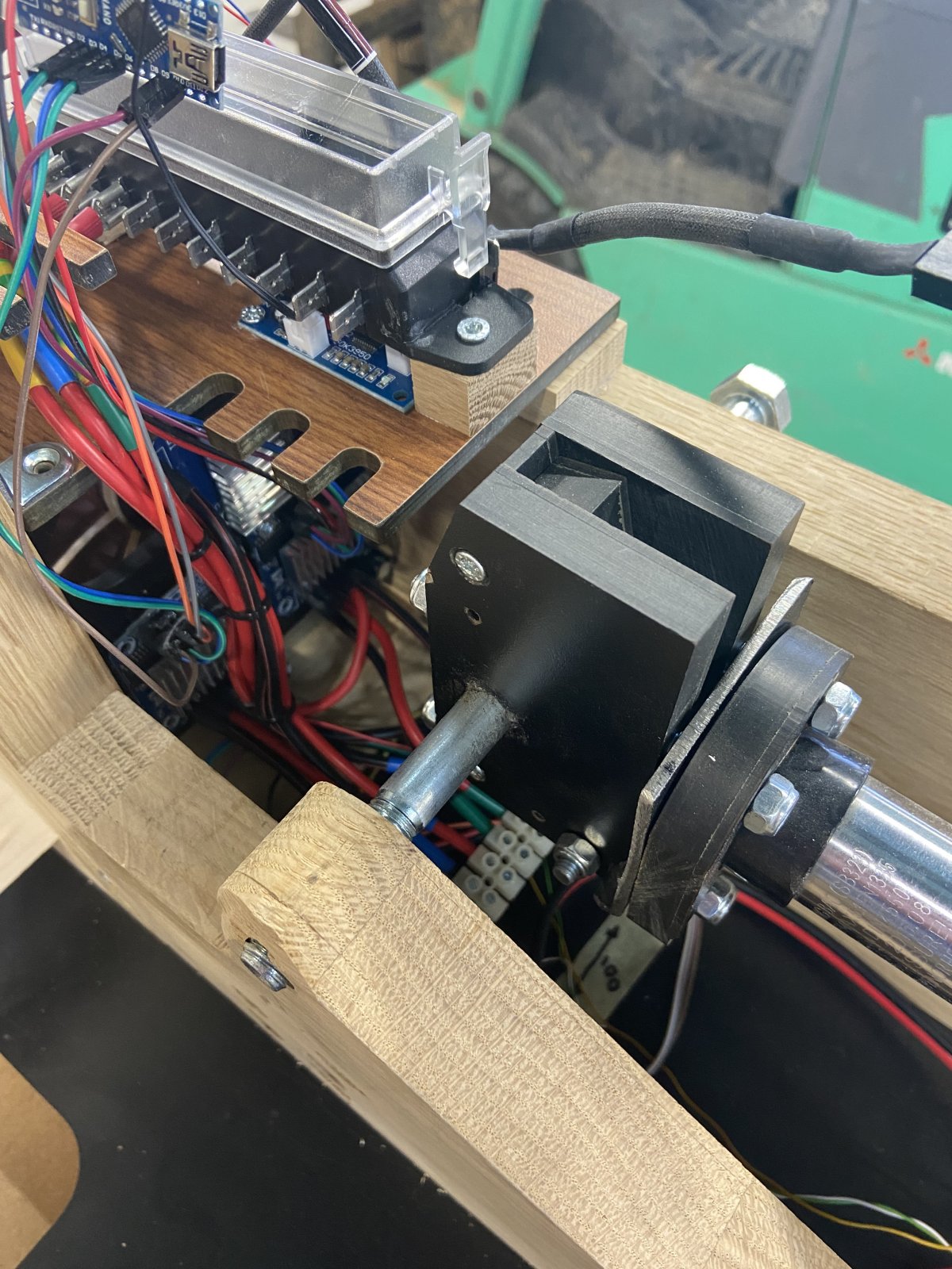

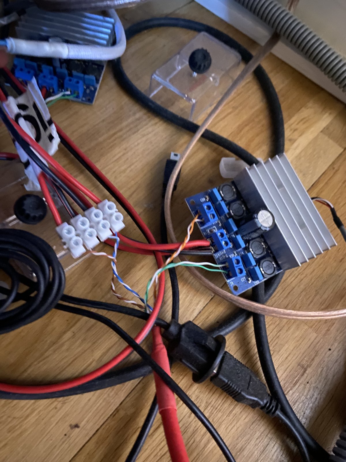

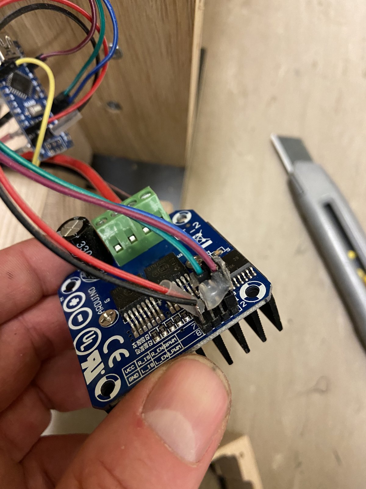

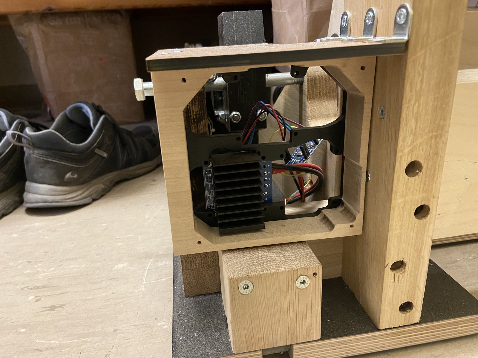

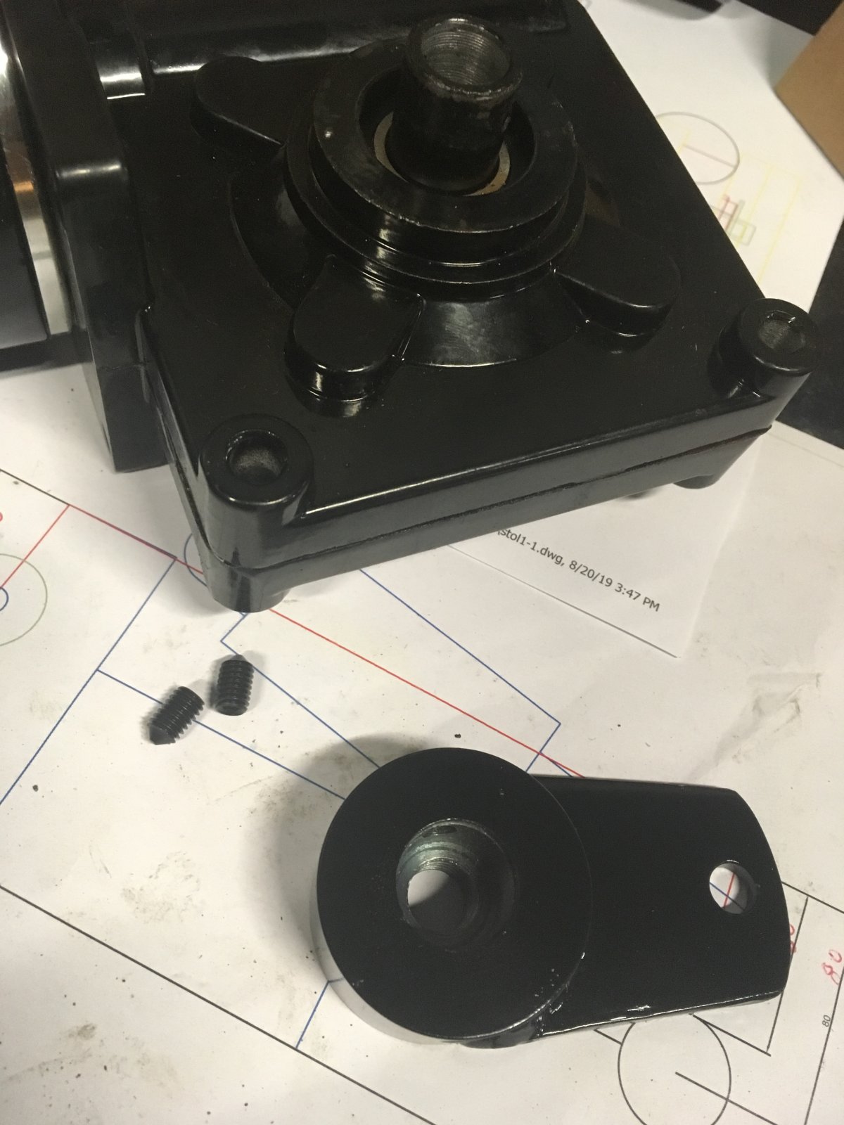

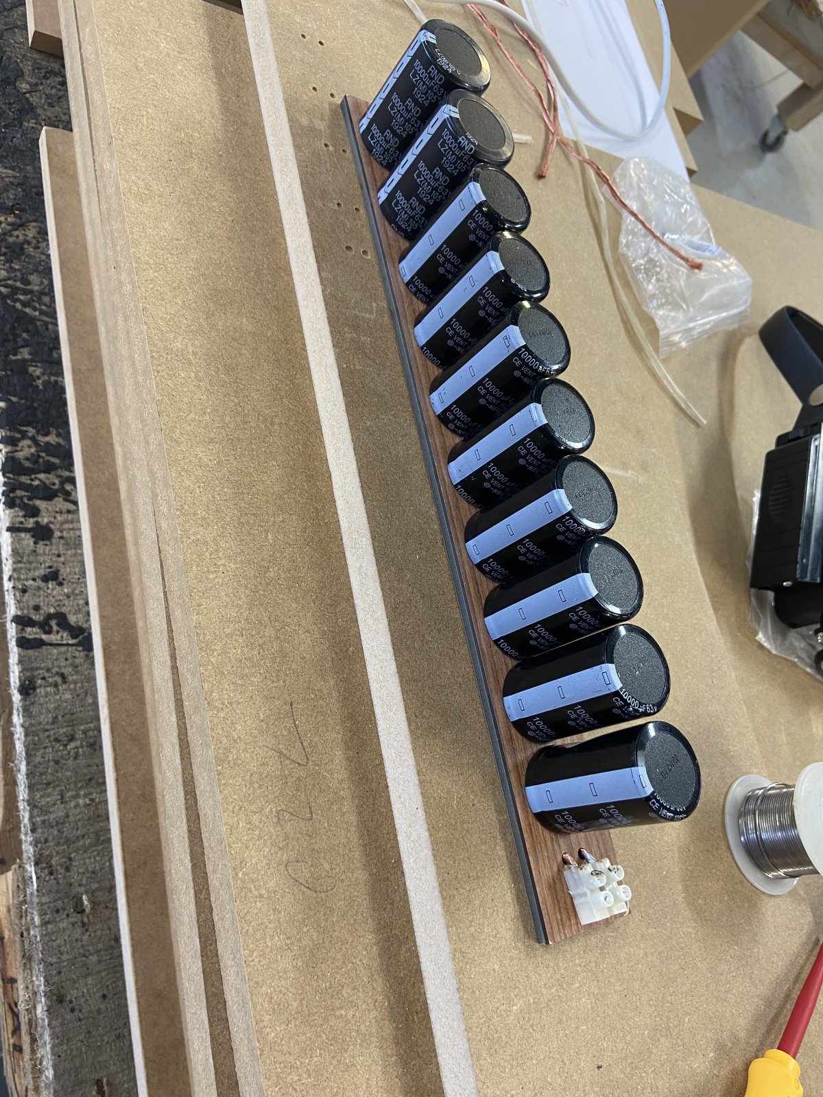

    I burned tow of the RC-servos, so i am taking out the boards from the servos and putting them on a "heatsink" And fixing som cooling for the motors.

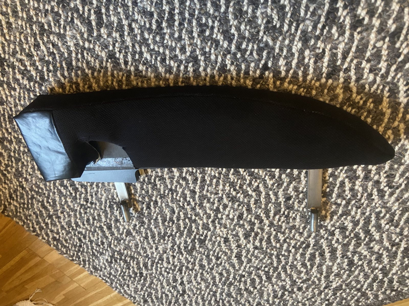

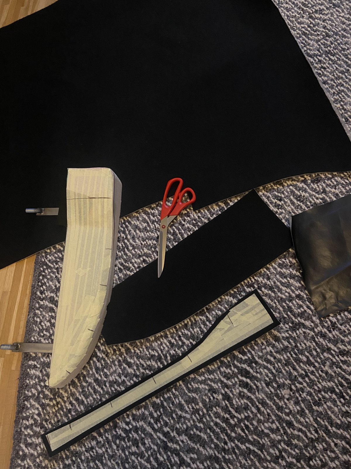

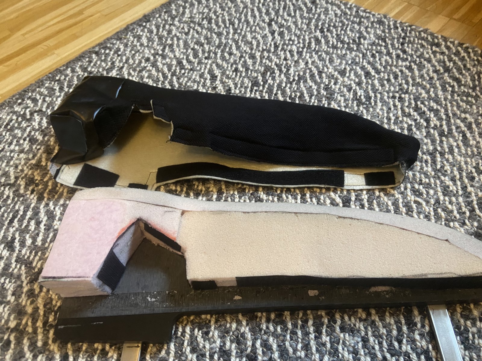

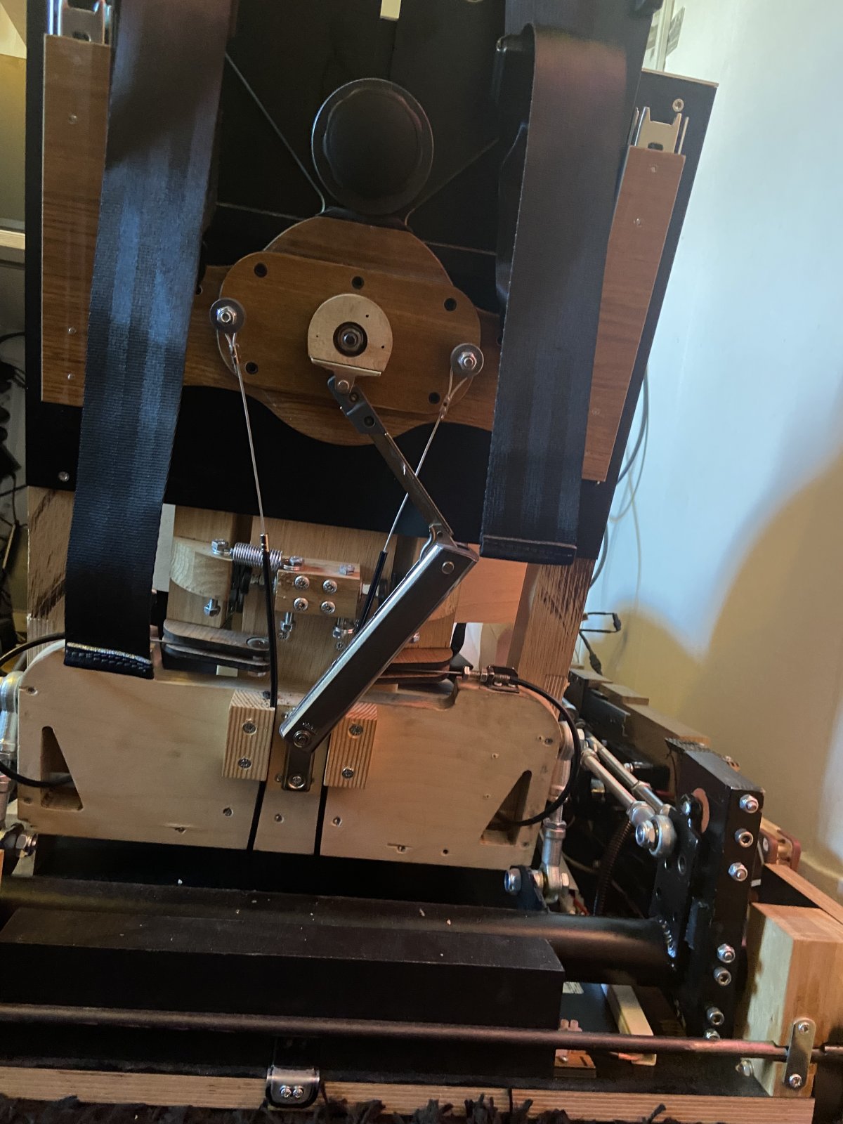

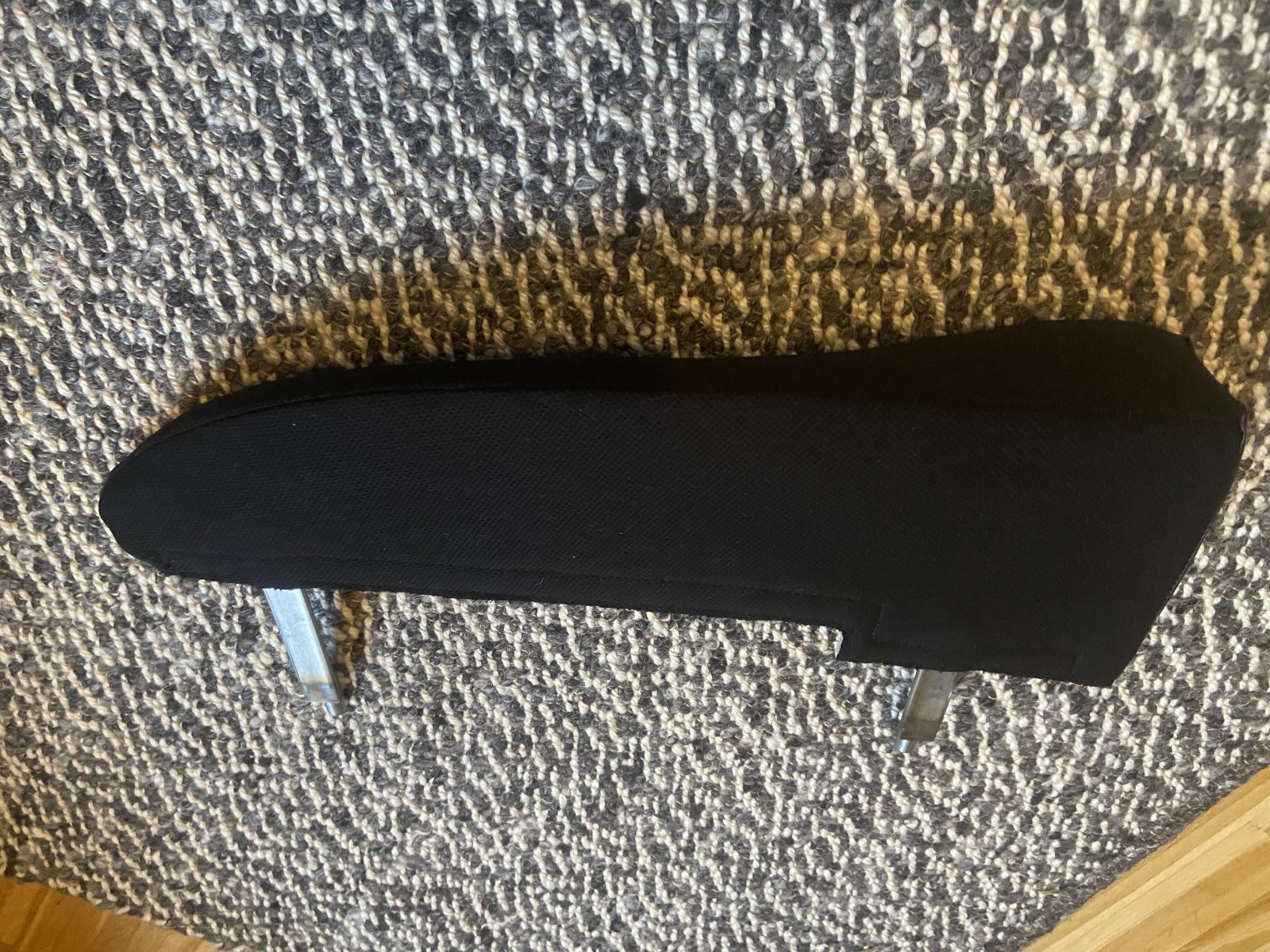

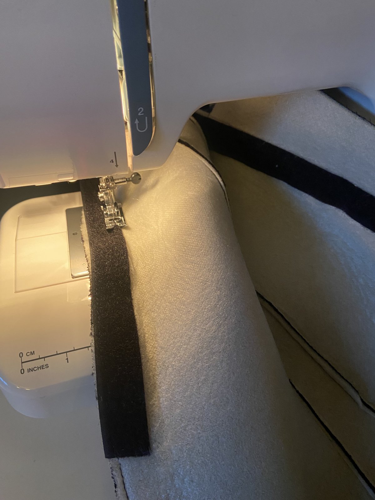

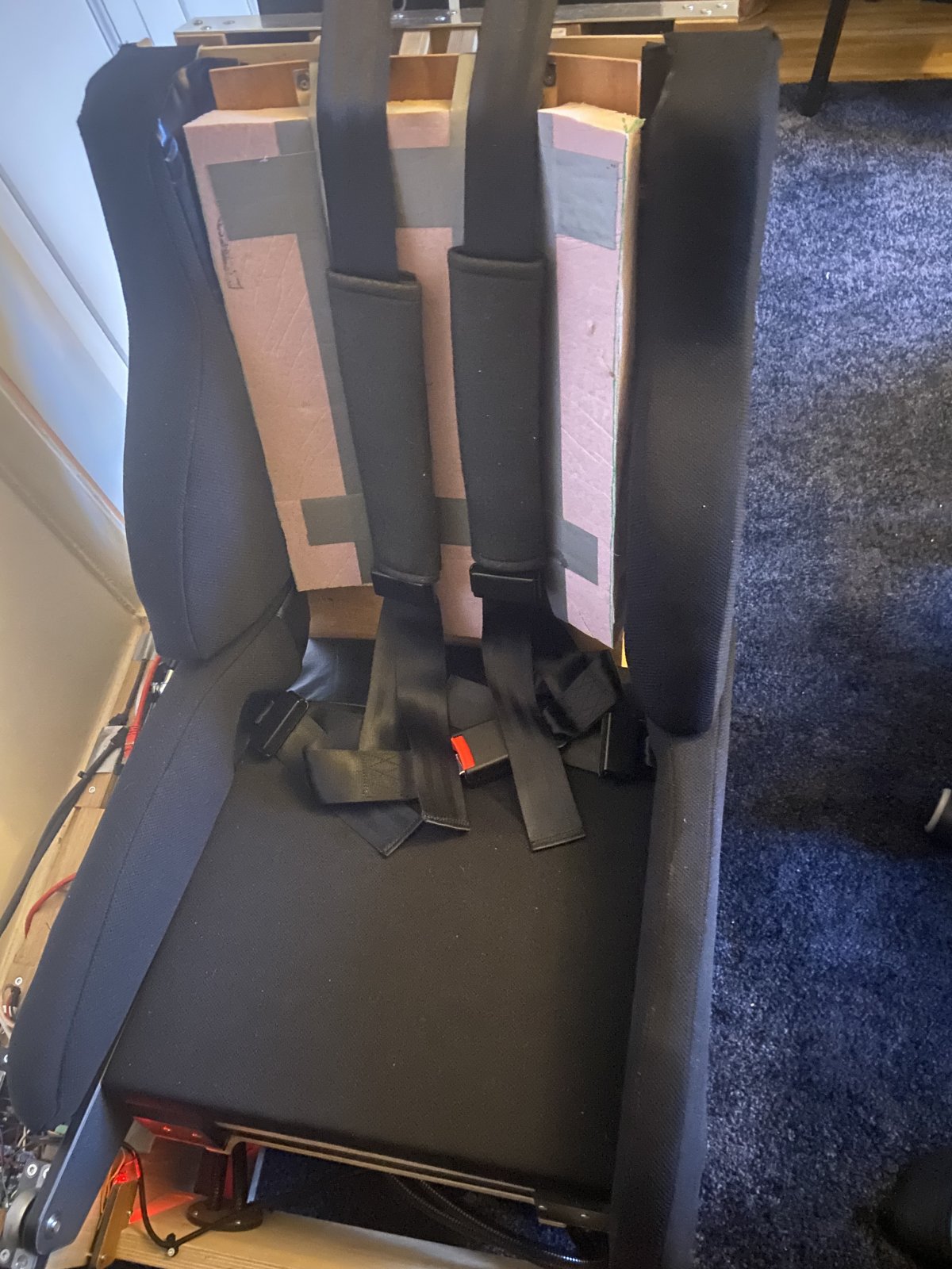

    Some progress with the fabric.
    I am waiting on parts for the servo board extraktion. An this is very time consuming.... :roll
    IMG_5397.JPG IMG_5399.JPG IMG_5400.JPG IMG_5401.JPG IMG_5403.JPG IMG_5404.JPG IMG_5405.JPG IMG_5406.JPG
