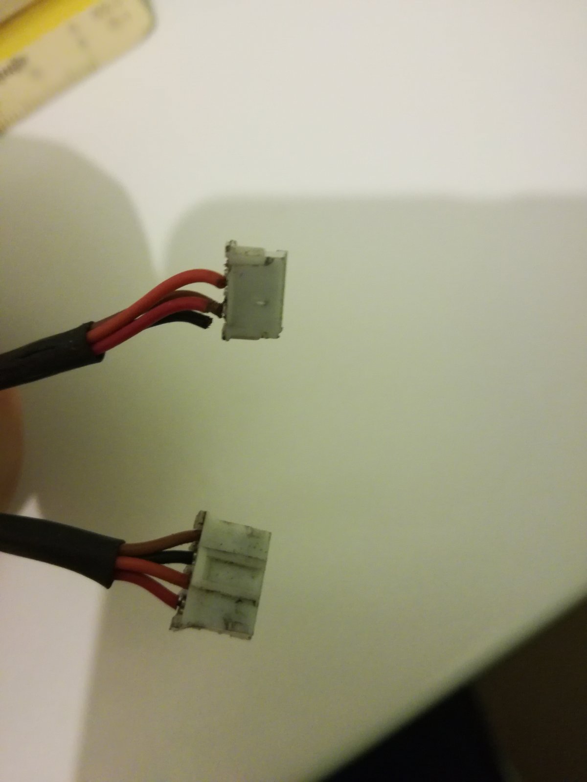

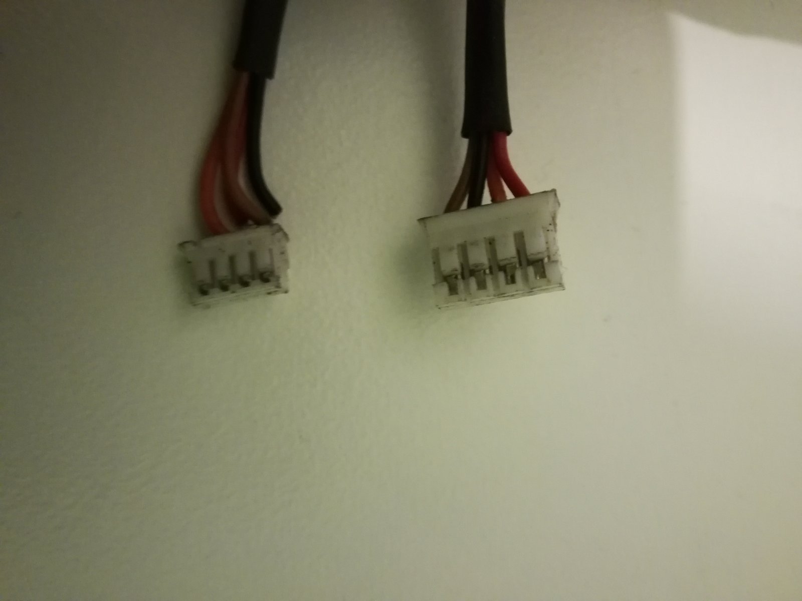

    Hallo,
    I need to replace the connector of my fanatec v1 pedal from load cell to PCB. I post 2 photos of the cable connector. The small connector (connection to pcb board) should be JST ZH 4 PIN 1.5 but I don'tk know wich type of connector is the one on the other end of the cable (connection to load cell).
    The cable is identical to the ones connecting the accelerator and clutch hall sensors to pcb.
    The two connectors look the same in shape, obviously they have the same number of pins, but they have different dimension sizes
    Can you please help me? thanks

    I answer myself and I hope it can help those who need to build these cables, the cable has a connector jst zh 1.5 mm 4pin to the pcb and the other connector jst ph 2.0 mm. 4 pins to the hall sensor or load cell amp card
