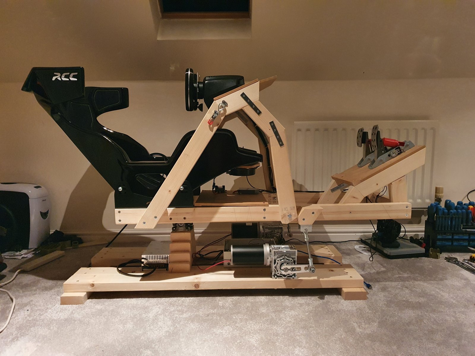

    While my 6 DOF design is ongoing/on hold, I've decided to make a 2 DOF sim as I have most of the parts lying about.

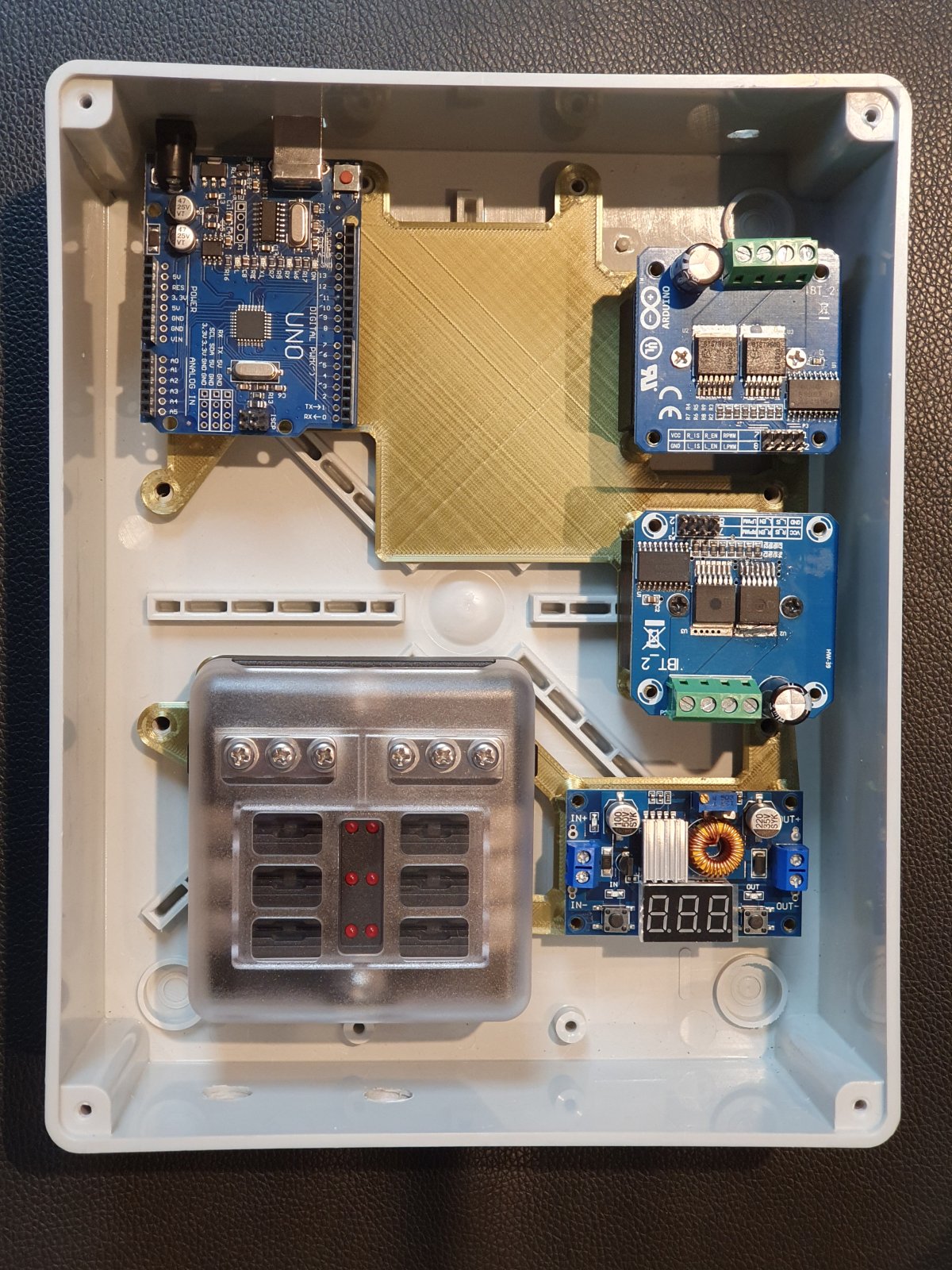

    Main bits used:
    RCC-MK8 2S seat
    24v 42A PSU
    2x 24V 440W 1:60 worm drive motors
    2x IBT-2 43A H-bridge
    Ard Uno R3
    2x 360 hall sensor
    Fuse box
    2x 12v fans for control box cooling
    DC to DC buck convertor (24V to 12V)
    Stud and MDF board for frame
    UV joint (from a Land Rover)

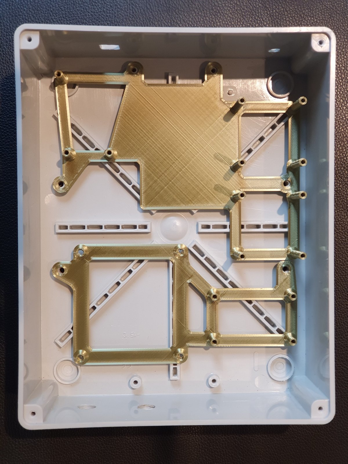

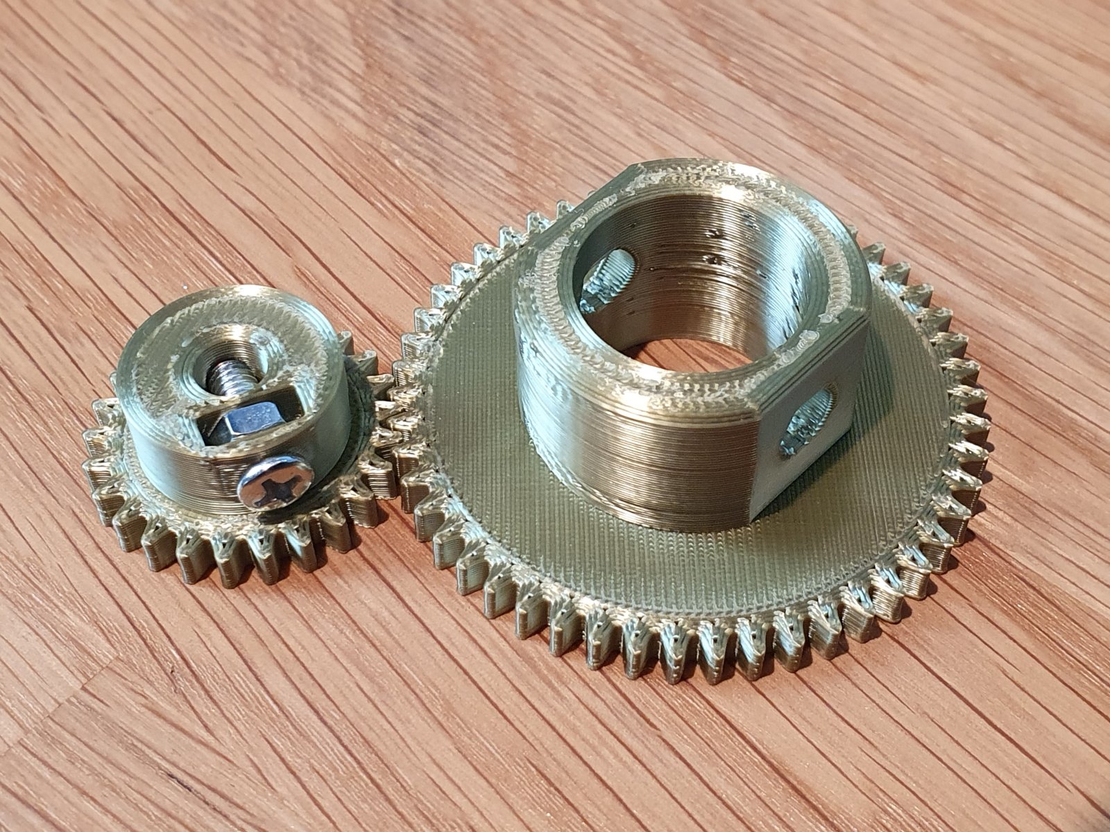

    So far I have made the top frame and incorporated a wind sim and transducer from a previous build.
    Control box

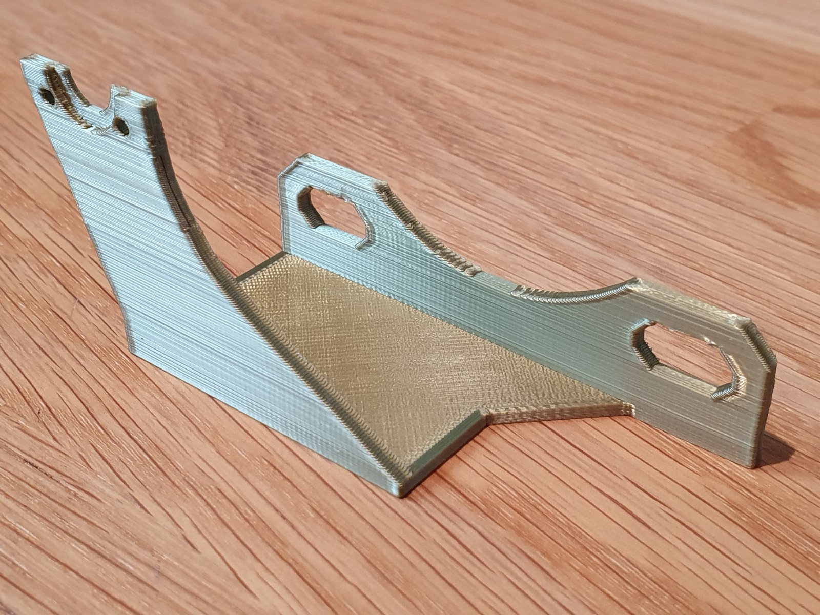

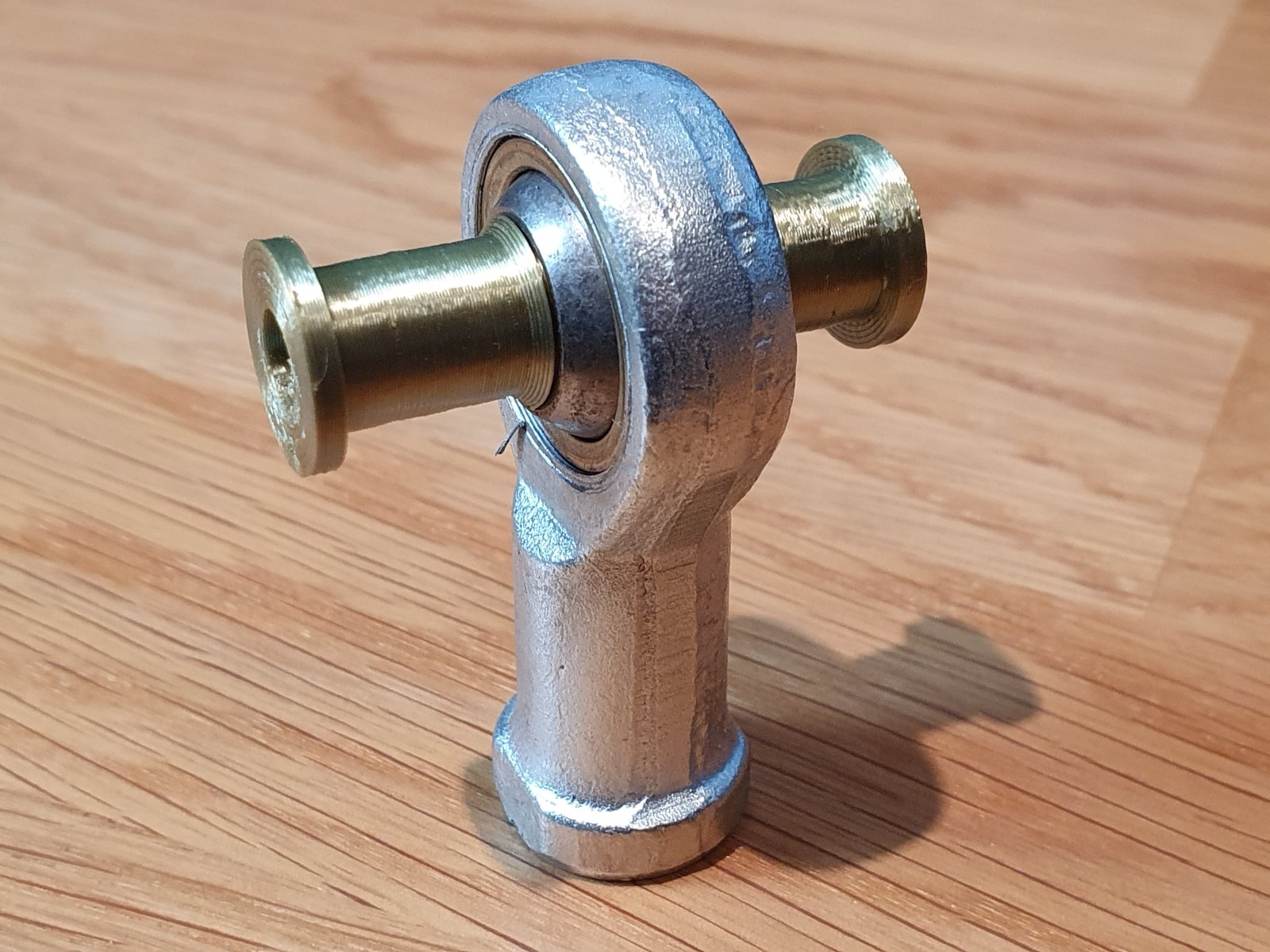

    3D printed misalignment spacers
    Pot gears and mounting bracket

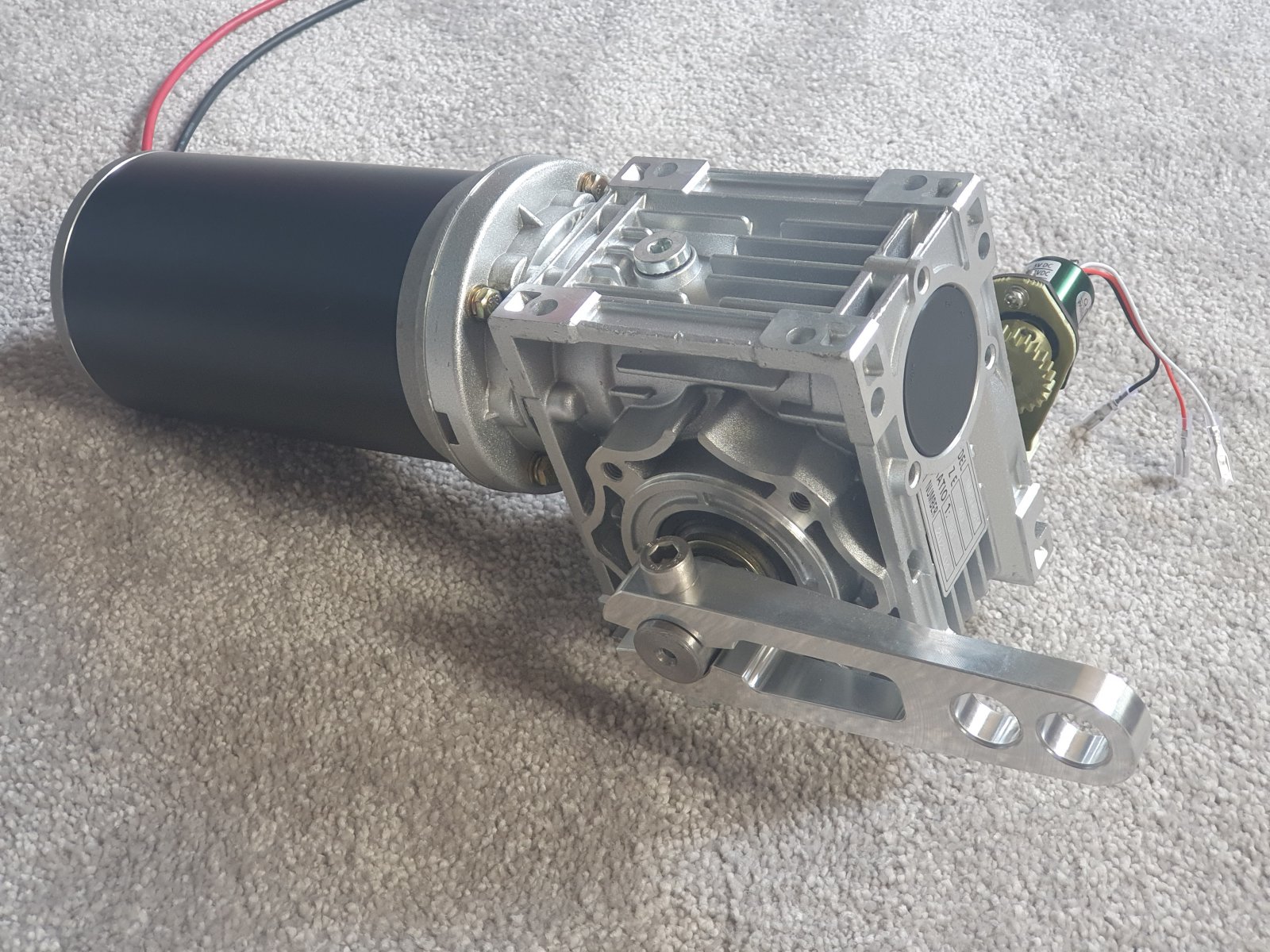

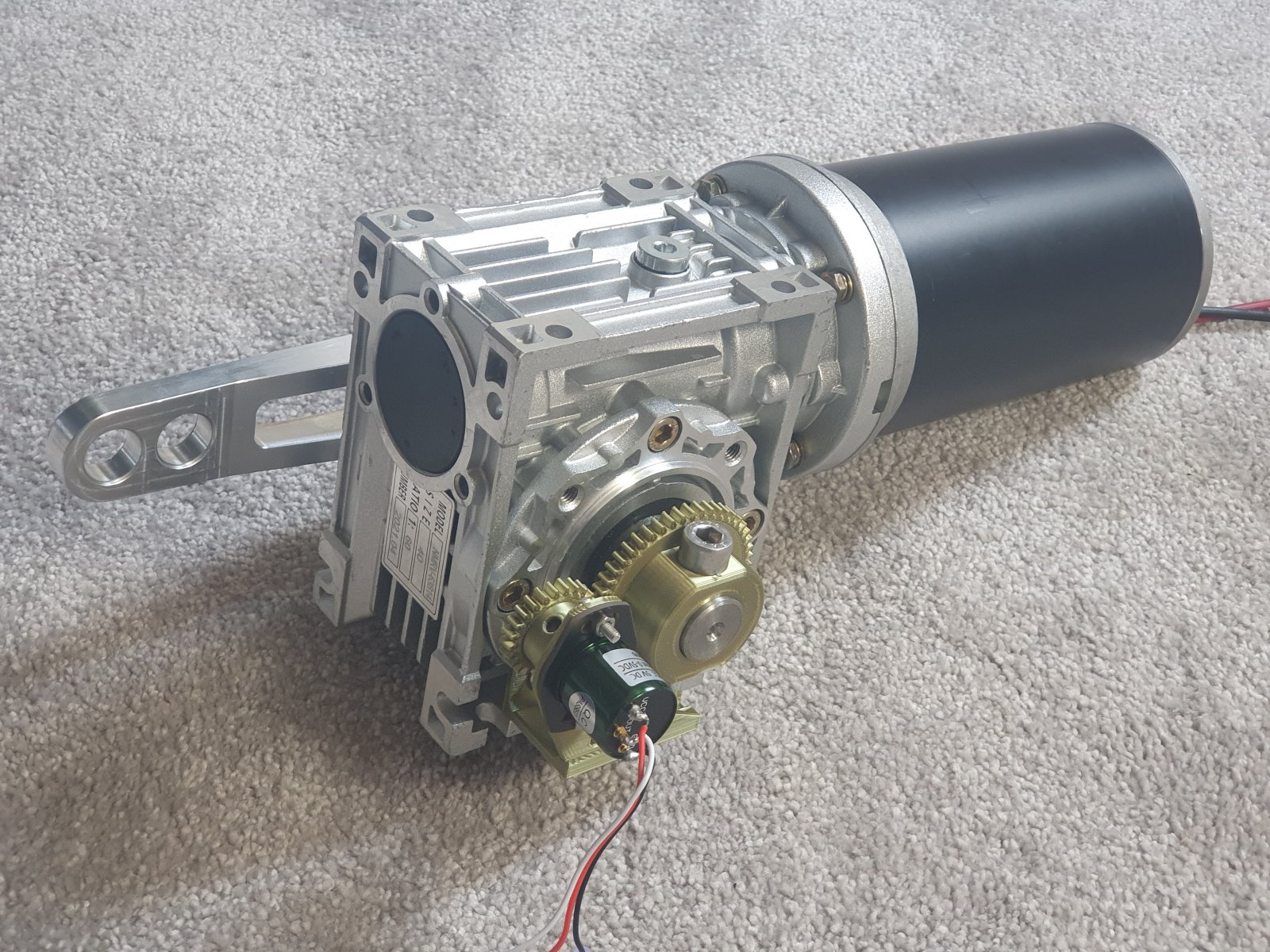

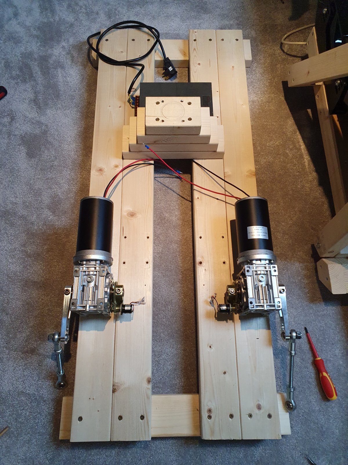

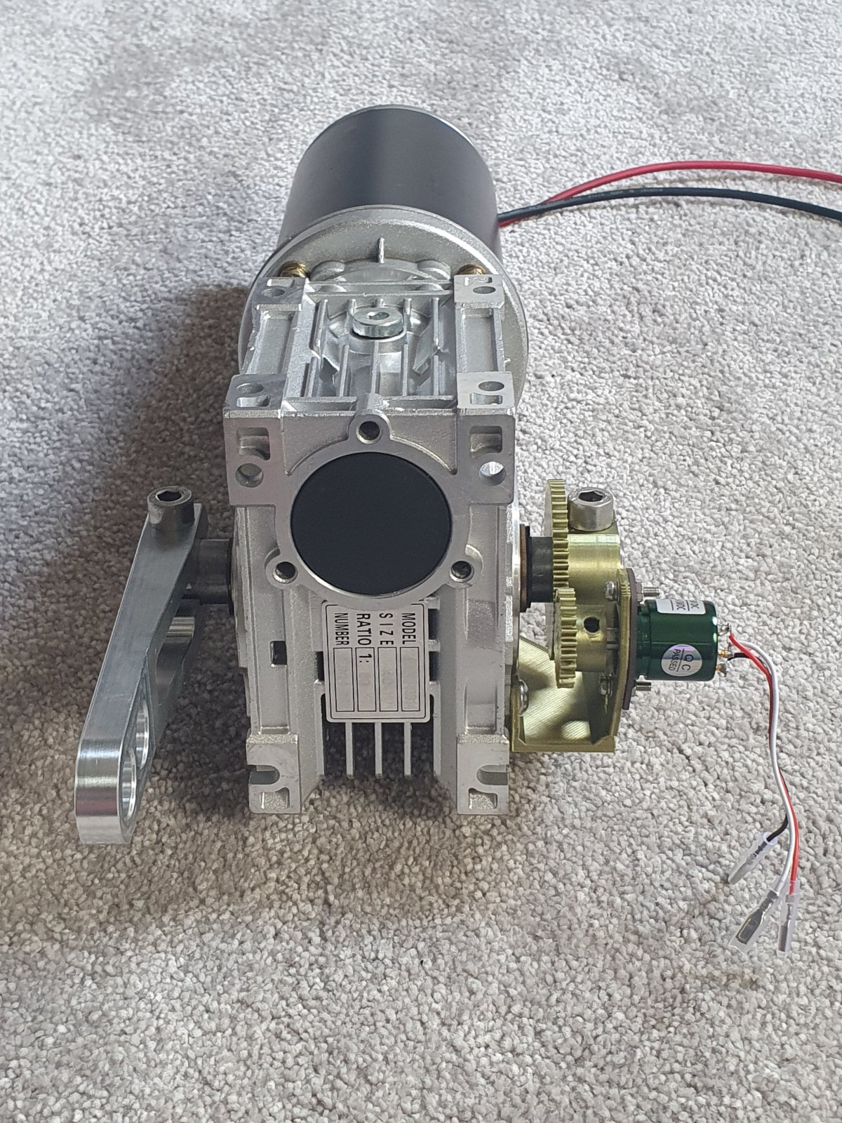

    Motors have finally come in so have been busy setting them up with the pots and electronics

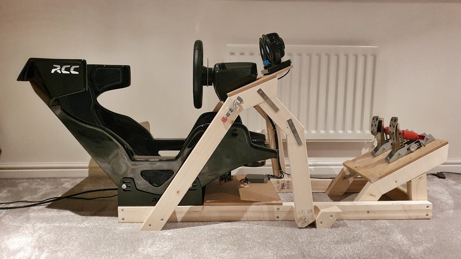

    Sim is now assembled and it's time for testing

    Lol, did you make the wheel console movable just to get into the seat?
  14. early_m
    early_m Active Member
    Jul 28, 2016
    343
    Chelmsford
    887Coins
    +358 / 5 / -0
    Yep, would have been impossible otherwise

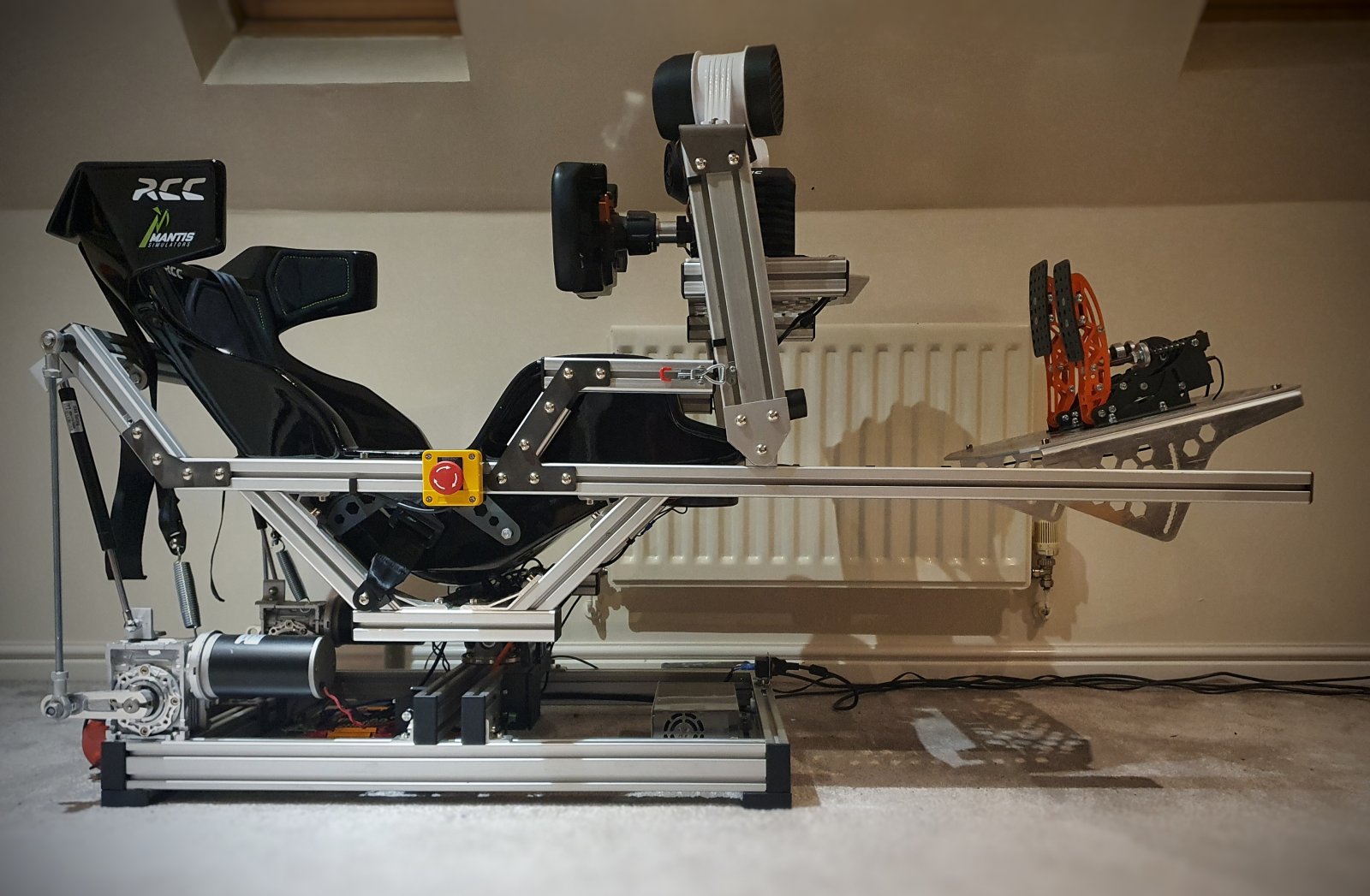

    Very nice! I really like this kind of project which goes to the essential with inexpensive materials. I thought that the wooden structure would not be very rigid, but watching the video I am reassured.
    Do you know the weight of the complete mobile structure? Did you use glue for the assembling?
  19. early_m
    Jul 28, 2016
    343
    Chelmsford
    887Coins
    +358 / 5 / -0
    All held together with 70mm screws. Not sure of the weight, bit it is pretty heavy! Going to swap out the top wooden frame for aluminium profile as soon as I can as I think it will be even more responsive and less strain on the motors
