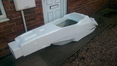

    The square box at the front can be cut off but it may become in usefull in the future. I will also come back to creating a roll hoop so that it looks more f1/gp style

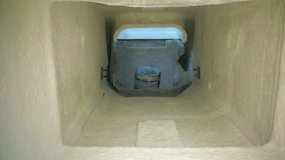

    This picture shows inside the monocoque and you may see the seat plug mould i am working on in the distance .

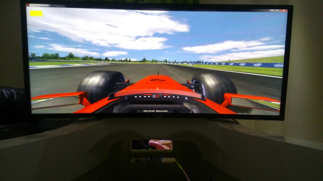

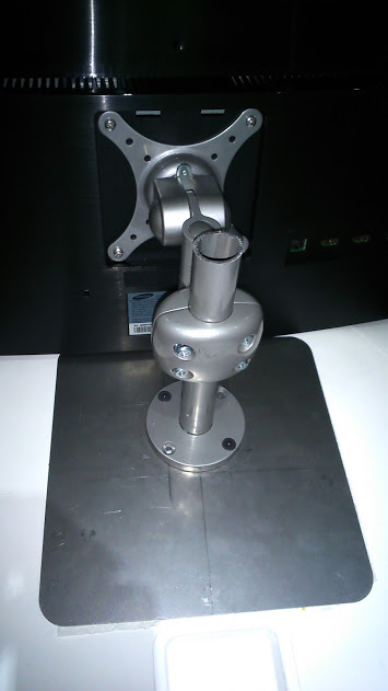

    After contemplating the monitor options and considering going down the oculas rift route i decided to fit a ultra curved monitor that could move with the monocoque. Luckily i had an old clamp desk style vesa mount which i could use parts from it along with some mild steel plate to bolt on to the top of the monocoque.( mite be overkill with the plate but see how it goes) This allows the monitor to be tilted downwards towards the driver as you are sitting below the monitor.
  4. mrt
    mrt Member
    Aug 31, 2013
    74
    United Kingdom
    719Coins
    +62 / 0 / -0
    3DOF, SCN6

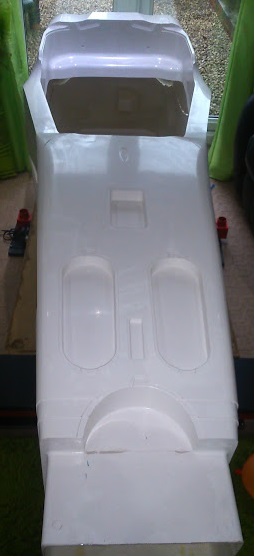

    Here is the drivers view from the seated position. I havent really played about with the in game resolutions/pov settings as yet.
    Luckily as the monocoque is flat the tv will sit onthe top flat and flat at an angle. Hopefully there shouldn't be any movement in the tv when it will eventually be in motion. Although it could just require an aditional bracket at the back to secure it.

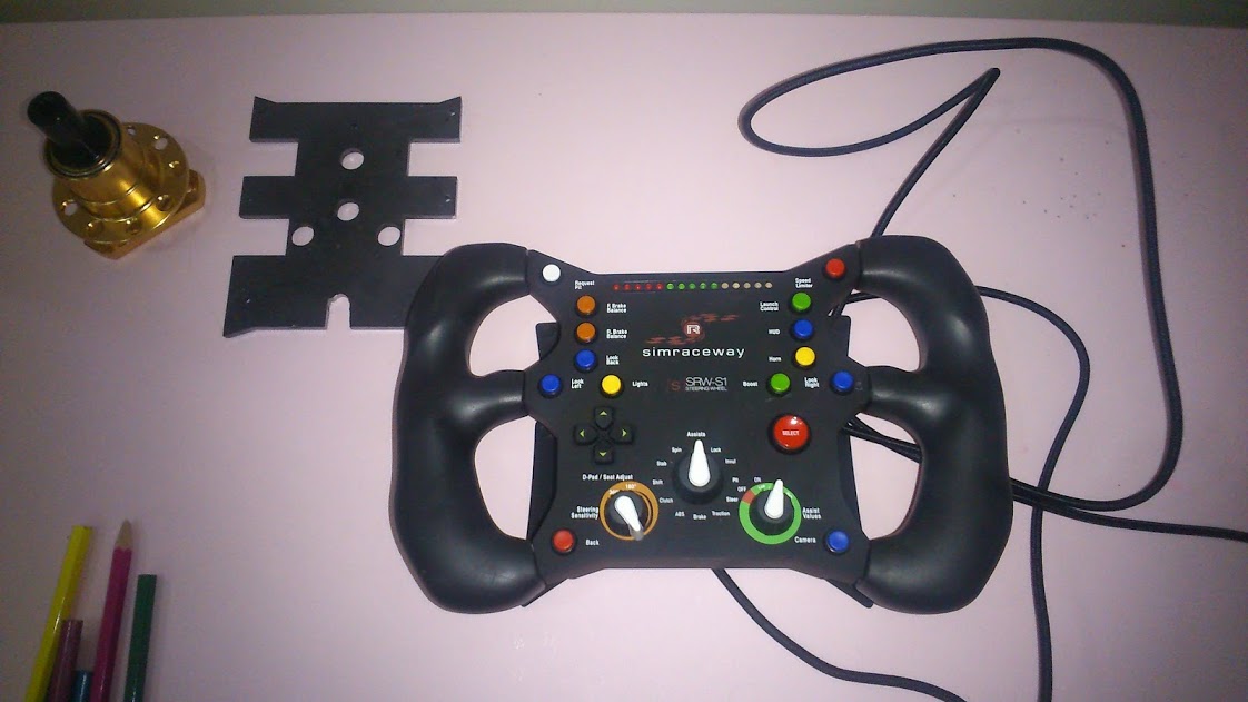

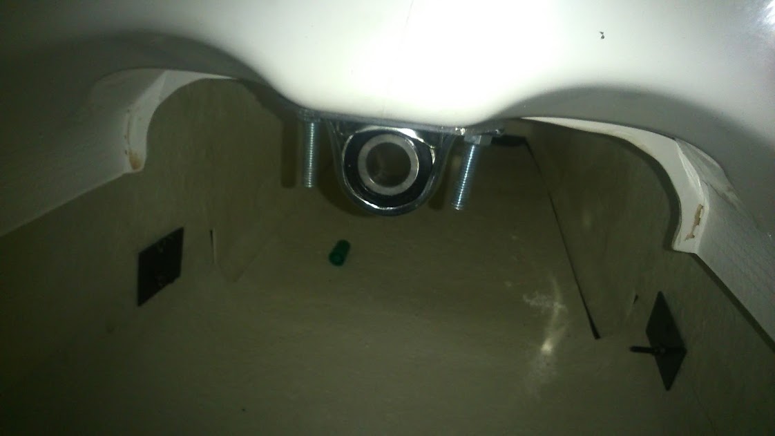

    www.JPG above is the steering column bearing . I will be changing the two bolts but its all i had at the minute. Bearinbg was aapprox £6

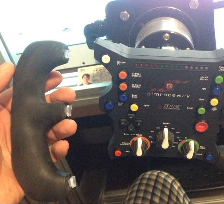

    And above is the srw-s1 wheel with back plate and a quick release boss which i need to fit together. I have decided for the steering it will be powered by the logitech g920 for the moment as its something i have already which i can use. for both the boss and the srw-s1 i paid approx £80
    For cutting of the back plate for the srw-s1 i actually did a hand drawing with measurements and sent it to
    http://www.lasermaster.co.uk/easy-order laser master who quoted me approx £8 inc delivery to convert it and cut it out. I did also use laser master to cut the plate for the tv stand and would recommend them.
    The next job will be affter fixing the boss onto the wheel will be making a steering coloumn to go from the wheel down to the g920n which will be located behind the pedals

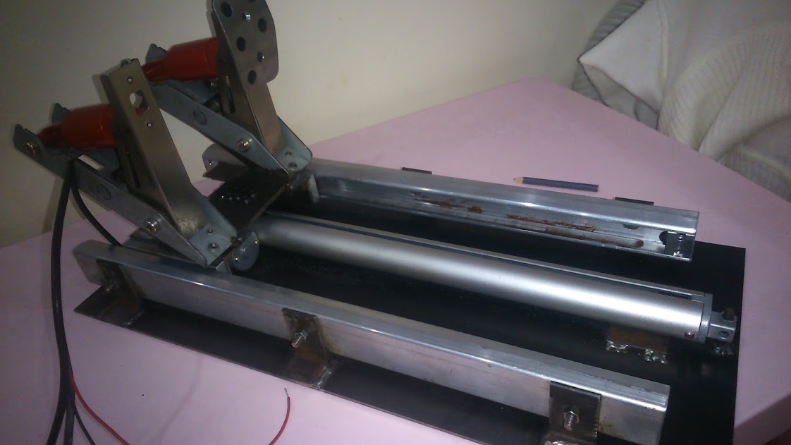

    so while work continues on the steering rack/wheel. Il share a picture of the pedals that might be going into the simulator. Nothing really special about them, as the are the g25 pedals. The main aim was with them to make them electronically adjustable for people of different height. Its not finished yet but will require a foot flate to rest your feet on and ideally it could do with at least the spring upgrde in the pedals. With the track actuator it allows approx 45cm adjustment . DSC_1081.JPG

    I would HIGHLY suggest you re enforce that SRW S1 before mounting it on a G27/29 It WILL slowly destroy the Tiny little screw bosses in the main plate.

    i did notice the loosening handles on a wheel i used on a g25 previously but thanks for the tip.
    heres a bad quality video i did a few years ago. showing the srw-s1 mounted into another cockpit.

    Pull both handles then you have a Button box and a hand brake all in one.

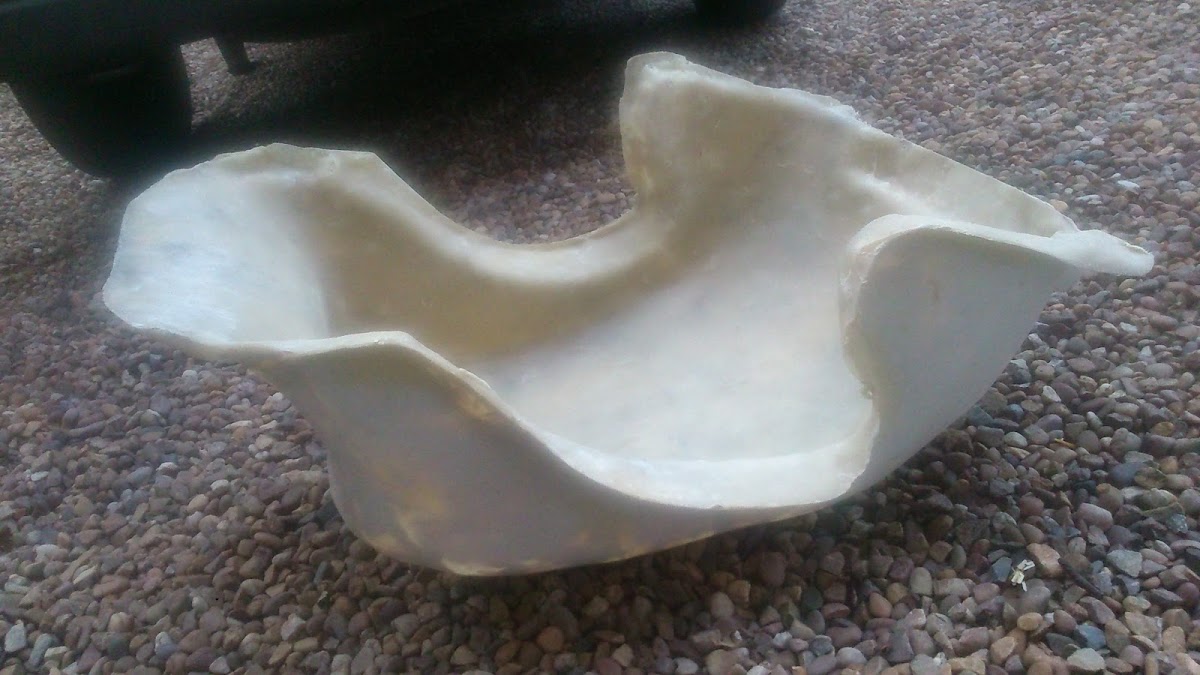

    Afew more photos for you all So first one is of the seat buck mould . The picture is showing you the outside of the mould just so you know what it will look like . Although its much more smoother detailed on the other side.

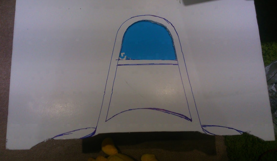

    So while i had two minutes before bed ive decided to mock up a roll hoop, which will make the rig look a little more like an F1 cockpit. Ive gone for a brawn style roll hoop as its pretty simple. It could be an idea to mount a speaker inside the roll hoop.

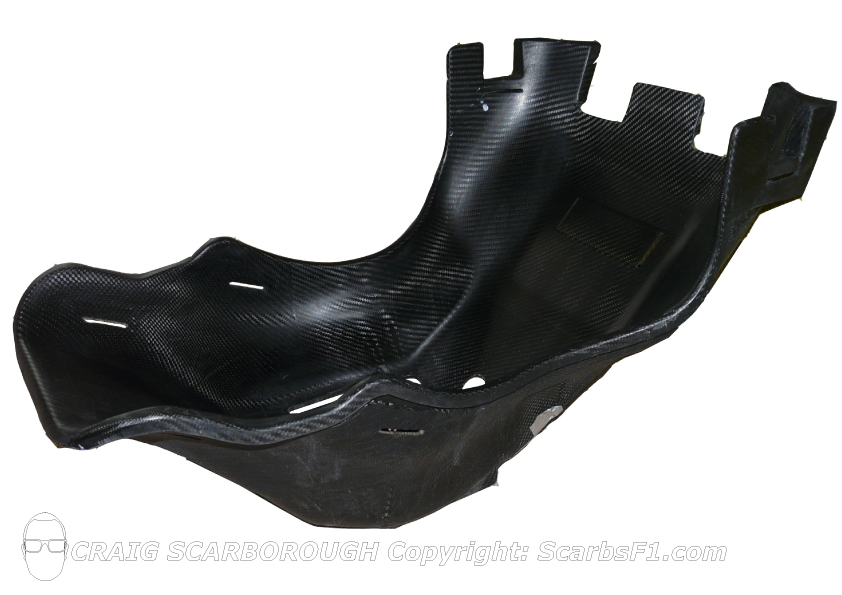

    2,572
    For reference here is a real F1 seat - similar look, but different seating position to a Go Kart. For comfort, they are normally custom molded to the driver.
  19. mrt
    mrt Member
    Aug 31, 2013
    74
    United Kingdom
    719Coins
    +62 / 0 / -0
    3DOF, SCN6
    Yea it is similar to this although in the picture my seat isnt shown at the right angle of when it is fitted. As the back would have to be higher. The seat would be a generic size/shape to fit most people

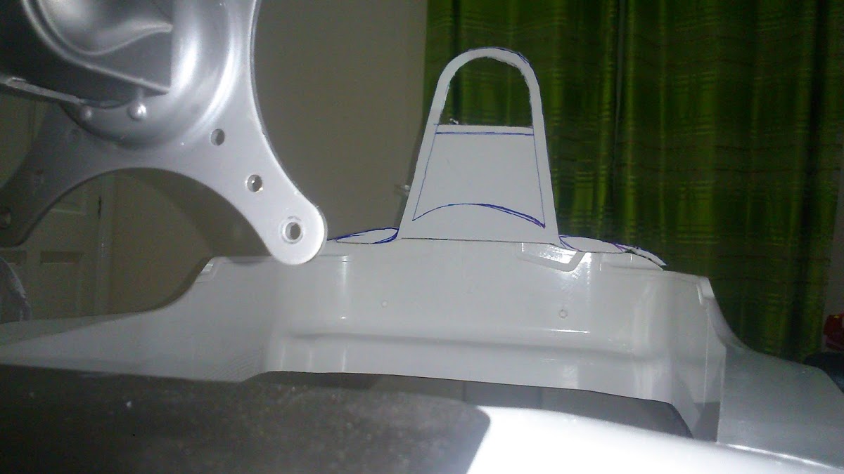

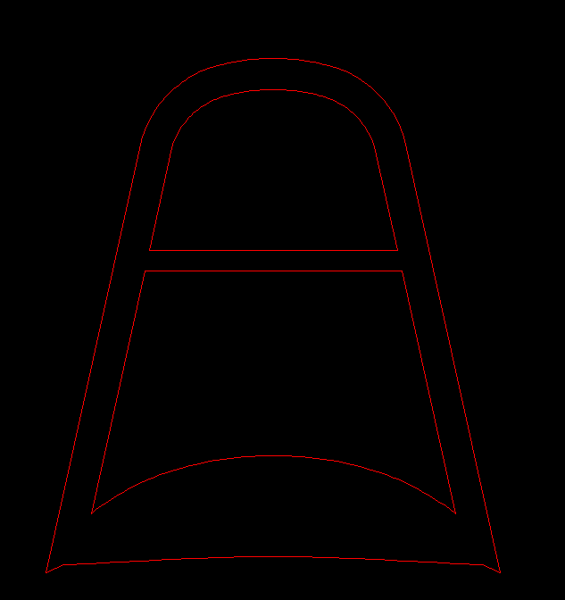

    Hi so heres a few more photos to keep everyone interested,while work continues.
    Side (ish) image of monocoque Roll hoop cad 2d image to be cut from possibly aluminium or i may
    just even cut out of styrofoam to start out with. design may change slightly
    once the head surround is sorted.
