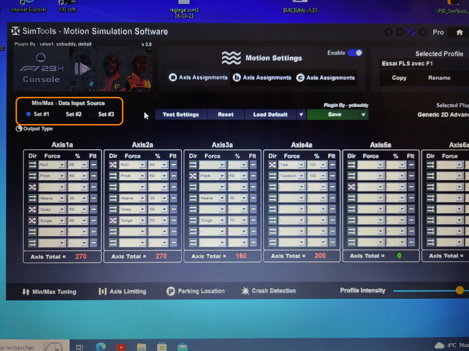

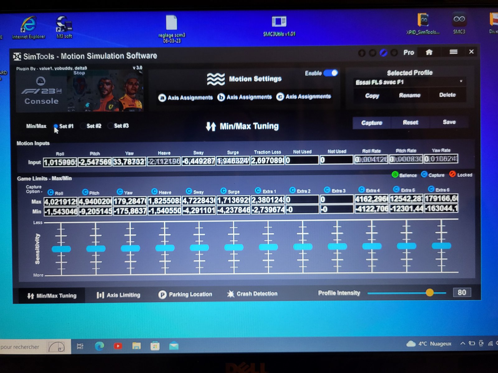

    Hello, I would like some advice on tuning simtools V3 in tuning center. I use the F1 23 game on PlayStation 5, and I captured the min and max values in the tuning center: the movements of the platform are very weak (the connecting rod moves a few degrees...)
    Can someone give me the correct tuning center settings as well as the percentages of the different roll surge pitch movements...? THANKS

    hello, thank you for responding to my message, here are the parameters that I set in Simtools, (I deliberately set the high percentages to obtain larger movements...)

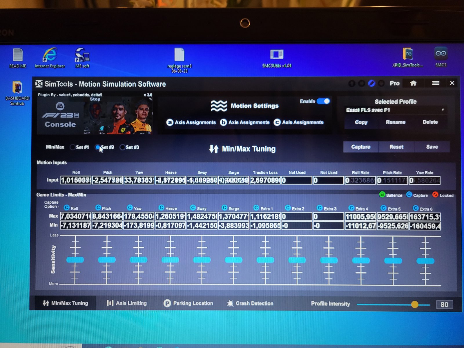

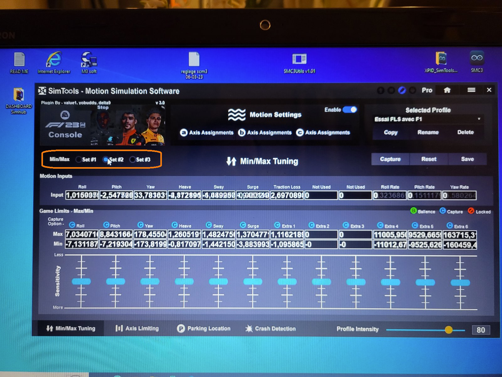

    It looks like you axis assignments is set to use set one of the max min values.
    But the max/min values you are showing me is for set #2, can I see what set #1 looks like? upload_2023-11-24_14-10-37.png

    Hi "my friend", in fact I hadn't seen that you could select "set 1" in "axis assignment"...
    But I think that the problem of my movements being too weak does not come from this setting...
    THANKS

    I would set your axis so they are not so high, or you will get a lot of clipping.
    Maybe 120 max or so, and then adjust the Max/Min settings to get the speed you want.
    Lower numbers are faster with less range, and bigger number are slower with more range.
    Take care!
