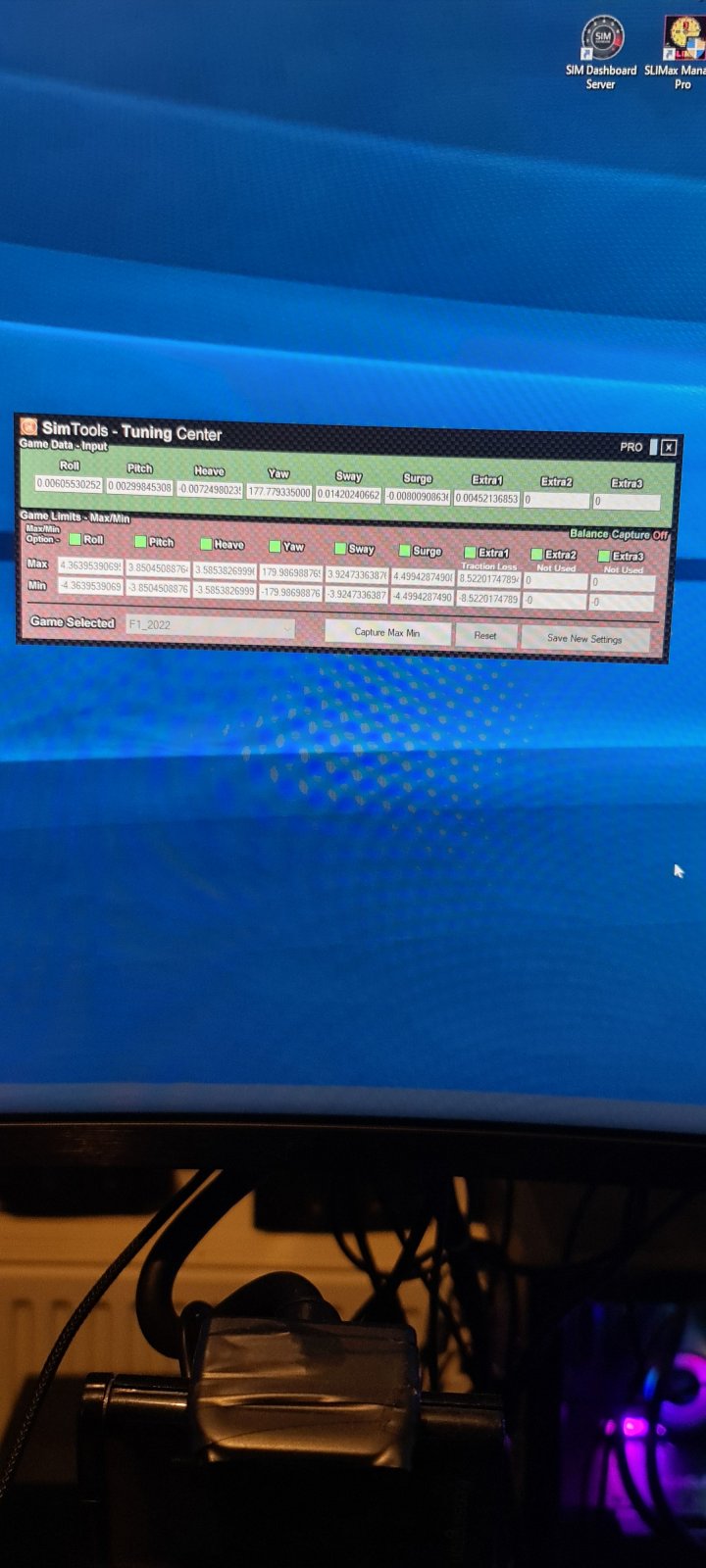

    Jul 15, 2021
    19

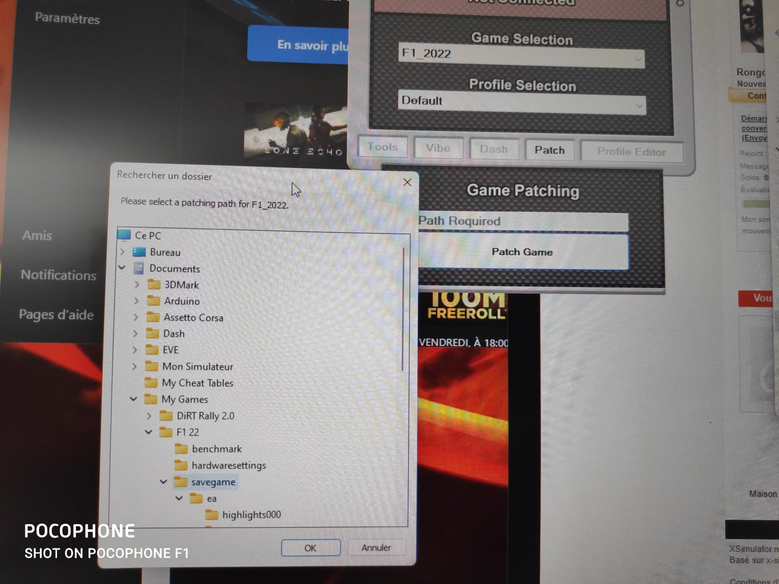

    hello. great for the plugin. for me, unfortunately it does not patch. maybe because of the directory name."F1 22" instead of "F1 2022" I use simtools version 0.2.4.0. executable of the game "F1_22.exe". do you have a solution for me?

    Have you run the game and played a race?
    If not, afterwords, select the 'F1 22' folder in you pic above.
    Take care!

    manually select the F1 22 folder and you are patched.

    thank you. it works now. indeed I had selected "F1 22\savegame" instead of "F1 22". Thanks again to everyone

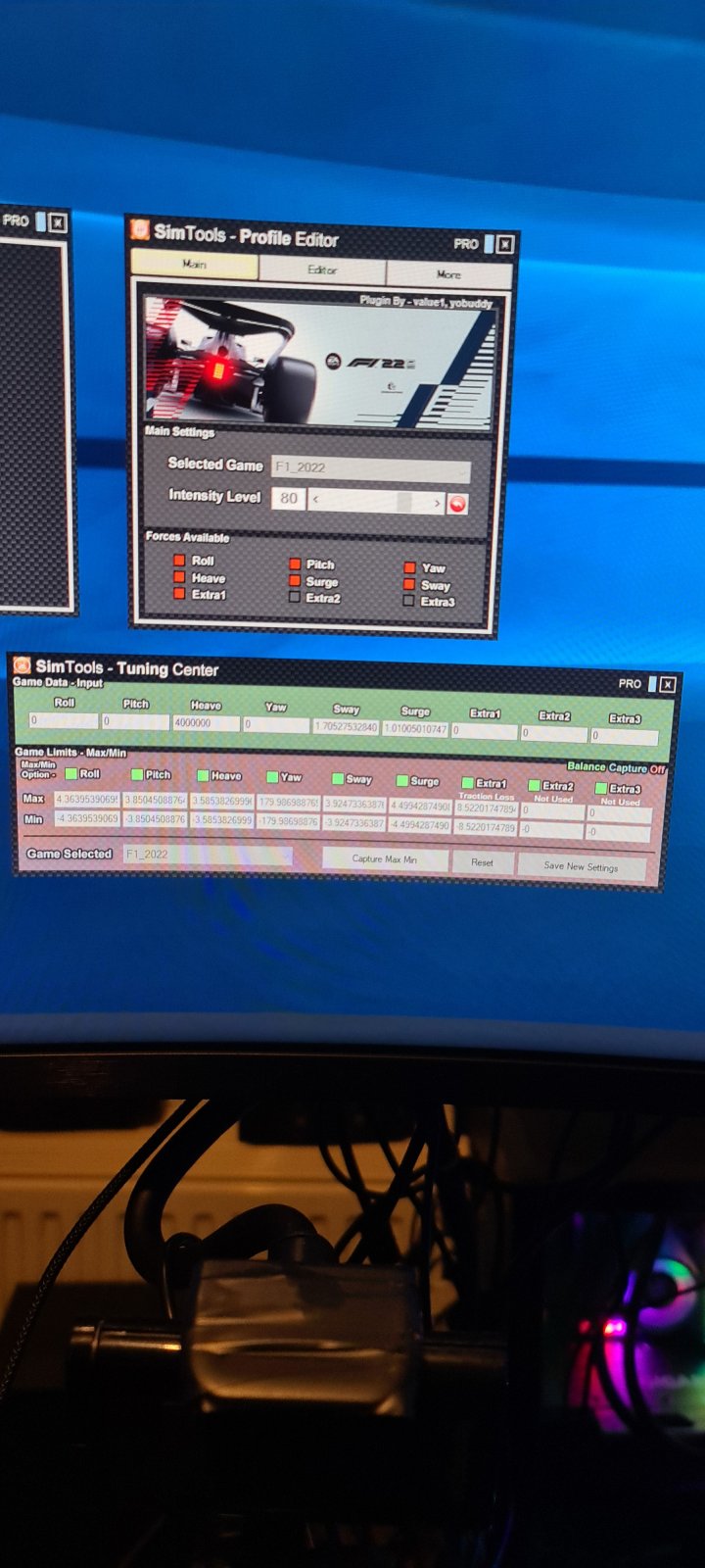

    Thanks for the plugin yobuddy! Im testing vibe now. Seems to get signal, but the labels are not set. Cant see witch input is RPM and Chassis :)

    I have no signal from the game. Checked the UDP settings, enabled vibe in game manager. Game manager show that the game is running, but i get no signal when i try to capture high/low in Game Engine or Vibe. When i run Dirt or another game it captures both. The patch was succesful.
  21. Blekkulf
    Blekkulf Member Gold Contributor
    May 18, 2018
    73
    Molde
    342Coins
    +13 / 0 / -0
    2DOF, AC motor, Arduino, Joyrider, 6DOF
    Found the problem. Sim dash was running in the background from my other sim, and blocked the udp i guess. Will try with this progam to solve the issue; https://www.eksimracing.org/srps/
