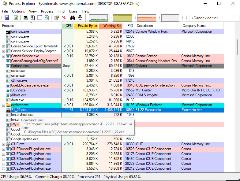

    The test plugin for v3 of SimTools works in desktop mode, but not in VR yet, so for those of you interested in F1 2022 what would be helpful is identifying the process name for the VR side of the game, while it is running in VR mode.

  7. Chris Twigg

    It's not a different exe for VR mode. It looks like it's just a /VR in steam switch to start the exe

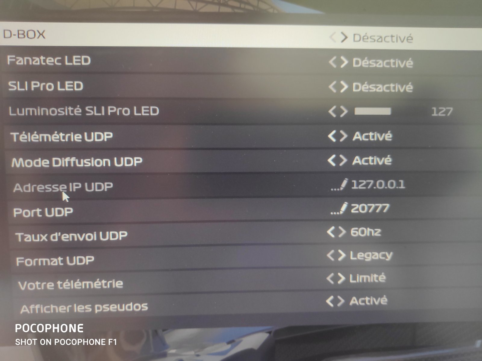

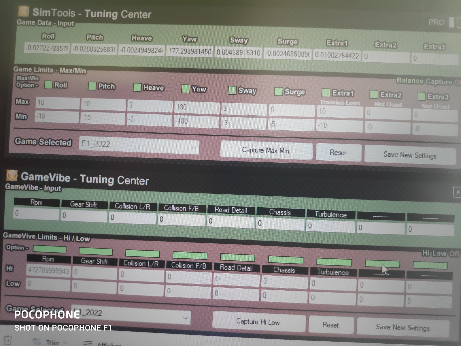

    Hi yobuddy. I use game vibe but I no longer have data going back to the game vibe tuning center. It worked at first when installing the plugin. game engine is still ok. I don't know if an update of f1 22 is the cause.

    Udp format Legacy or 2018 it's the same thing.

    2018 is the format it was meant for.
    Have you tried closing and reopening game vibe when the game and simtools is running?
