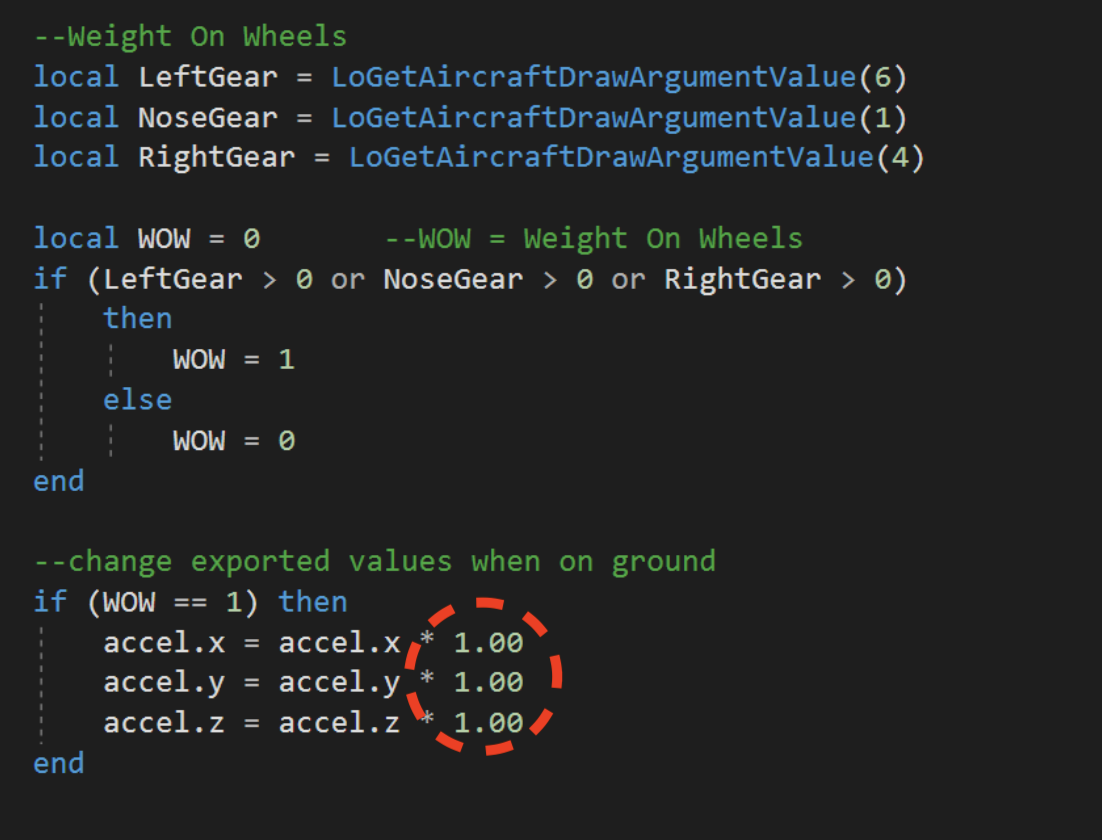

  13. Dirty
    Oct 15, 2017
    746
    All the way up front.
    7,975Coins
    +890 / 3 / -0
    here's an updated Export.lua
    Code:
    -- Experimental Export plugin for SimTools V2.3 (created by Value1, modified by Dirty)
    -- Version 0.03
    Myfunction =
    Start=function(self)
        package.path = package.path..";.\\LuaSocket\\?.lua"
        package.cpath = package.cpath..";.\\LuaSocket\\?.dll"
        socket = require("socket")
        my_init = socket.protect(function()
            -- export telemetry to SimTools
            host1 = host1 or "127.0.0.1"
            port1 = port1 or 41230
            c = socket.udp ( )
            c:settimeout ( 0 )
            c:setpeername ( host1, port1 )
        end)
        my_init()
    end,
    AfterNextFrame=function(self)
        --Euler Angles
        local mySelf = LoGetSelfData()
            local Yaw =     mySelf.Heading
            local Pitch =     mySelf.Pitch
            local Bank =     mySelf.Bank
        local accel = LoGetAccelerationUnits()
        local omega = LoGetAngularVelocity()
        --Air Data
        local IAS = LoGetIndicatedAirSpeed()
        local AOA = LoGetAngleOfAttack();
        --Weight On Wheels
        local LeftGear = LoGetAircraftDrawArgumentValue(6)
        local NoseGear = LoGetAircraftDrawArgumentValue(1)
        local RightGear = LoGetAircraftDrawArgumentValue(4)
        local WOW = 0        --WOW = Weight On Wheels
        if (LeftGear > 0 or NoseGear > 0 or RightGear > 0)
            then
                WOW = 1
            else
                WOW = 0
        end
        --change exported values when on ground
        if (WOW == 1) then
            accel.x = accel.x * 1.00
            accel.y = accel.y * 1.00
            accel.z = accel.z * 1.00
        end
        --send data via UDP
        my_send = socket.protect(function()
            if c then
                socket.try(c:send(string.format("%.4f; %.4f; %.4f; %.4f; %.4f; %.4f; %.4f; %.4f; %.4f;\n", omega.x, omega.y, omega.z, accel.x, accel.y, accel.z, WOW,IAS,AOA)))
                end
        end)
        my_send()
    end,
    Stop=function(self)
        my_close = socket.protect(function()
            if c then
                c:close()
            end
        end)
        my_close()
    end
    -- Overload
    -- Works once just before mission start.
    do
        local PrevLuaExportStart=LuaExportStart
        LuaExportStart=function()
            Myfunction:Start()
            if PrevLuaExportStart then
                PrevLuaExportStart()
            end
        end
    end
    -- Works just after every simulation frame.
    do
        local PrevLuaExportAfterNextFrame=LuaExportAfterNextFrame
        LuaExportAfterNextFrame=function()
            Myfunction:AfterNextFrame()
            if PrevLuaExportAfterNextFrame then
                PrevLuaExportAfterNextFrame()
            end
        end
    end
    -- Works once just after mission stop.
    do
        local PrevLuaExportStop=LuaExportStop
        LuaExportStop=function()
            Myfunction:Stop()
            if PrevLuaExportStop then
                PrevLuaExportStop()
            end
        end
    end
    If you want to change the gain of the accelerations on ground, change these values in a text-editor:
    ...I will recompile the plugin tomorrow to have this included in version 0.03
    Dirty :)

    Any ideas on why this may not be installing? I removed the regular DCS plugin and killed all SimTools apps. I used the plugin updater and it says it installed, but I can't find a DCS related plugin in the plugin directory nor the drop down list in Game Manager. Sorry, maybe a newb question, but I'm a newb...
  17. noorbeast
    22,132
    154,418Coins
    +11,181 / 57 / -2
    Are you using the demo version of SimTools, as that won't utilise any plugin except LFS, which is provided for testing purposes. A licensed version of SimTools is needed for other plugins.

    No, Pro version, I had full motion working in the standard DCS plug-in but got whiplash completing a roll. Couldn't get the FLT settings to work either in the regular plug-in. Wanted to try this one. So I removed all DCS related stuff from the c:\users\[user]\AppData\Local\SimTools directory and tried to use Plugin Updater to install the plugin. It said it worked, but no trace of the plugin to be found.

    I just tried reinstalling the regular DCS plugin and it installed fine. Weird. If I try to install the experimental plugin manually, I get an error saying it's an invalid plugin.

    I'll try to get some testing in as soon as possible and see if I have the same problem.
    I didn't have any issues installing the older version of Dirty's plugin, but I don't think I've tried the most recent one yet.
    Last go around what actually stopped me was that I couldn't get the SimTools 6DOF interface (by FlyPT) to talk to the AMC1280USB. FlyPT Mover works with the AMC no problem, but the native SimTools 6DOF interface version was the one I couldn't figure out how to make work.
