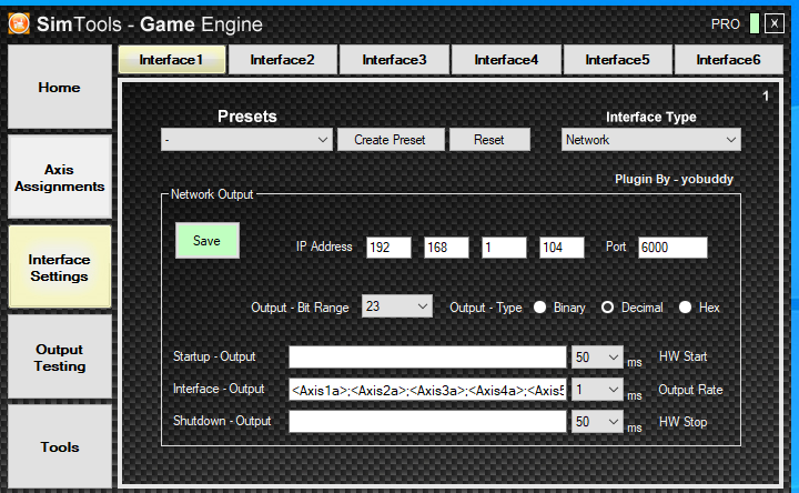

    I'm getting an update rate of 67 hz or 67 packets/s. (15ms between each UDP packet) from Simtools game engine.
    Even if I set the update rate to 7ms.
    Each dof is set up to one axis with 100%. (No mixing, and no filters)
    The kinematic is programmed in the motion controller.
    The interface output: <Axis1a>;<Axis2a>;<Axis3a>;<Axis4a>;<Axis5a>;<Axis6a>;
    When measuring the time between each packet in the motion controller, it is steady at 15ms between each packet received. Also measuring the average over 1s. It does not matter if the game is in "idle" or in full action.
    So it does not look like a performance issue.
    Its quite annoying, since it does result in jerky movements in the rig.
    The servoes are quite dynamic, and are tuned quite stiff.
    The gears are also quite dynamic. (Planetery gears from Apex)
    PC spec: AMD Ryzen 9 3950x, 32Gb ram @3600MHz, RTX 2060 Super (Waiting for RTX 3090)
    (This computer is brand new and Windows 10/64 bit fresh install)
    Have the same results with this PC spec: Intel I7-8700, 32Gb ram @2600MHz, RTX 2080TI.
    Question: How can I improve the packet rate?

    Also, I'm guessing that the interface output Ie. <Axis1a>;<Axis2a>;<Axis3a>;<Axis4a>;<Axis5a>;<Axis6a>; is as required by the Omron controller? Actually, a screen shot of your simtools interface settings my help.

    I'm using socket service in the Omron motion controller, so I do have full control of how to decode the data.
    Attaching a picture of the interface settings with 1ms update rate. Does not matter if I put any number from 1ms to 15ms. The packet interval is still 15ms, InterfaceSettings.PNG

    I don't see how your output string could work when using decimal without delimiters. Hard to analyze though when you don't say what your controller model # is.
    Edit: Didn't notice ; as your delimiter on my small phone screen.
