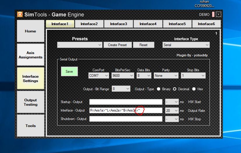

    I have used Eaorobbies @eaorobbie code with great success as 2dof. I am now attempting to expand to 3 dof by adding another axis "B" on pin 7. With my very limited arduino code experience I am missing something. The new axis when manual actuated by slider seems to work in negative direction but in the positive direction it goes to full lock the at the end of scale seems to snap back to position. Could some one with more coding experience have a look at what i have done and guide me/teach/show me the error of my ways.
    Thanks in advance

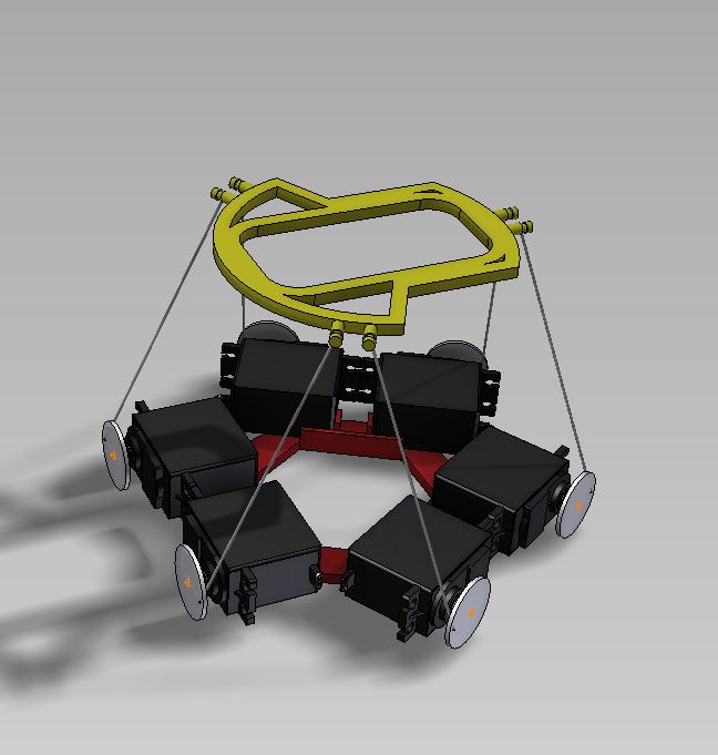

    See cad image of where Im trying to get to.

    on line 13 try this
    Code:
    const char kActuatorName[kActuatorCount] = { 'R', 'L', 'B' };
    there is a space missing after the 'B'
    here is the link i followed for expanding this code https://www.xsimulator.net/community/threads/my-project-guide-me.5682/#post-59262
    i am not an experience coder just compared it with my setup and saw this difference.
    if you still have any problems after that i could share my setup to you

    Thanks for your help. but i found the problem. End of block delimiter was missing from interface settings
    delimiter .JPG .

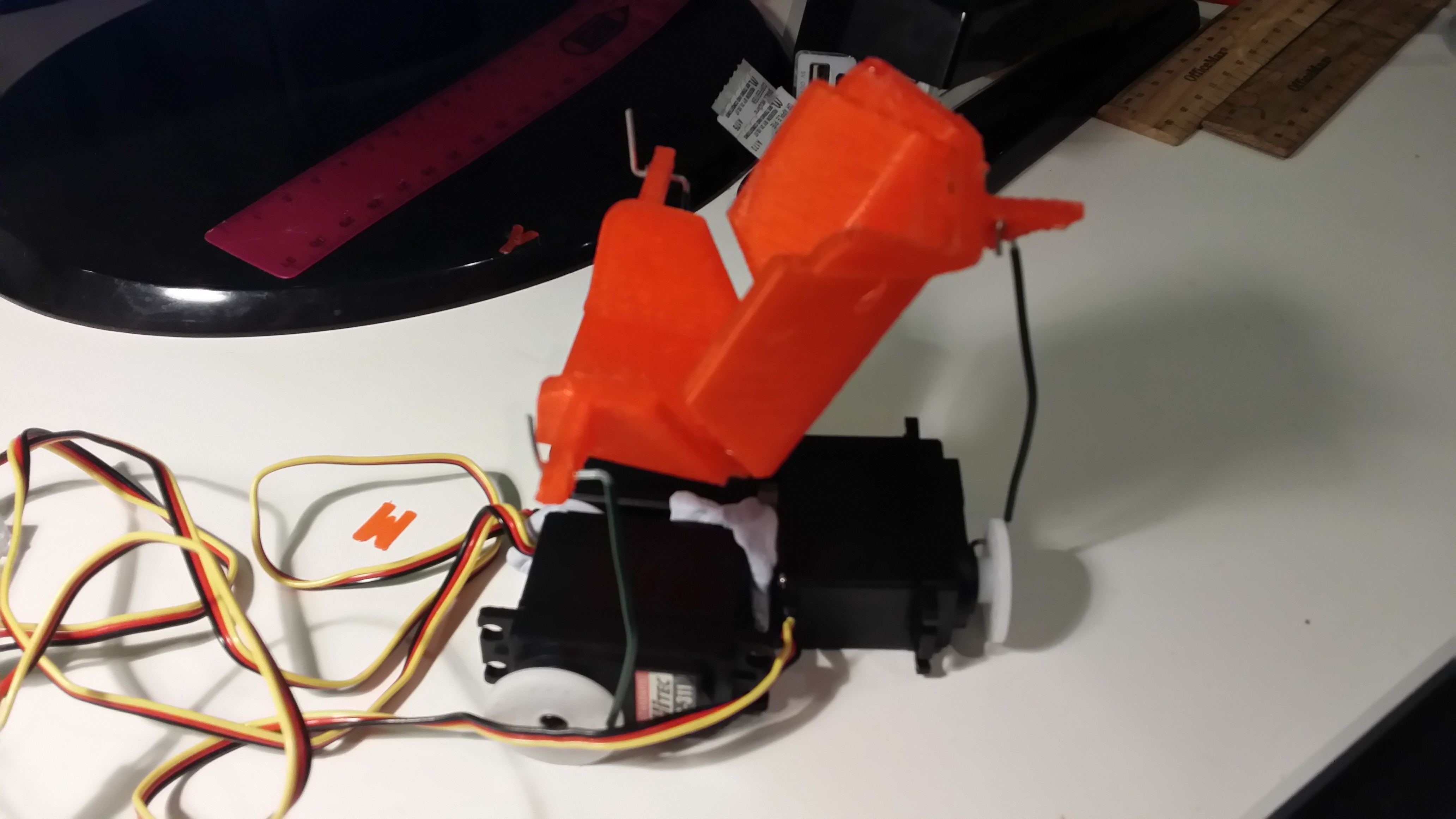

    Blue tack sim seat 3dof wobbly is up and running. I know the geometry doesn't work but but it was just to get heave happening.
    Next is dodgy Stewart platform like in the cad. above
