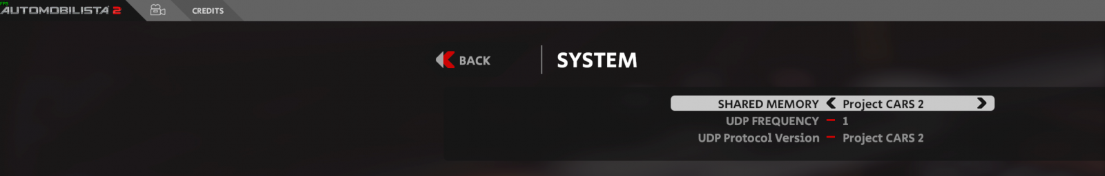

    In output testing all is working, games are patched and showing connected and started when starting up via steam. (dirt 2 and ams2) but no movement. Udp settings for ams2 are ok (project cars 2) and I set the -ui: pcars like I supposed to do. Still no reaction in game. When I return to game engine the output testing is still working. What could be wrong? thx in advance

    Automobilista 2 requires telemetry configuration:
    ❉ In steam add the launch option "-ui:pcars" this will allow you to enable UDP and SharedMemory. Its using the exact same data output as PCars2 for shared memory.
    ❉ once you have enabled shared memory in the system setting using the pcars ui you can then delete -ui: pcars from the launch options in steam to return to the AMS2 ui.
    ❉ Also adjust the max min settings in the Tuning Center.

    thx for the reply. I did set the startup like you mentioned in steam. no movement though.

    For Automobilista 2 you also need to set the required in-game settings as well.

    Ok, I got it working in all games exept for Project Cars 2 and Ams2. Game manager says "game running" but no motion. I did set the min/max manually. Started the game in steam with -ui: p cars. UDP settings are ok. I'm out of ideas.

    Can you please post pictures of all of your settings, including those in game and of TC while the game is running.

    For a while now there is now need to do the ui pcars trick its in ams2 own ui now :thumbs
