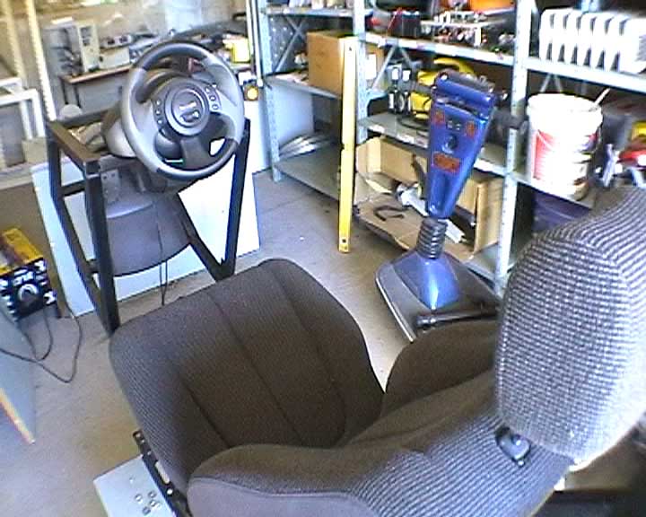

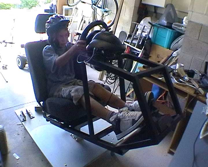

    UPDATE 17/01/08
    Made a cockpit
    A few more tweaks still to be done to the T-Bar, mount a monitor and shell the cage, but now can concentrate on the positional feedback part. With the help of a buddy I'm going for a home-made optical sensor system and count the number of strobes per revolution of the lead-screw.

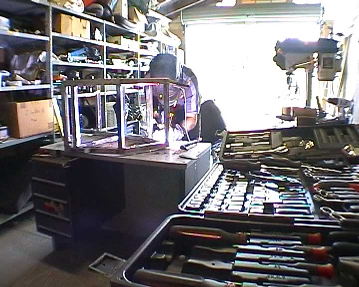

    Here's what I did on the 28/12/07 EST ..
    Video posted up on YouTube documenting it
    http://www.youtube.com/watch?v=8QAhLHSW2IE
    [​IMG][​IMG][​IMG][​IMG]
