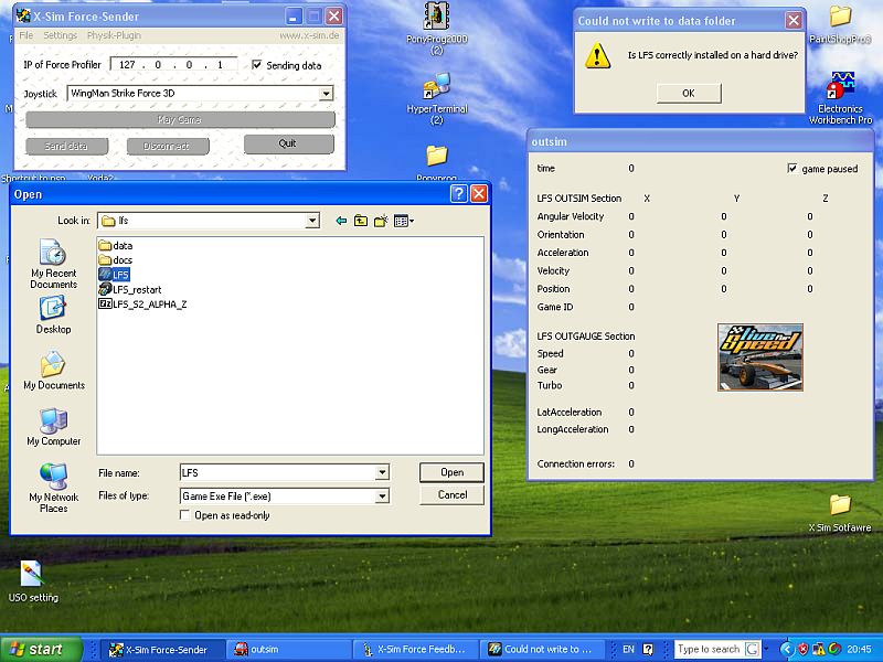

    Hi Guys its me again making hard work of what will turn out to be a simple fix...Basically have now got my Tronic AMC & H Bridge Circuits functioning and wanted to interface them with X-sim Running LFS .. Have donwloaded X-sim 1.6.9 and extraced all the files into a folder on the C drive called X-Sim i then loaded and extracted LFS S2 onto the same C drive but in its own Folder Called LFS :? ...Then i ran Force sender and Loaded the LFS Plugin selected the Game EXE location (As Above) and specified the YODA2.exe and Buffer.Dll Location and pressed Send data Which linked up with the Profiller OK But When i pressed Play Game This erro messgae came up ( See Picture Below ) Help again guys please or point me to the correct post if this issue has already been discussed ...also is there a way to remove all my exsisting X-Sim Downloads and start again in case i have corrupted some files ?? :cheers: should i have a YEF file at this stage ? as i have to cancel that option when prompted in the force sender setting options??

    first Happy New Year :hi: :cheers: .
    i`m only using Force Sender and Force Profiler. I don`t use Yoda.exe ore something other.
    That is my starting procedure. First start Force Sender, load the LFS Plugin and klick on Send Data. Then i start the Force Profiler, load the LFS.rnr file (Profile game config file) and klick on Start Simulator. After that i`m starting the Game with it`s one Exe. I`ve read in a thread here, that the startingbutton from the Force Sender is a little bit bugy. It is better to use the normal Game.Exe File to start the game.

    I do not use this plugin, version of X-Sim, or XP, so our scenarios are in no way similiar. However, since you haven't received any replies, I thought I would offer the only few things I can think of, which are:
    1.) The plugin is looking for a folder that doesn't exist?
    OR
    2.) The plugin is looking for a filename that doesn't exist
    OR
    3.) The plugin does not have permissions to the folder that it is being pointed to?
    OR
    4.) Possibly the game has to be configured a certain way to export data for the plugin?
    These are all guesses based on no experience whatsoever with LFS or your version of the plugin.

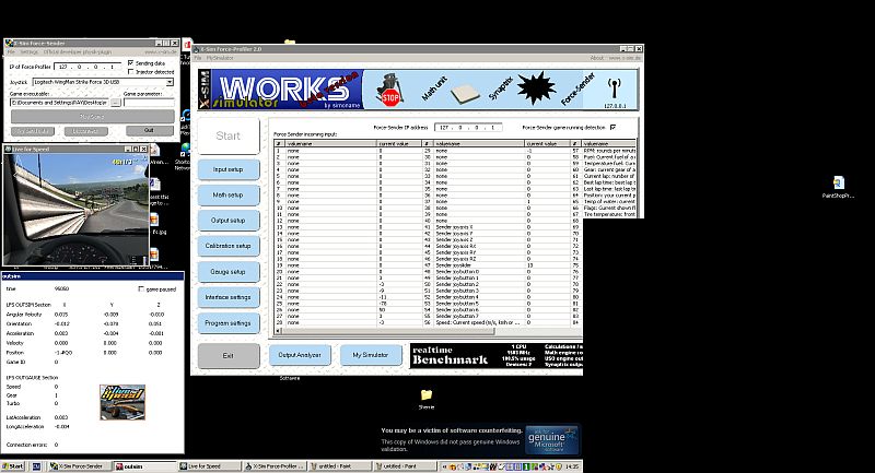

    Hi Guys Thanks for the Input .. The annoying thing for me is that i had this setup working on the other PC and then because i got my Electrical Interface's working, i thought now would be a good time to move to a better PC and Start all over again ... On My original XP pro system i was able to load force sender configure the files and point to the relevant bits without a problem hell i was even jumping when force sender started the Game and and i could see the Game values in LFS Outsim so thought i had it sorted. but maybe the directory sturcture was different ?? had so many versions of x-sim on that pc that i did a clean up and now am stuck ... like i said guys thanks for the tips will try them now and update this post accordingly :cheers: attached was a screen dump i just did after reloading beta ( Locked ) X-sim 2 ... seems fine so am sure i was following the instruction pretty well but problem still there when i try X-sim 1.6.9 :blush: so looks like am gonna have to wait for full release of X-sim 2. No given up yet though it must work cos you guys are using it, so look like doofus (ME) here must be having brain fade LOL:)

    Thanks Sirnoname Thaought i was doing something else wrong and having tried X-sim2 and got that to work .. much head scratching because i know that people out there are using 1.6.9 ok . So Will Have another play today and see how it goes.. Always greatful for replies cheers 8)
