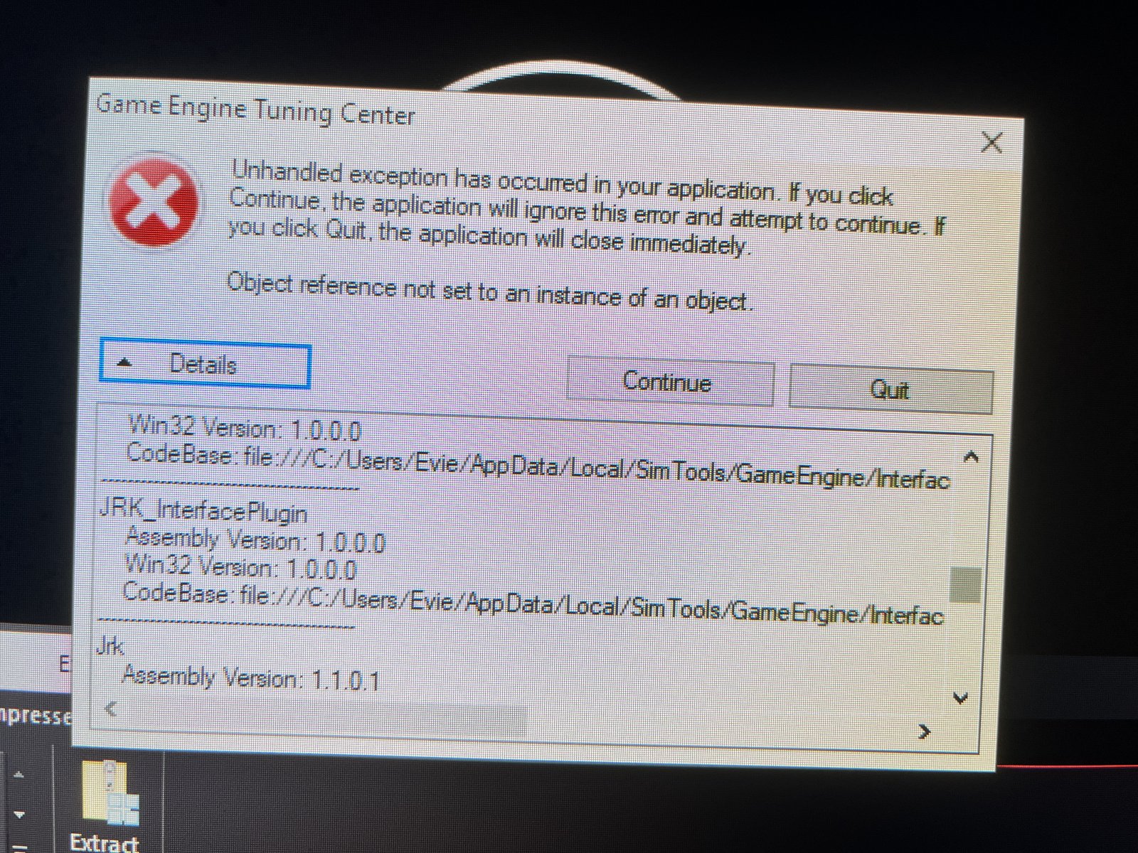

    Please copy and paste the full details of the error message.

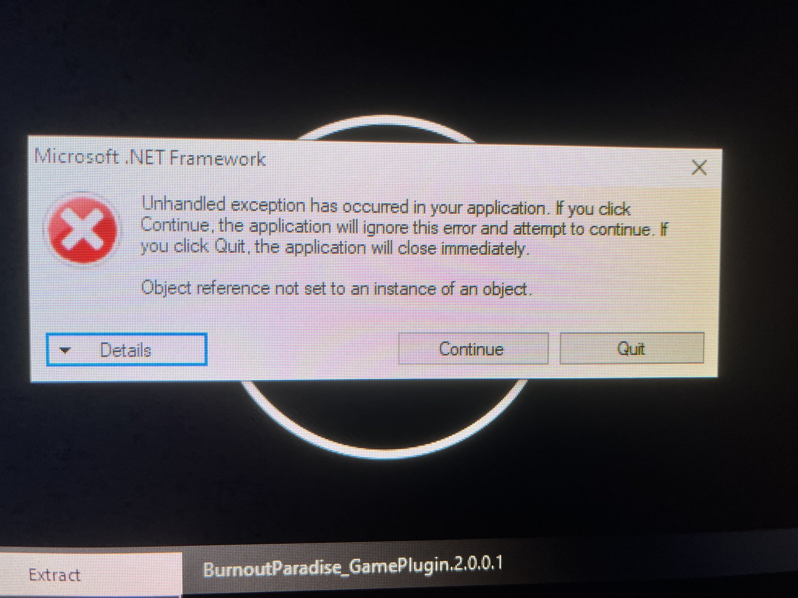

    Hi i have the same message after use the WRC2023 plugin with pluginudapter
    Unstall completly simstool and reinstal after
    For me i fix the problem
    Sorry for my english

    @leonaikikai,
    v3 plugins are for SimTools V3 only, and v2 plugins are for SimTools v2 only.
    You can not load a v3 plugin into SimTools v2 is all, so that is why your having problems buddy.
    You can install SimTools v3 and use it for WRC2023 thou, and SimTools v3 will work with your license also for v2, as it's a free update.

    Thanks for your help , i instal Simstool V3 and test WRC2023 Plugin

    Hi, it's the same, I have the same problem. Did this work for you

    The original issues was trying to use SimTools v3 plugins with SimTools v2, and they are not compatible. Is that what you have tried to do, or something else?

    A v2is license, yes, that must come from that. doesn't work on v3 so I'm stuck

    As per PM advice please contact the SimTools devs directly, so they can help sort out your license issue: https://simtools.us/contact-us/
