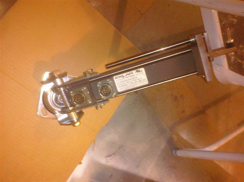

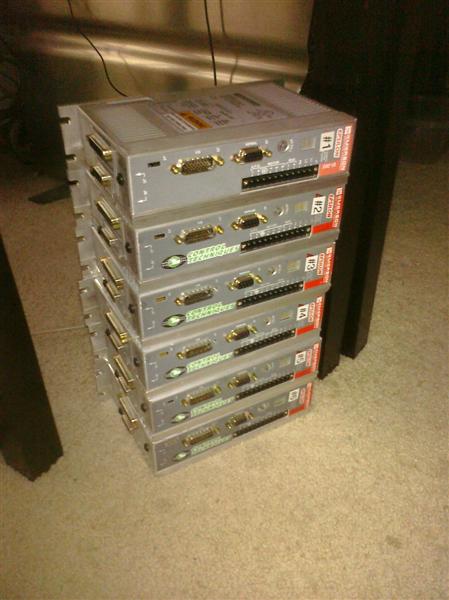

    I'm fairly new to the group, and I'm getting far enough along to share my progress on a 6DOF motion simulator designed for amusement park ride and real-world simulation. Here are some of the specs:
    • * Six Exlar GSX20 6 Roller Screw actuators
      * Six Control Techniques (Emerson) Epsilon Servo Drives
      * Modbus over RS232 (followed by a cascade of RS485 to each drive)
      * Fully enclosed in a Geodesic Dome
      * Interior projection filling about 180 degrees of the dome
      * Dell XPS 720 Quad core
      * Most likely x-sim and a modified version of 6dofMaster for software control
      * C# or C++ modbus drivers (custom)

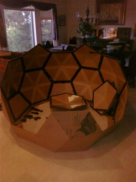

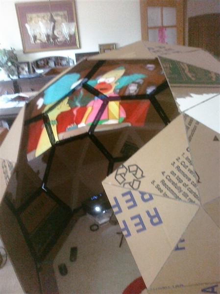

    Here are some pictures of the 6DOF in progress:

    Re: Paul Burke and dome projection... he was the inspiration, but I created a variation that uses only a convex mirror (as opposed to a half-sphere) and looks pretty dang good without pre-distorting the output. Paul uses some filtering technology that's apparently unique to QuickTime to correct for the spherical distortion and even if I could get that for movies, I doubt it would be available for any given video game.
    However... if you know of any filtering (for Windows), I'd love to try it. The motion-platform dome is a little small for full sphere projection, because you need to be able to keep out of the way of the beam (and the beam is everywhere). I did, however, test the projection off a real half-sphere mirror in a large room with vaulted ceilings... although it was distorted, it was pretty awesome - the movie was on just about every surface in the room :)

    Something interesting about spherical (or convex) mirror projection... you must find a projector that can focus at whatever the distance that your convex mirror is from the projector. If it is in focus when it reaches the mirror, it seems to stay in focus indefinately. If it is not in focus, changing the distance from the mirror to the wall won't help. This is much different than a normal flat mirror, which doesn't seem to affect the focus at all (you can have one a few inches away from the lens without any problem).
    I am trying to upgrade from a 1024x768 projector to a 1400x1050 projector, and it is very challenging to fit it into the dome unobtrusively because it takes another 1-1.5 feet for it to focus.

    Unfortunately, domes are much more complicated than simple curved screens :) Fortunately, my dome only cost about $60 + 2 days labor. The current version is painted with Behr Silverscreen paint in the projection area and looks pretty darn good.

    A few of things:
    1. The entire dome weighs 20lbs - probably substantially less than any monitor and monitor support system. Its very strong, though I would build it differently if I did it again.
    2. You are fully enclosed, so there is no outside reference to corrupt the illusion
    3. The image fills much more or your peripheral vision (side to side, and up and down). Ideally, you can't see anything that isn't projected without turning your head.
    4. If someone outside the simulator gets whacked by the simulator, at least its a rounded (cardboard) structure, not a steel beam.
    Bottom line: Who knows - I've never built one, but I think it is going to ROCK!

    Thats about how much area I project on in the dome. A standard 4x3 projector is on the floor under the screen. It projects on a 8.5 - 18 convex mirror situated behind about where the steering yoke would be, and the image bounces back (spreading very quickly) to the screen, filling the area.

    Its true that the focus is less sharp at the corners in my dome (though text is still readable). However, it should be possible to situate it so that is not the case. If you think about it, a dome should actually be more focusable because every beam of light has the same distance to the surface (whereas with a flat surface, the center is closer to the lens than the edges.)
    The trick is that the mirror must be in the dead center of the dome to achieve this, but its much nicer for a simulator if it is offset down a bit (so you don't have to look around the mirror). I'm not sure if they use a convex mirror in the canopy solution, but I think thats probably an important part.
    Eric
  20. ebinary
    ebinary New Member
    Jun 23, 2009
    90
    2Coins
    Let me clarify that. My geodesic screen dome is front projection. In this case, the focus should be able to be better than a flat screen. jDome is rear projection. In this case, it would be difficult to focus the edges.
