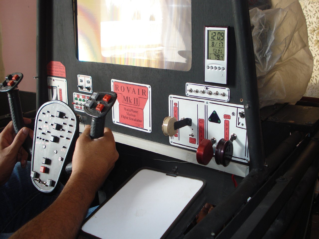

    Hello fellow simbuilders,
    Update 16.Jan.2009:
    http://www.youtube.com/watch?v=5rgwXlD6WHk
    here are some general-view pics of my Flight-Simulator project.
    I hope to be able to add a video soon.
    Merrry X-Mas
    Erich...

    I love the way you made that cockpit canopy on your sim! And what a lovely cockpit panel with levels, switches, leds and a fresnel lens!!!! :clap:
    Can't wait for a video!!!! Make it a two stage please, half with a GA plane and other half with a more acrobatic plane to be able to see better the range of motion and the speed! A view of the game screen while seeing the cockpit moves would be great too!
    About the weight that Egoexpress suggested: Its the best way you can go! I would made it motorized though, perhaps by sensing the load current on the motor and acting as servo moving that weight front and back and actually helping the pitch motor!!! (IDEA!! :brows: )
    Best Regards ,Thanos

    Hi Ego & Thanos,
    Great ideas! I worked out (empirically!) that for my construction that movable weight should be around 4-5Kg. And using the current draw and an electrically moved weight to get the correct balance is pure icing on the cake (just in time for X'Mas!!).
    I owe the switching, LEDs, levers, my whole control system, and use of a Fresnel Lens and tactile transducers to the goldmine of information available from Roland, http://www.simprojects.nl
    Now, if only I can find a way of tightening my proposed active seatbelt with just one motor, instead of the two I had in mind, one for each axis, I'll have one spare motor for moving that balance weight----today!!!
    Great stuff!! :clap:

    Hi Thanos, RaceRay & Ego,
    Thanks for your observations, comments and suggestions. The limited objective at this point was to check if the sim would move at all with a reasonable degree of agility. I had a whole lot of doubts with balance and power, being too heavy and not enough, respectively. The balance problem I was able to solve, removing an absolutely useless deadweight of ~6 Kg. located at a 30 leverage point (please see Post #2, Pitch Frame Bearing Location' in the DIY FAQ Section). I'm impatiently waiting to improve the DSMhb's power with the IRF3205 from where I have three options-- a) increase single motor torque by reducing pulley size from 4 1/2 to, say 3, and run the motors in high speed mode--b) use twin motors parallelled, with the cable wrapped over both (though I have some reservations about this)--c) look for a more powerful 12 or 24V motor. There is another option brewing also--use the WW motor (all steel in my case) gearbox section only and on it graft an 80/90 watt radiator fan motor. A lot of work to do neatly, but not too difficult!
    For the moment, I didn't question anything too much myself-- I was just glad to have some movement. Be assured, I will be addressing all the issues you all have so kindly pointed out. For one, I have been having the LCD on!! Big mistake (thanks Thanos!) I had the FS turbulence set at severe for wind and cloud turbulence, a 16Kt headwind and gusting 8kts. Yes, at the moment it does look a bit synchron, doesn't it? My friend STP weighs about 53Kg only--a bit light. It will definitely be a bit more sedate with an 85Kg pilot aboard. And RaceRay, sure, I'll be testing also under glassy conditions!
    Another thing I'm not happy about is my drive system. One deadloss thing I removed today was two springs located at the pitch cable ends that I think are causing secondary oscillations (a sort of mechanical ringing) when the motion is supposed to stop dead. (Ego, you have the pics).
    I have a long way to go, but I'm getting there! I have a benchmark in front of me--Thanos' Athens video---from which there is much to be learnt. Thanks for the encouragement.
    Regards, Erich.

    Hi Thanos,
    That was a priceless piece of advice! Turning off DIP Sw1 made all movements silky smooth and accurate. Even with the turbulence on, the movements were smoother---some of the roughness gone. The other thing I did was to remove the two springs at the ends of the pitch cable. These were the culprits causing some 'hunting' I could not get rid of even at Kp3!
    Many thanks for that advice.
    Regards, Erich.
