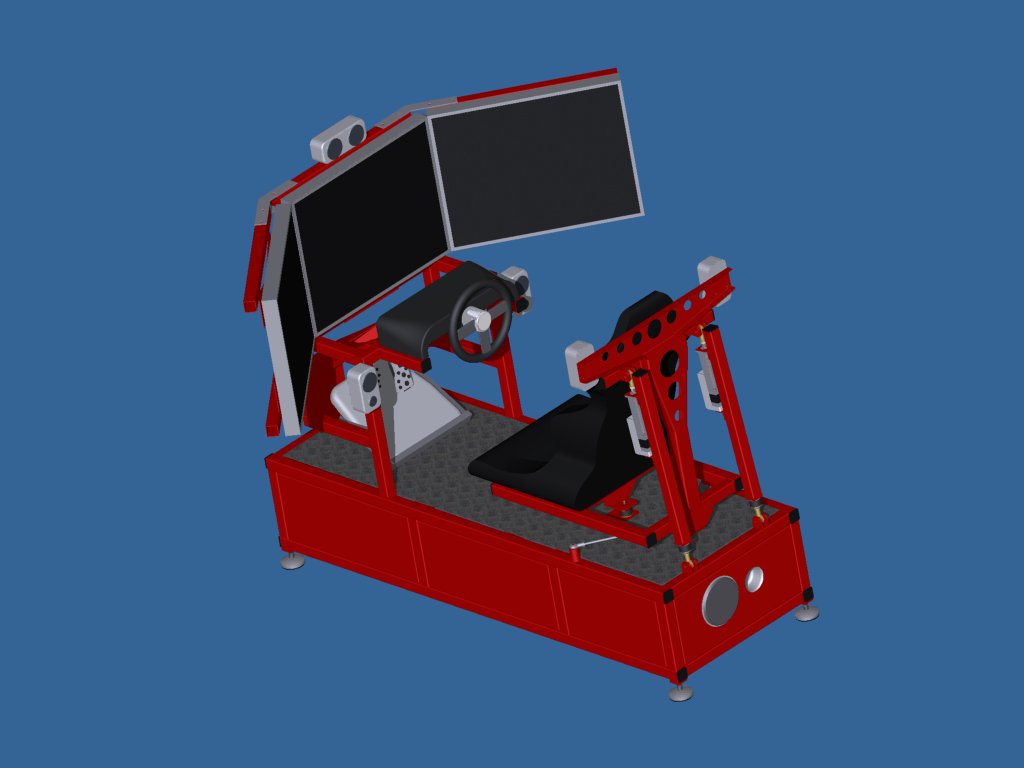

    HI
    I have finished the project of my simulator, now i think that i build it, but the xsim2 is only way for pilot snc5 ?
    I have tried to dowload xsim2 but the program asked me a key of activation, is it possibile to have this key ?
    And then, if i need to install xsim2 on another computer i need another key ? is it possible to install xsim2 on two or more computer.
    Thank you for gently response

    X-Sim2 is free as X-Sim1. Just as long as it is in BETA status, its preferable to just hand out keys to active BETA testers. There have been some bugs sorted out, and they may occur some others.
    Don't worry, you will get a key when your setup is ready ;D
    Thanks for the drawing. Did you tried out to implement the racing seat I've mentioned from redbulleyes? Yours looks kind of flat imho.
    Perhaps you'd place the actuator arms a little bit more away from each other (like forming a triangle while looking from behind), and shorten them a little, to meet the acutator topplate. As well I'd place the acutator arms 180° inverted, to show of the SCN5.
    But the rest is well done. :thbup:
    Regards
    Christian

    I think that in this week i buy the scn5 ( because the frame is almost complete ) and then how do I do for trying the actuators? without xsim2? must I wait for the end of the period of test?
    Thank you in advance and thank you to egoexpress for the suggestions on the mechanical setup

    Hey you're mixing up topics. The name of the thread is SCN5 3D file!
    I'll cut off your simulator drawing to a seperate thread.
    You will get a BETA testers key once your mechanical setup is ready. You probably should talk to MasterYoda and Charlypro, as you guys will be the first SCN5 plugin BETA testers :cheers:
    We will help you with the procedure when time comes anyway, so no need for detailed instructions right now. But you need the SCN5' at least!

    Please hurry up with possible mods (seat, acutator arms) so that we can add your drawing quickly to the forum header!
