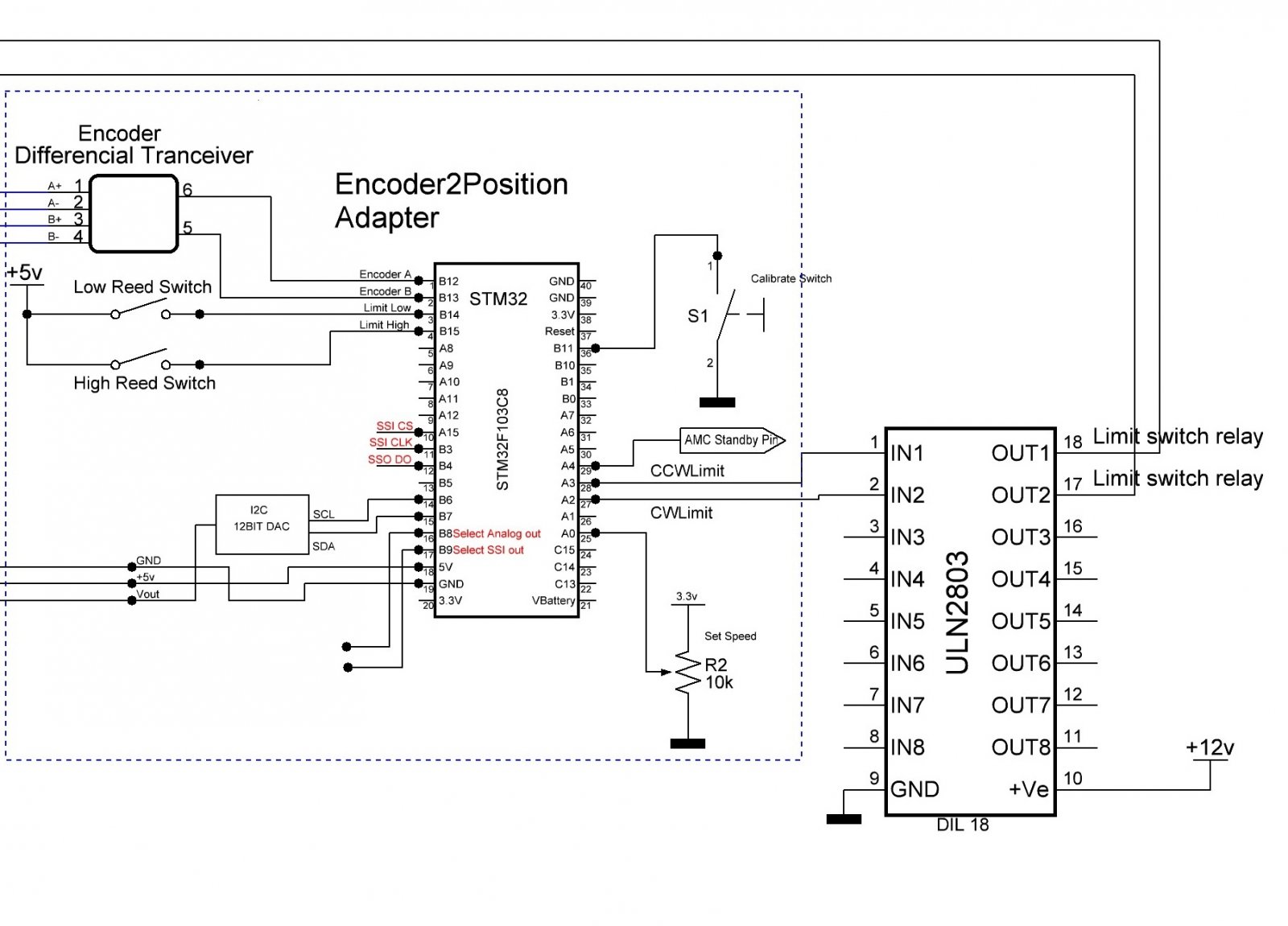

  8. Thanos
    Jul 6, 2017
    1,367
    Electronics Engineer
    United States
    2,830Coins
    +1,069 / 9 / -0
    You can use this breakout of the DAC:
    https://www.adafruit.com/product/935
    There is no need to use the encoder differential transceiver, in your case connect the encoder directly to A and B

  11. Thanos
    Jul 6, 2017
    1,367
    United States
    2,830Coins
    +1,069 / 9 / -0
    You need to hook up limit switches for the Encoder2position circuit to evaluate the total stroke of the actuator...
    The limit switches are calibrating for calibrating essentially. But if are activated again later they will reduce the travel length a little more ;)
  12. Thanos
    Jul 6, 2017
    1,367
    United States
    2,830Coins
    +1,069 / 9 / -0
    And that is exactly the reason I didn't want to have to deal with numerous different encoders out there... The circuit will automatically SCALE the output to any number of resolution the encoder has....
    The limit switches will mark start of end of position of the actuator and the encoder count in between will spread evenly to 0-5v output... no mater how much CPR is the encoder...
