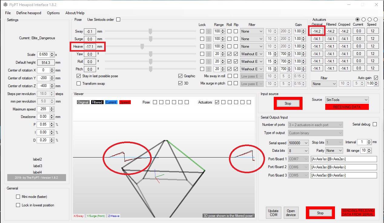

    3DOF, DC motor, Arduino, 6DOF
    I tried to use the thrust up until I reach the value of twenty. It goes up extremely rapidly and keeps on growing. When I release it, it goes in the opposite direction and I recorded -14. Yes, it quite high.
    My rig is shaken quite a lot.

    This is only in SRV? ship is ok?
    If so, change the % of force in the XML for the problematic value

    This is exactly what I'm doing right now. So far, I went down at 25% and I am reversing the pitch, maybe the roll too but I'm not yet sure.
    The up/down left/right thrust had to be tone down, even for the ship. I did it in hexapod interface.

    It does happen to me too to reach 14 on SRV when thrusting up, but I think it was like that before. Because I overwrite the XML value you have it changed your last configuration.
    Anyway theses are the value that the game give us. Unless there is another one I didnt catch, we cant really do anything about excel modifying the force via XML or the Tuning center (but this will also affect force on the ship so kinda out of the equation).
    Will check more on the weekend, but I think theses are the values that we are stuck with.
