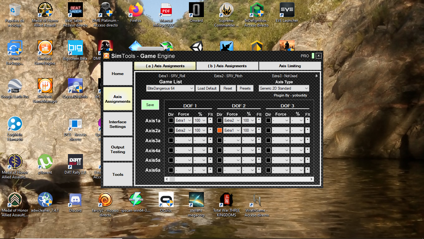

    Hello, good morning friends, does anyone have a simulator 2 dof so show me how the game engine is configured in axis 1 and axis 2? In the last update (update 3 of 07/14/2020) of elite dangerous horizon vr?
    picture show config for srv the ship move whit pitch & roll,
    I change the config every time I change vehicle, is there one that works without having to change it?
    I use google translator i Speak spanish. Greetings and thank you very much
