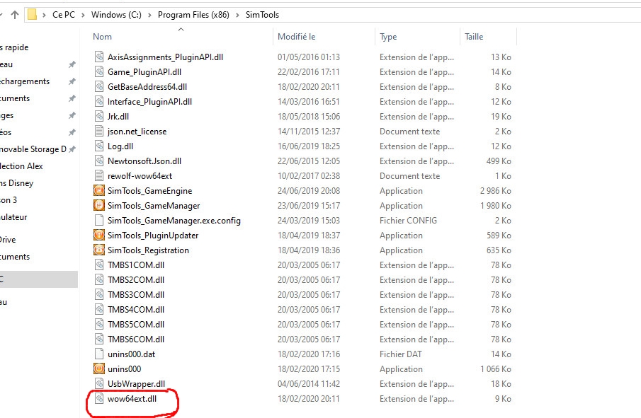

    The one surrounded in red, that I should remove?
    Thank You !!!

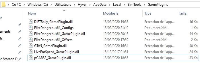

    No not that one. The one in the plugin directory. Located located usually on c:Your usee\appdata\local\simtool\simtoolplugin

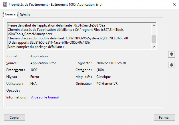

    Also, go into the windows even log and find the error related to game manager and post it here
  6. AlexWinter
    AlexWinter New Member Gold Contributor
    Feb 17, 2020
    13
    83Coins

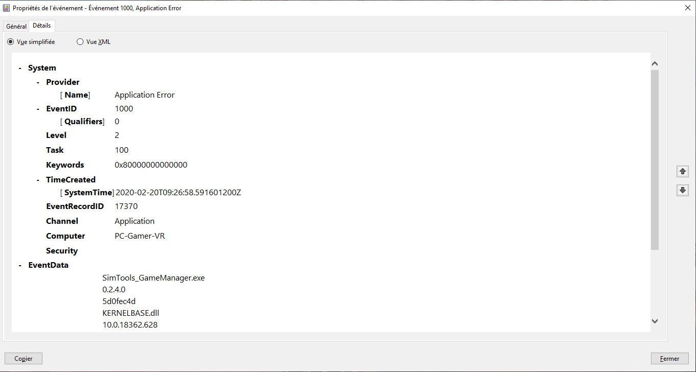

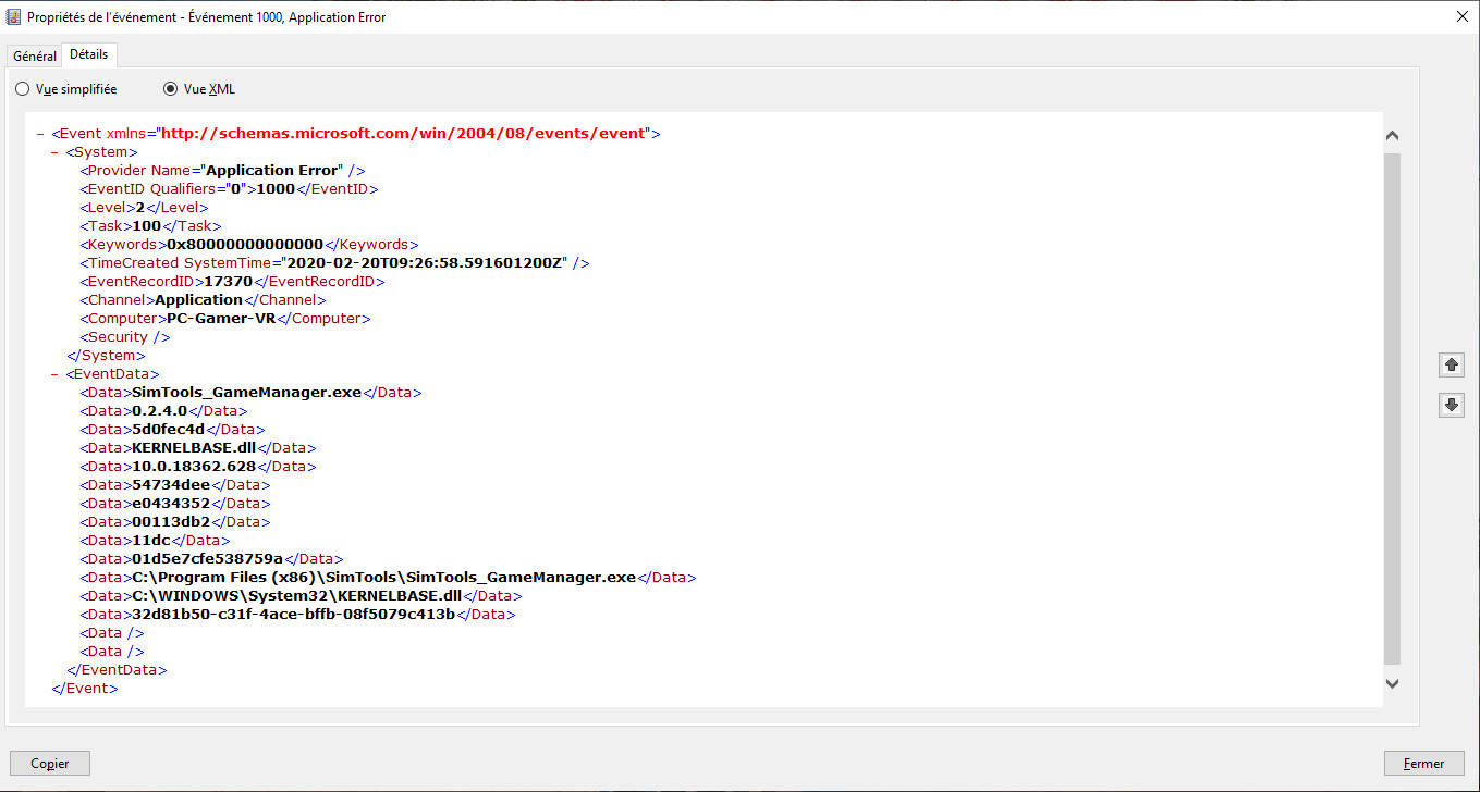

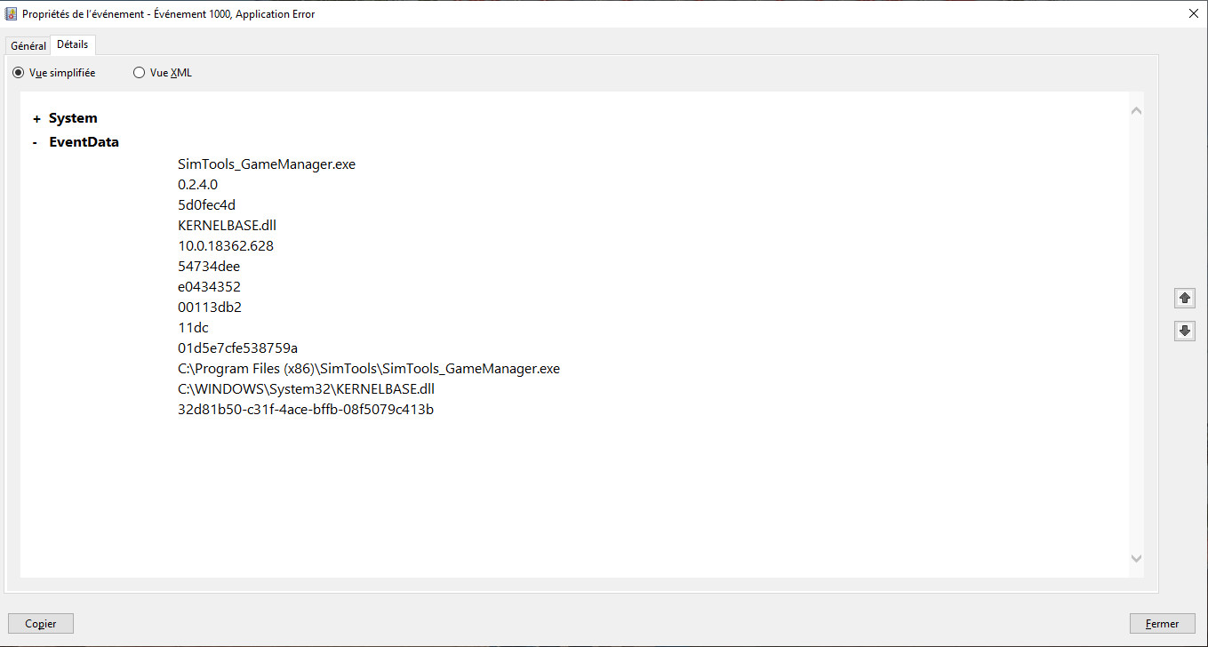

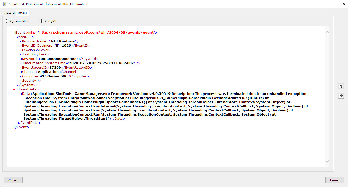

    in my error log : 1.jpg 2.jpg 4 bis.jpg 5.jpg 6.jpg 7.jpg 8.jpg

    Ok thanks, it seems the wow64ext in the programfile directory may not be up to date.
    Try updating your simtools to the latest to see if it fix the issue. Normally the file wow64ext should go bigger in size

    In the windows log it tells me about the problem of Kermell.dll maybe that makes my GameManager crash with Elite ...

    I'm quite sure the wow64ext.dll you have on "C:\Program Files (x86)\SimTools" is not the one thatr come with the latest simtools. I had this happened to me in the past because I had the one from rewolf. We can even see the txt file from it.
    I suggest you unsintall simtools completely, delete the simtool folders if it is still present "c:\Program Files (x86)\SimTools" than re-install the latest version (2.4)
    You will see that the wow64ext.dll should be higher than 9kb in size that you currently have.

    When I download from simtools.us the wow64ext.dll = 9ko
    Simtools from xsimulator.net the wow64ext.dll = 769ko
    You’re right! Thank you for your time
