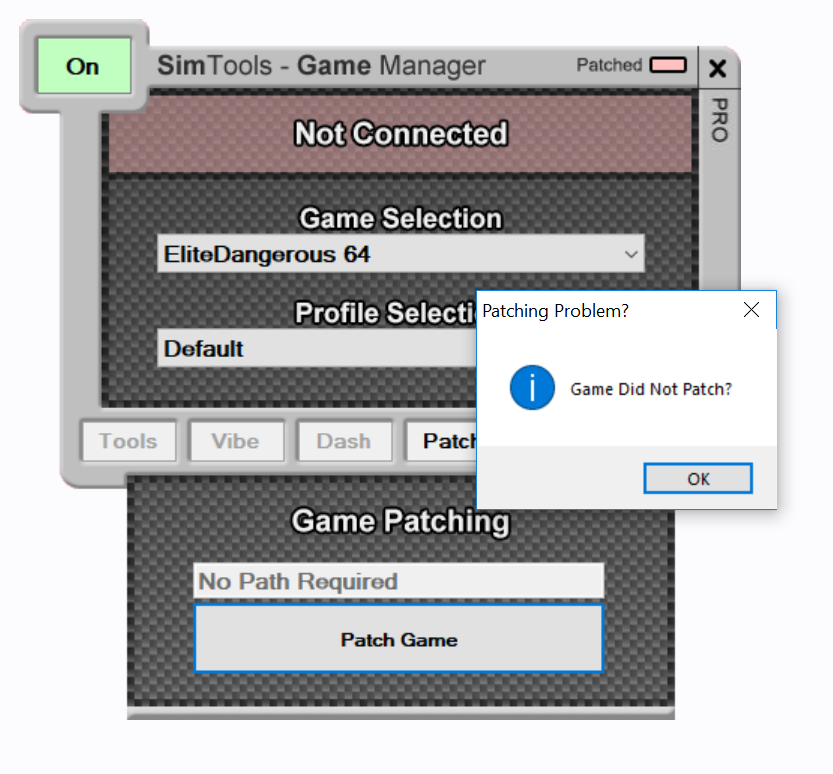

    Hi @Wagnard, I'm getting this message when trying to patch the game using your plugin. Do you know what I may be doing wrongly?
    I downloaded the plugin, unpatched the game using GameManager in admin mode, closed GameManager, dragged the plugin zip to PluginUpdater window and then tried patching using GameManager in admin mode again.
    Thanks in advance!

    That's weird, try again I would say? Be sure to run as administrator for game manager. Sometime it doenst work first time.
    Is there other message before this one?

    No, that’s the only message I’m getting
    I’ve tried installing SilentChill’s plugin — that one worked. Then I unpatched the game, installed your plugin and tried patching, but the same message appears.
    I also tried rebooting without any luck.

    Do I need to do anything with xml file? I do not see it in the zip file of the plugin.

    Weird I'll check later.
    Be sure you have the latest simtools

    Can I know ,where on your HDD, simtool is installed?

    D:\program files\simtools

    Ok. That's the reason. Currently it is hardcoded in the plugin to be in drive c.
    Either you wait for me to update (will take a little while I have work today) or simply reinstall simtool to to D:\program files\simtools

    Just realized I did a typo, I of course meaned to reinstall in C:\program files\simtools
    Or just wait for me to update

    Thank you very much. It indeed worked after I moved the SimTools installation to C:
