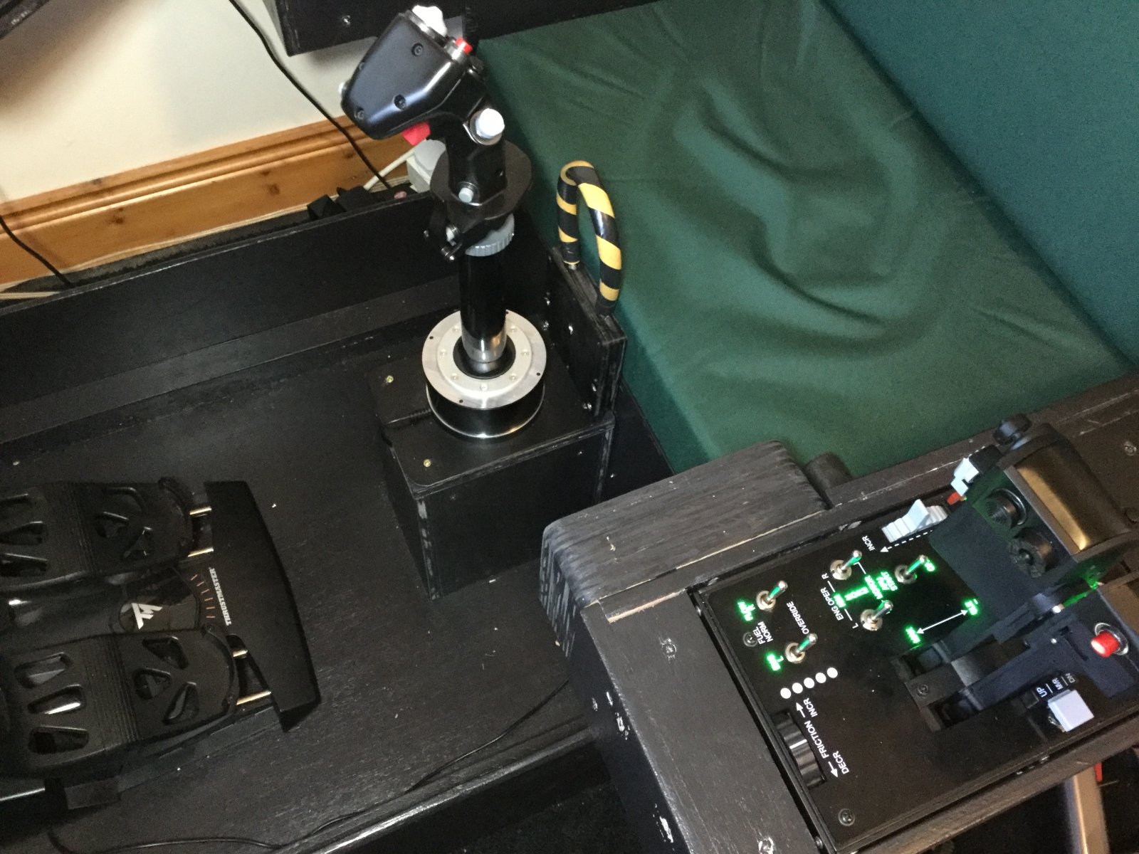

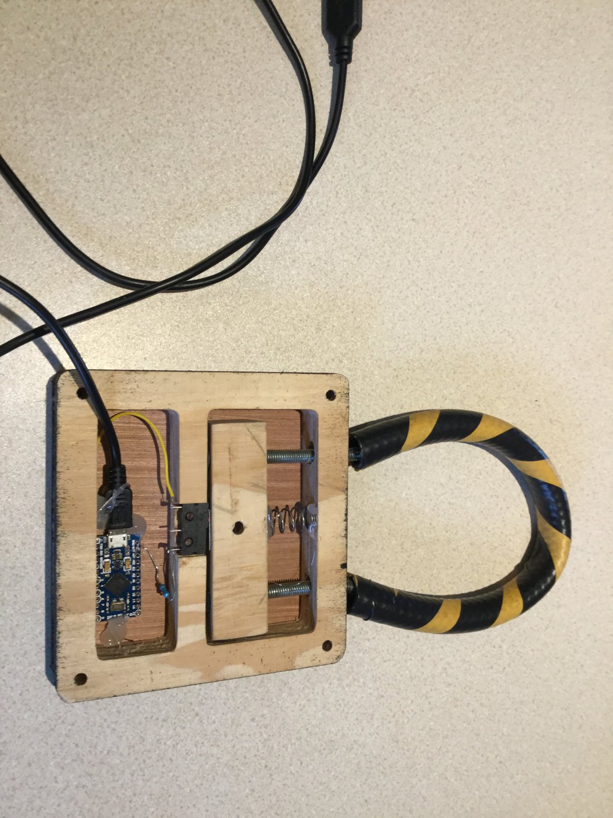

    Built this a while back and thought I would share it. While flying in DCS in vr it was impossible to find ctrl and e on the keyboard to eject before bursting into flames. I made an ejection seat handle. Basically a micro switch, arduino board which replicates ctrl and e being pressed 3 times. A spring and the handle made out of a piece of stud bar and garden hose with black tape around it. Its a bit of fun and works a treat.
