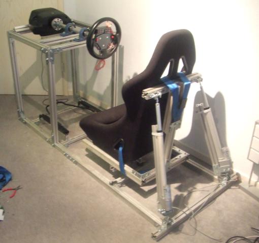

    Let's try it with firgelliauto actuators and Tronicgr' DIY motion controller 1.5 ...

    Hi Ego,
    that´s the first time i see your Sim, looks great!!! The Actuators looks very massive an stable, too. I am a little bit surprised, that they reach 75mm/s, thought they could only reach round about 40mm/s. You really should try to change the ratio of the transmission. The Actuators are build to move heavy weights and not to move very fast. So, i think > 150mm/s should be possible for a load of 10kg on every actuator without any problems, and with the build in motors.
    By the way, please tell me, what you paid for the profiles and from where do you got them.
    ( I hope, the dual driver arrives today, still not there, tho the trackingsystem told me, package was send 4 days ago :-( )

    What is the model number of your actuators. Looking at the prices on the Firgelliauto.com web site they seem very reasonable compared with others I have looked at previously.

    Hi Roadster
    Welcome!
    They are quite slow compared to the Frex ones. Dont know if I should recommend it to buy them right now.
    And they need reworking in order to be able to connect the rod-ends as well^^
    If you want to buy some though, then look at these ones for a Frex-style sim.
    http://www.firgelliauto.com/default.php?cPath=109
    Connecting them to 24V makes them run faster ;)
    ego

    @Roadster
    Do you really think that I dont know the specs of the SCN5? They are a piece of art. Nearly a miracle!
    But just for an example Thom Theisson' Frex video.
    He set the speed to 10000 (whatever for a unit) though 16000 is possible. But ask him how long he can take 10000. Ok, its impressing for show purposes, but I dont think one can sustain this speed for more than 5mins.
    The firgelliautos, on the other hand, are crap and slow, but cheap. But they can be controlled by connecting them simply to a DC motor driver.
    Imho the 24V isnt a problem, as they wont drive with high speed under load permanently.
    Though they are much slower than the SCN5, I think they could be fast enough for a nice ride. Keep their price in mind.
    Here in Euorpe we have to pay shipping and customs on top!
    I have to test them under better conditions. After this test I'll report back.
    Besides that. I thinke that they are rated for 12V, because the end switches are too small to stop them at 24V. They just run over them ;)
    You'd had to build an interface which communicates with the controller of the SCN5.

    kjg71
    Last year I ran tests with my 24v 3000N 10mm/sec linear actuator. In one of the tests I used a Lab bench supply and gradually moved up the scale until I juiced it with 80 volts. It moved just over 3x faster, I timed it by placing a ruler beside the actuator 'ram' and stopwatching it. This is inline with the theory of doubling the voltage doubles the speed. At 40 volts the motor got warm slowly, but at 80 volts the motor got warm very quickly, I must have run 80v into it for about 2 complete extensions of 300mm (in and out) and it began to smell of warm oil, I wouldn't advise it but it showed the screw thread was up to faster movements.
    As ego has inferred in other postings, you have to be careful what nut you get with the linear actuator. ego knows which one is the best to look out for, I can't remember offhand. The one in mine is a nylon nut and I have had to machine (well a mate did) a brass 'bush' to stabilise the ram on maximum extension as at hi-speed this will get unstable.

    @Kyle
    Between slightly overvoltaged and driving an actuator with 3times more power is a difference.
    The actuator itself is rated at 2per sec and 100N @12V.
    Please watch at firgelliauto website for the different models.
    By setting the current to max of 24V doesnt mean, that the acutator gets permanently 24V. Just the peak voltage will be 24V.
    With 24V they drive a lot faster ;)
    The problem is imho the plastic nut.
    BTW: I opened a thread in the actuators section for the firgelliauto actuators...

    Heres a short vid that shows the self-centering procedure of the frame with Thanos' interface 1.5 and 12V PSU.

    Here's another vid!
    Thanos' AVR Controller 1.5 and actuators work fine together now :yippiee:
    (12V powered still)
    http://www.youtube.com/watch?v=STI_tkt8fnE
    Its running with LFS already right now :dance1: :dance3: :dance5: :dance2: :dance6:
    I'll make a more cinematic video with GTR2 and beamer at the weekend. Have to finetune the settings a little now.

    Yeah, It works amazingly well! Can't wait to see it in action with the faster-calibrated firmwares I've sent.
    :clap:
    Perhaps you could try with 24volts for faster extension speed... If I remember well you are powering it from two batteries placed parallel? Put them is series and try it. But watch the motor's temperature...

    No, I haven't loaded the car batteries yet. Currently its powered by a 12V 2A Laptop PSU. (Just for the testing procedure).
    I know that it is too weak.
    I have a 5A fuse connected between the the h-bridge and PSU as well
    I'll flash the more direct firmwares you gave me now.

    @24V across the rails, would the 15V zeners need to be upgraded to handle the potential difference between gate and source of the FETs? :blush:
