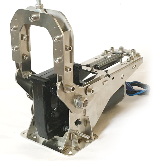

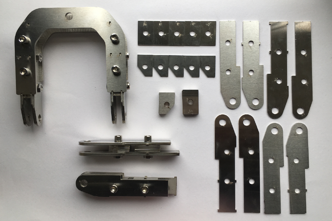

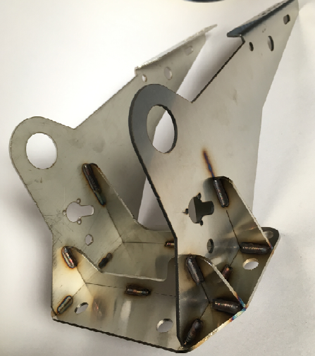

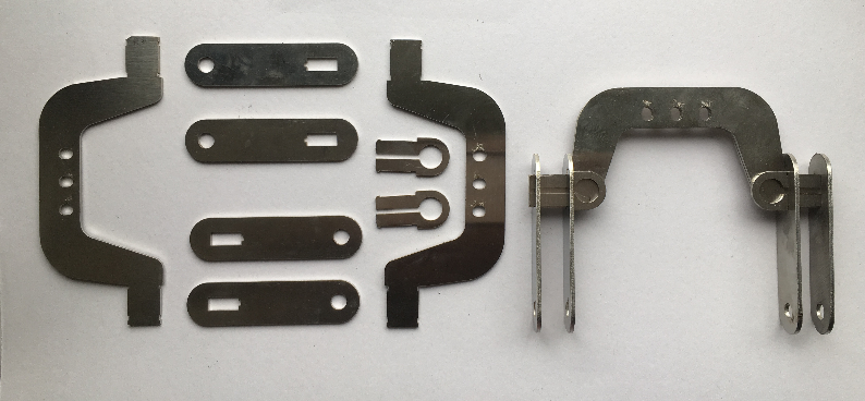

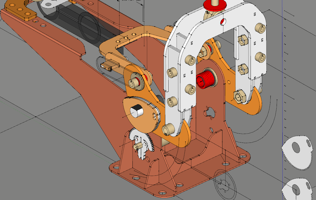

    Efficient quiet compact
    Use laser cutting stainless steel to assemble a small amount of welding
    150W*3=450W
    Weight 75kg
    Load test
    Noise test

  4. Gadget999
    1,971
    12,035Coins
    +488 / 10 / -0

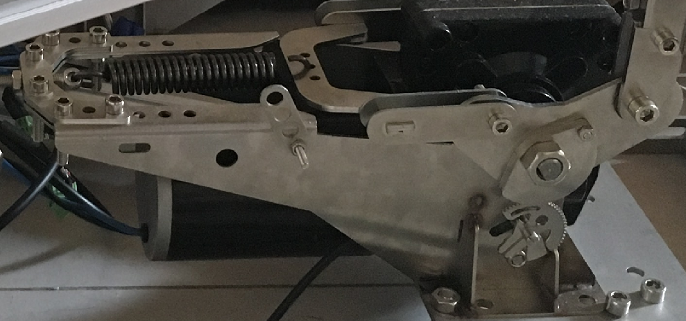

    i like the idea - can you fit more springs for more lift ?
    this concept will work on a 6dof also ;)
    the only problem you need to consider is if something goes wrong and the motor tries to rotate 360 degrees

  6. fzxj520
    fzxj520 Active Member
    May 14, 2015
    176
    1,341Coins
    +90 / 1 / -0
    Reasonable use of spring can reduce motor load and improve commutation speed
    In fact, many motion simulator designers have added springs to their designs

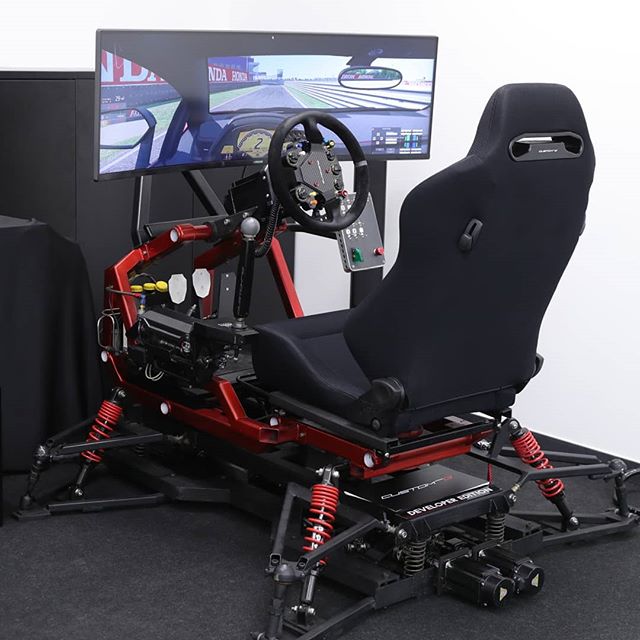

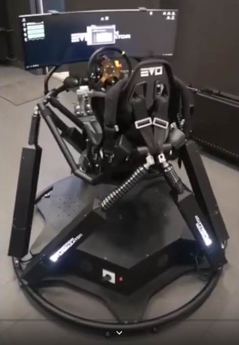

    Some photos
    Evolve Motorsport
    Custom G Development

    Yes, it can work on 6 DOF ===》Evolve Motorsport

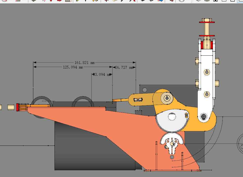

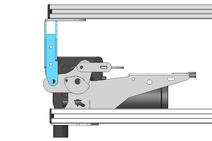

    I don't know what you mean. I don't know if this picture can answer your question

  12. RacingMat
    2,233
    21,058Coins
    +2,092 / 21 / -2
    Ok thanks
    - white U arm is going roughly up and down
    - Spring is here to compensate part of gravitation force during the lifting.
    But how the seat is guided up and down?

    so if you were using this principle on a 6 dof, what spring rate would you use? If the rig is say 180kg inc person and peripherals, would you use 6 x 30kg rated springs?

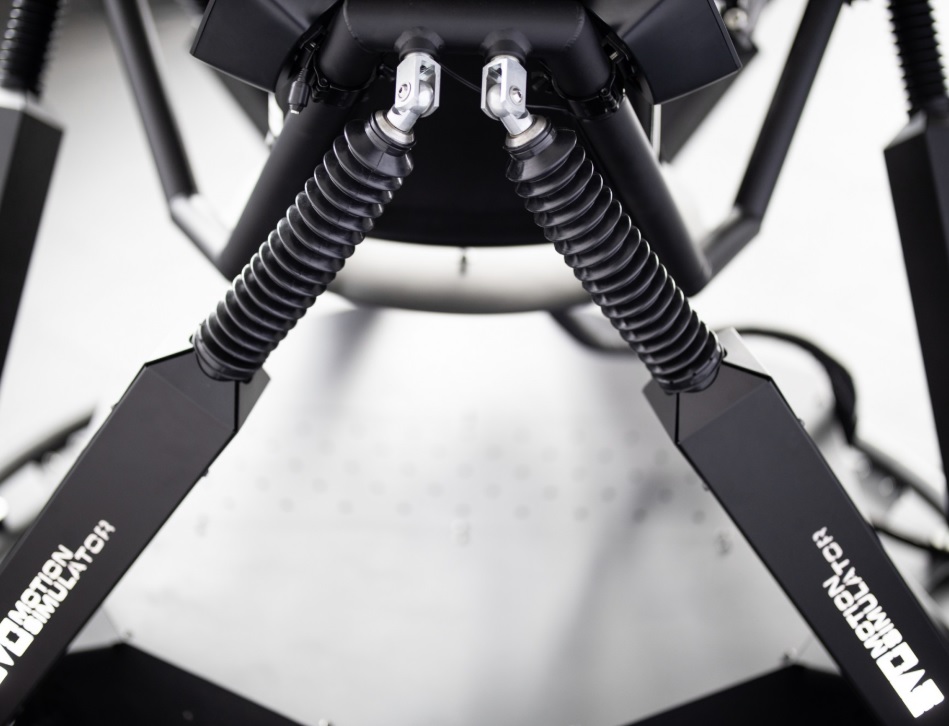

    Where is the spring in the Evolve?
  15. SeatTime
    2,572
    Maybe he thought the dust bellows were a spring?

    The spring rate is not defined in terms of weight, but as force per length (e. g. N/mm).
    For calculating the desired spring rate, you need to know your overall weight plus the maximum travel distance of your motors or actuators.
    You probably want the fully loaded rig to remain in neutral position with idle motors. And you want the springs to support the motors along the entire travel distance, or at least a large part of it. These could be the parameters on which you can base your calculation.
