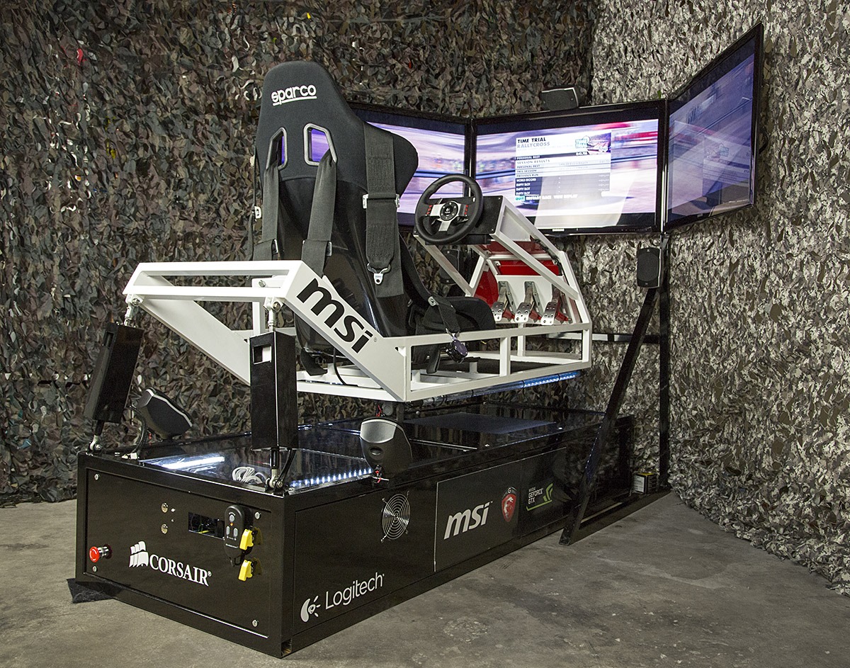

    My plan is to use 2 SCN5's with a u-joint under the cockpit. After looking through many DIY builds I found the E.B.T.R. which I'm thinking of using to start my design.

    The following are observations and suggestions, not criticisms, the EBTR design would work but likely could be improved.
    I have no experience with the EBTR, but it looks to be a fairly hefty top frame, even for a full frame design.
    There are options other than the SCNs. Quality DC motors are more powerful and a lot quieter, the SCNs in full song sound like a cage full of demented budgies.
    If you like what can be done with a project inspired by an existing offering check out @Milton's rig : https://www.xsimulator.net/community/threads/cxc-inspired-design.7709/
    Also a look at existing member builds, that may help you refine your own project ideas: http://www.xsimulator.net/community/forums/diy-motion-simulator-projects.22/
    You will find plenty to get you started in the FAQs, from design software, dimension of sims, to PSUs, pots, motors, JRKs, Arduino code and Motor Monsters, plus heaps more: http://www.xsimulator.net/community/faq/

    I don't know what your budget is, but for what you want to do a G-seat and a Direct Drive wheel would work a treat. The EBTR looks to have sound deadening boxes around the actuators and the frame from its design is maybe made of aluminium.
