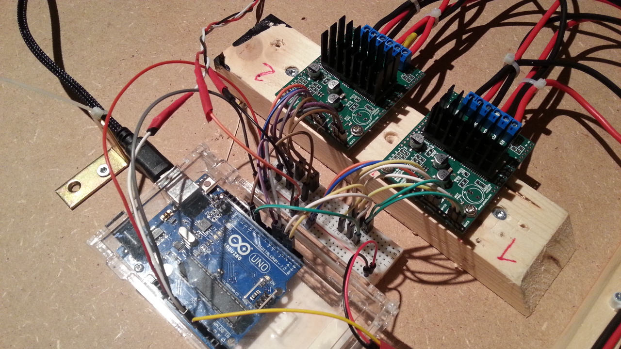

    short reply : VNH5019 and Ard Uno if less than 100W motors are used or Sabertooth 2x32 and Ard Mega.

  6. Pit
    3,013
    30,409Coins
    +3,088 / 31 / -0
    The Arduino is the controller and the VNH5019 the driver, you need both of them. The Arduino is powered by the USB cable (5V) and not by the psu.
  7. Pit
    3,013
    30,409Coins
    +3,088 / 31 / -0
    for example

    then..for my 2 motor 24v
    - n° 1 Arduino uno (now Arduino uno R3?)
    - n° 2 VNH5019 (each card one feeder?)
    ability to find connection scheme of Arduino and VNH5019?
    thanks again and big greetings

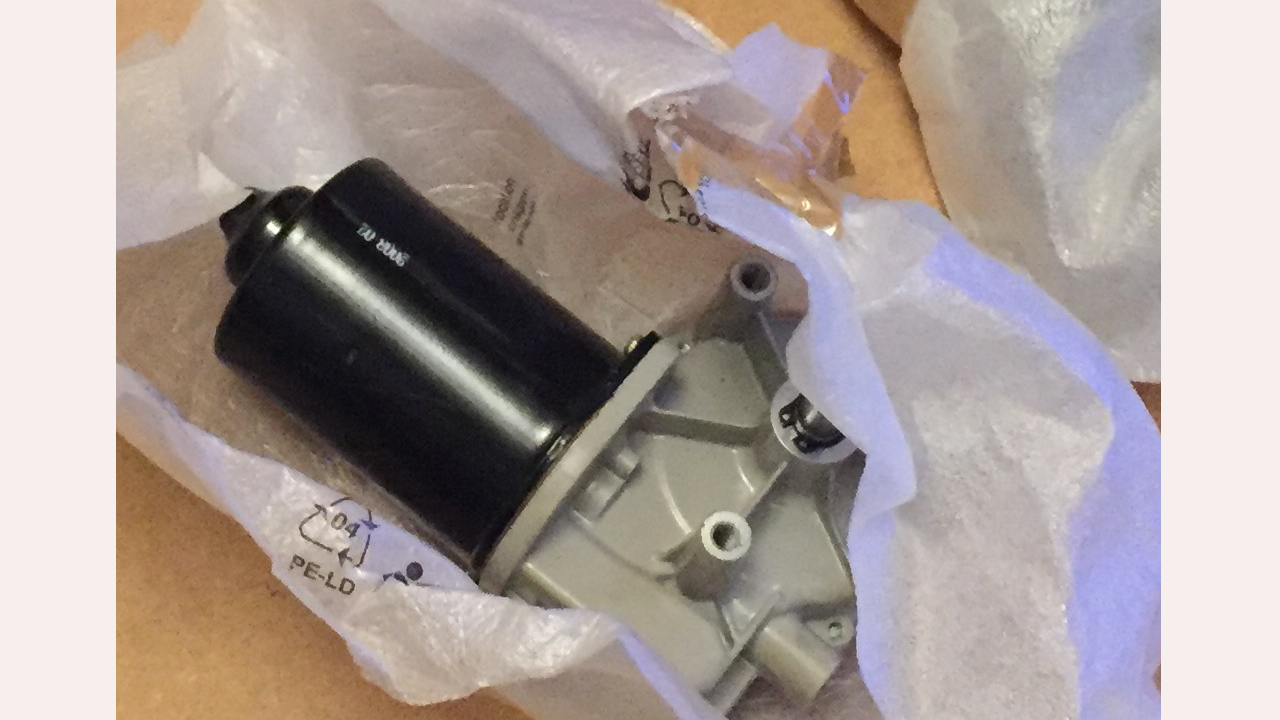

  10. MotoGatto
    MotoGatto New Member
    Dec 30, 2015
    23
    Torino
    450Coins
    12/24v
    30/50w
    64 giri al minuto (24v)
    coppia 15 Nm
    I hope it's enough
    this is the information that I have given
  11. Pit
    3,013
    30,409Coins
    +3,088 / 31 / -0
    IMO you should be fine with only one VNH5019 h-bridge for both motors. https://www.pololu.com/product/2507. You need (as already mentioned) an Ard like the Arduino Uno R3, either original or a Chinese clone which works in most cases without any issues. All Ard related information like codes and wiring you will find in the FAQ section. If you will struggle with the details we can help, but we do not help if users do not read and learn from what we tried to collect in the FAQ section ;) Good luck with your project.
  12. Pit
    3,013
    30,409Coins
    +3,088 / 31 / -0
    BTW these not really strong motors are only suggested for a seat mover or shaker but not for a motion platform.

  14. Pit
    3,013
    30,409Coins
    +3,088 / 31 / -0
    I wouldn't, nevertheless you can try it, even if you build a very well balanced motion platform do not expect a big "impact" while driving over curbs. The motors are simply too weak. You can implement additional springs or gas springs but IMO stronger motors are cheaper at least than all the tinkering.
