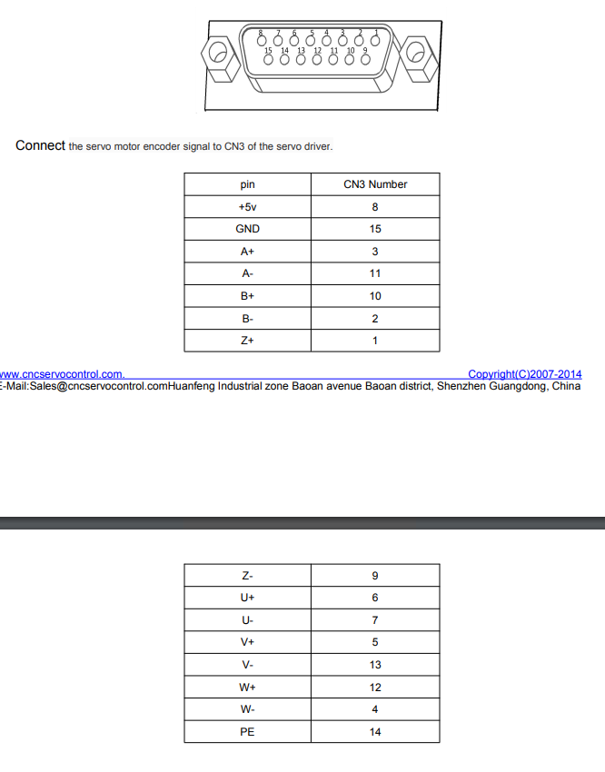

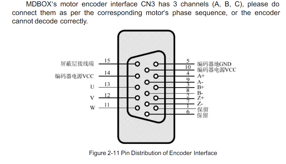

    Can anybody tell me, if it is possible to drive a Syntron 80CB075C-543AA0 Servo with AASD-15A driver?
    Can the Connector be wired to the AASD-15A driver?
    This is the MDBox Encoder Interface:
    while the AASD-15A has this Encoder connector:
    Thanks for your help!

    While the encoder signals may be connected, the encoder resolution might not match of what the AASD-15A can read (different CPR). And it gets worse if the hall effect signals UVW does not match the position of pulses from the encoder. The AASD-15A driver has certain motor model codes that uses to make sure the attached motor uses correct factory calibrated parts (Encoder-Hall sensors-Coil field forces etc).
