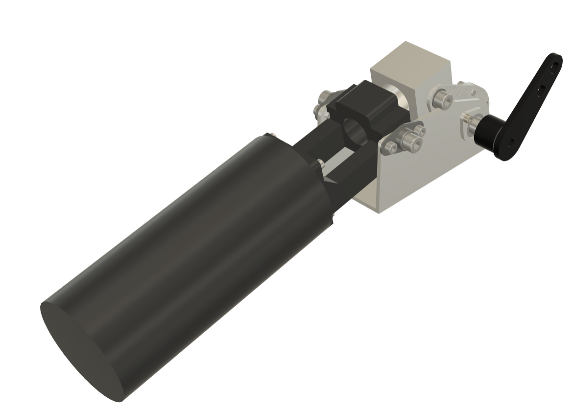

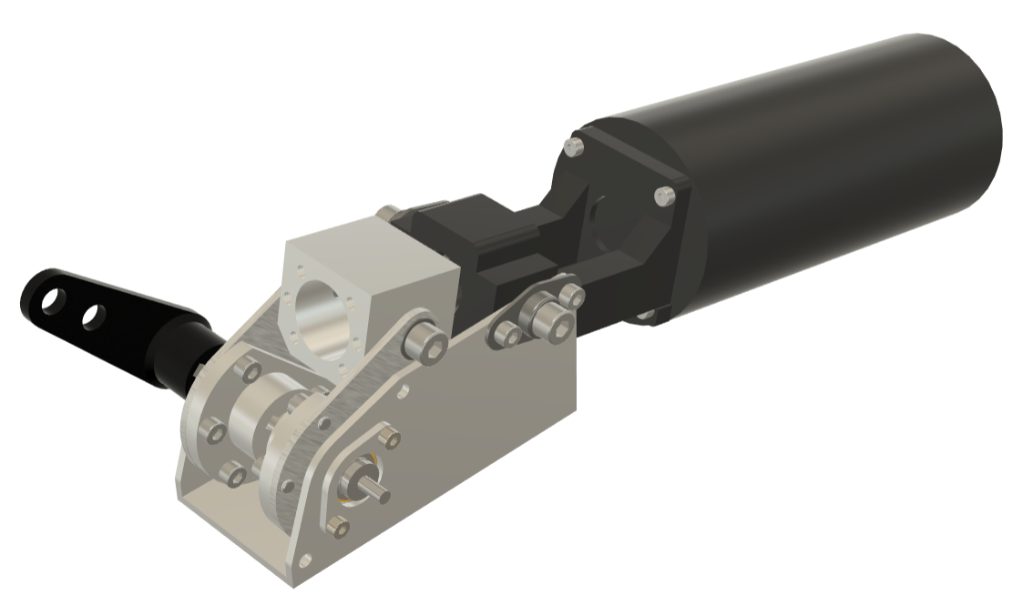

    I contacted DR. They said the gearboxes are available. 2 are $520 shipped. They said they have to get with Transtechno to verify shipping date. I wasn't aware that Transtechno made those gearboxes. I thought they made them in-house.
    I drew up a ball screw gearbox solution. The idea was to make it from off the shelf parts so there won't have to be many custom parts. Basically I have to drill 37 holes, cut 6 non-precision profiles, and sand down the sides of the motor mount and nut housing.
    I'm using the drive shaft and actuator arm from the original gearbox.
    They're not drawn in yet, but I plan on adding a couple cross braces (bolts through tubes) between the 2 side where they won't interfere with the arm travel. Do you think this will be strong enough? I thought about using steel, but aluminum is easier to drill and cut.
    Total cost $307.56 from amazon.

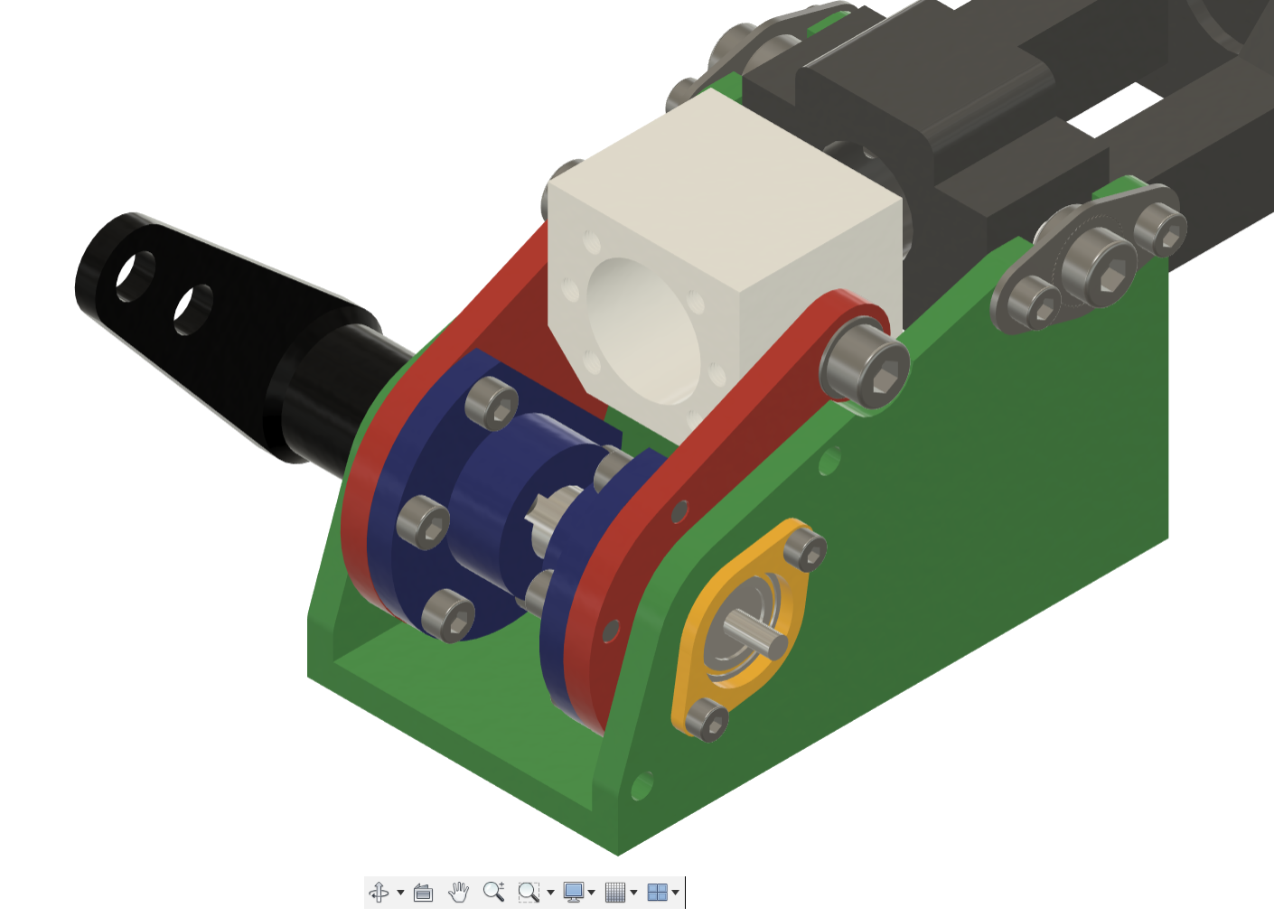

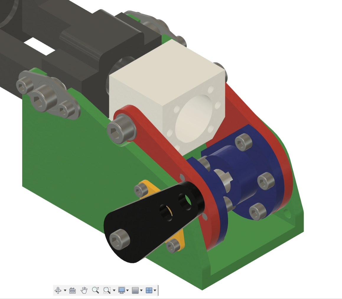

    I was able to find 3" x.25" wall square tube on Amazon. So I redrew it using .25" drive arms and profile. Just took a little shifting here and there but it seems to work well, and I don't have to worry because it's too thin.
    Here's the final drawing. I haven't heard back from DR yet regarding shipping time on there gearboxes. Looking around though, they seem to be at least 4 months out. And this looks like a fun project that I can do in the house. finishing my rig is out in the garage in 20F weather.
