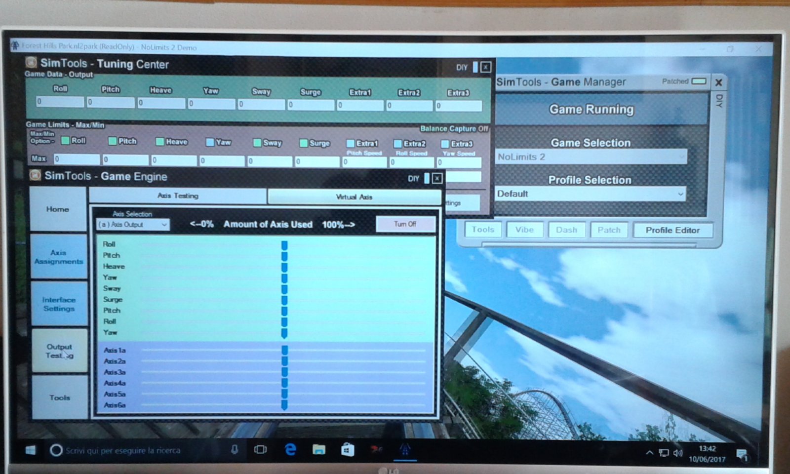

    I downloaded it from steam NoLimits 2 Roller Coaster Simulation Demo and downloaded plugin at link
    https://www.xsimulator.net/community/marketplace/nolimits-rollercoaster-simulation-plugin.31/
    As you can see from the photo, simtools is perfectly running but there is no movement even on the test sliders
    Everything is set perfectly on the manager as well as tuning and assis assignment, can anyone tell me if the plugin is not suitable? Version simtools installed v2.1
    All the other plugins work perfectly as assetto corsa,rfactor2,f2015,projectcars.
    thank you
    21,582
    151,106Coins
    The plugin does not work with the demo, only the full version of NL2.

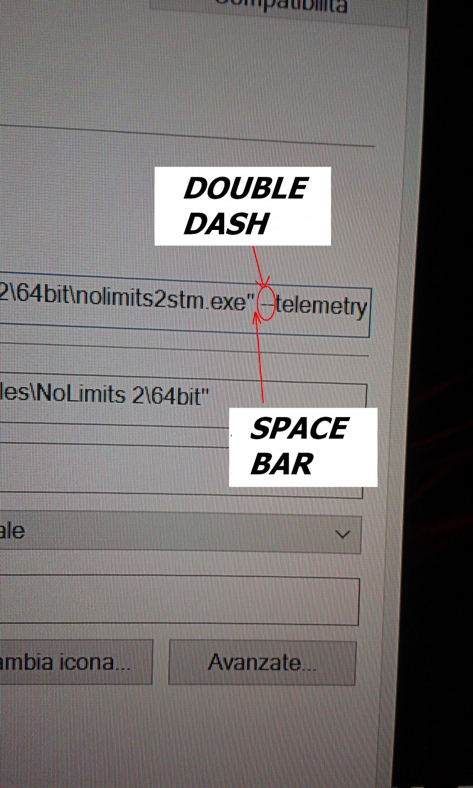

    Hi, tried with full version I have the same problem. Where could this be the problem?
    I started both 32 and 64 bit but it is always the same

    I would also like to add that after patching I can not find plugin files under any game directory.

    With my 2dof simulator I got the best result for this game by only triggering surge and sway
