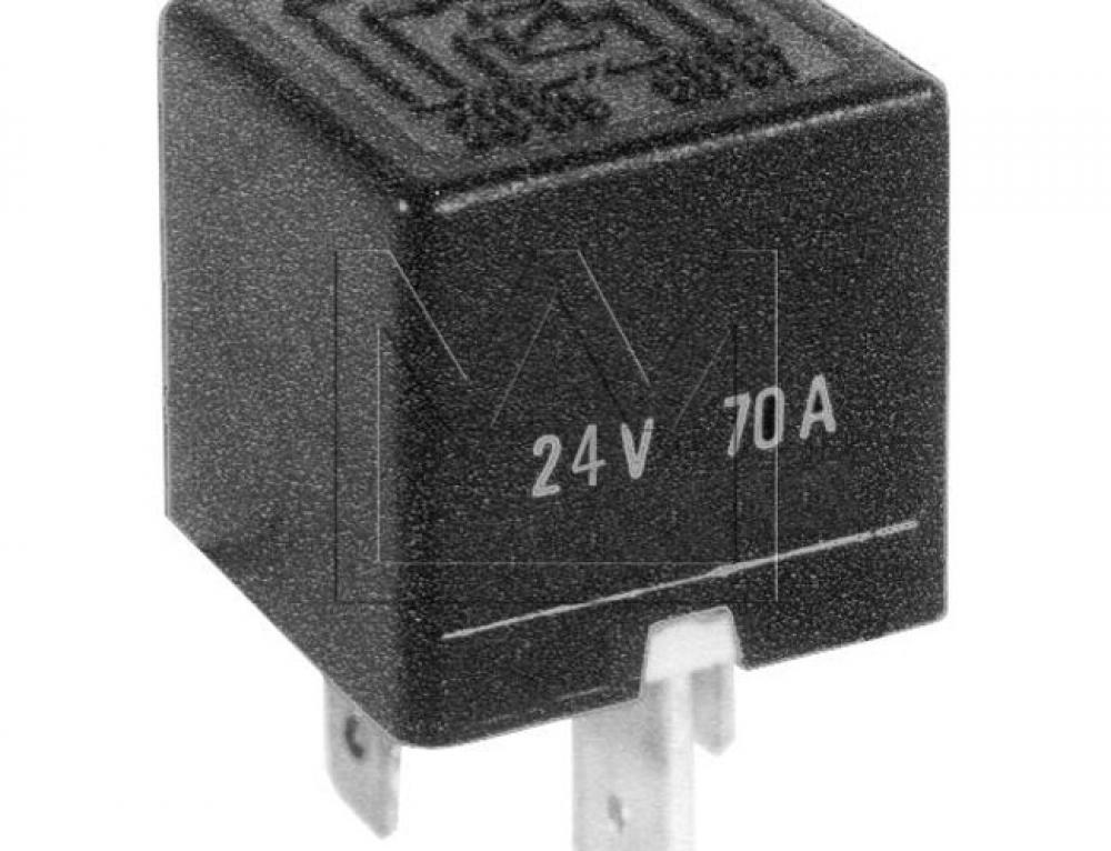

    I have 3 dps800gb, two in series for a 24v motor and one for two 12v motors, I want to be able to stop all with a single emergency stop, the first option is for the 220v directly, the stoppage lasts 10a but I do not know if it will heat up , the sources are 1000w each, the other option is to cut the cable that turns them on, but I do not know if you can put the three cables together, is that possible?
    I also want to put two 22000uf capacitors in parallel to the source to help and stabilize the return voltage of the coil, when using the emergency stop and stop the sources, these capacitors have the ability to continue moving the motor?

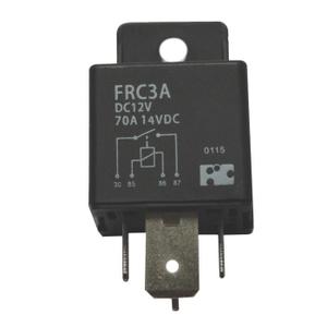

    Hello, I do not know if that will answer to your question, but why do you not simply use car relays (example: 12V 70A that you can use surely to cut 24V without problem. It is the cheaper, but you can also find 24V relays for truck for exemple). 70A x 24V = 1200W... you can use several relays like that to cut all the wires. Your capacitor must be connected on the wire between the power supply and the contact of the relay (to have an immediat stop of the motor) .
    If you post a circuit diagram that will be easier to understan your need (and I can complete it with the relays connections)
