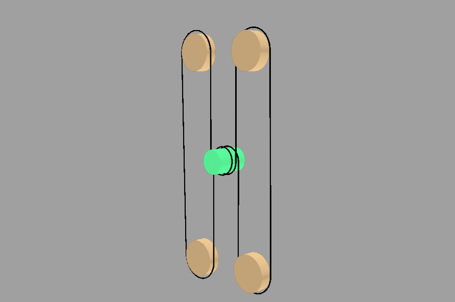

    It probably has been tried before?
    With a little thought using a couple of extra pulleys, it is possible to use 2 motors to drive 1 axis.
    This would nearly double the touque available - so maybe increase the size of the drive pulleys which would increase
    the speed / acceleration of the system.
    Also as a refinement of this idea, is it possible to drive the 2 motors from separate channels of the DIY controller in a master slave arrangement? This could enable feedback correction for variations between the performance of the 2 matched motors.
    Bruce

    You should be able to use two motors per axis, as long as the speed of each motor is the same. If one motor is slightly faster than the other , it would obviously cause and issue. Do some tests to see how you can find a suitable way of setting it up.

    Thanks for the reply bsft,
    I have sussed a way of using a pulley that automatically compensates for the different motor speed. It converts the speed difference into a rotation but still allows the 2 motors to pull in a linear fashion.
    I will try to do a drawing soon to share my idea. It seems that the only critisism of the the wiper systems (single motor) is their inability to accelerate at a fast rate. Maybe this might be a possible improvement?
    Bruce

    Done a quick sketch of what I was talking about. The centre pulley is attached to the frame to be moved.
    You can see that if one motor is slightly faster, the centre pulley rotates but is still displaced by the linear motion of the 2 motor belts. If the speed of the motors are the same, the pulley will not rotate and you will get maximum speed of linear motion.
    I think this will work???
    Bruce

  6. bsft
    This should work, build a test model and throw some weight at it. Motors will move better if you get your weight balance on the sim right, depending on what style you build.
