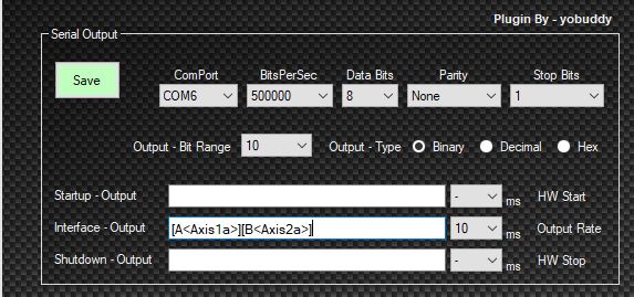

    additional question... if i want to use b axis for traction loss as well i have to add the B axis also to the A Axis motors ? how i have to change the value ?[​IMG]
    add [A<Axis1b>][B<Axis2b>] ???!
    i testet it with [A<Axis1a>][B<Axis2a>][A<Axis1b>][B<Axis2b>] and so on ...but it doesnt work ....seems thet the a and b axis interferes with each other and the sim makes terrible noises and shackes like hell ...

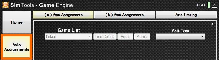

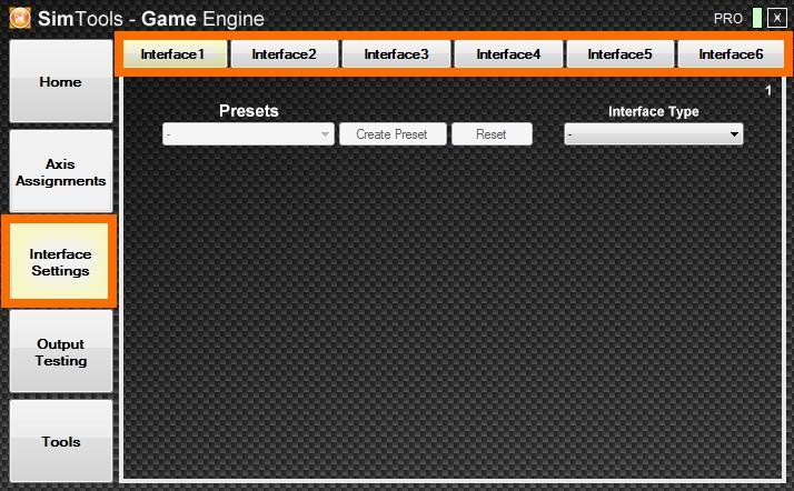

    See pages 27 and 41 of the SimTools manual: https://www.xsimulator.net/community/faq/rtfm-start-with-the-official-simtools-documentation.117/
    Each hardware interface has to be configured and assigned, there are 6 slots available, then a and b are separated Interface Type dedicated hardware, not mixed:
    Then and Axis Assignment can be made using the (a) and (b) tabs in axis assignments:

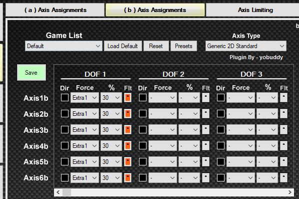

    here we go:

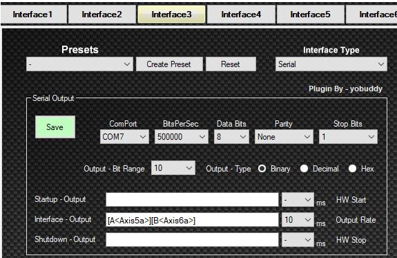

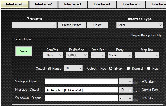

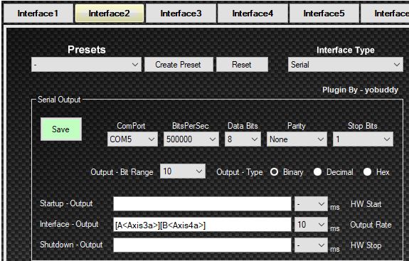

    interface 1 to 3 settings here i would add [A<Axis1b>][B<Axis2b>] ?!?!?!?! or is it C...D.... ?
    [​IMG][​IMG]

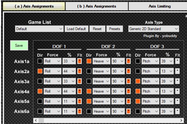

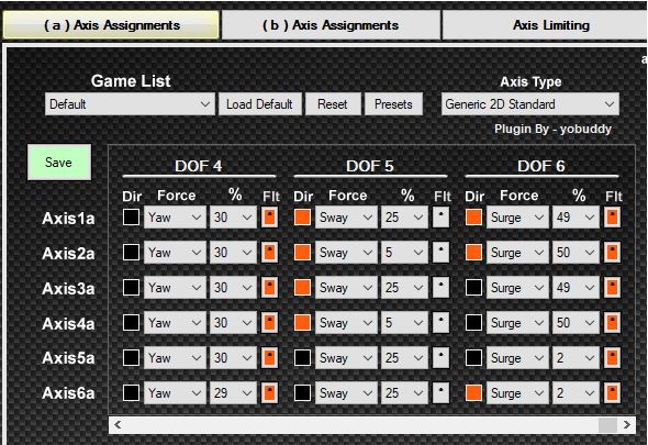

    and here we got the DOF Settings for Axis A:
    DOF1 to 3
    Dof 4 to 6:
    (Axis 6a for yaw should also be 30 ;D)
    and Axis B for the Extra 1 which is Yaw (Copy of Dof 4 in my case, right ? )
    21,517
    150,722Coins
    +11,018 / 55 / -2
    In your Interface 1-3 you have the controllers for your 6 axis. The controller for the harness, and by the looks of it, traction loss (Extra1) should go on Interface 4 and be [A<Axis1b>][B<Axis2b>]

    So i can add the 4th channel to the same com port as another channel?
  12. sci666
    sci666 Active Member Gold Contributor
    Mar 18, 2021
    195
    1,190Coins
    +72 / 0 / -0
    Oh I think we got something wrong.... To yaw the rig for traction loss I need All 6 Motors so I have to add channel 4, 5 and 6 with axis b, right? It's so confusing
  13. noorbeast
    21,517
    150,722Coins
    +11,018 / 55 / -2
    No, each controller needs its own assigned port.
    21,517
    150,722Coins
    +11,018 / 55 / -2
    Yaw is one of the 6 axis, you already had those set up.
    Traction loss is a different physical axis, with a physical pivot point near your feet. What is the physical design of your rig, please post pictures

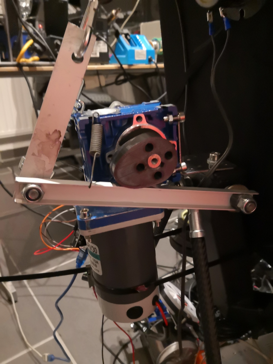

    So i doubbled the surge channel with an additional arduino on channel 4. everything works well. But it there a way to cut off All positive movement on the second surge axis but not on the regular?
    I use this channel for the belt tentioner. But I dont want to loosen the belt while accelerating above the neutral position.
  17. sci666
    Mar 18, 2021
    195
    1,190Coins
    +72 / 0 / -0
    it seems there is no Software solution for this so I so it in a mechanical way. I have to redo it in a prettier way
    So this is my belt tentioner Motor : linked with surge of the 6dof rig.

    You are correct that with your 6 DOF setup, you can have a traction loss effect by moving the rear 2 actuators causing the back to 'slide' side to side. Most plugins use Extra 1 as the channel to setup this effect.
    The easiest way to configure the belt tensioner for surge on deceleration only is to alter the arduino code to output the data accordingly using a map function. It will depend on the code you are using, but something like:
    servoData[0] = map(rawServoData[0], 128, 255, 0, 180); // Map the data to servo i.e. 0, 255, 0, 180 is from bytes 0 to 255 mapped to 0 to 180 degrees
    This works on the assumption that the surge data is from 0 to 255 and that the neutral position is 127 to 128. It ignores anything below this and maps positive surge data to a 180 degree servo so that it will only move with surge one way.
