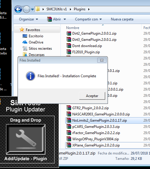

    Hello!
    Since it's the first time I'll do it, I'm probably making a mistake.
    I do not understand why I do not see the imported plugin
    Any ideas..?

    The Demo version of SimTool includes the fully functional plugin for Live For Speed, specifically for testing purposes, but will not allow the use of any other plugin. A licensed version of SimTools is needed to use any other plugins.
    An eligibility criteria applies but genuine DIY motion sim builders can apply for a free DIY license for SimTools, see here for details: https://www.xsimulator.net/community/faq/request-a-free-diy-simtools-2-0-license.262/

    Thank you very much @noorbeast ! I have already activated my license and I managed to import the plugin
