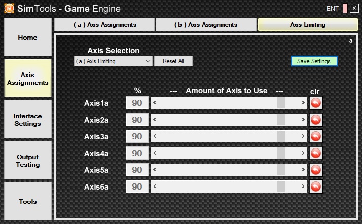

    Please goto your axis assignments and set all the axis you use to 90% (be sure to hit save.)
    If you then get no errors, it's probably a motor not stopping in time and turning a pot to far?
    Anyway, please try this and report your results buddy.
