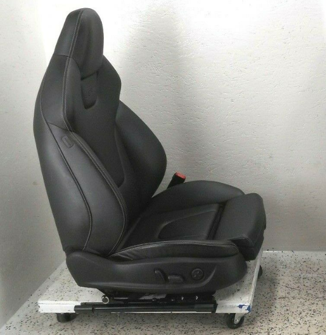

    If you can find a nice actual car seat (something like a bucket style seat from an Audi S4 is nice - pic attached of an example used seat you can pickup for under $500) and of course you don't need any of the electronics so you can gut all that stuff to reduce the weight.
    As cool as an OMP actual racing bucket seat with wrap around head impact protection? No/maybe.
    Comfortable as hell and still plenty supportive for the vast majority of 'regular' motion platforms.
    But if it's additional weight concerns, then a fiberglass racing seat will be better - just get something that's wider than you think your butt/hips are. Nothing worse than something that feels snug like an actual race car for long stint comfort. The majority of racing seats are quite a lot narrower than you think, so think about that and do your due diligence.

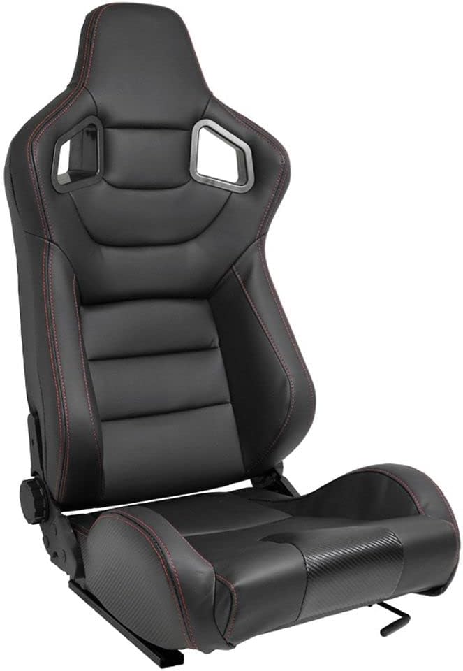

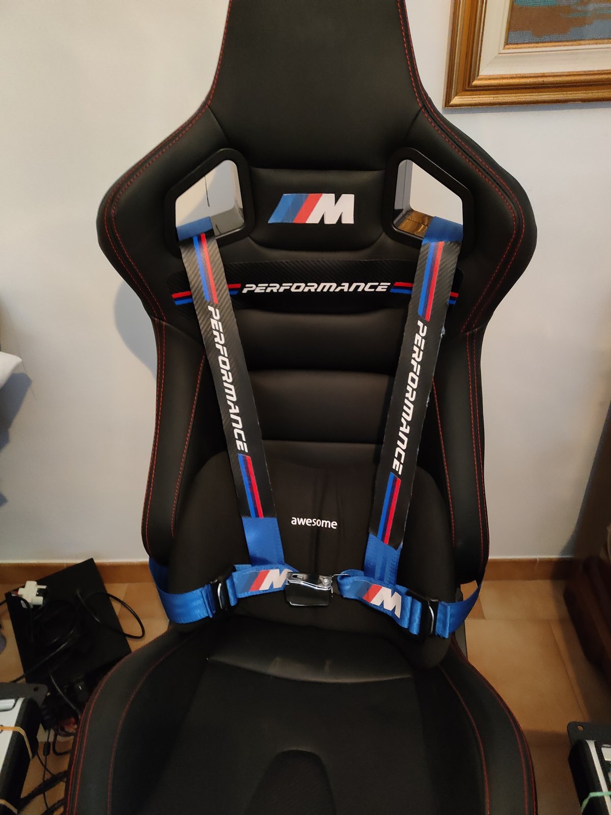

    I recently too acquired a P3 with a lot of accessories and still refining it, it takes quite some tome to do it, so you are in my similar situation as I was before.
    That said, there are principally 2 choices:
    - bucket seat
    - non bucket seat
    BigAustin showed you a bucket seat meanwhile Globespy a real car seat with electric parts (which could be also a negative point because too heavy, DOF has weight limits), personally I preferred a middle choice, that because I tried every kind of seat and my final result is that:
    - a bucket seat envelop you better, but it is more harder to get out, especially if you have several accessories on the DOF (I can "jump" into my DOF in and out only from left side where there is only the Flying Throttle, on right one there is the Flying Stick and the Handbrake), It's quite strange that not so many people describe this fact
    Here it is my seat in pictures, before buying it and after on DOF
    If you wish to know the cost is about 230€, it's in faux leather with red stitching, rails included and it fits perfectly on DOF (even if it was quite hard to get in the last screw), weight 15kg.
    I hope it helps
