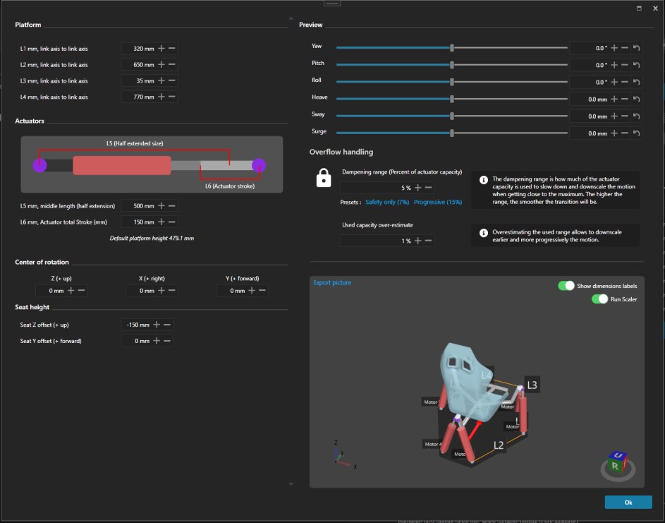

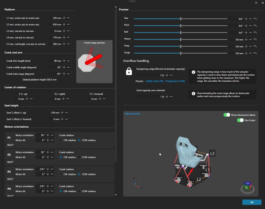

    You will be able to configure almost any 6DOF Platform. There will be no pre-configuration for platforms already available for purchase, at least not from Simhub directly. But this fact makes it usable for all DIY projects.
