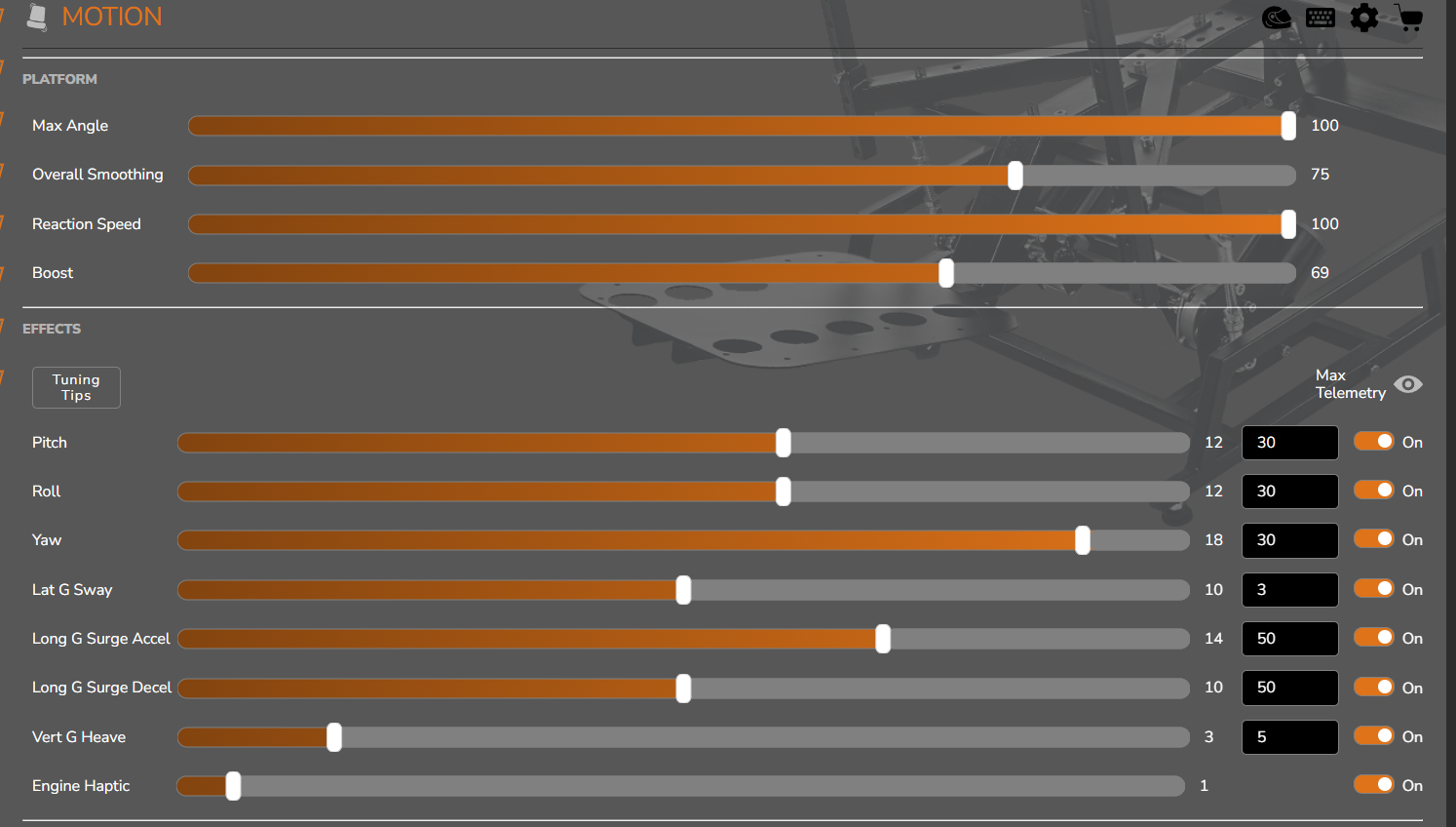

    have a dof reality h2
    in xplane and flight sim 2020 or 24, i cant for the life of me get any movement on turbulence or ground roll etc
    when i start off i get a little push back on seat - then it kind of does nothing
    airborne - i get the full pitch and roll etc but i want the ground roll and turbulence etc
    any ideas?

    have tried vert g heave up a bit - not sure what i have wrong here - thanks!

    any ideas anyone - think i am missing something with max values and slider values

    You have to adjust your telemetry inputs. You can look at your last session at "Max telemetry" on the right side when i remember it right.
    Also, your overall Smoothing is high and will smooth almost every Detail. You can set it to 30% and after adjusting all inputs, you can even lower it if you want it. Same for Smoothing Heave.
    Also Boost, set it to 1, as it was as Default. It Boost all Inputs, which are obvious wrong.

    still doesnt give me much to go on
    max turbulence in telemetry shows as 162!
    dont even feel runway bumps a little now either

    Can you make a screenshot of your gameinputs?
