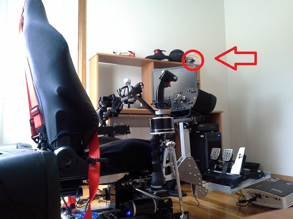

    Since I have moved my sim room around and successfully extended the Rift cables my tracking camera is now mounted off the sim, back over 2 meters and is even off to the side. It is working pretty well but I would still like to see motion cancellation.
  15. SeatTime
    2,573
    Here's hoping:) Yes, motion cancellation with the camera remote from the sim - long day....
