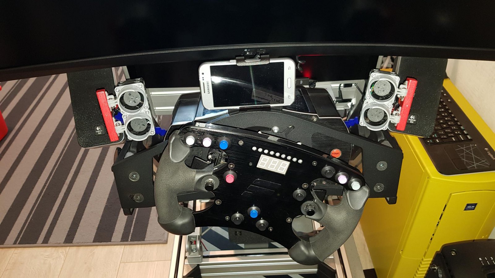

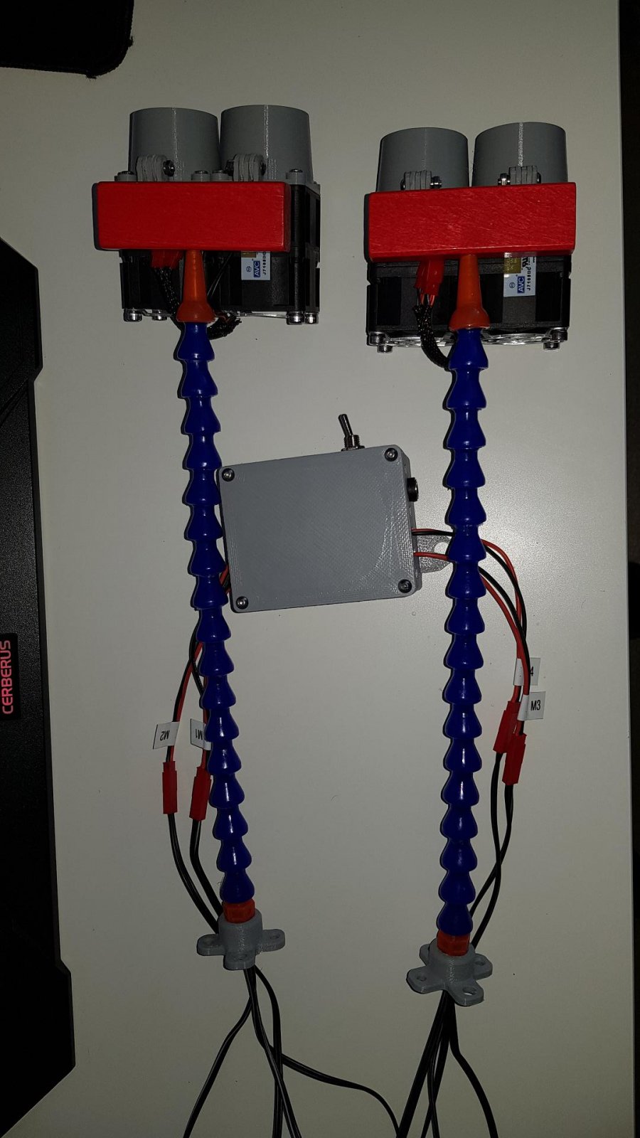

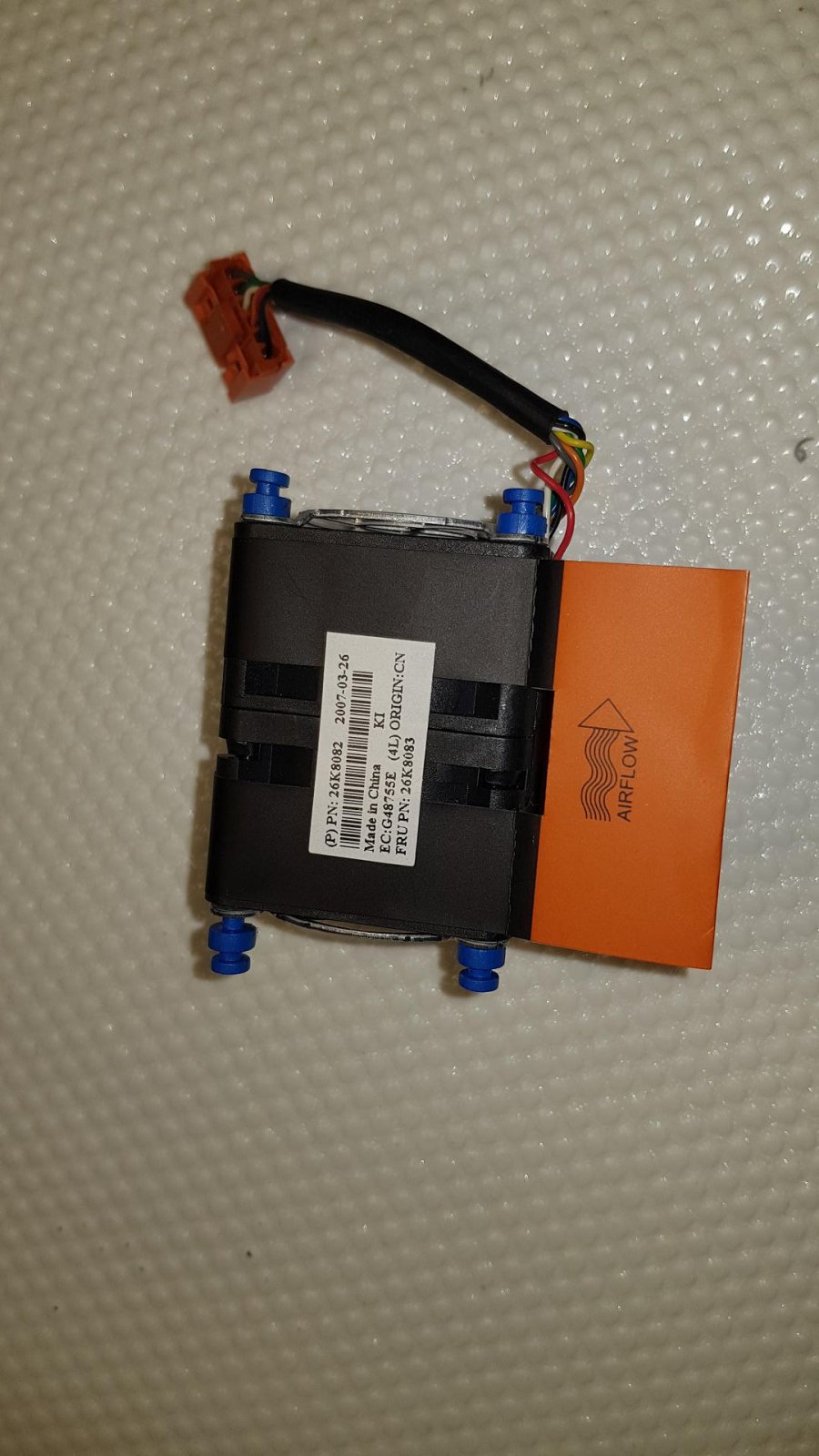

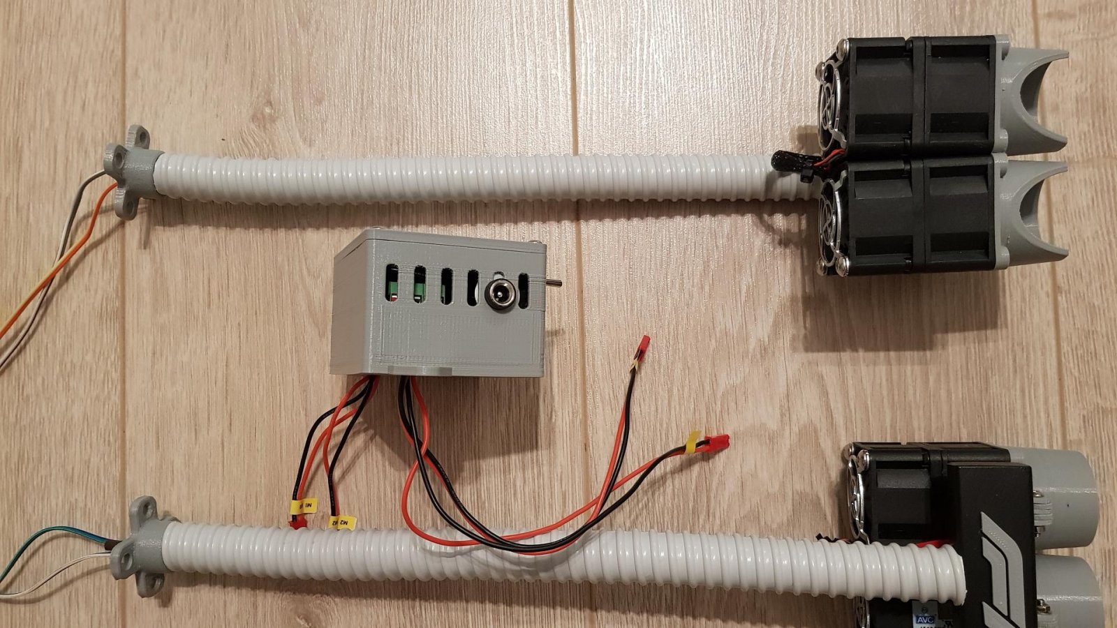

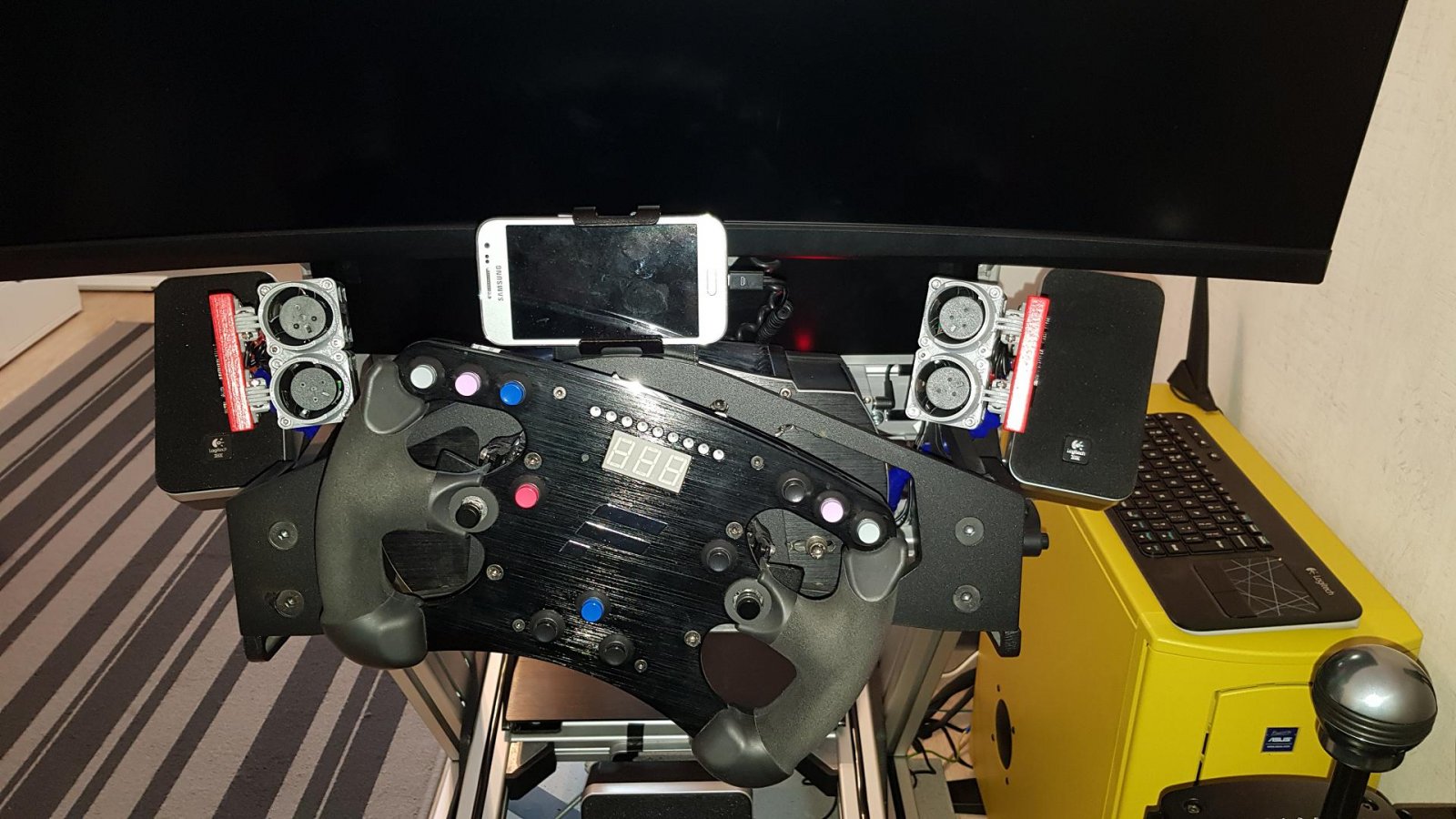

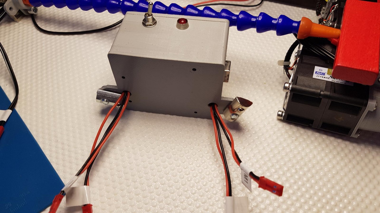

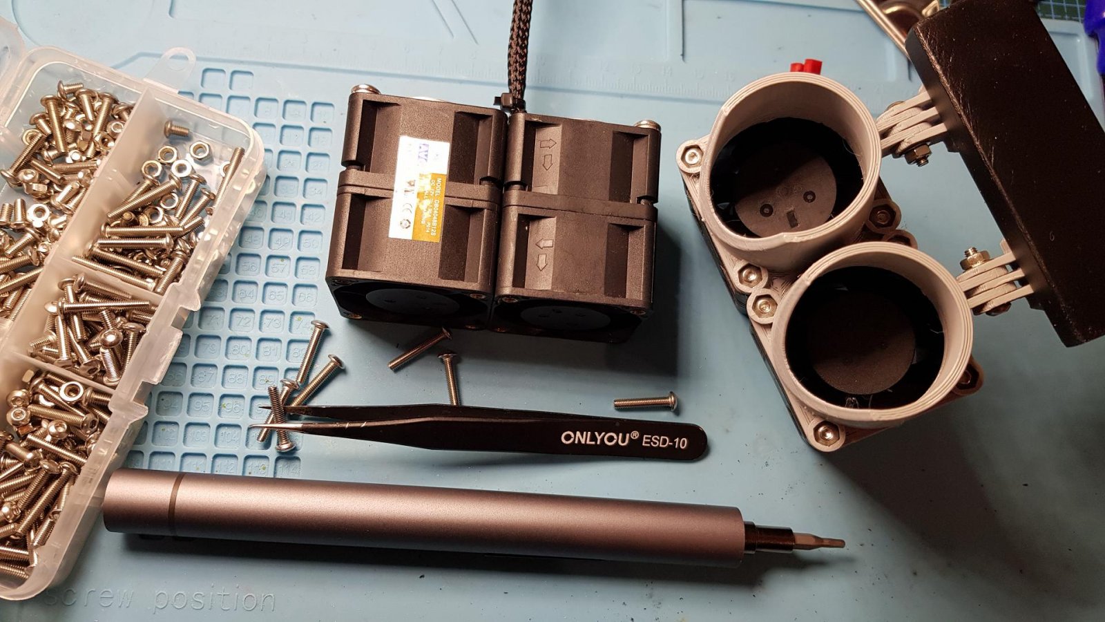

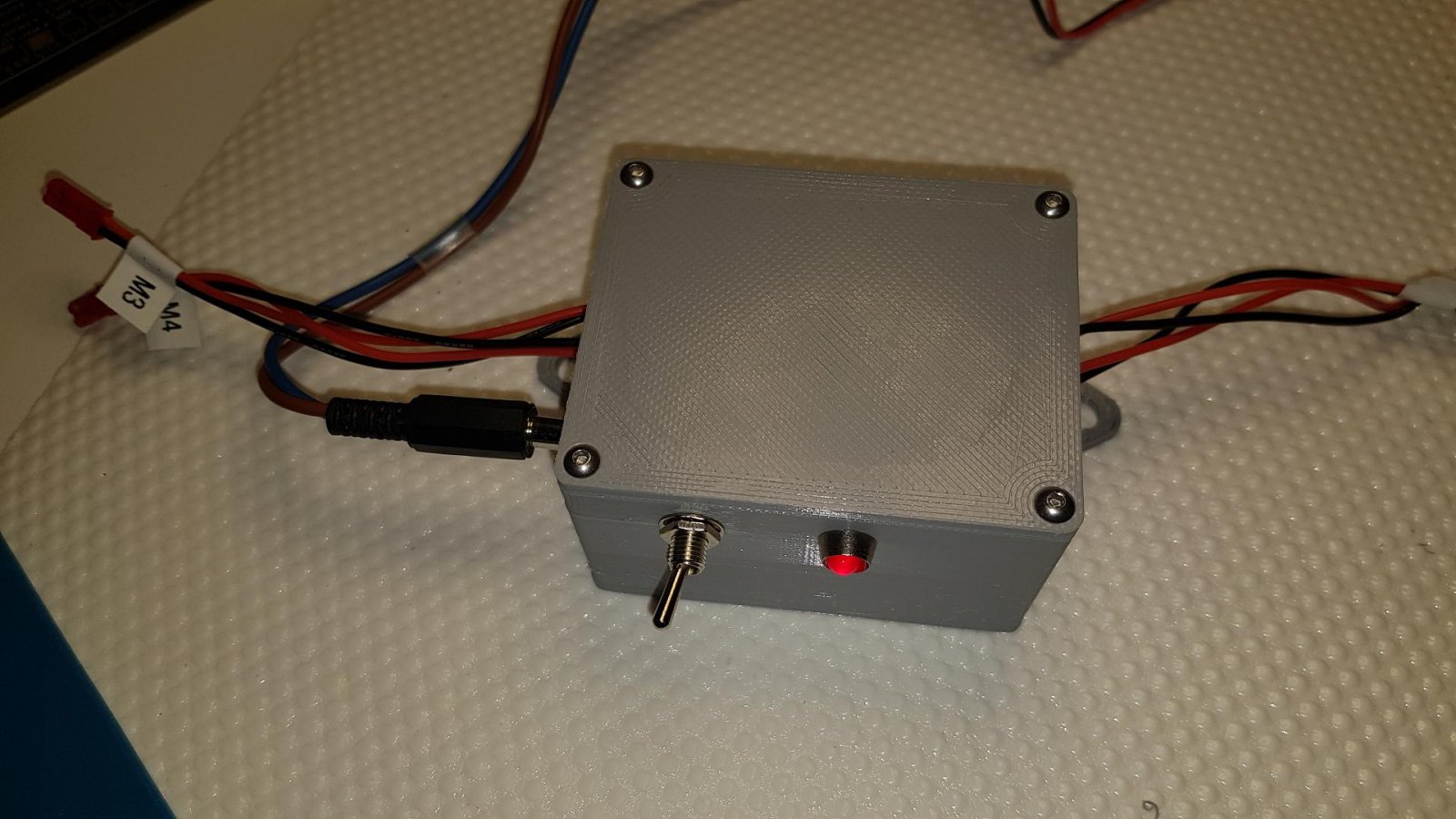

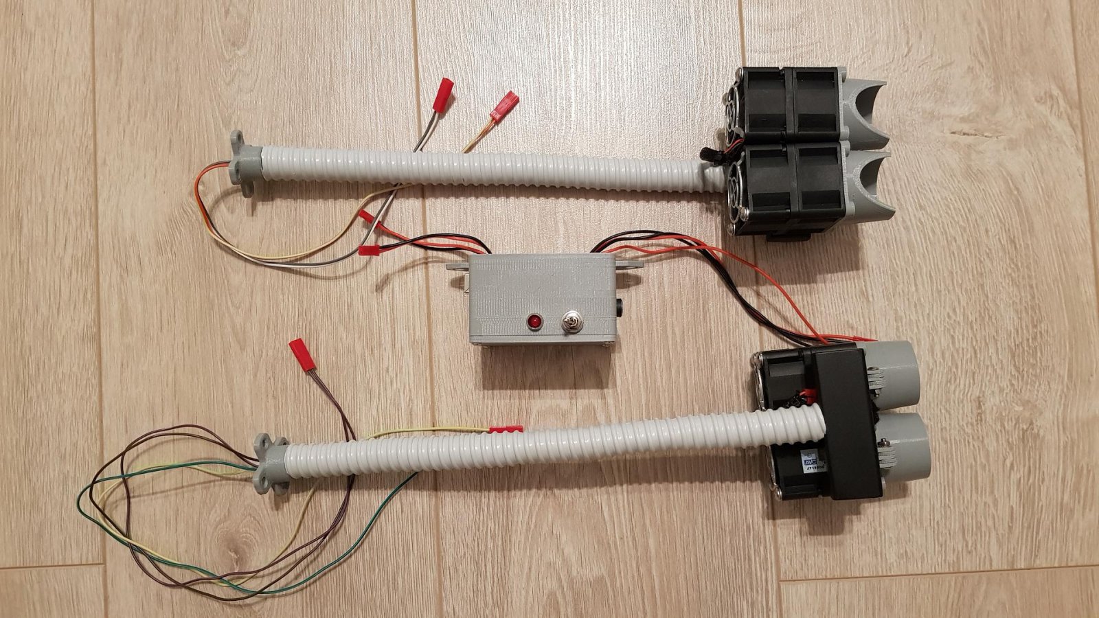

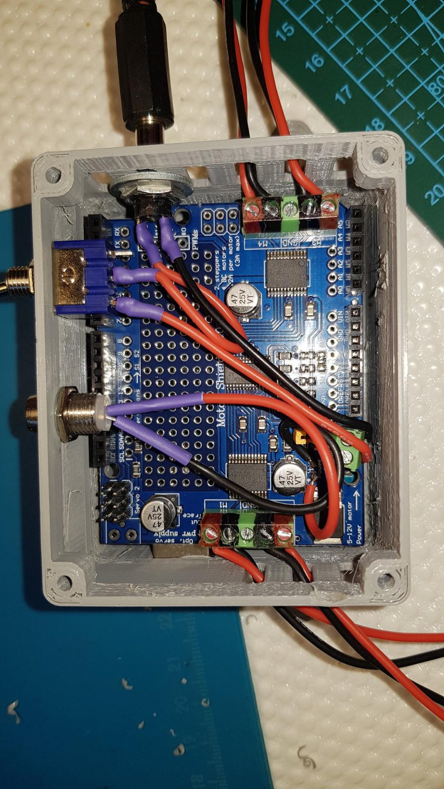

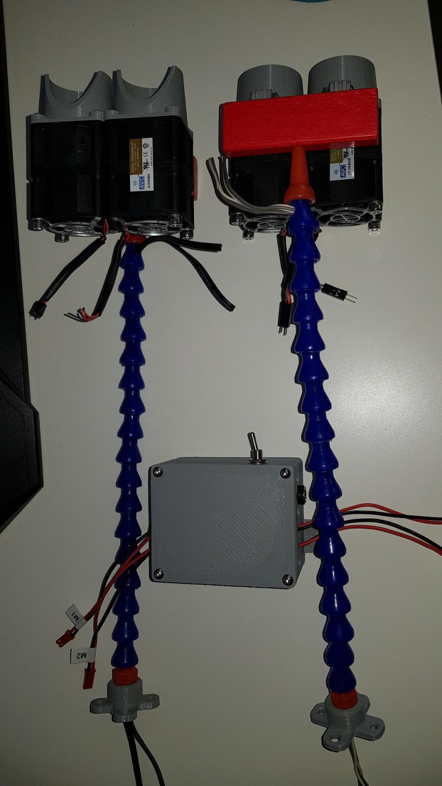

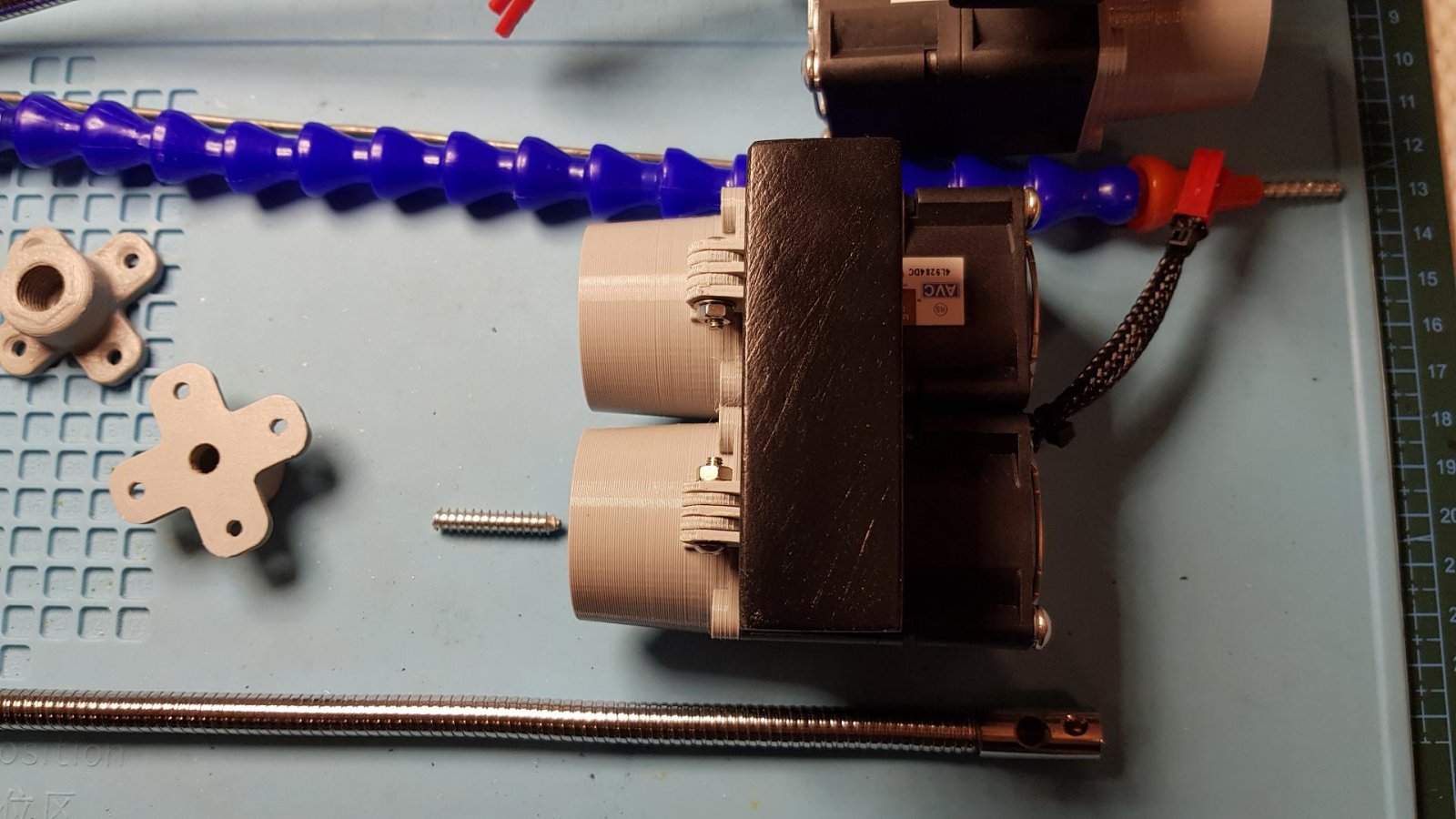

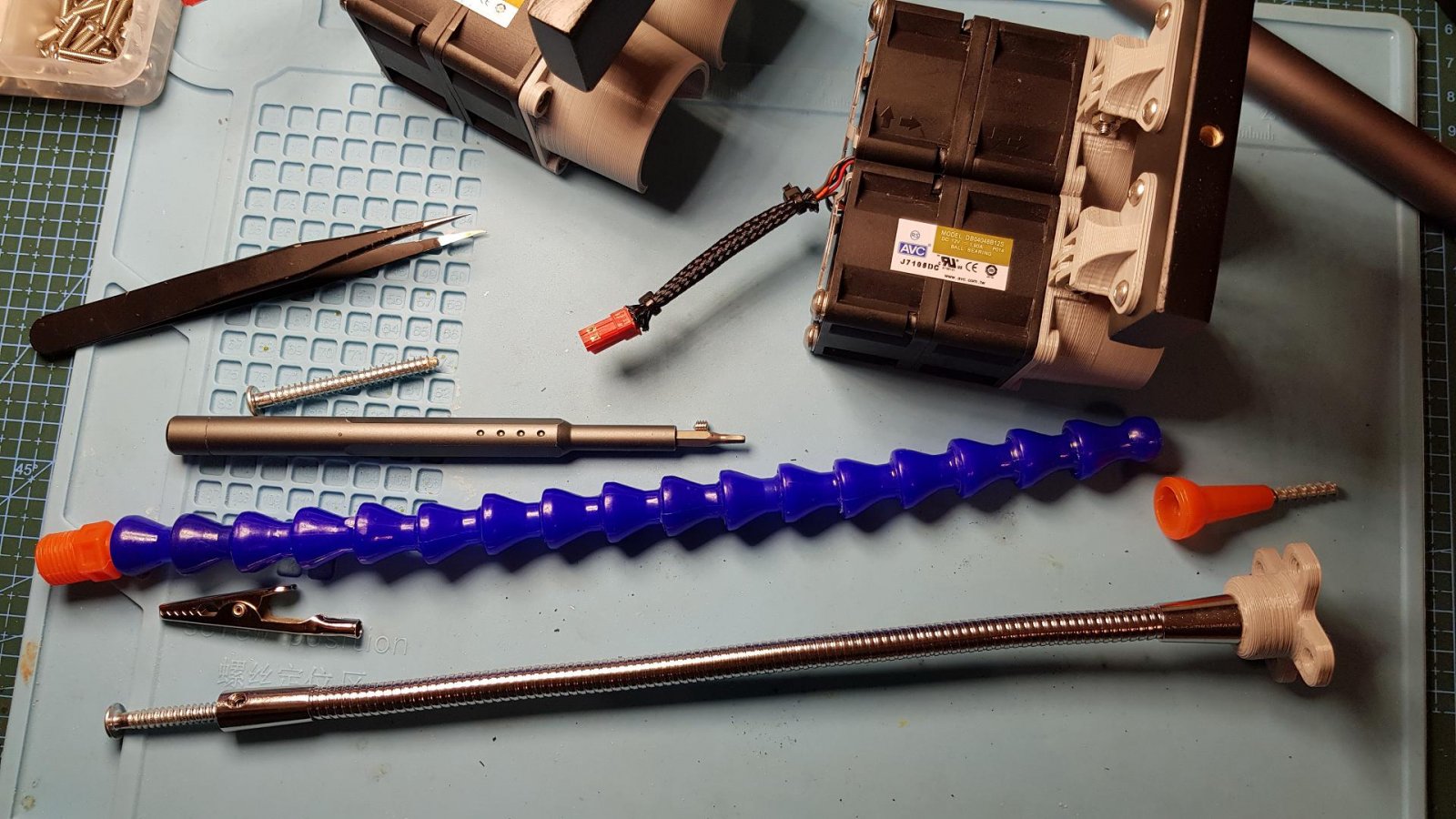

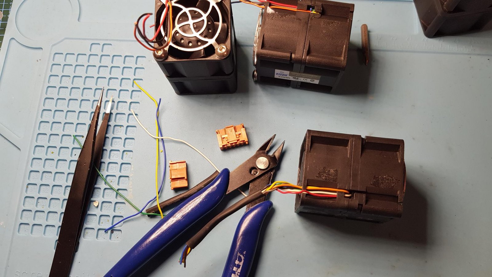

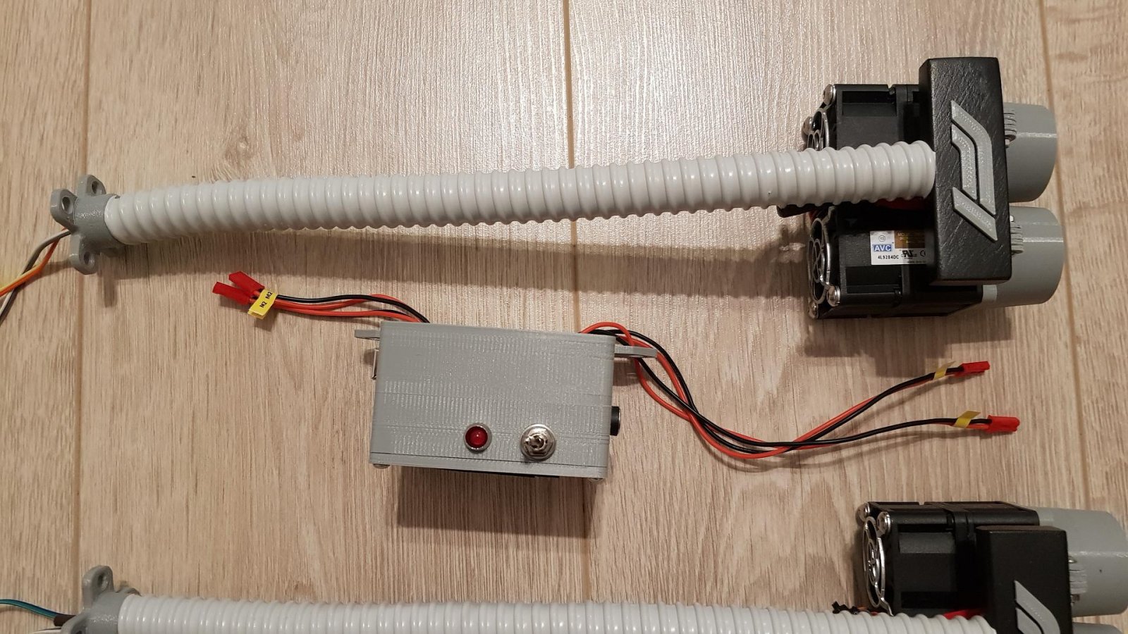

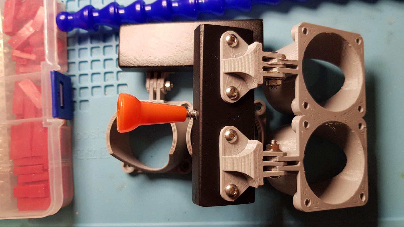

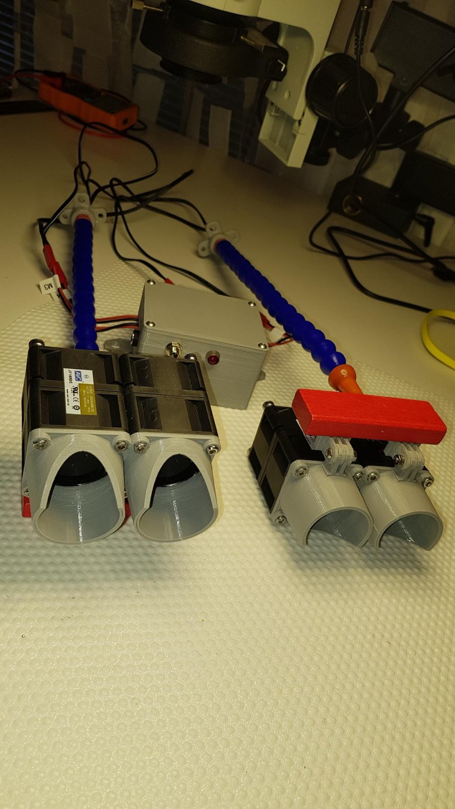

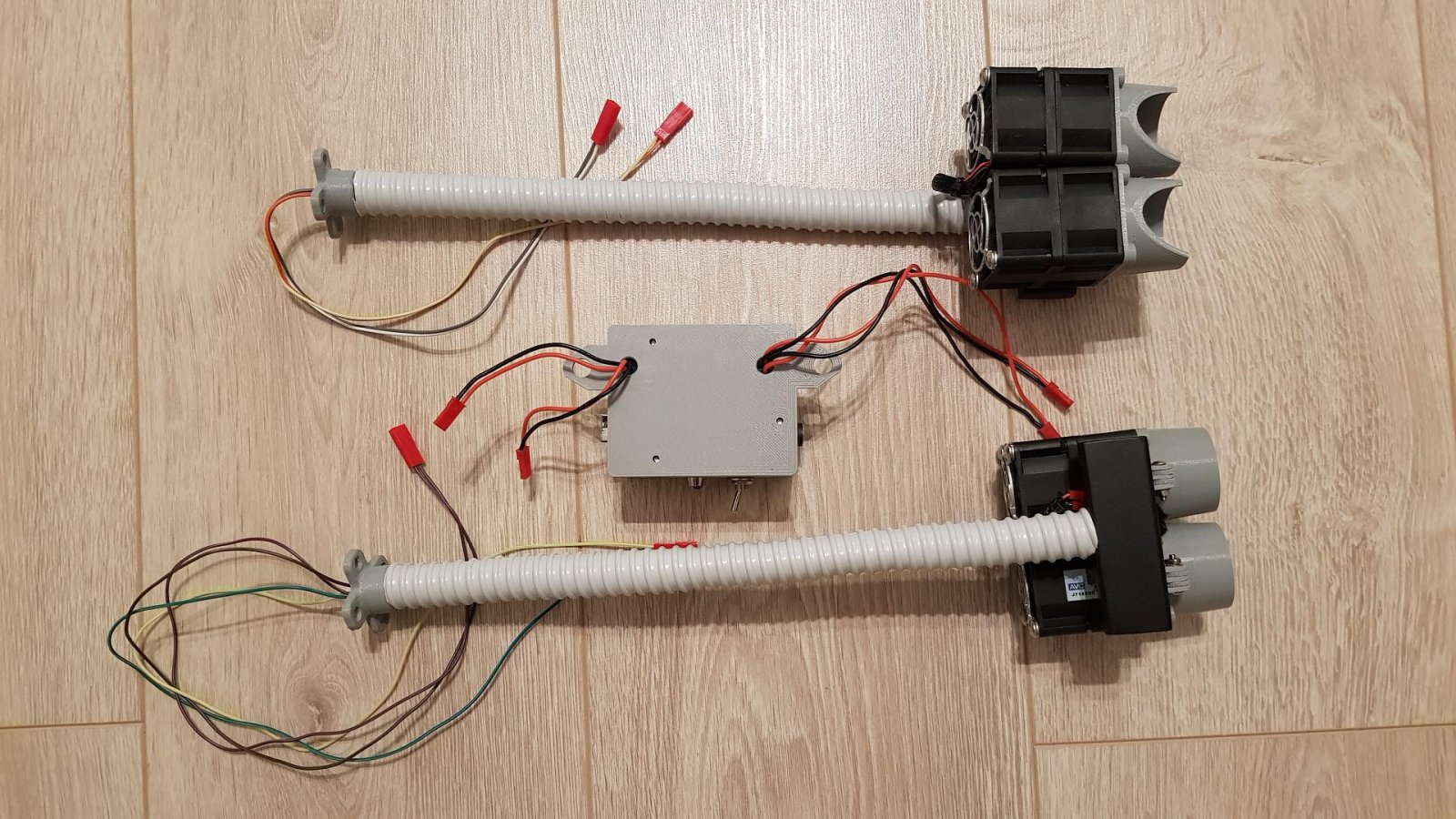

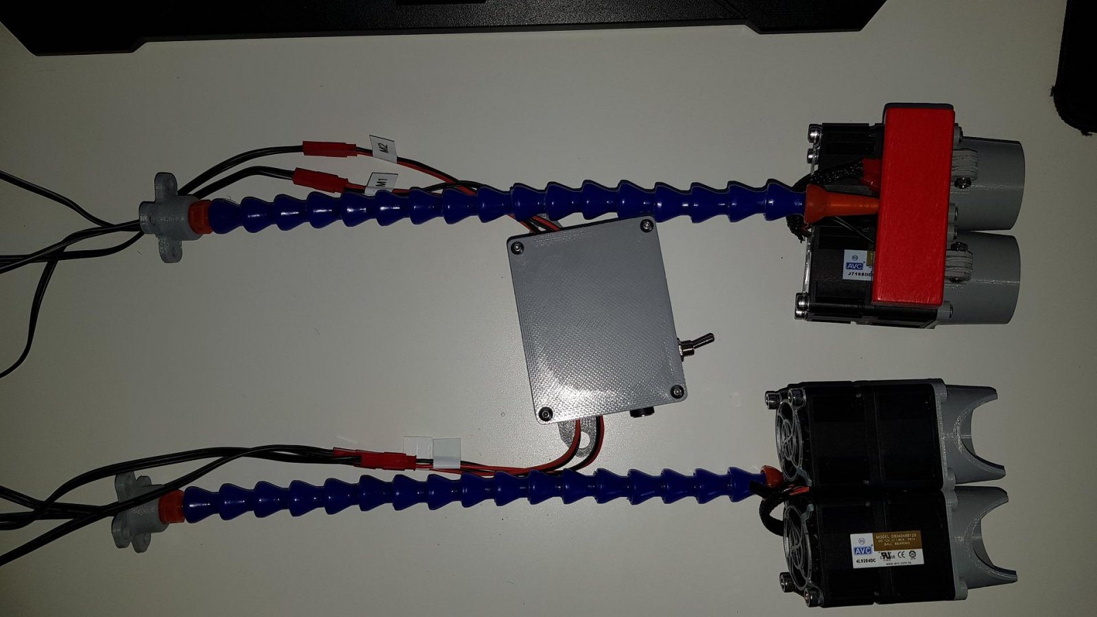

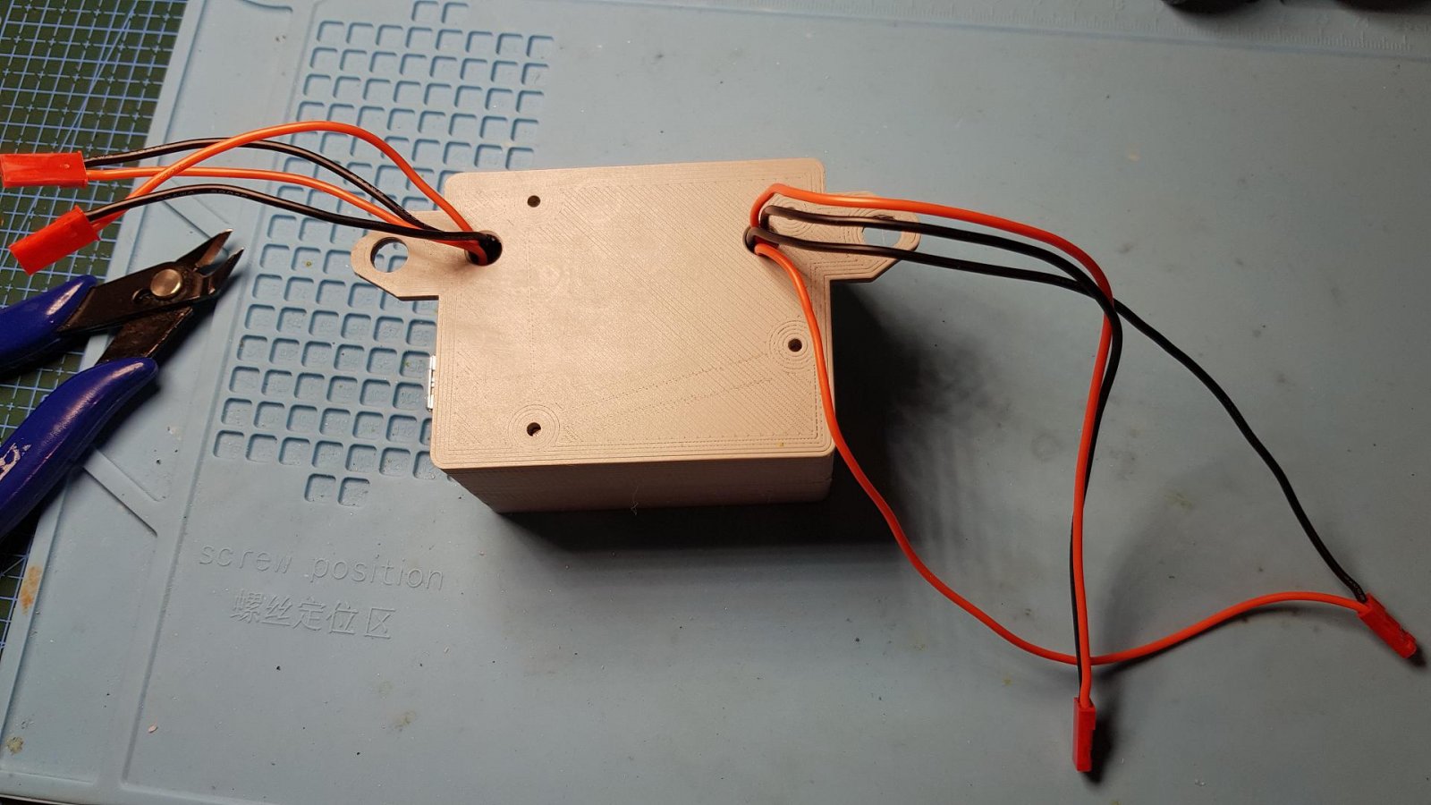

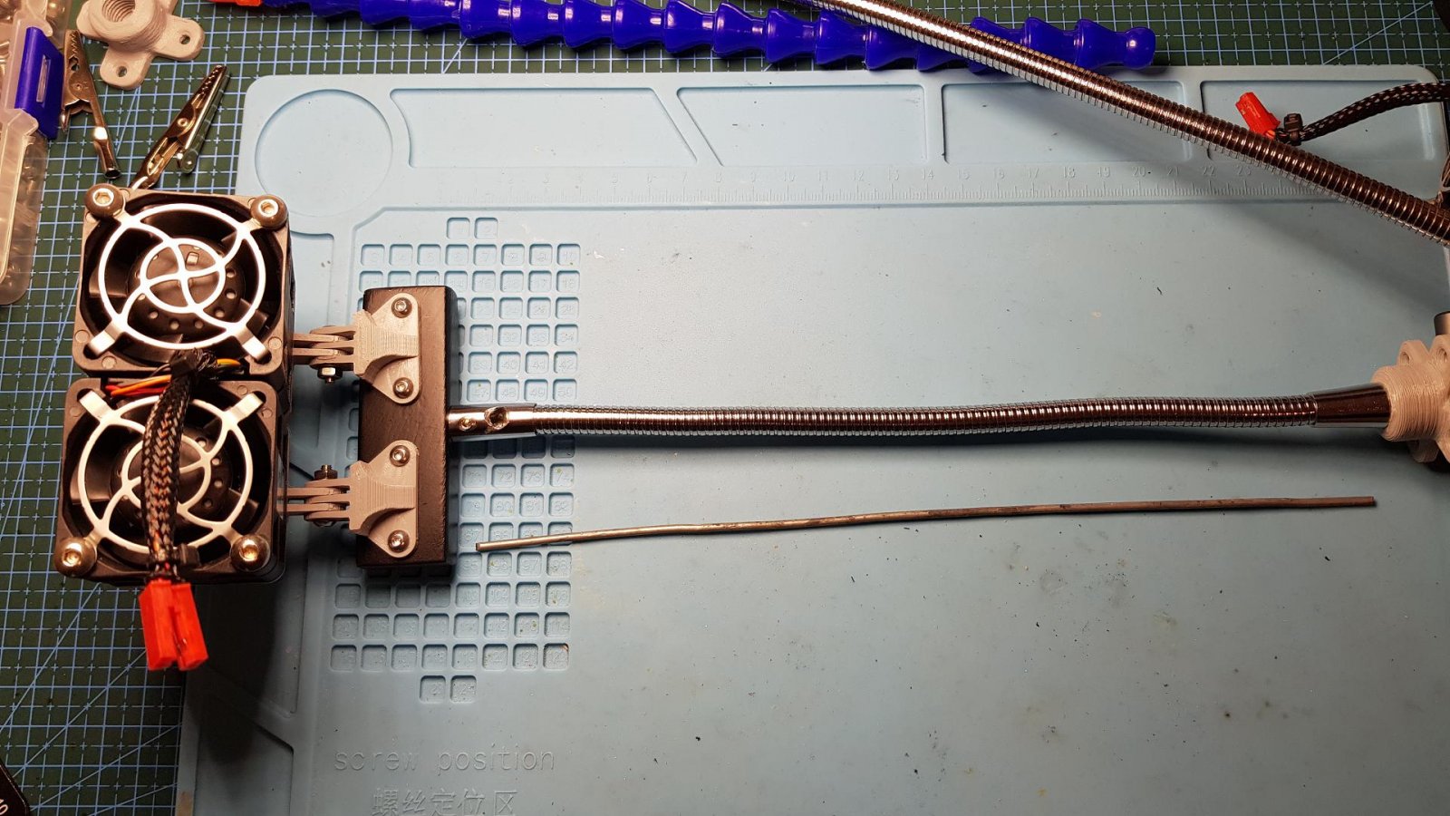

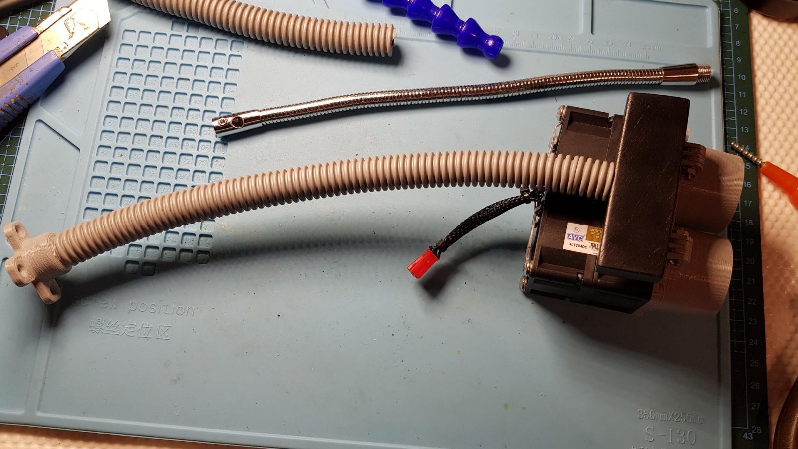

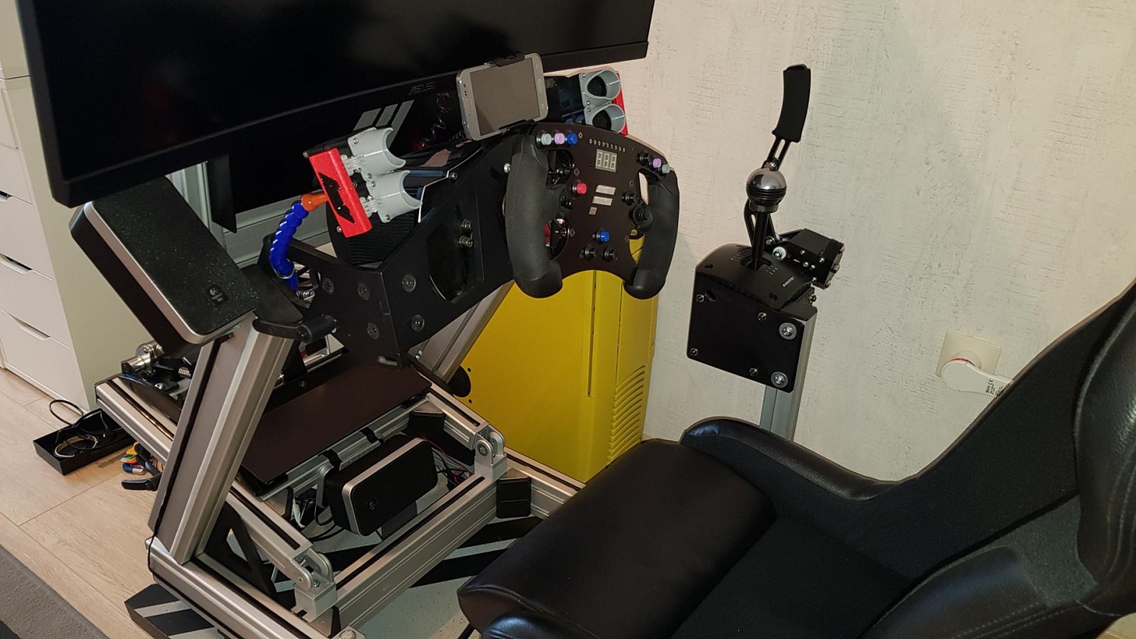

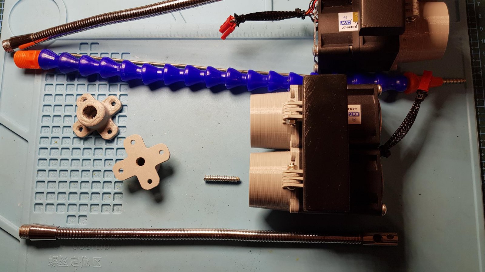

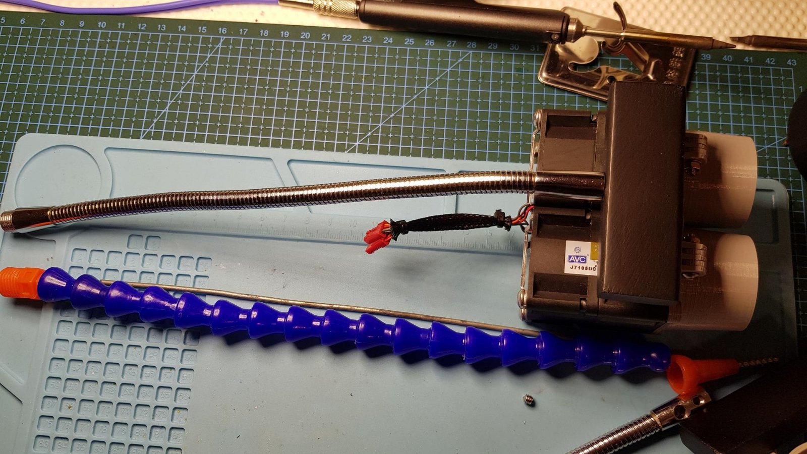

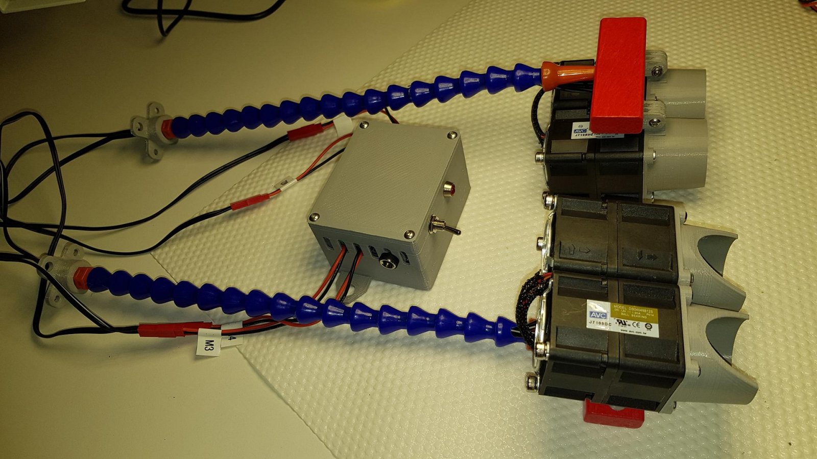

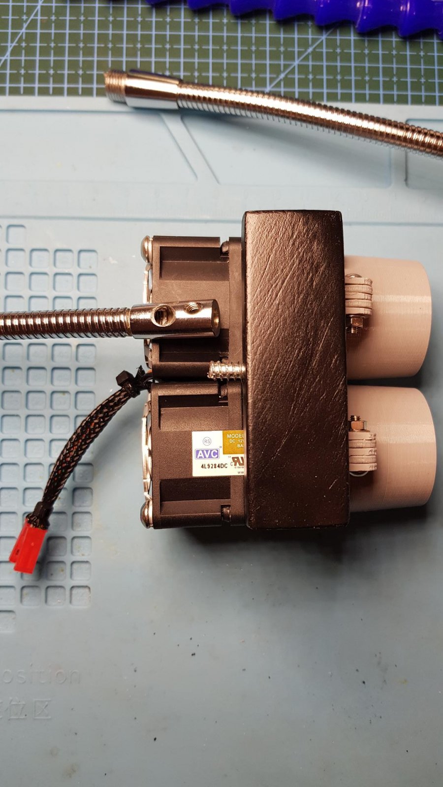

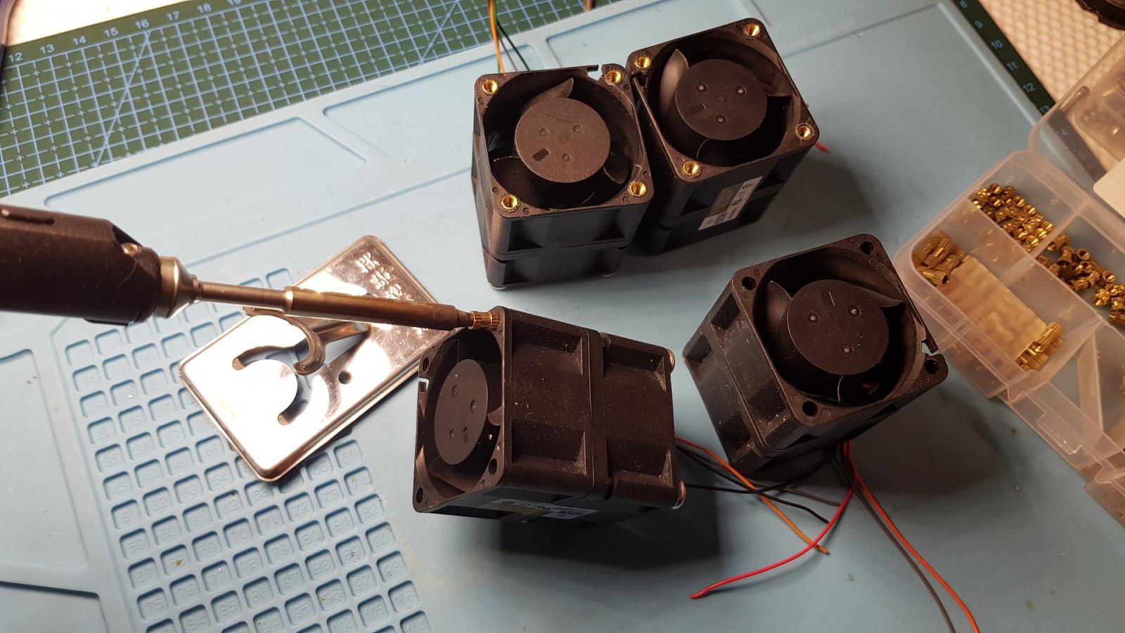

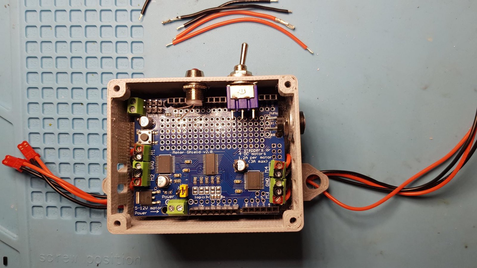

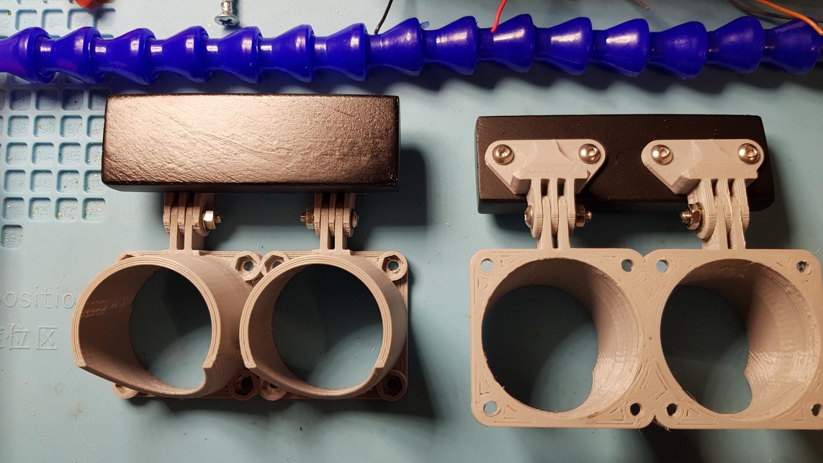

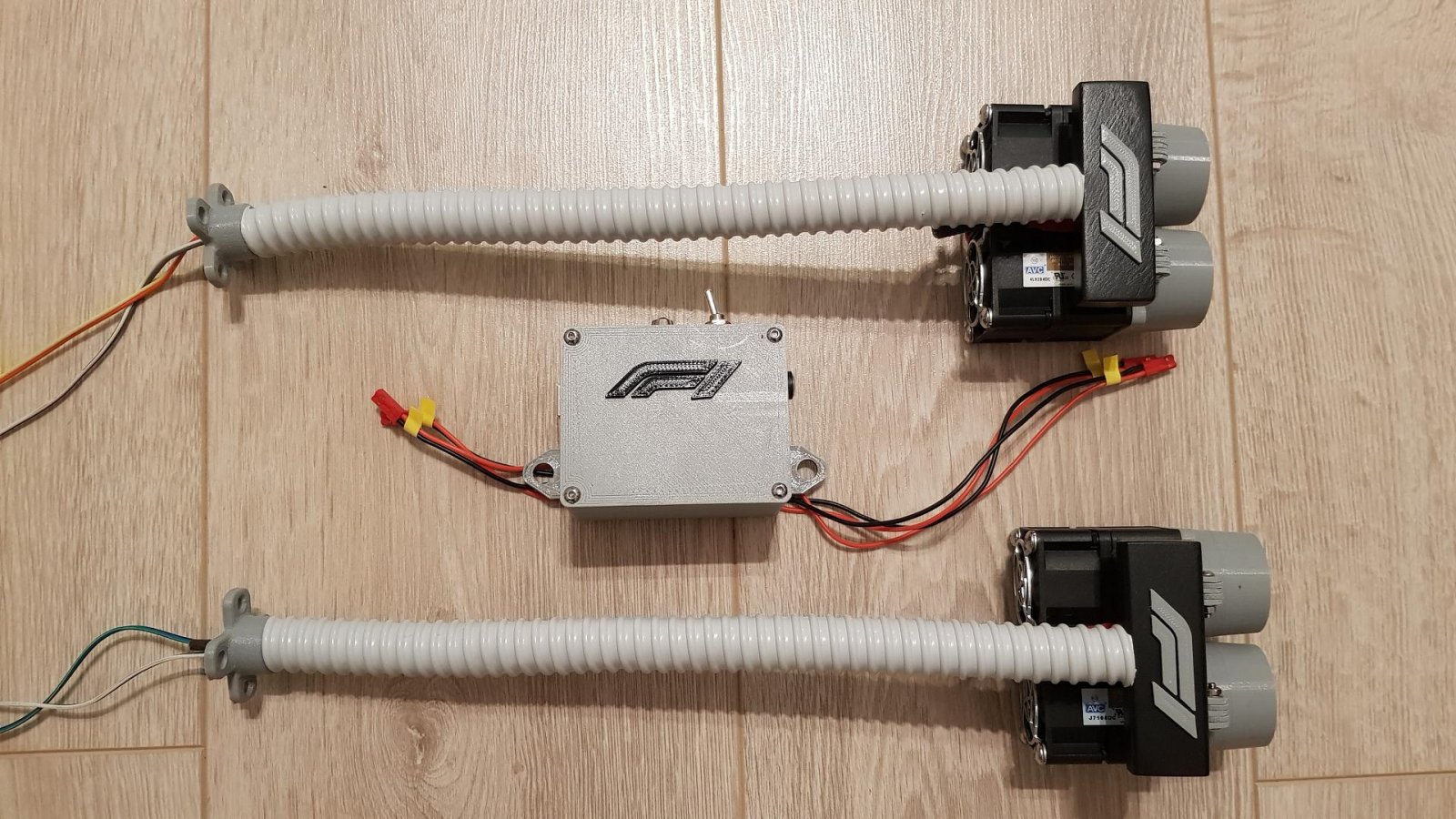

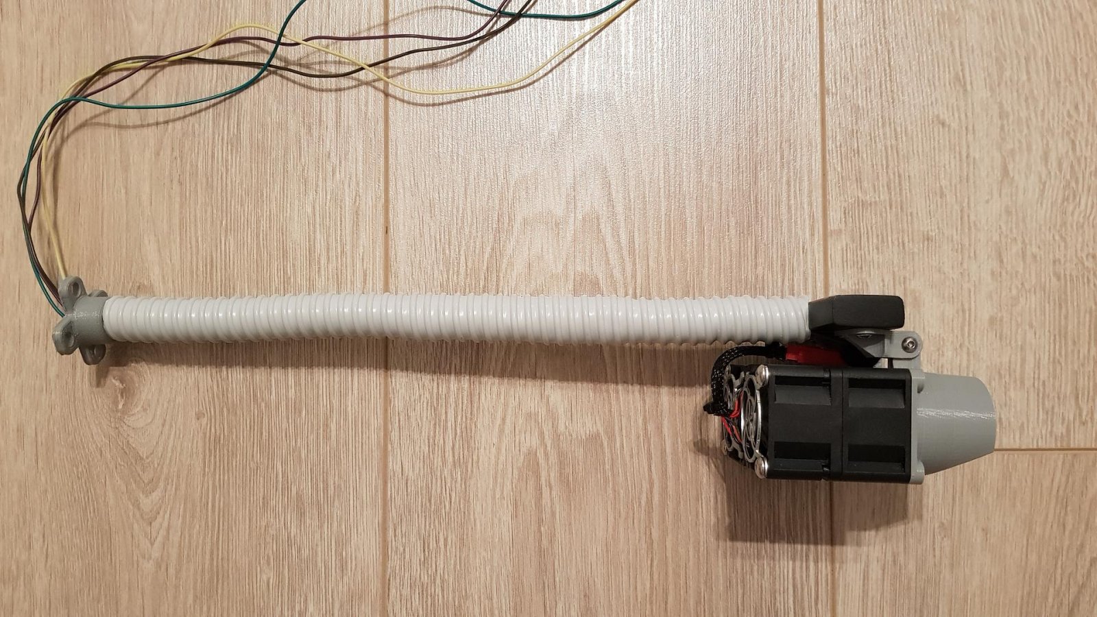

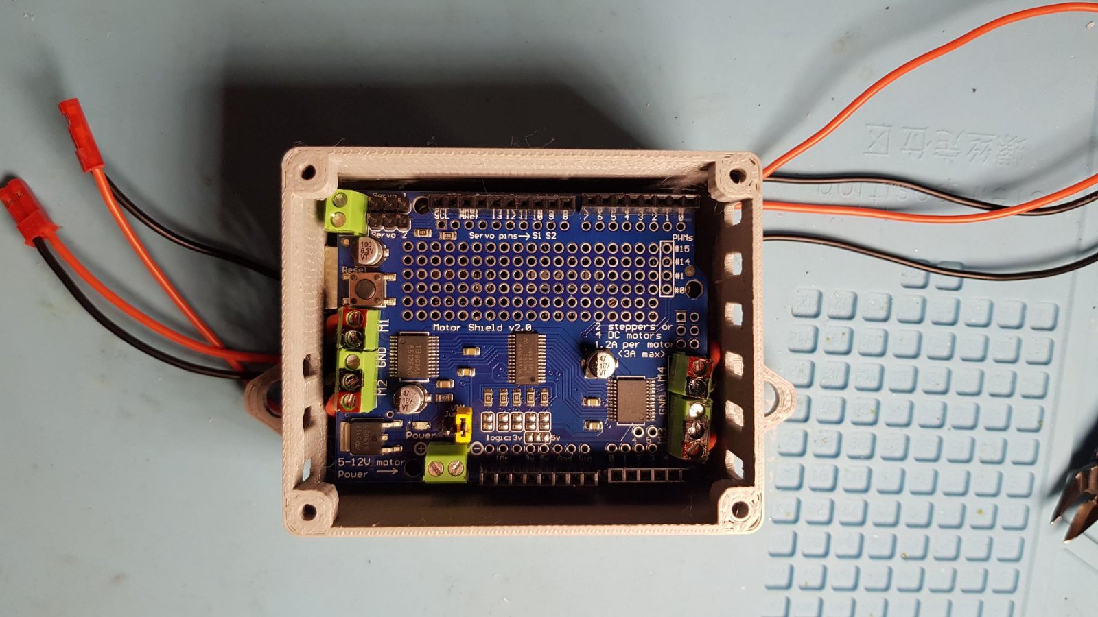

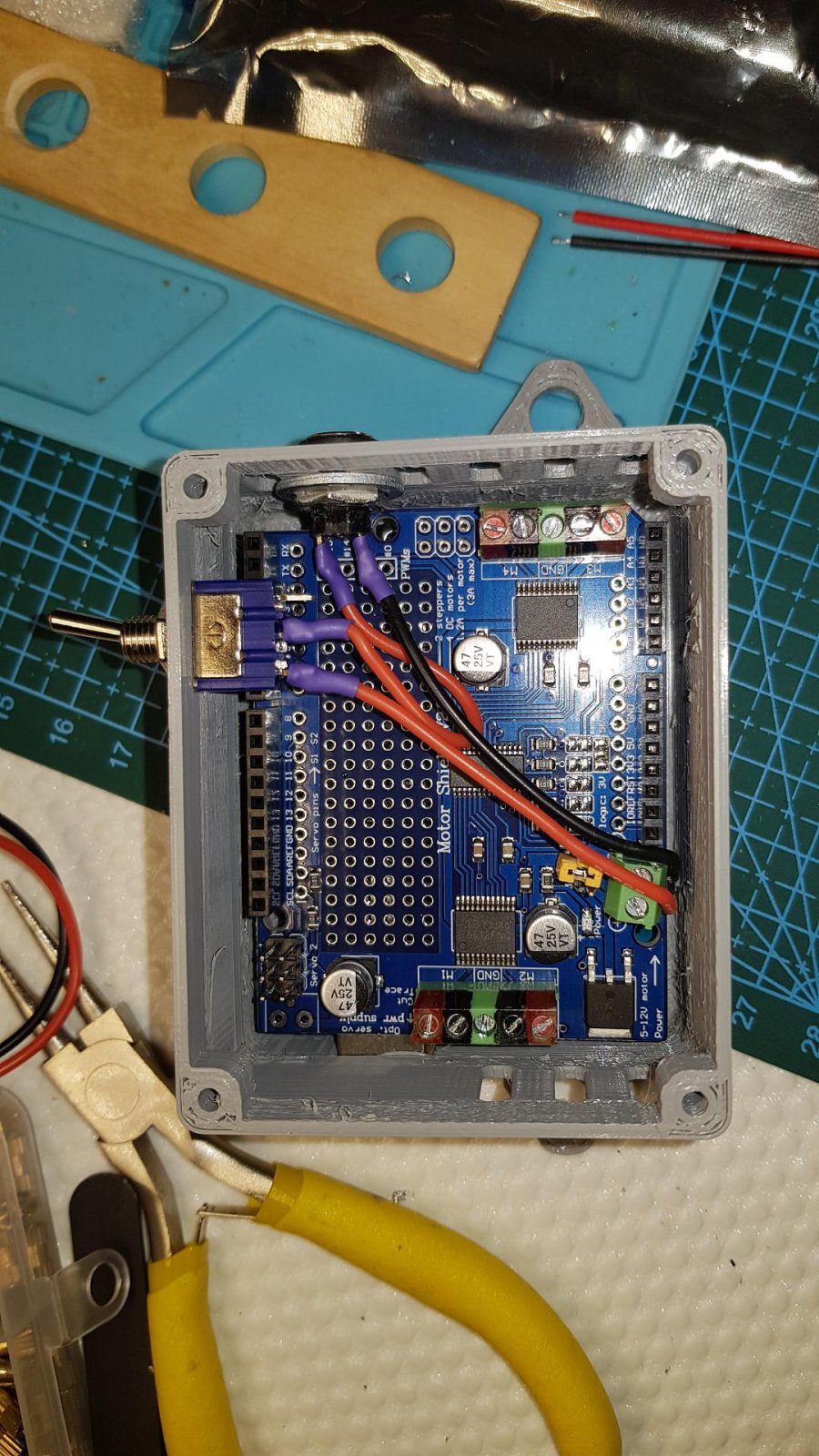

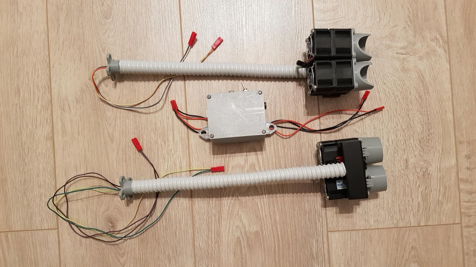

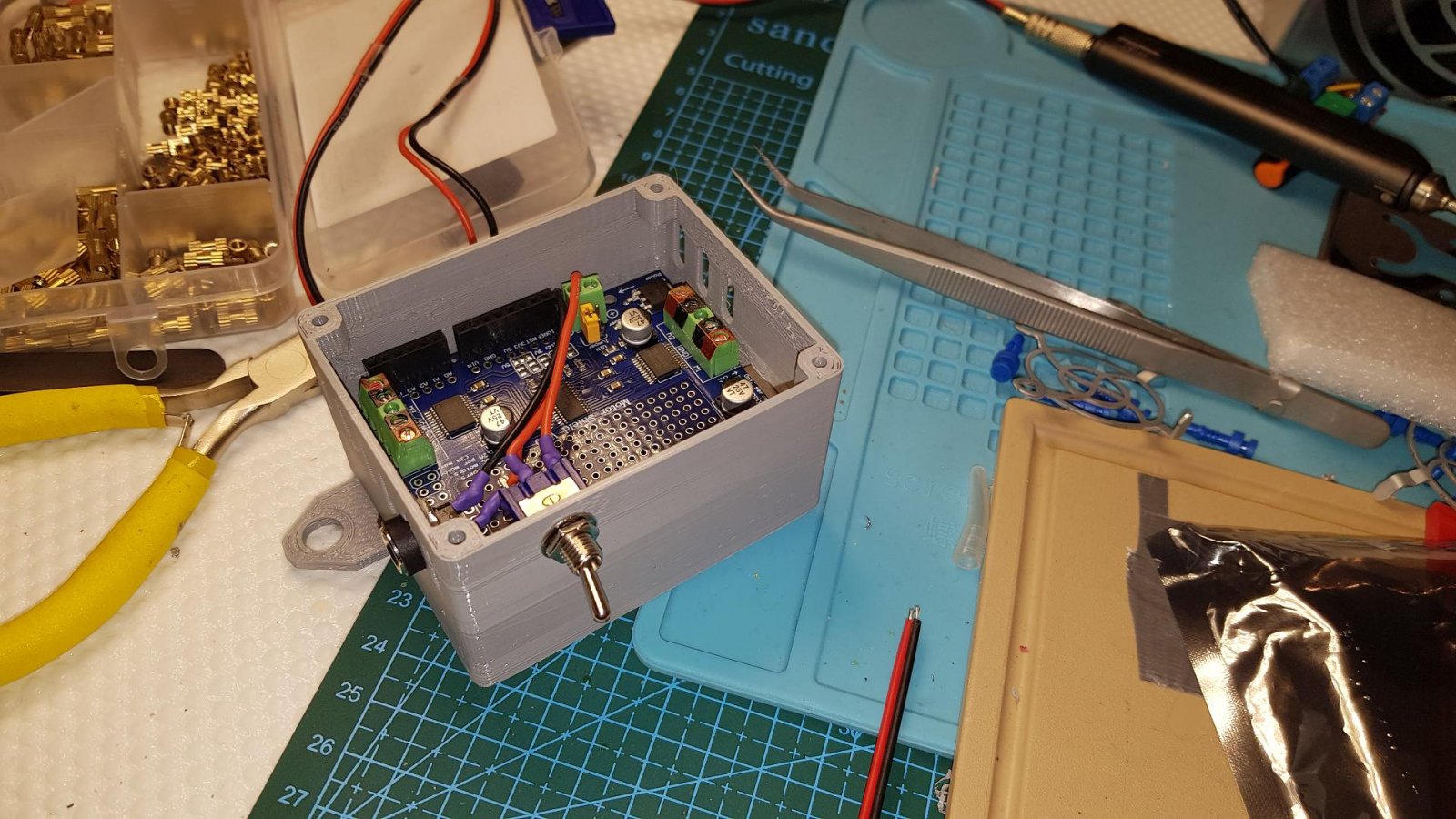

    This is the wind simulator you can build.
    It is 4 channel simulator. Using 4x fans from IBM x3550 server. You can buy those from ebay and they are not expensive.
    This wind simulator is very compact, responsive and powerful. In SimHub you can define 4 separate effects.
    I am using separate speed and curving effects.
    From the pictures you can see the process. If anything is not clear feel free to ask.
    The arduino box on the picture is has cabling in the back because the are meant to be mounted on the 4040 alu profiles.

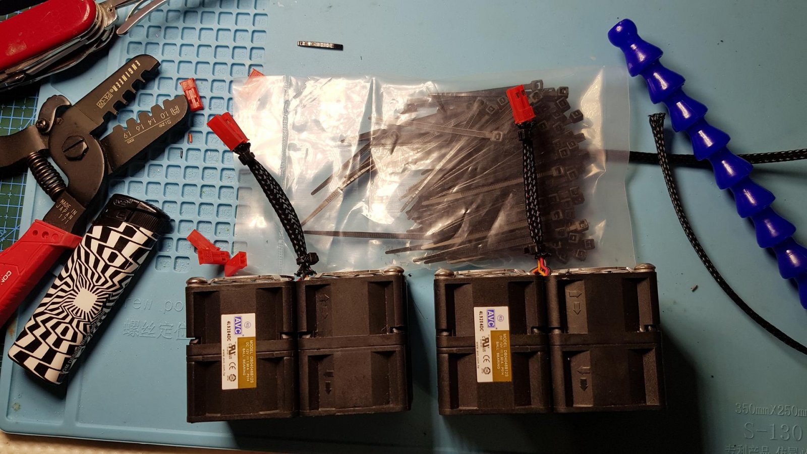

    Material used:
    - 4x IBM x3550 wents (in SimHub i have best results with 800-900hz when programming arduino)
    - screws are 3mm
    - inserts are 3mm
    - led diode with holder
    - on/off switch
    - power connector
    - wire
    - few zip ties
    - wire
    - Self-closing wire wrap
    - jst connectors (red one) - manually crimped

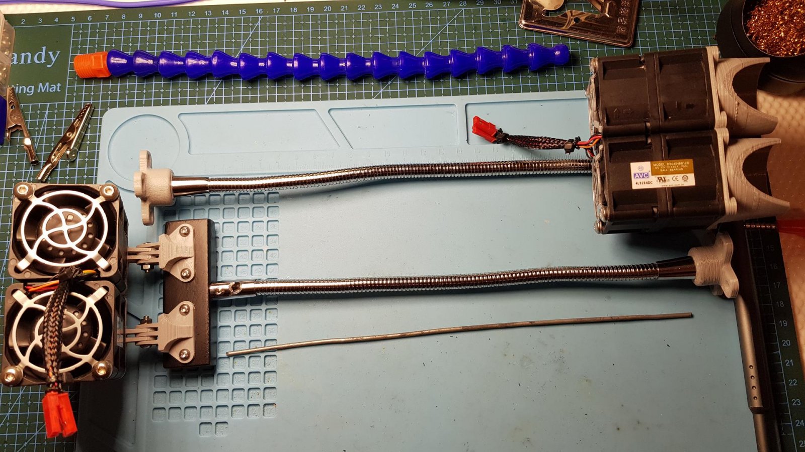

    - 2x flexible arm (can be plastic or metal one); in pictures they are inserted into some tubing. To be sturdy enough I have inserted one around 2mm thick wire in the tube. https://de.aliexpress.com/item/4001107499899.html
    - 2x wood screws

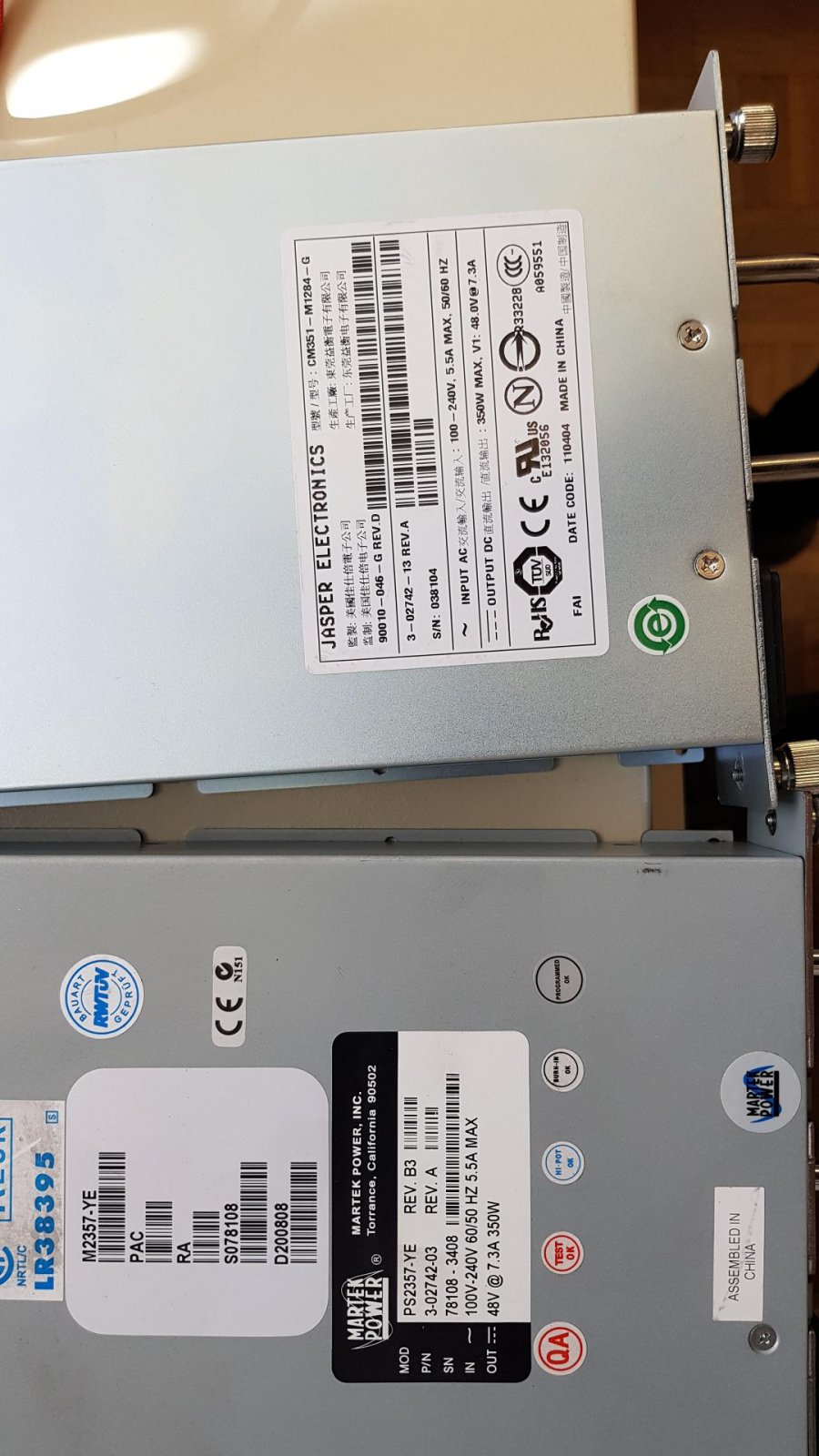

    - 12v 4A Power supply (It can be also lower spec like 2,5A since the fans are so strong that you will not run them at max. I am using them at 20-30%.) One motor is rated 1.9A but at Max it uses 1.2A; so 1,2/3=0,4Ax4=1,6A at 30% so 2,5A is enough.

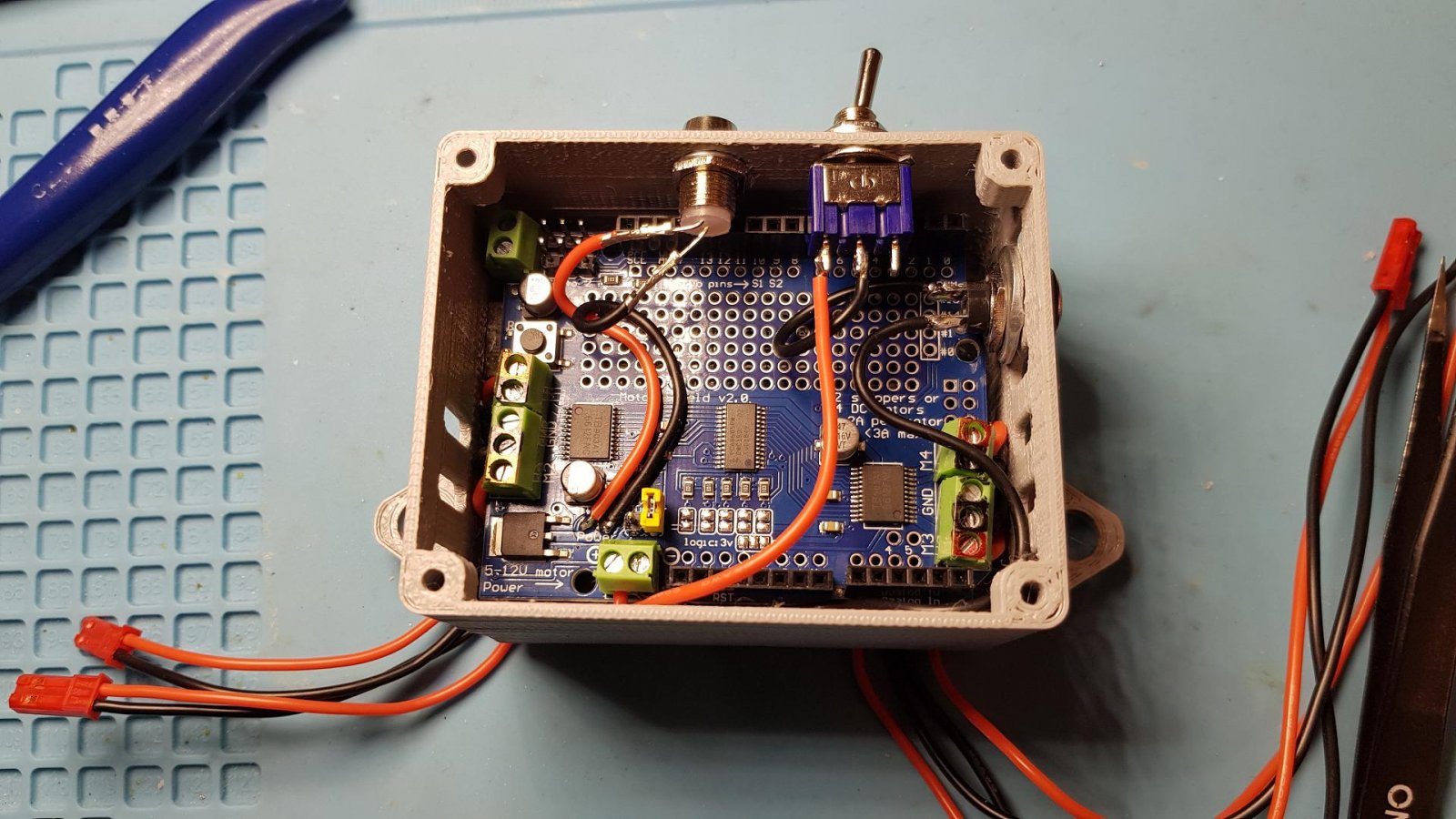

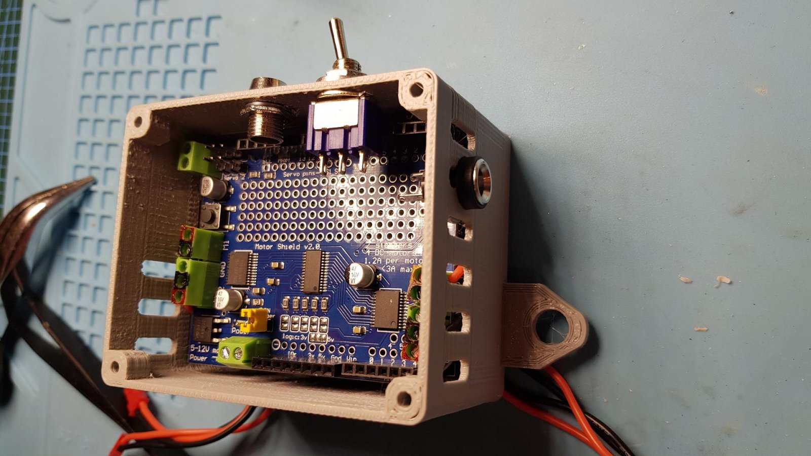

    - Arduino Uno (removed power connector)
    - Motor Shield v2

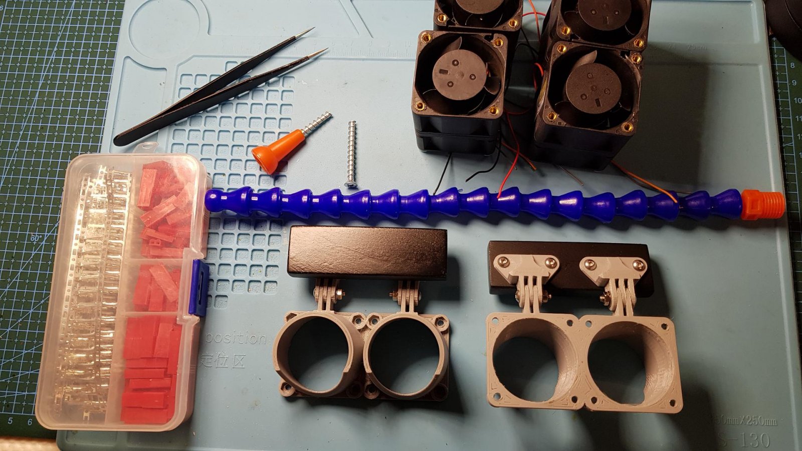

    3d print files.

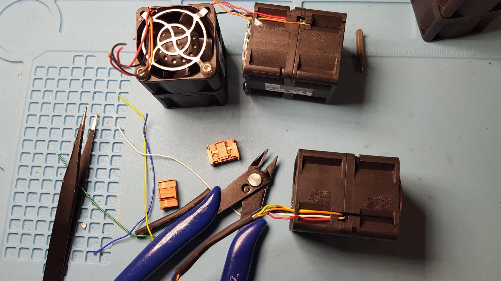

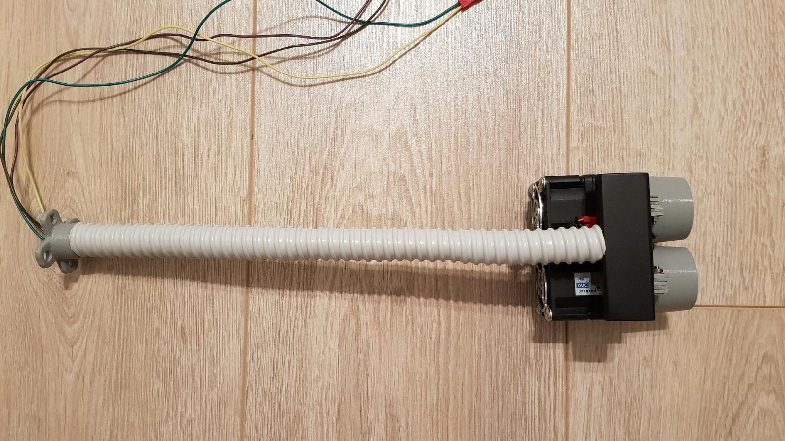

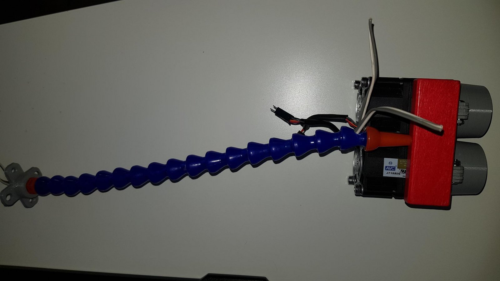

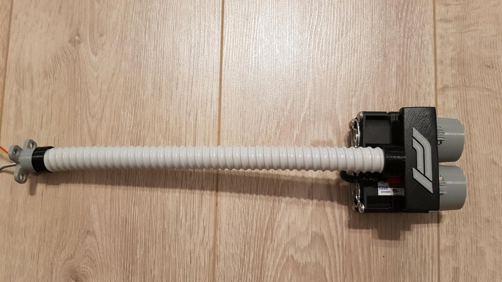

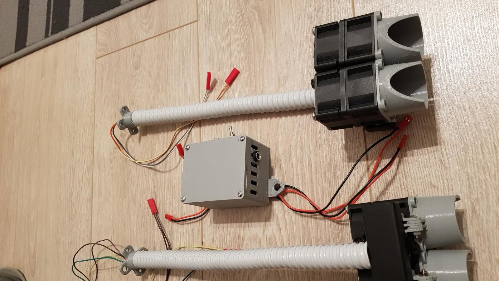

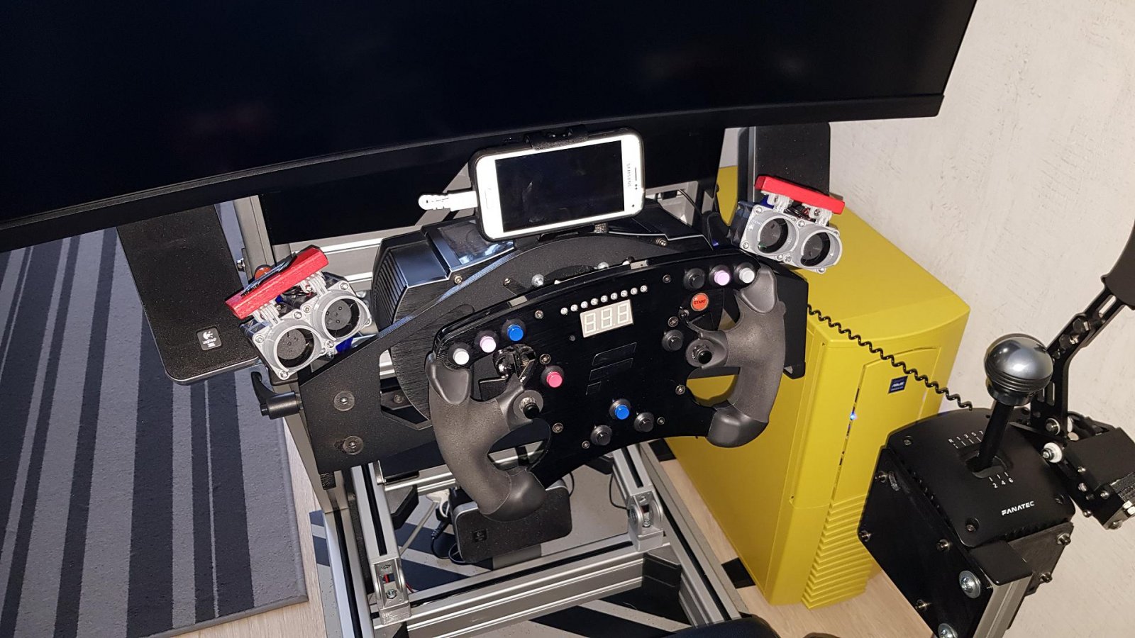

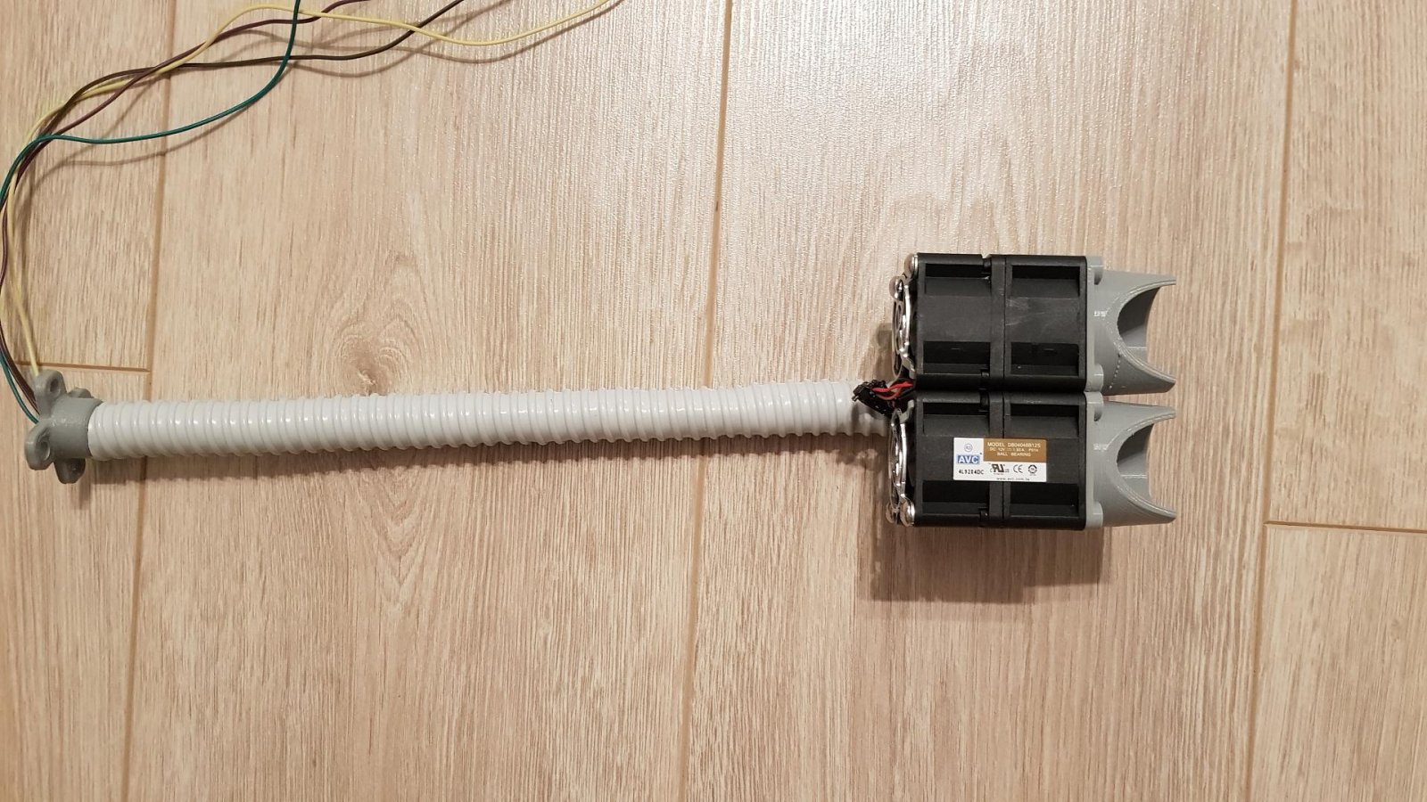

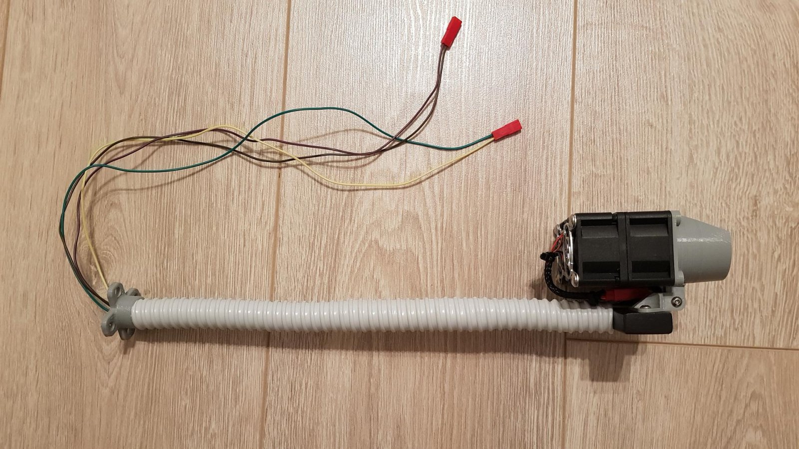

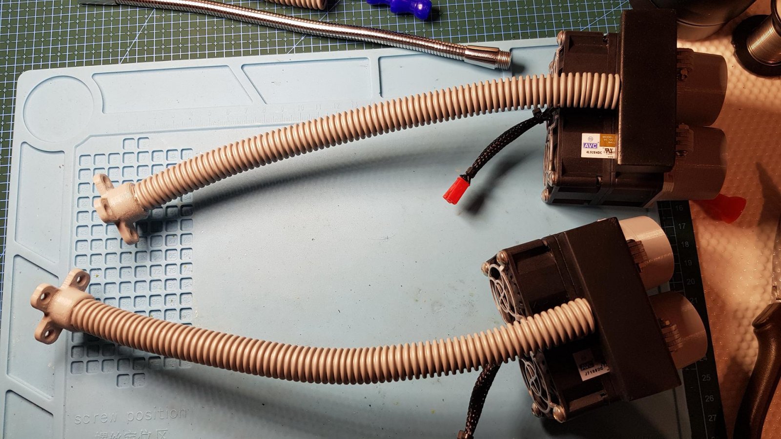

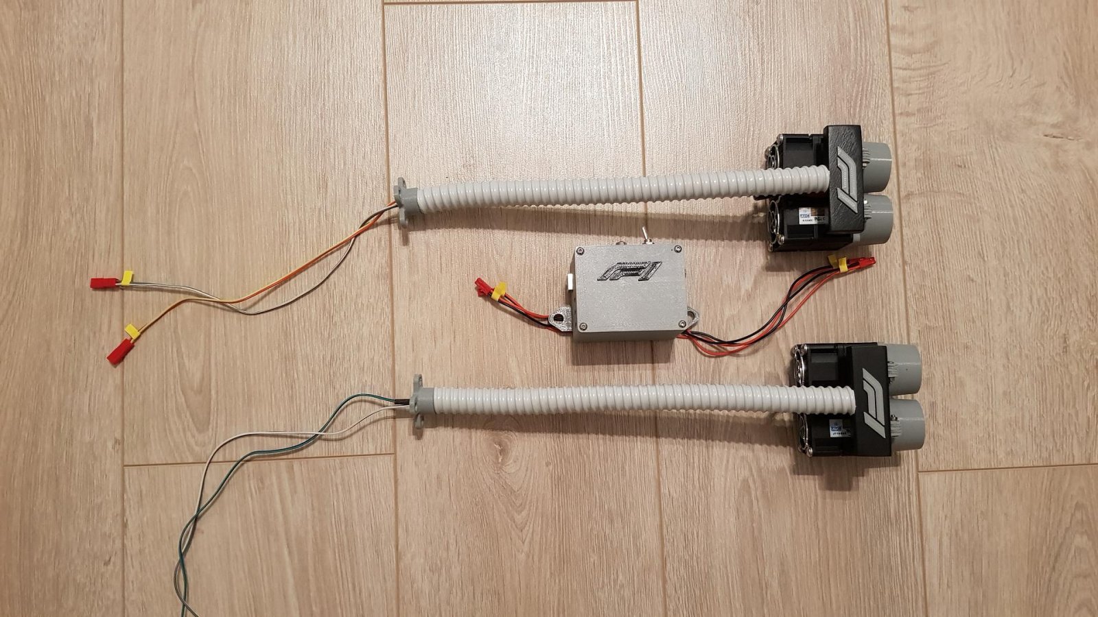

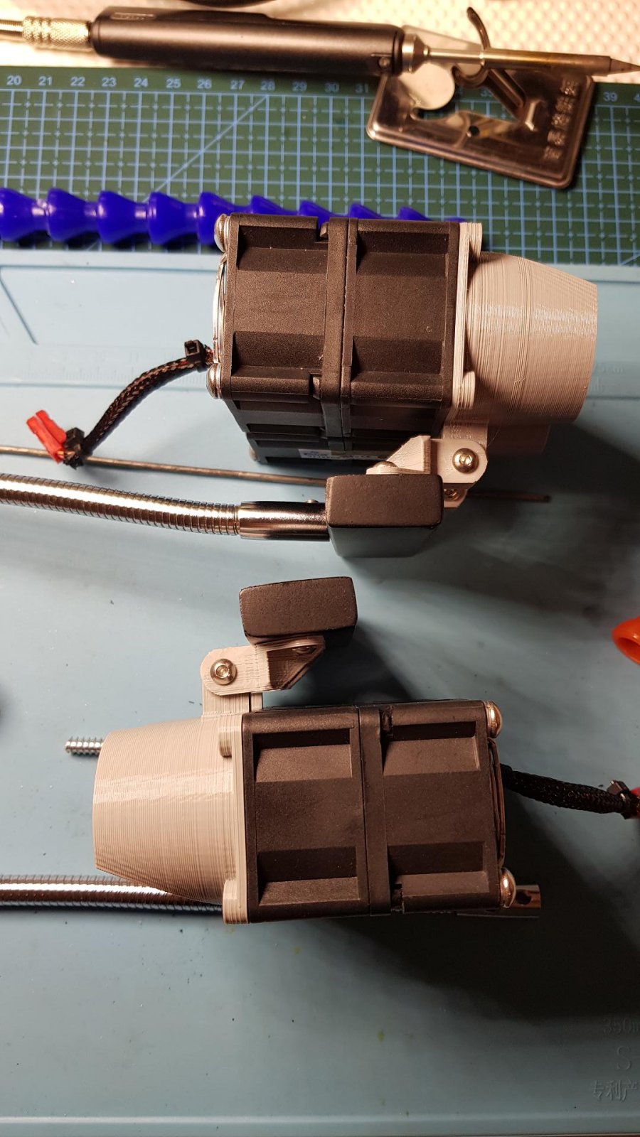

    Additional pictures from first build.

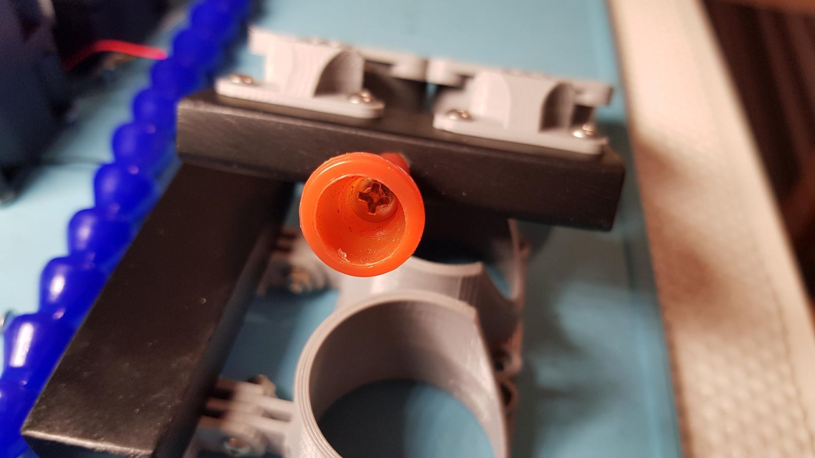

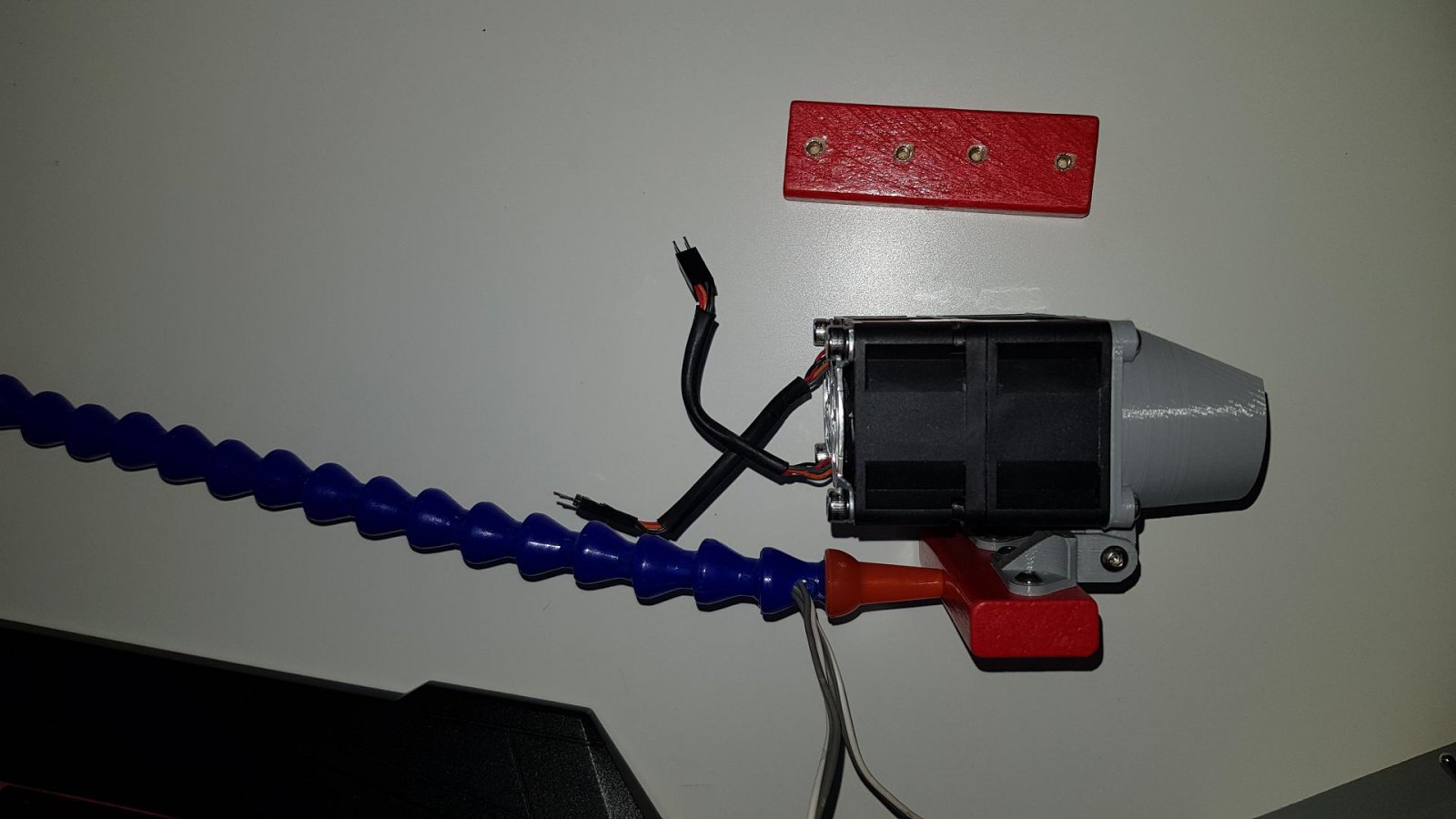

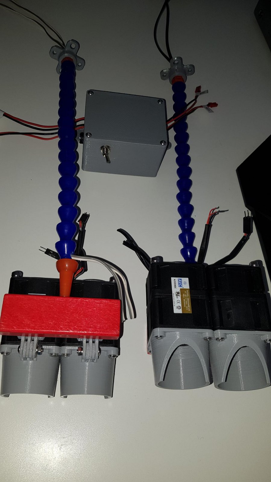

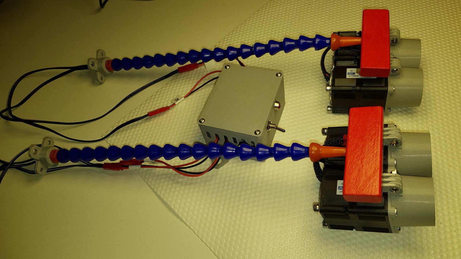

    End caps mod.
  5. neportocala
    neportocala New Member
    Jun 21, 2020
    8
    52Coins

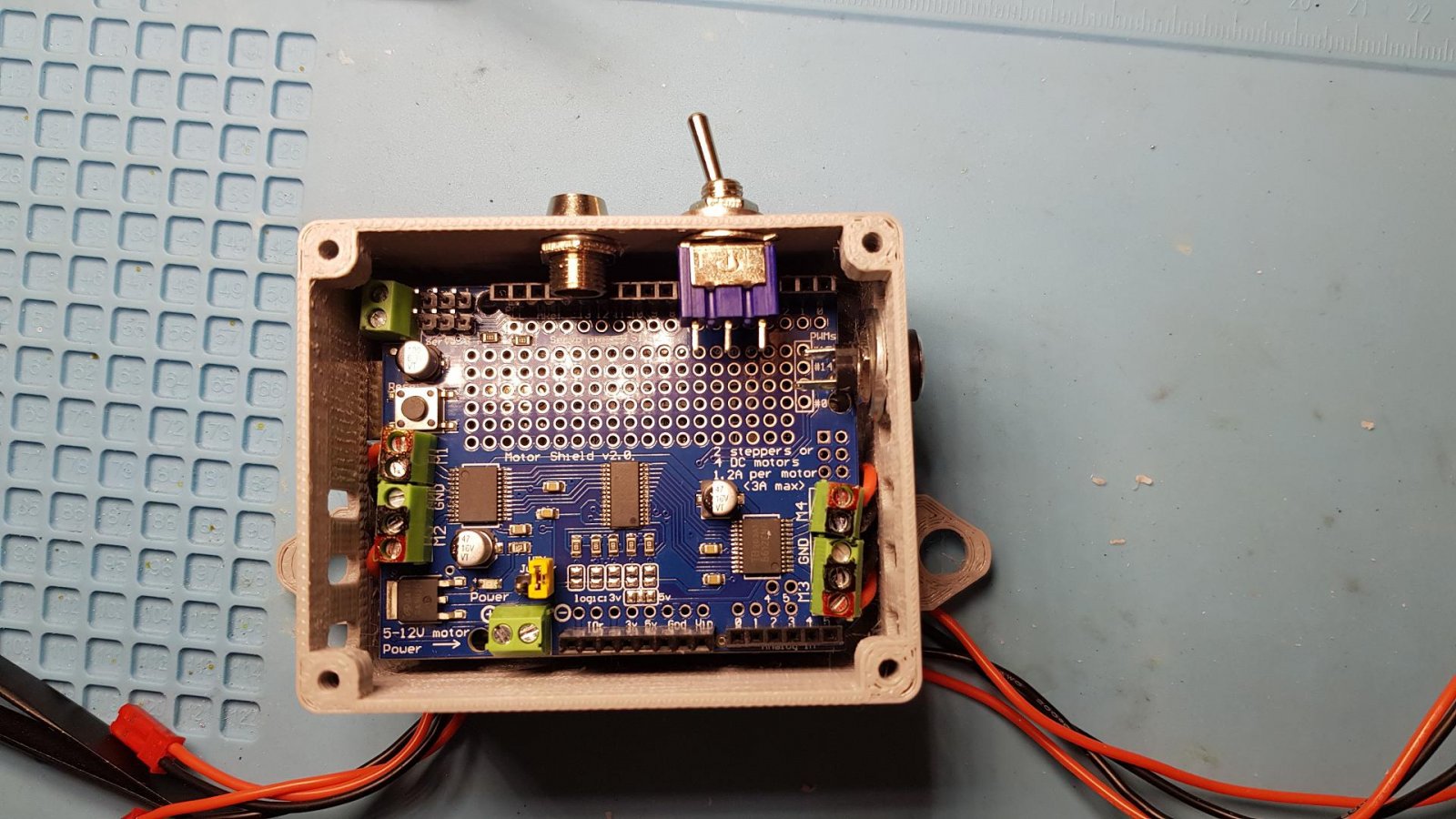

    question: are your fans 12v? My motor shield v2 won't output more than 6V and I don't understand why.
  6. iLLuac4
    iLLuac4 Active Member
    Jun 19, 2019
    136
    893Coins
    +58 / 0 / -0
    Yes they are 12V. They do work. I am powering them directly from shield board and also you have to remove the jumper on the shield to enable external power.

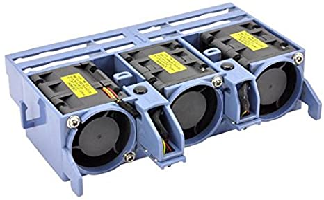

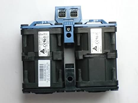

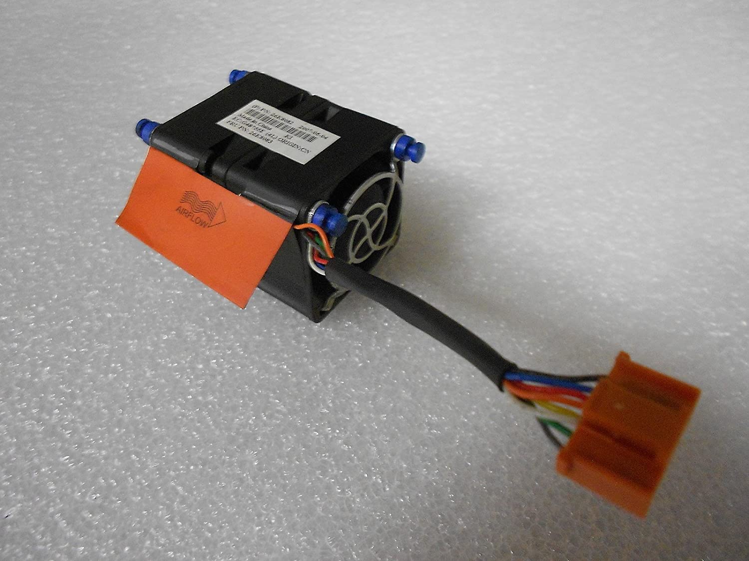

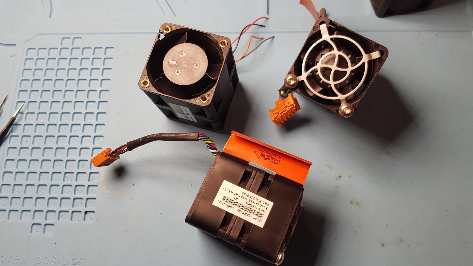

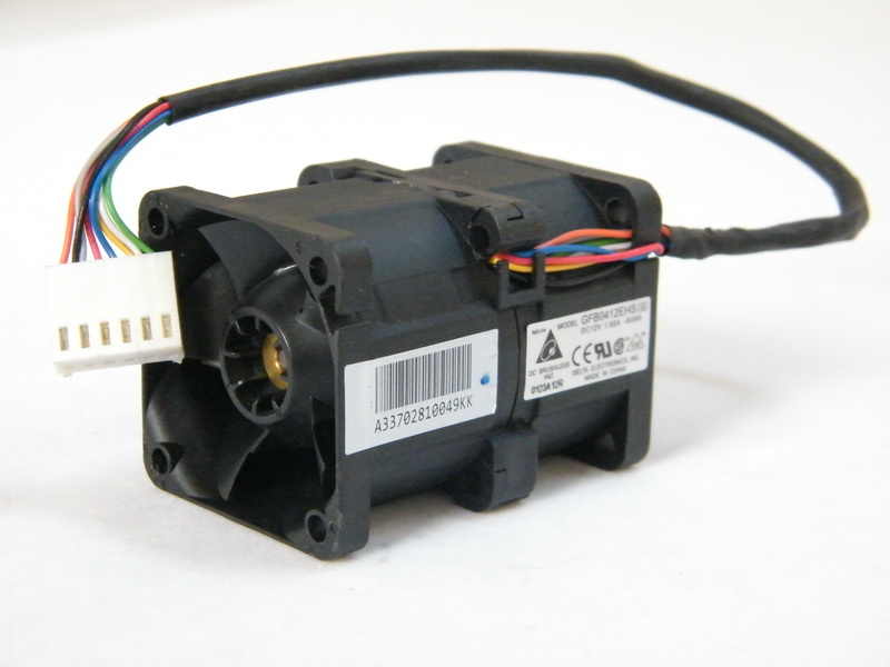

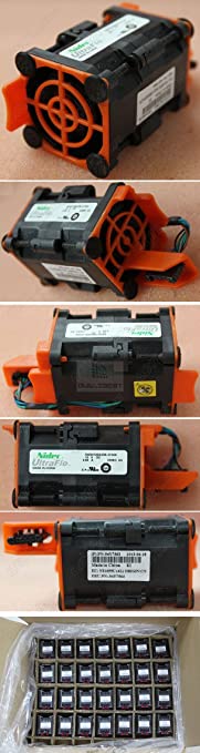

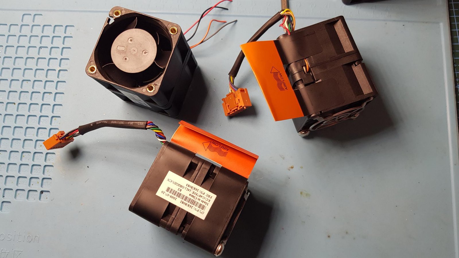

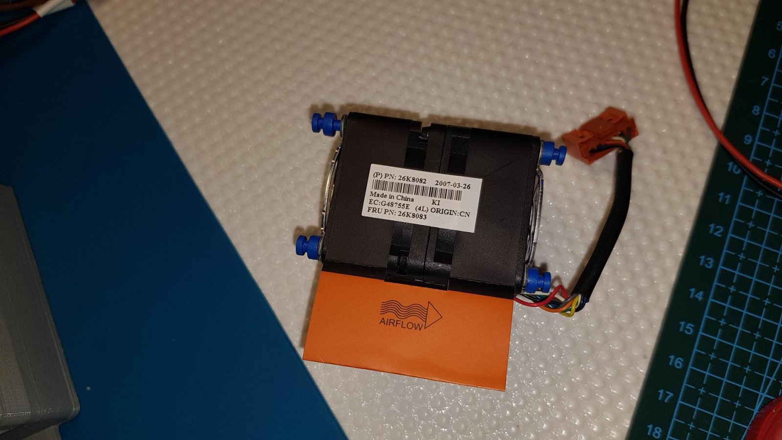

    A note about which fans are good and which are not. The difference is that some fans are responsive and some are not. Servers usually starts with full blow and some wents need full power to startup. Those models are not good and you will not be able to get a good response from them. They are not usable.
    I would say buy HP DL360 fans G4 (part number 361399-001; they are in a pack of three). Those are cheap and just great. Also IBM ones are good.
    1. Good:
    IBM x3550 fans
    HP DL360 fans G4
    2. Not Good:
    HP DL360 fans G6/G7/G9
