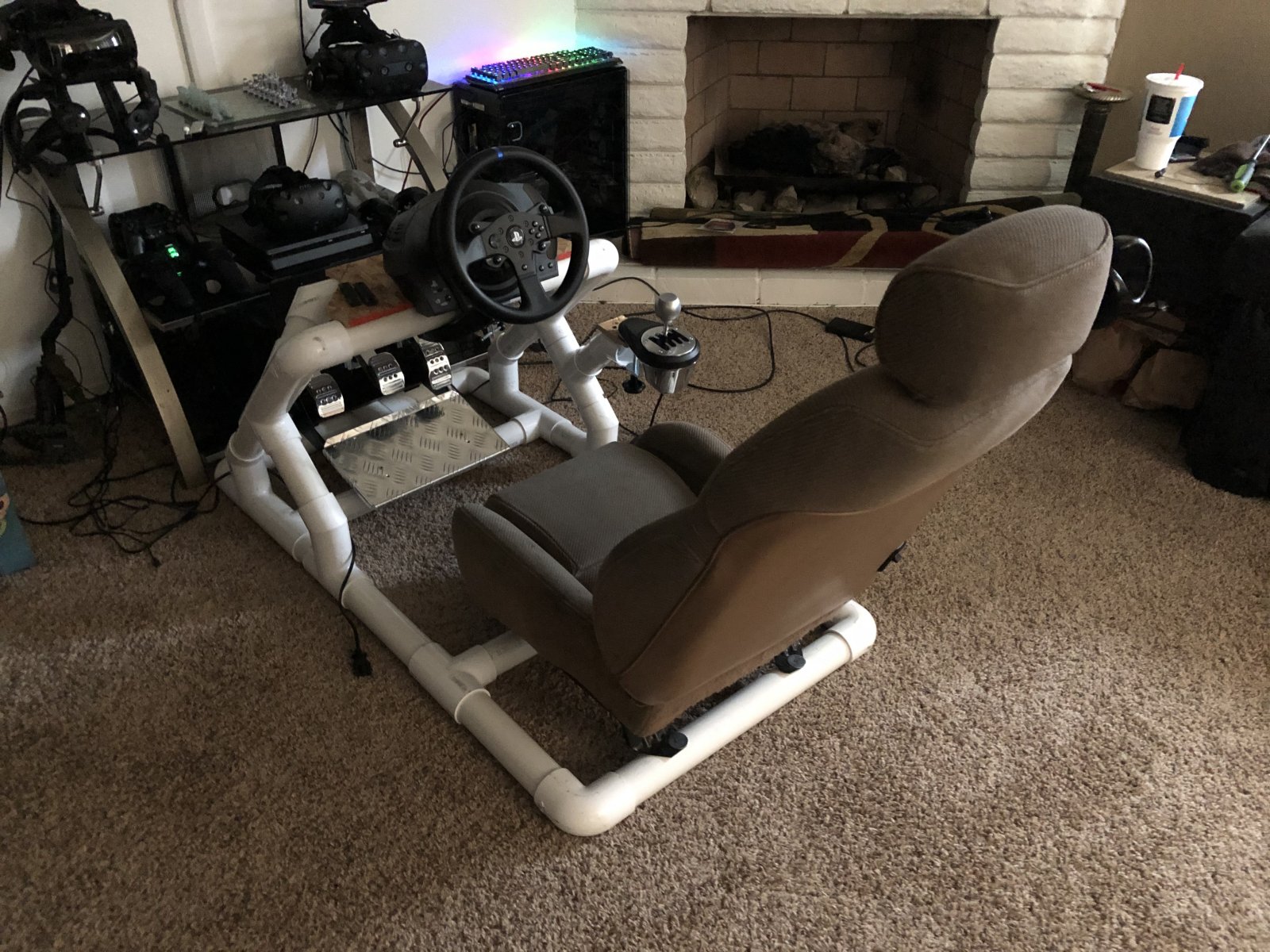

    I built a basic PVC sim rig after getting into VR a few weeks ago and it was a blast. The level of immersion the VR and force feedback bring to the table is just incredible. However, it instantly left me wanting more and I couldn't help but imagine the possibilities that a little more feedback could bring. I started researching motion rigs and was initially taken aback by the price, but after a bit more digging I came across DOF reality and the amazing systems they are offering. After watching Sim Racing Garages reviews on the seat mover, H2, and H3's I was surprised at how relatively straightforward the electronics seemed. A few more late nights researching and I came across this gold mine of a website!!

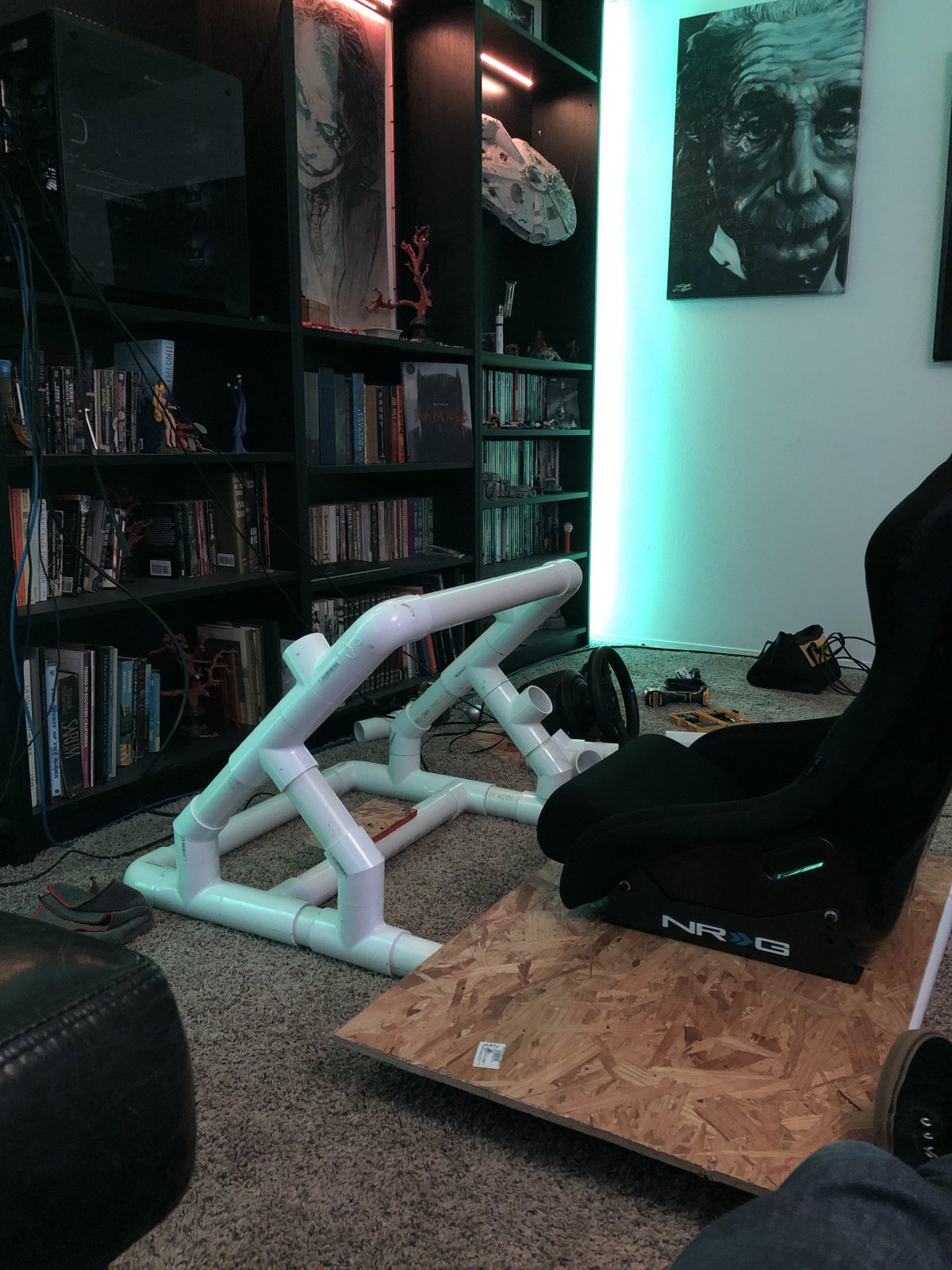

    IMG_1462.jpg Initial PVC build using an old seat out of my Mustang. The PVC is great to work with when getting initial dimensions to determine what 'felt' best for me.

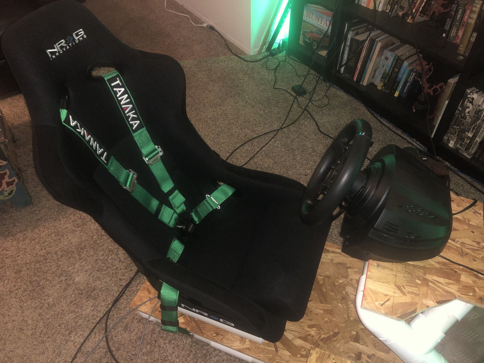

    NRG FRP-300 seat and Tanaka 4Pt Harness (you know, so I don't get thrown through a virtual windshield HaHa), great deal on amazon. I will be adding extra foam to the lumbar area and seat pad when I embed the Dayton shakers. Another nice thing about the PVC is how easy it is to disassembly when mocking things up!

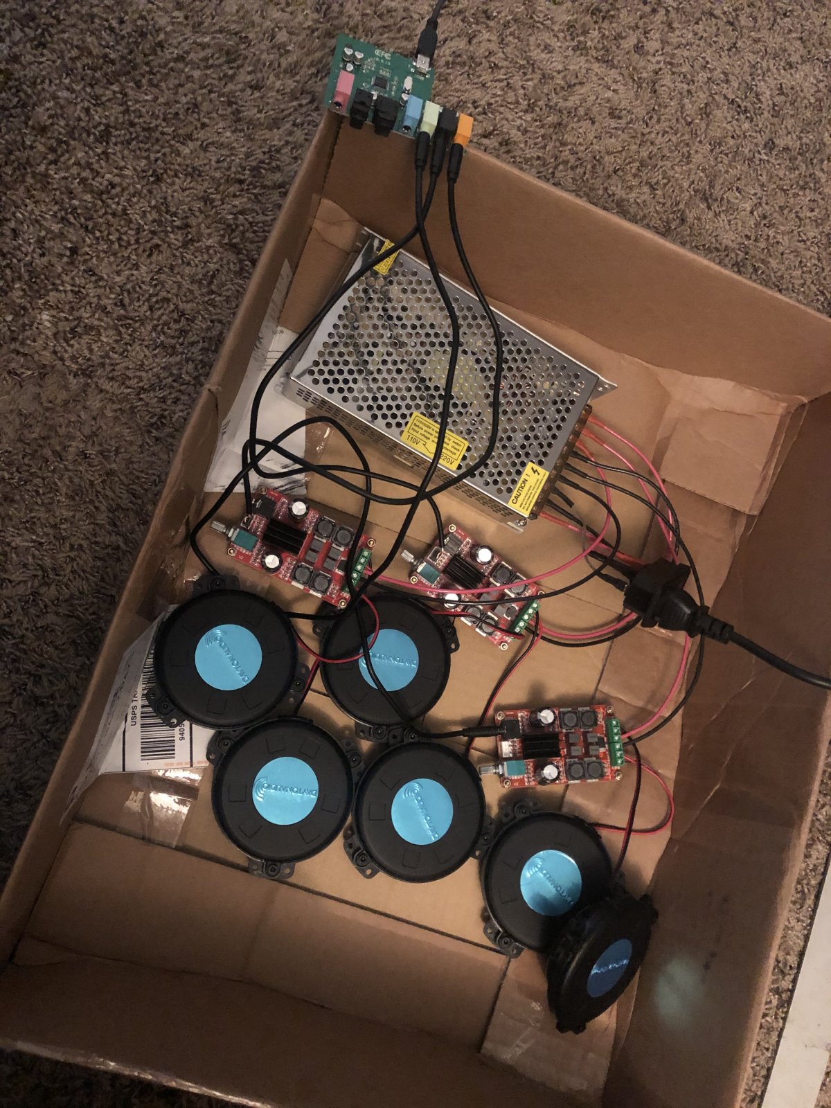

    Dayton shakers, I have mocked these up in the seat and using the Sim Racing Studio software after some tuning the haptic feedback is pretty dang awesome. I am running two in the front of the seat wired to FR and FL channels, two in the back of the seat wired to RR and RL. I also have two under the pedals wired to FR and FL as well as a pair under the seat buttkicker style wired to SUB. I got the idea for this from Sim Racing Studio's ShakeSeat and ShakePedals. They seem to be a great over the counter solution for this kind of haptic feedback! https://www.simracingstudio.com/product-page/srs-shakekit-shakeseat-integrated-with-shakebox-lite

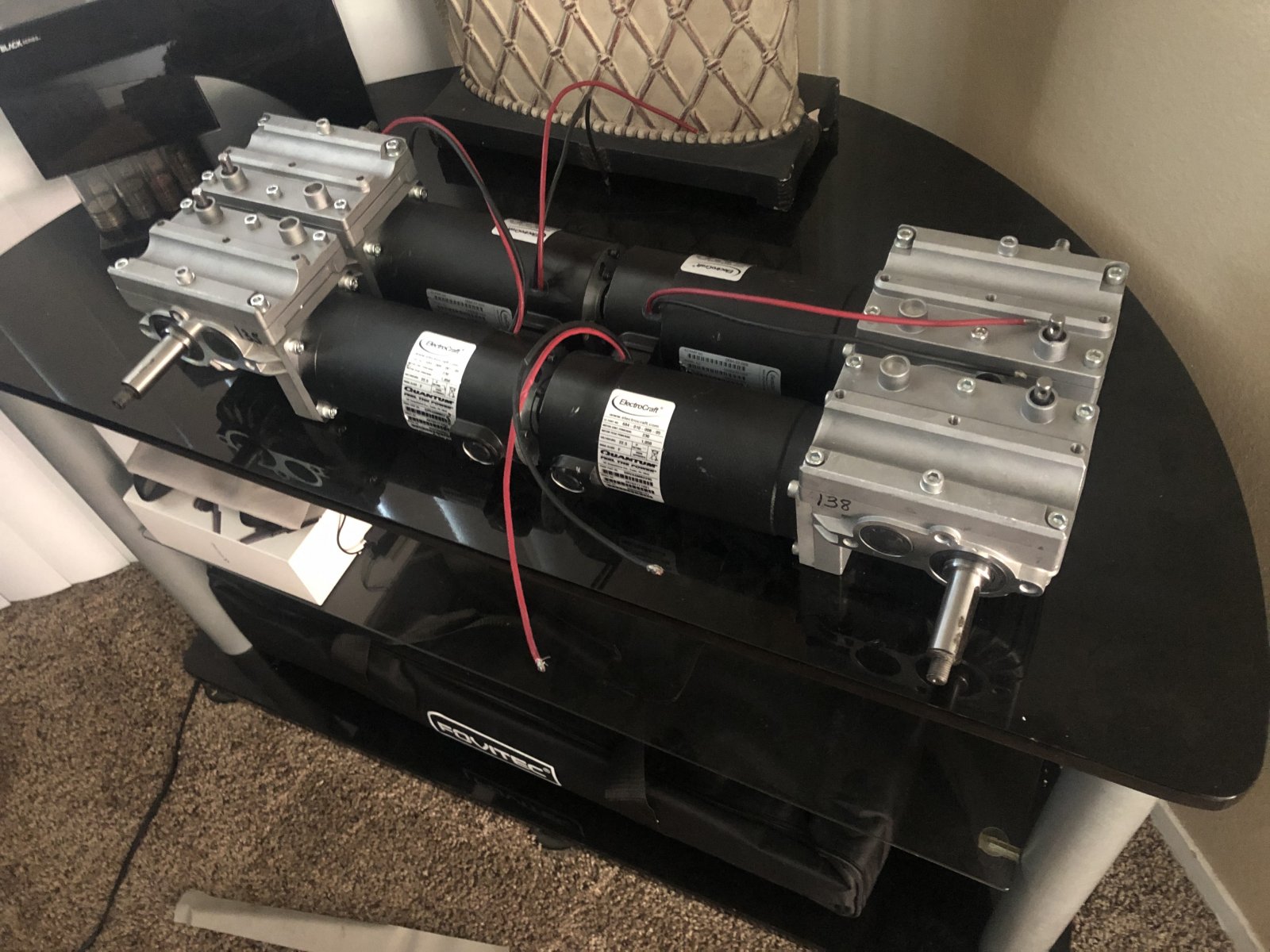

    IMG_1484.jpg 4x 250w continues 1050w peak 24v DC Motors w/ Worm drive gearboxes

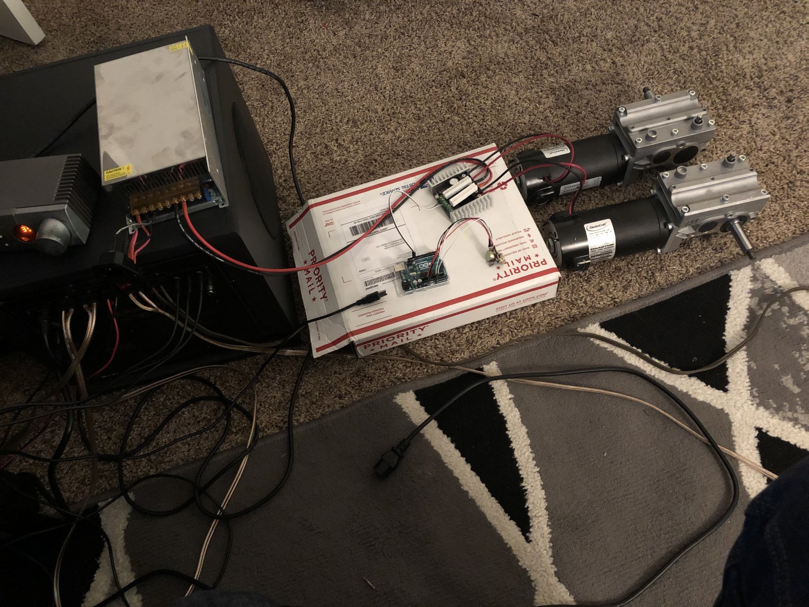

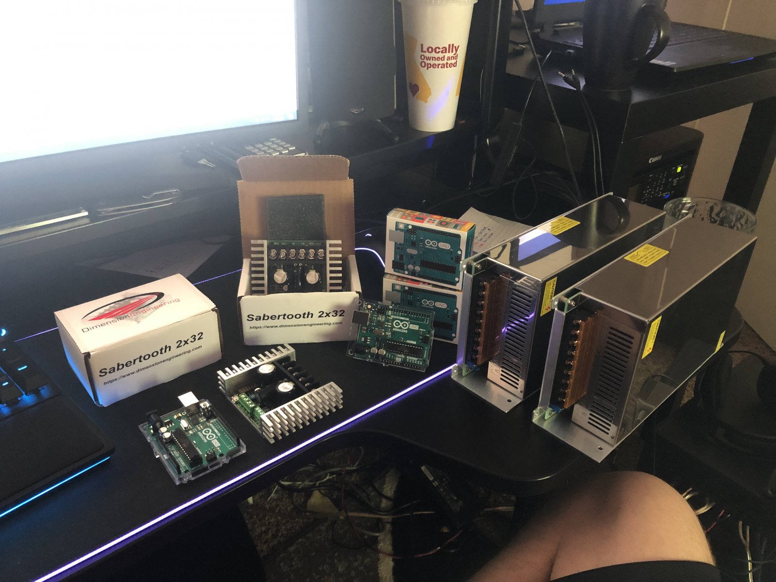

    My Amazon potentiometers showed up early so I got to wiring everything up in a test capacity.
    The Sabertooth 2x32 supply's a return current to the power supply via regenerative breaking. When using a PSU rather than a battery you must create a voltage clamp with appropriately sized resistors to dissipate this current. My local Fry's electronics did not have nearly large enough resistors to create the appropriate circuit to dissipate the motors regenerative current. Per the convenient calculator provided by dimension engineering I determined I would need a 1x 200w 3 ohm resistor per motor.
    Resistor Calculator:
    https://www.dimensionengineering.com/calculators/power-resistor
    200W 3 Ohm resistors are relatively expensive at around $20 USD each on eBay. I found a great deal on eBay for 18 100w 6 ohm resistors for only $30 USD shipped! I intend on wiring two each per motor in parallel to create the appropriate 200w 3 ohm circuits.
    I used the amazing guide provided by BlazinH to wire and configure both the arduino's and Sabertooths. Following his guide made this so easy I would honestly say its barely DIY for the electronics and programming. Its just so simple!
    BlazinH's Arduino and Sabertooth guide:
    https://www.xsimulator.net/communit...ket-serial-pid-motor-driver-w-softstart.9277/
    After some tinkering I was able to get all 4 motors working within Simtools on individual axis and DOF's. After playing with this program some more I can really see the power this software has. I was so happy with its performance and intuitive programming I went ahead a purchased myself a pro license! I realize I can get a free DIY license once I complete this build but honestly I just wanted to support the guys that wrote this game changing software, without it my sim rig dreams would be going nowhere!

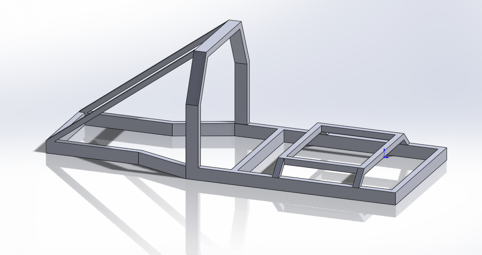

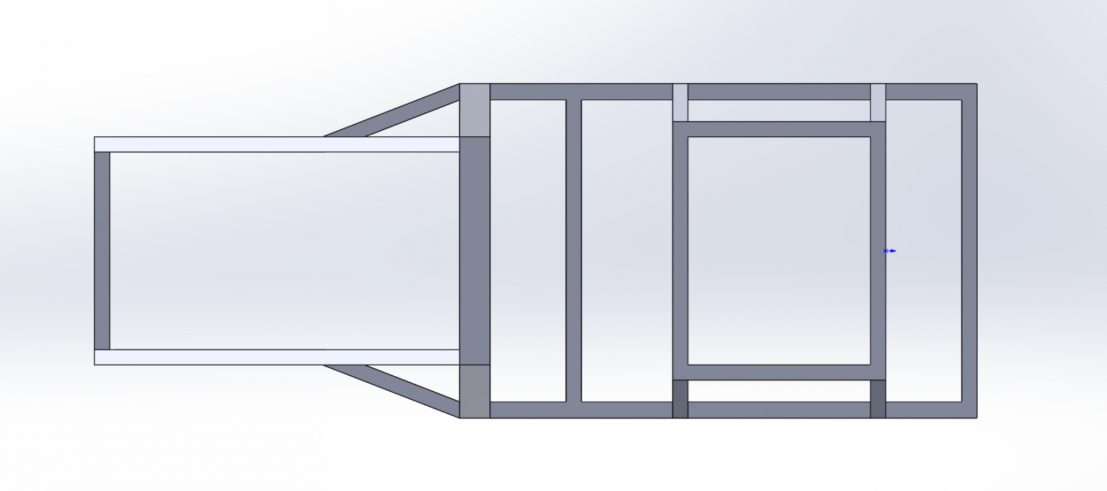

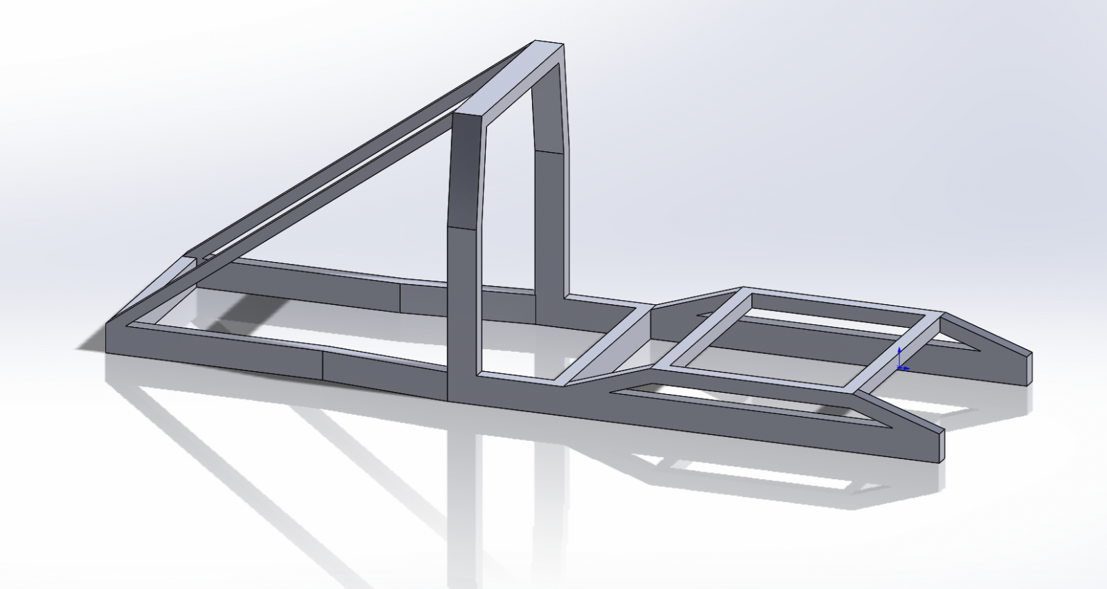

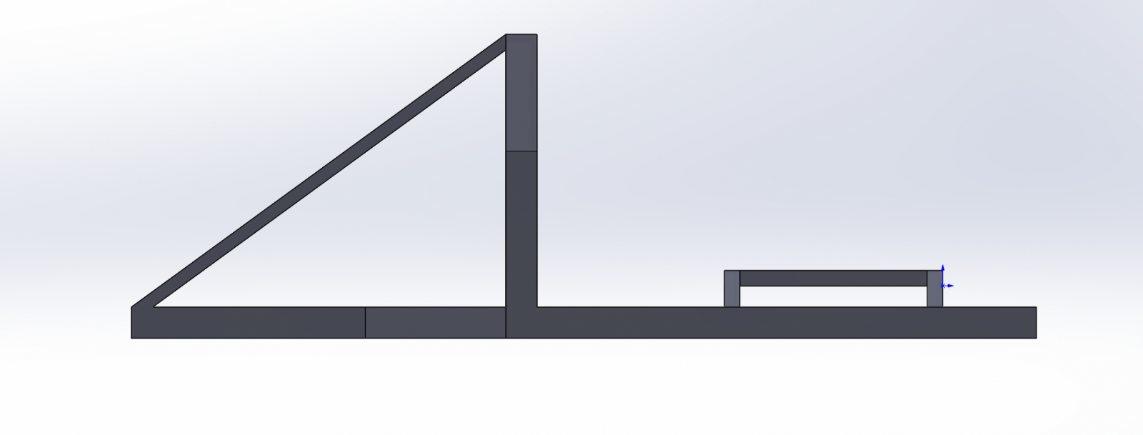

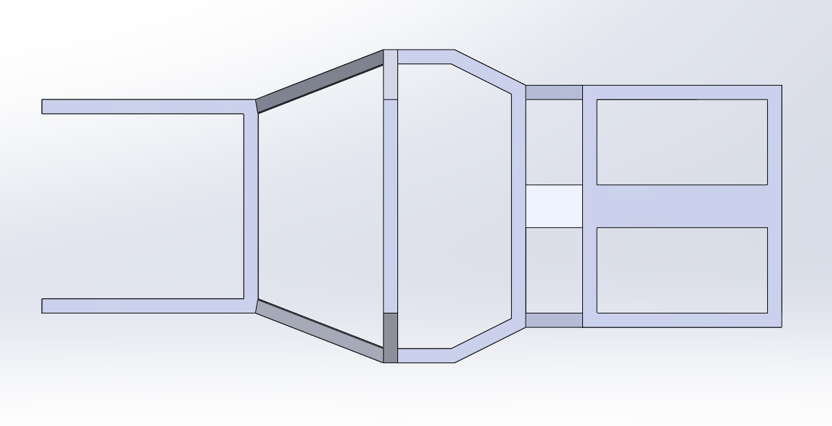

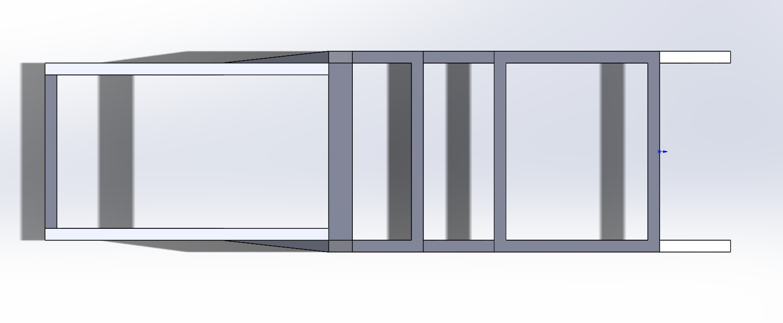

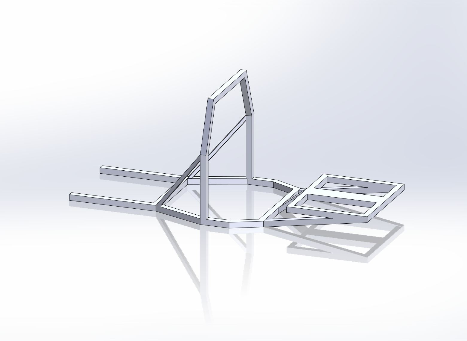

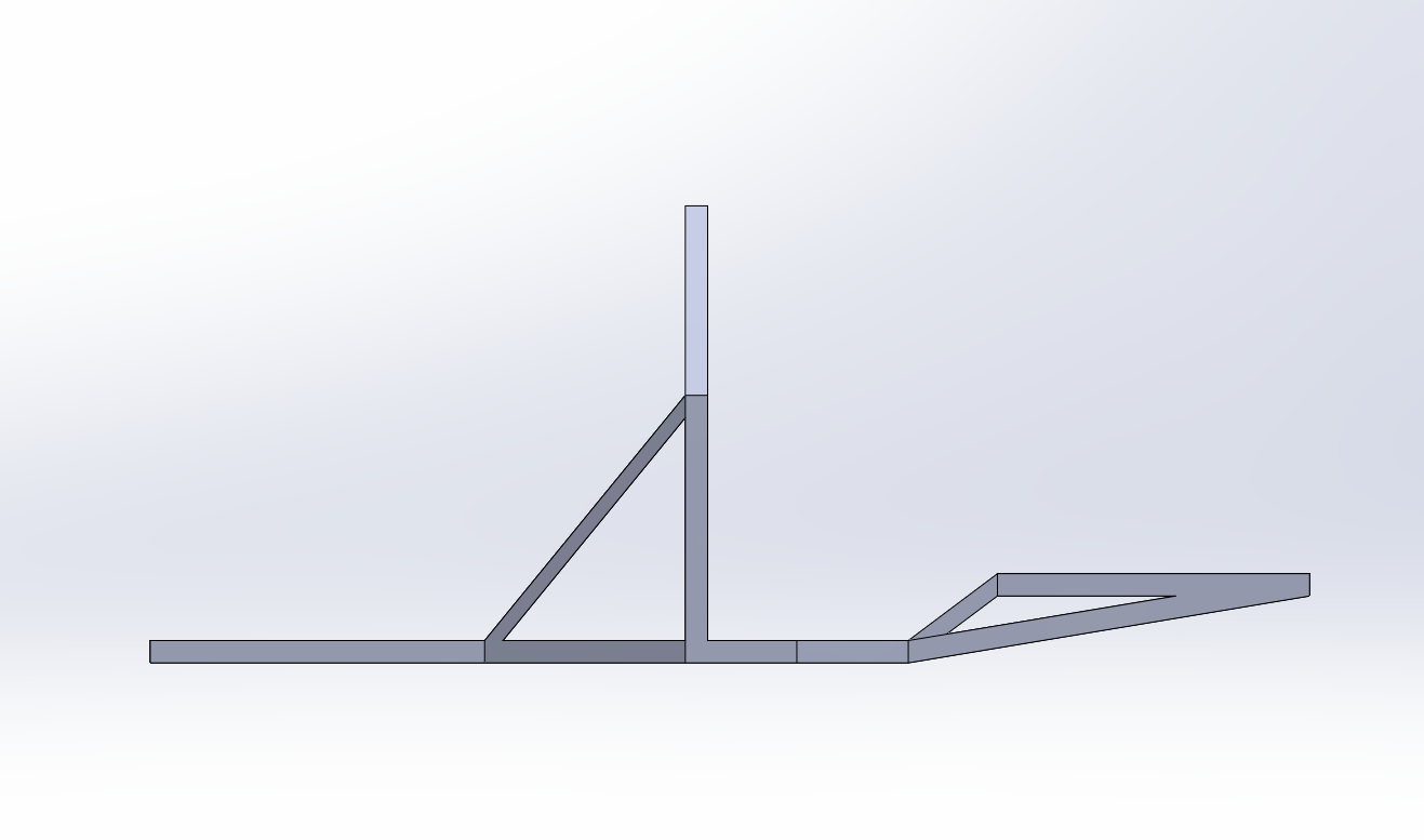

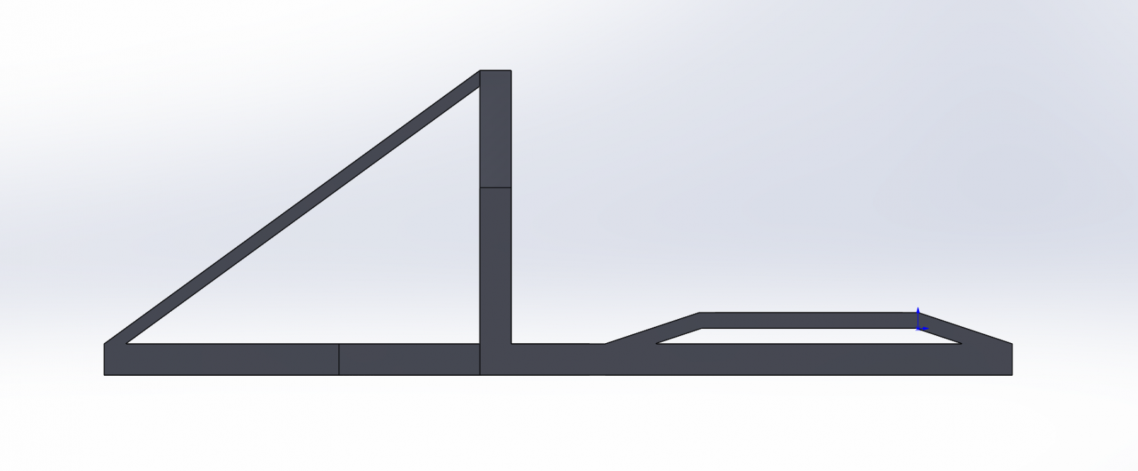

    Finally, I spent a small amount of time dreaming up some concepts for the cockpit. Using the dimensions from my PVC rig I mocked up these 3 concepts. I don't necessarily like/dislike any of them but none will be the final design. I'll probably go through quite a few more concepts before I land on something I like. Since this rig will be in the living room aesthetics are important, I'm drawing on the Vesaro and Next Level Racing rigs for inspiration. While these are just early concepts of the seat and wheel/pedal base frame I though I would post them encase anyone can draw some inspiration from the designs. They are based around 1x1 and 2x1 steel stock I happen to have laying around in my shop.
