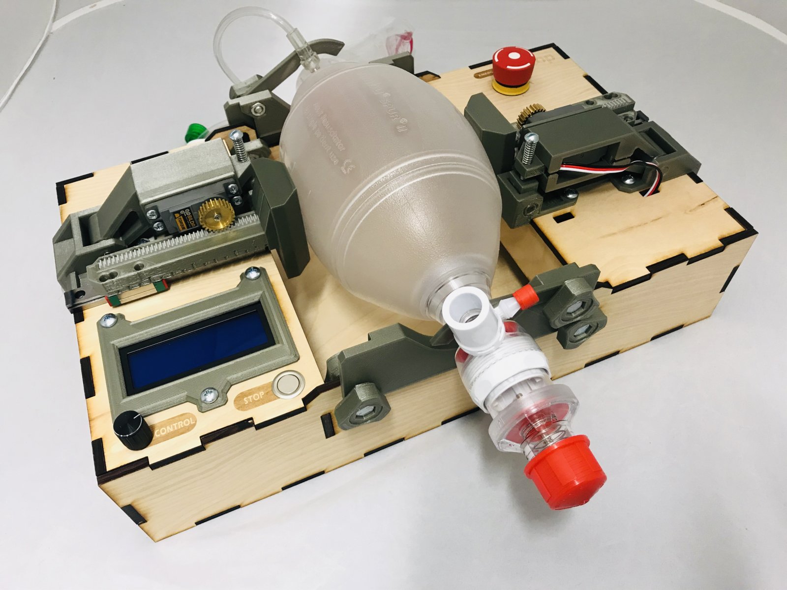

    It seems like this is the perfect group of people to make ventilators for the COVID-19 crisis. Most of us can build just about anything, and a lot of the technology is pretty similar to a motion simulator.
    Hopefully the big manufacturers come through with high volume units and it doesn't come down to the maker community building these one at a time. But just in case I've started working on creating something. One I've been involved with was built by someone else and is already mostly working. Now I'm planning to build one designed around motion sim technology.
    My plan is to drive the ventilator with a wiper motor and a Monster Moto. I already have some cheap MM's floating around. Hook that to an Arduino and I should be able to drive a ventilator with variable pressure, speed, and volume. That would be a usable start and then I can add an oxygen sensor later.
    Anyone else doing something like this?

    Excellent point on the MM's. I don't even trust them for my sim. I use JRK's on the sim, although I did blow one of those also. My hope was they wouldn't get driven very hard so maybe they would hold up? Also my experience is if something doesn't fail right away it usually it okay. I'll probably start with the MM's since I have them while I look for better options. Maybe a real MM instead of a clone.

    That can work in an extreme emergency, but only as a very last resort when the person will die if you do nothing. Not exceeding a certain pressure is critical. Having something monitoring and responding to pressure is a big plus, as is being able to adjust the volume (tidal volume in medical terms) is helpful. But mechanically my design isn't much more advanced than the cam and water bottle solution you described.
    I have no medical background and certainly I'm not looking to recreate a $5,000 to $60,000 full featured and medically approved ventilator. The goal is to create something that can be used when no other options exist, but to have enough features on it so it will be more likely to help than hurt someone. So a little more advanced than just a fixed pump.

    Here is my crude ventilator in action. Not nearly as nice as the one @BlazinH shared, but it works and only about $60-$70 USD including the bag valve mask. Doesn't require a 3D printer or laser cutter.
