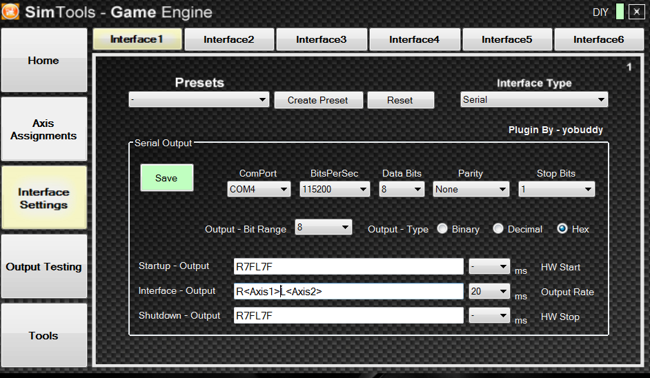

    we have problems trying to builde our own first simulator.
    our components are:
    Arduino uno
    2 Motomonster
    2 Engines
    2 Pot 10k
    2 PC with licence (game tool + engine tool)
    we mannage to connect everything, we update the arduino card with
    Arduino 2DOF code
    it seems fine. we can send comands on the arduino program tool to change engine position and it work fine.
    the point is that we dont get any movment from sim tool "test tool" and also when we plaing games.
    every thing is connected by the guide and we make sure the com port/speed/bitrate is correct.
    BTY, we do get conected by the two pc and when we running the game we gat the "playing game: notice.
    can anyone give us a direction what can we do/check
    Regards
    Asaf.

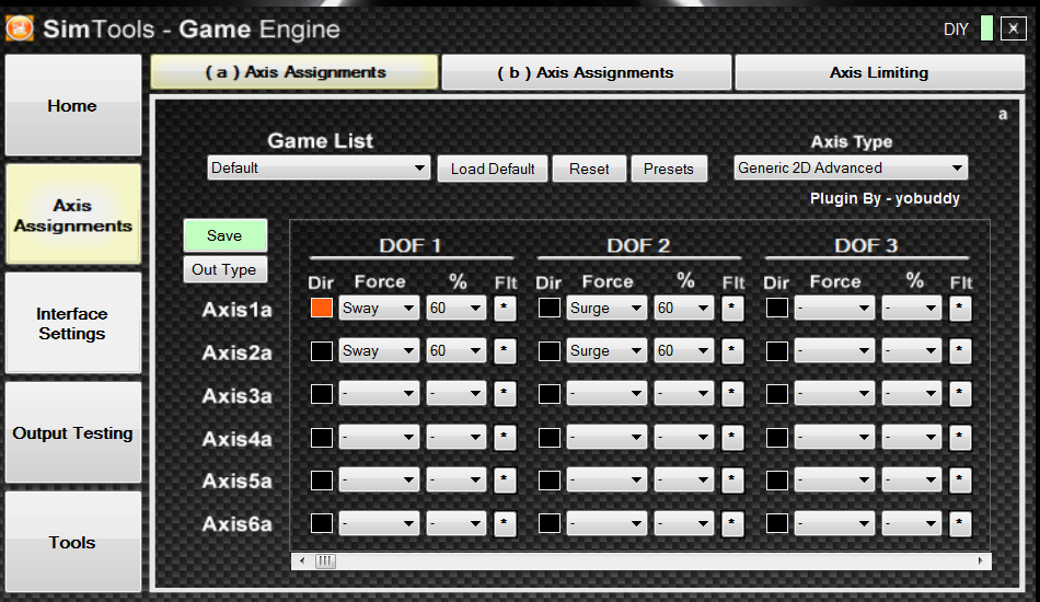

    What code are you using with the Arduino?
    Please post pictures of all of your settings, in particular your SimTools Interface settings.

    RacingMat_2DOF_Arduino_code:

    For SimTools 2 the Interface Output seting should be: R<Axis1a>L<Axis2a>

  6. Asaf
    Asaf New Member
    Sep 28, 2018
    76Coins
    2DOF, 3DOF, DC motor, Arduino
    you are the best
    after a few days of trying we are now working.
