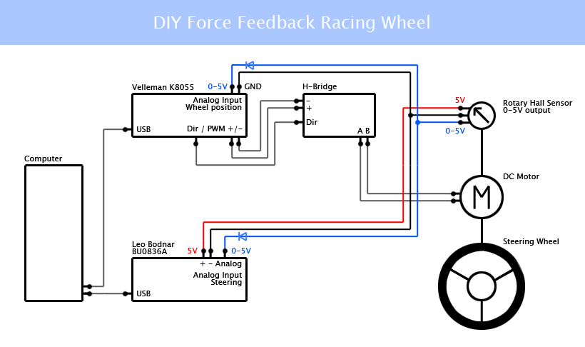

    has someone an idea how I could pick up steering force feedback signals (fet-ready gate signals) from racing sims? I'd like to build my own steering wheel. The Mjoy16 controller should do the trick, but it can't do the force feedback job :-(

    As far as I know the AVR has only analog and digital inputs. To get the FFB working it would need 1 analog + 1 digital output for the FFB signal.
    1 analog input for the steering wheel.
    1 analog output for the translated FFB (PWM) -> connected to h-bridge -> FFB motor
    1 digital output for direction control -> connected to h-bridge

    That´s more than enough to make a DIY FFBwheel. Additionally you only need one or two motors and a h-bridge.
    Creating a proper feels good movement of the wheel with x-sim will be the hardest challenge after building the electronic and mechanic. - But is possible!

    Could I use one single hall sensor for steering input (Leo Bodnar controller or Mjoy16) and simultaneous for position tracking of the wheel (X-Sim)?

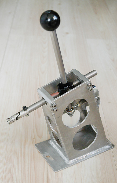

    a DIY Shifter?
    Try to build this... :lol:

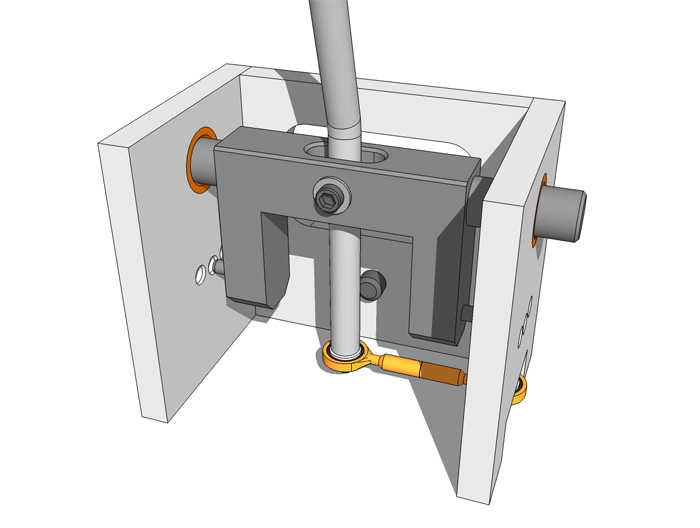

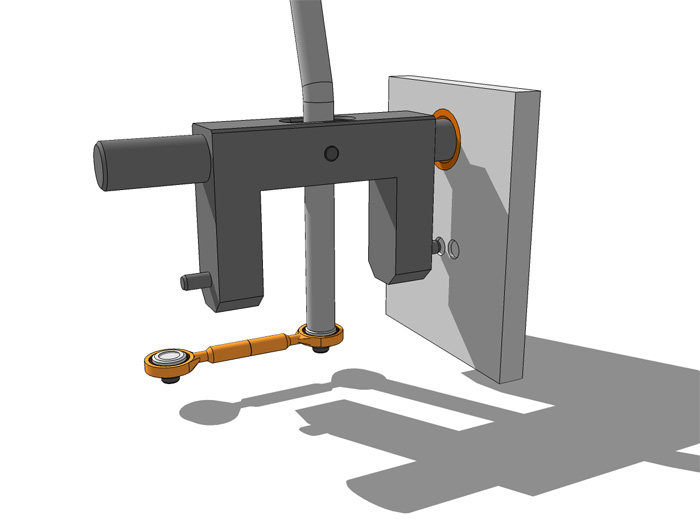

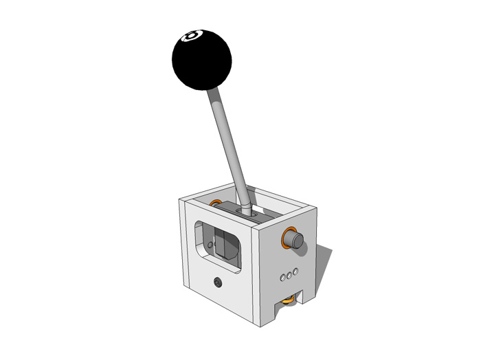

    Thanks, but I'll do it my way. Found a Porsche G50 shifter on google:
    Based on this h-shifter I designed my own version. My CAD concept:
    Most of the parts are already here and the 4 main pieces of the housing are already cut (CNC). I have the tools to build the rest, but no time. Maybe around x-mas.

    hi jakob, I´m working on a DIY FFB wheel too, but this project is very big and laborious.
    I looked at your design with Leo´s board and the Velleman, but I think you should use one single board, with analog input an PWM output.
    To control the motor I am thinking to use an H-bridge with current sensor, so you could set the apropiate torque in the steering shaft. Any comercial wheel does this.
    I am designing a board (based on a PIC 18F4550) to reach all this functions. The best way to drive DC motors is by ECCP module (Enhanced Capture/Compare/PWM)
    The H bridge is similar on Tronicg´s design with a little modification.
    In the PC I think to use rFactor InternalsPlugin.dll witch give me the steering torque value.
    As Crobol, sorry for my english.
    Regards, Willy

    I've rejected the Velleman idea and I'm actually working on a uC (ATMEL) controller board for the wheel. I wrote in another thread:
    Thread link: avr-boards-bascom-t2137.html
    I have some 24V industry robot motors (110oz torque, 8Amps), two h-bridges (each can handle up to 20Amps) and an ATMega88 dev board. I'll test the wheel with one and with two motors. But one should be enough.
    I hope it works out. When it does, I'll make a tutorial and post the layout + software.
